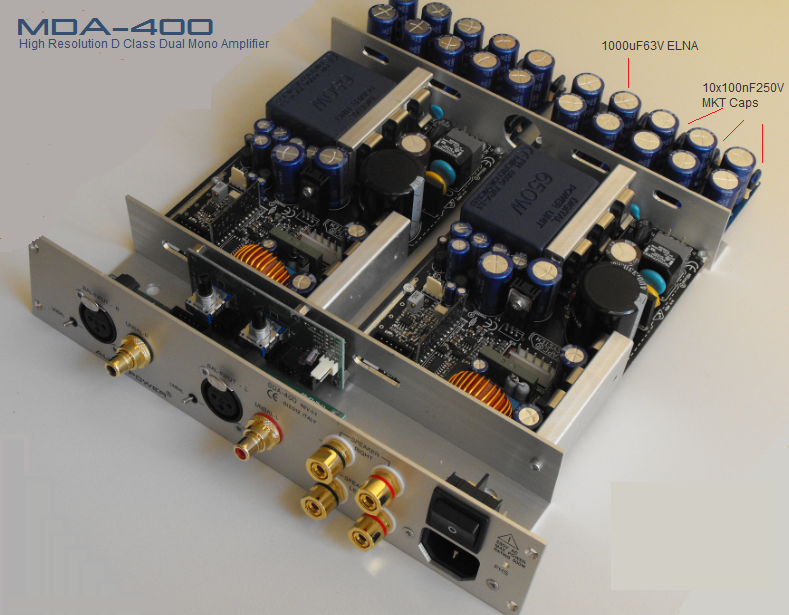

Yes, 2 pz. ELNA 1000uF63V+4xCN 10Pin (2+2)
@Pinnocchio 60pz+20pz ELNA 1000uF63V+ AL parts,Package sended.

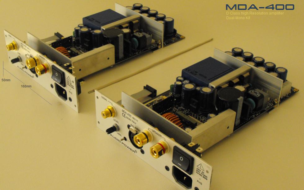

Some have asked me for the rear panel.
This is the stereo version for the Dual mono MDA-400.
Tomorrow I put the panel mono version.
Regards
...Disguised as a Class D hehe
Regards

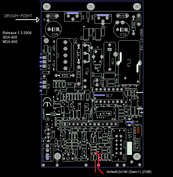

SDA/MDA Gain Modify
I thought it may be useful to others.
Honestly, the SDA / MDA have the input sensitivity already in the standard range.
Attention, with a normal soldering iron there is a risk of destroying the pads.
Use two welders equal to the res smd desolder.
Make sure that during welding, the amp is totally disconnected from any connection, including gnd.
This change does not require calibration.
Change two res same value, eg. 2x15K.
partial scheme coming soon

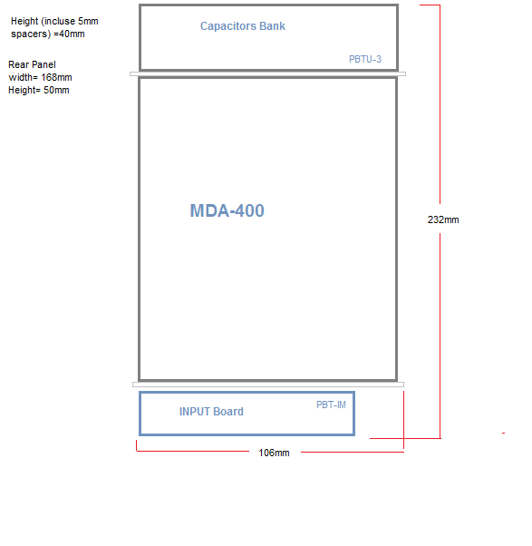

Dimensions are referred to an MDA-400 complete.
I am waiting for a case for this amplifier, use this panel at rear.
Front 10mm thick, with very nice top / bottom cover 6 opaque pastel colors.
Rear Panel, includes wrong RCA-Input (I not use this,just on old photo), then changed with professional CN, certificate gold.
Oki I prefer that!Ah..yes, I wanted to refer to another DIY. I sent you a small envelope days ago, with two blue-250V mkt 0.1 +2 res.
Btw your amplifiers are looking great as usual 😉
Maybe you love this MKT blue caps..eheh.Oki I prefer that!
thank, we waited for your finished job 🙂
