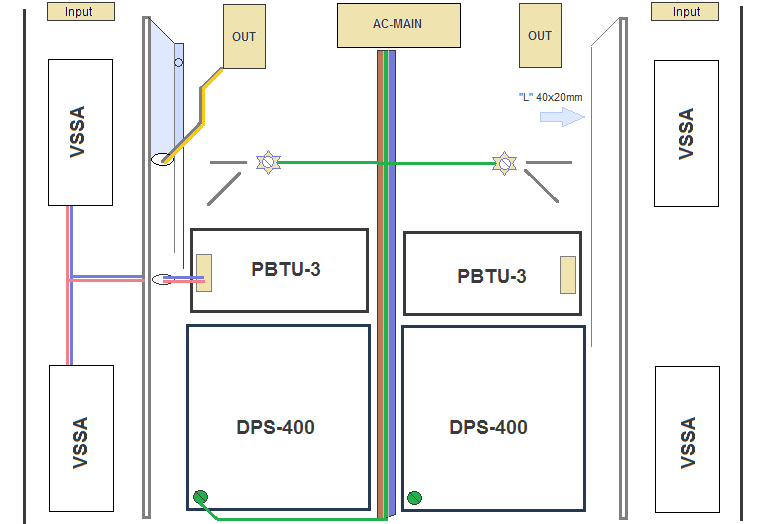

I tried to figure out how to configure 2 amps with quad channels each, in 2U x 300mmx 435 with 2 heatsinks.
one amp with 2 DPS and 4 SPS would give that, with the power filter socket and the conector at the rear:
one amp with 2 DPS and 4 VSSA would be that:
by the way I realized that the DPS-400 DOESNT fit in 1U , the Rubicon cap and the bridge rectifier are two high
Also I m thinking to put a steel panel in U between the VSSA and the DPS to isolate them from some radiations...
any feedbacks welcome

OOOPSSS : 1U = 1.75' = 44mm. should be ok, just depend on the height in the chosen enclosure.... sorry
Hello Fabrice, This is the best arrangement of the modules inside a case, is not the only course, but I have considered many factors.
the "L" alluminum you can easily find in the city, from small artisans aluminum is widely used. normally at around € 3 x1mt
If you need to use small spacers x DPS-400 (instead of 7mm), I recommend adding a sheet of mylar or other insulating material, under the DPS-400.
the same can be used under the SDA-400 (right below the voltage regulators).
For SDA-400, Also you can see the arrangement as the 4CH, the pictures that I put in the thread.

Perfect Roberto thank you!
yes I m going to use the L aluminium, just to feel better 🙂
yes you are right, some milar spacer will provide some dielectric and better security.
