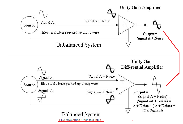

btw, input impedance specs says 2x 5k ohm balanced
will that also be 5k in single end ?

You have 5K as Unbal Input. (see jmp at input)no, even in lower quality, still not cheap
