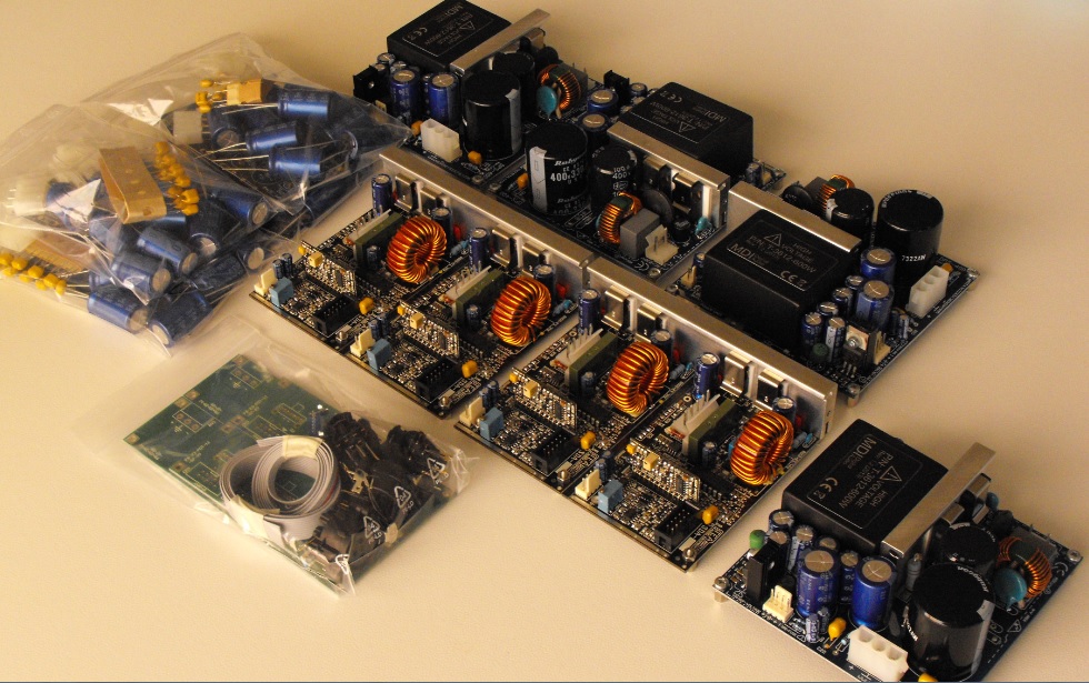

I've received my amp/smps this morning.
Judging only by the look of the boards it seems really solid build. I'll mount the capacitor boards and then I'll get back on you to have some informations about the wiring.
I'm happy to have not asked for refund 😀

Hi Roberto,
I have solder the capa psu board but I'm missing one resistor and one decoupling capacitor:
Received only 3 resistors and 19 capacitors
Alexandre
I'm Very happy you have received the pachage.
Ah...well, just change error instead of 10Pin connettors 😛
I send small package for this, no problem, I want you have same on PBTU-3. for now, you can solder any res 10K to 22K as pair. this need only for pull down the voltage, just if you disconnect power DC connectors. just for safety, no other.
Sorry for this error, but period we chose very poor for Kit.
I have found a resistor 15k in my toolbox same value as the one you send me but I have no substitute for the capacitor.
And don't worry it happens 😉
If I miss one decoupling capacitor can I still use use the amp or it's better to wait? At least I can try one amp 😀
Alexandre

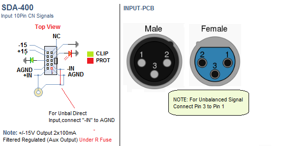

Roberto can you please tell me what is what on the sda-400 balanced/unbalanced connector because I want to connect my dac directly on the amp board. Can you please tell me where to connect for unbalanced setup and balanced.
Alexandre
Hi Alexander, If you can, use Flat cable & input board,
ALPS pot, put at the max (R=zero).
In the meantime, this is the connector on the SDA-400.
