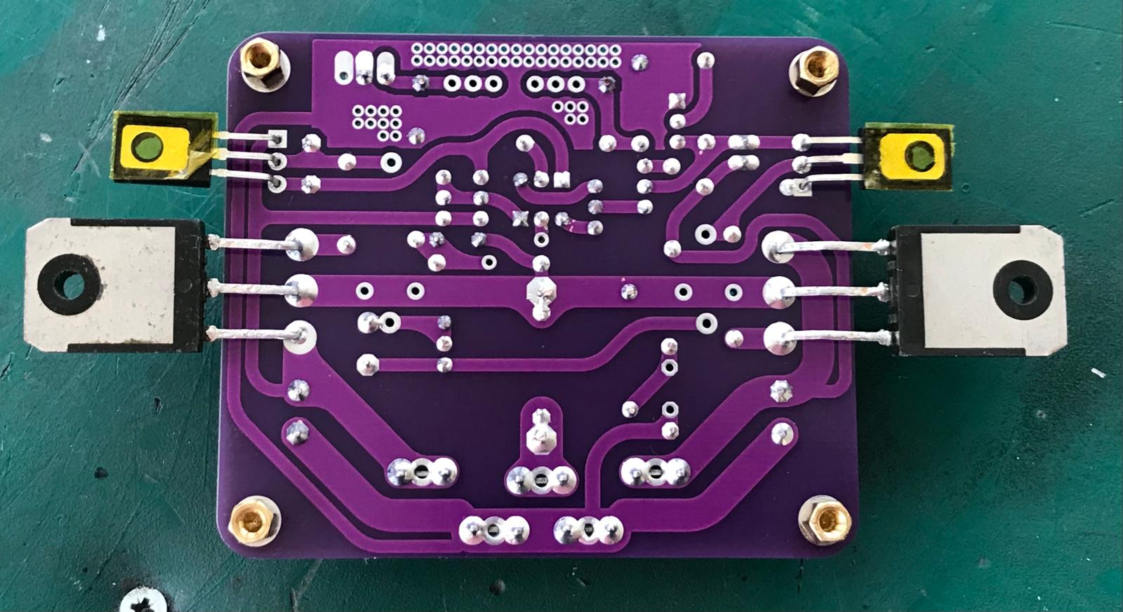

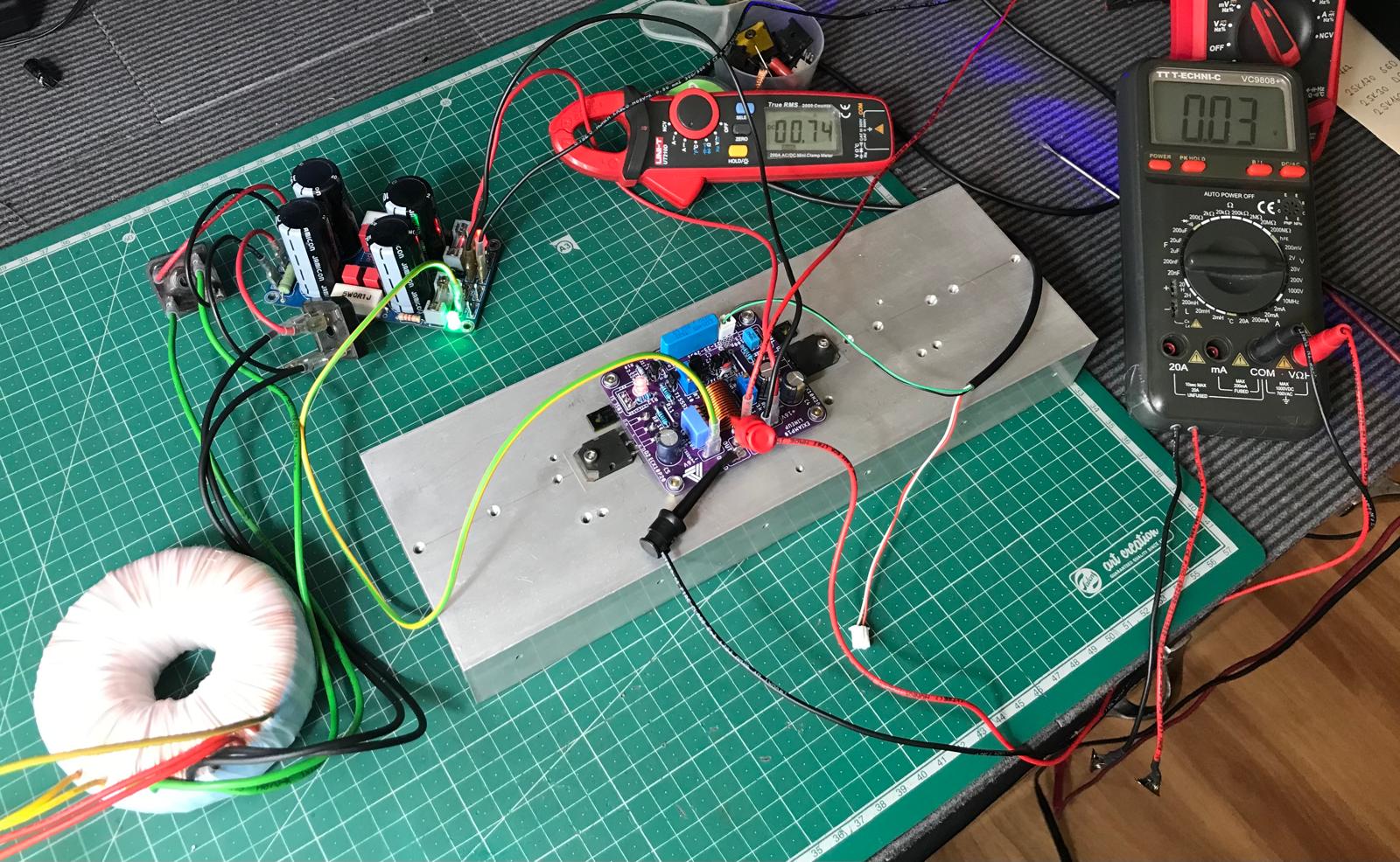

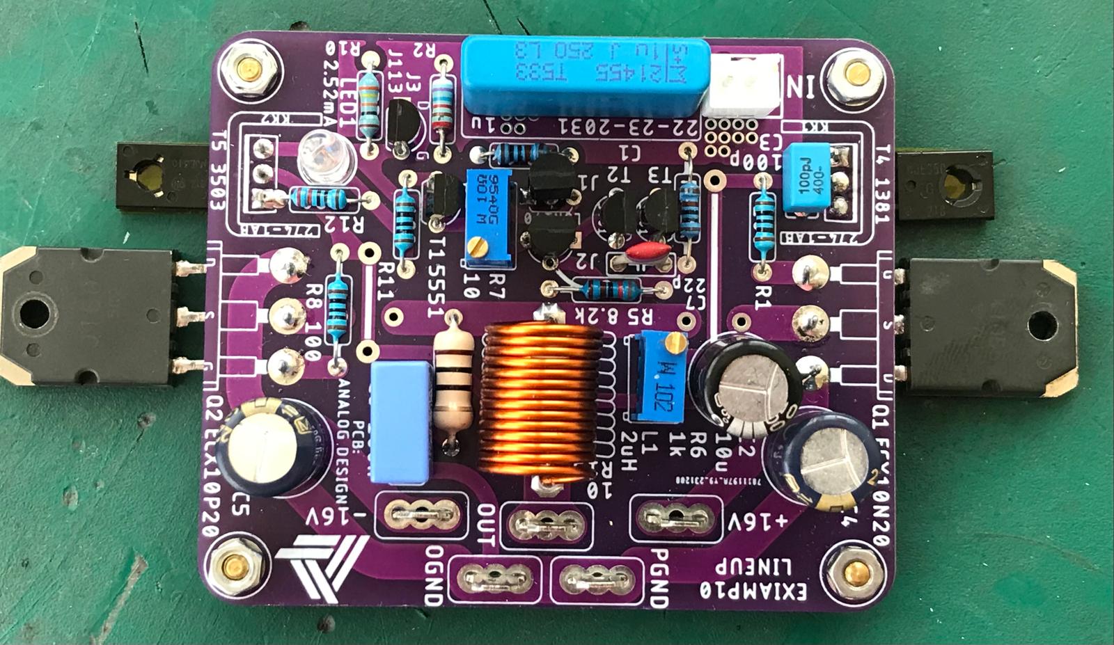

I've finished assembling my amplifier circuit.
  • Output mosfets 2sj160-2sk1056
  • Supply voltage +-18vdc
  • Quiescent current 0,75Amp
I cannot reduce the offset voltage below 3.3v. The sound is fine. Although the offset voltage is 3.3v, the speaker protection circuit does not cut. I'm waiting for your help where I'm wrong.

After connecting the mosfets to the heatsink, I checked to see if they were in contact. The mosfets do not touch the heatsink.
It will make measurements according to the published scheme. When measuring, there should be a signal input. I adjust the quiescent current with R6 and the offset with R7. Jfets are not mapped. I suspect the Jfets. I run it for 15-20 seconds, the sound is fine. I read somewhere that there is a virtual offset in the outputs.

I finally managed to run it properly.2sk170s were suspected to be original.I replaced them with 2sk163, which I am sure is original.I made IDSS mapping.offset voltage around 3mv.quiescent current 0,75amp.Thanks to everyone who helped.
