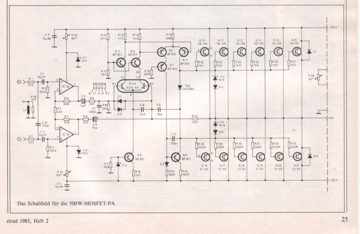

My 2 cents on compensation:
Do connect c5(22p) with the gates/bases of power transistors instead of output. In many cases this increases stability considerably.
Just the way I did it with my first 2x500W latFET amp, published 1985

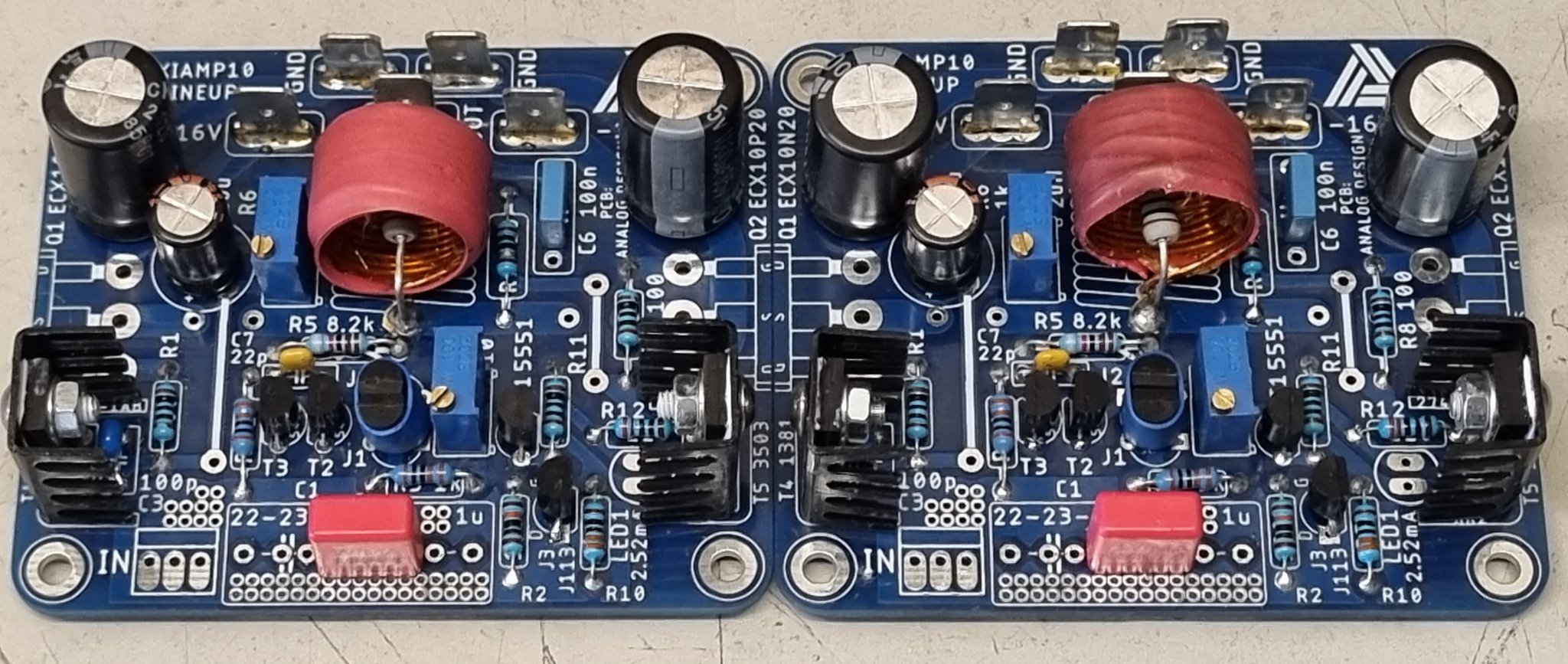

I've done the boards (need to tidy up the heatshrink on the inductors and add LEDs still).
I haven't got a suitable transformer on hand, so I'll have to wait until I get one before I can see if this makes noise.. or smoke..
