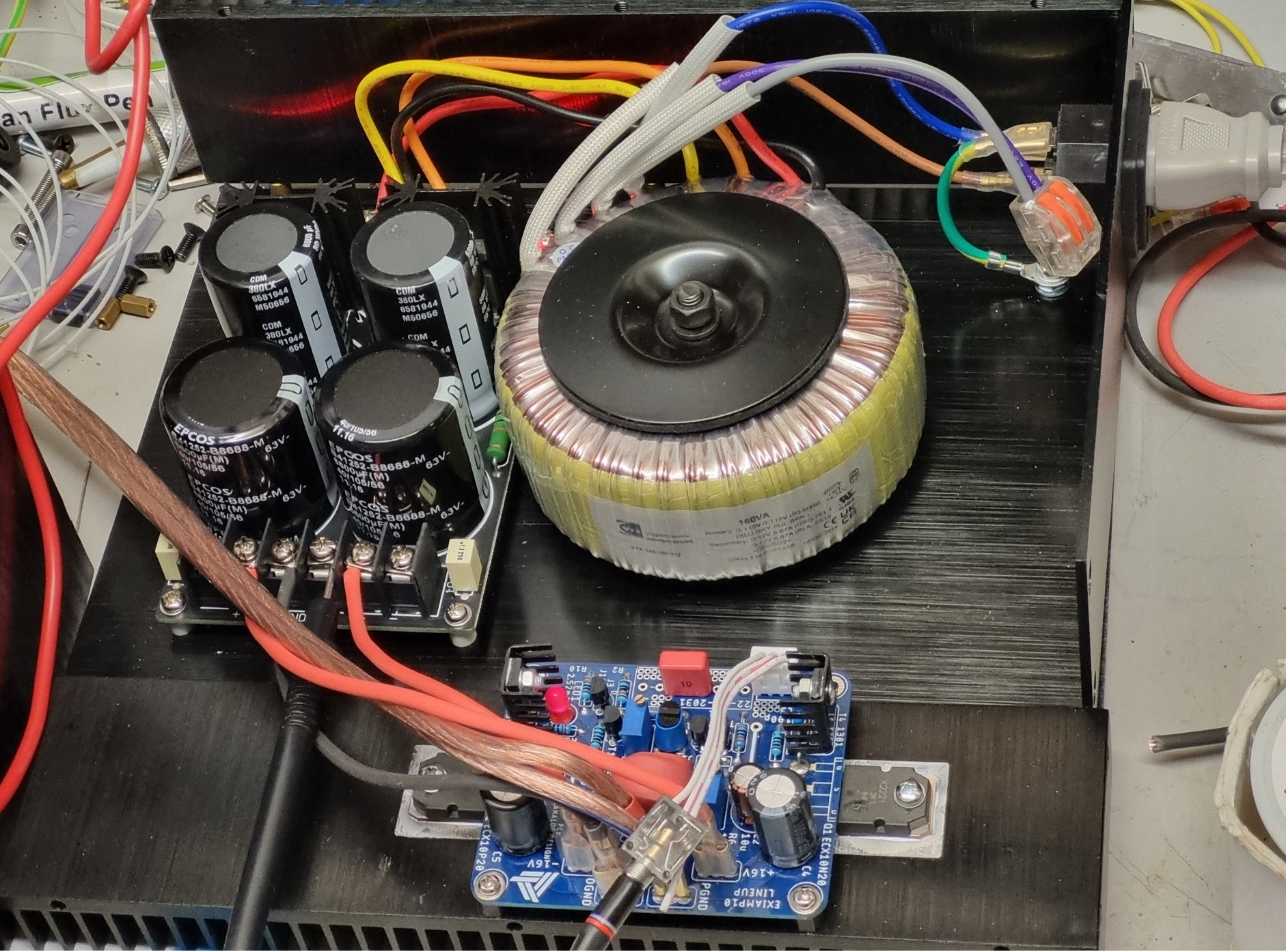

First channel is up and running. No smoke or fire so far, so that's a good sign!
Even on the sacrificial test speaker, the amp sounds very nice and there is no audible hum or hiss whatsoever.
The case I have available is fairly small, but may be just enough to run this amp without getting too hot.
Due to availability, I substituted in MPSA42, MJE 350/340 and the outputs are 2SK2221 and 2SJ352 (Not Exicon, I know, but equivalents).
Setup:
18V rails with CRC on power supply. 160w Toroidal.
7.5 Ohm resistive load.
Measurements with oscilloscope and/or TrueRMS Fluke179 multimeter

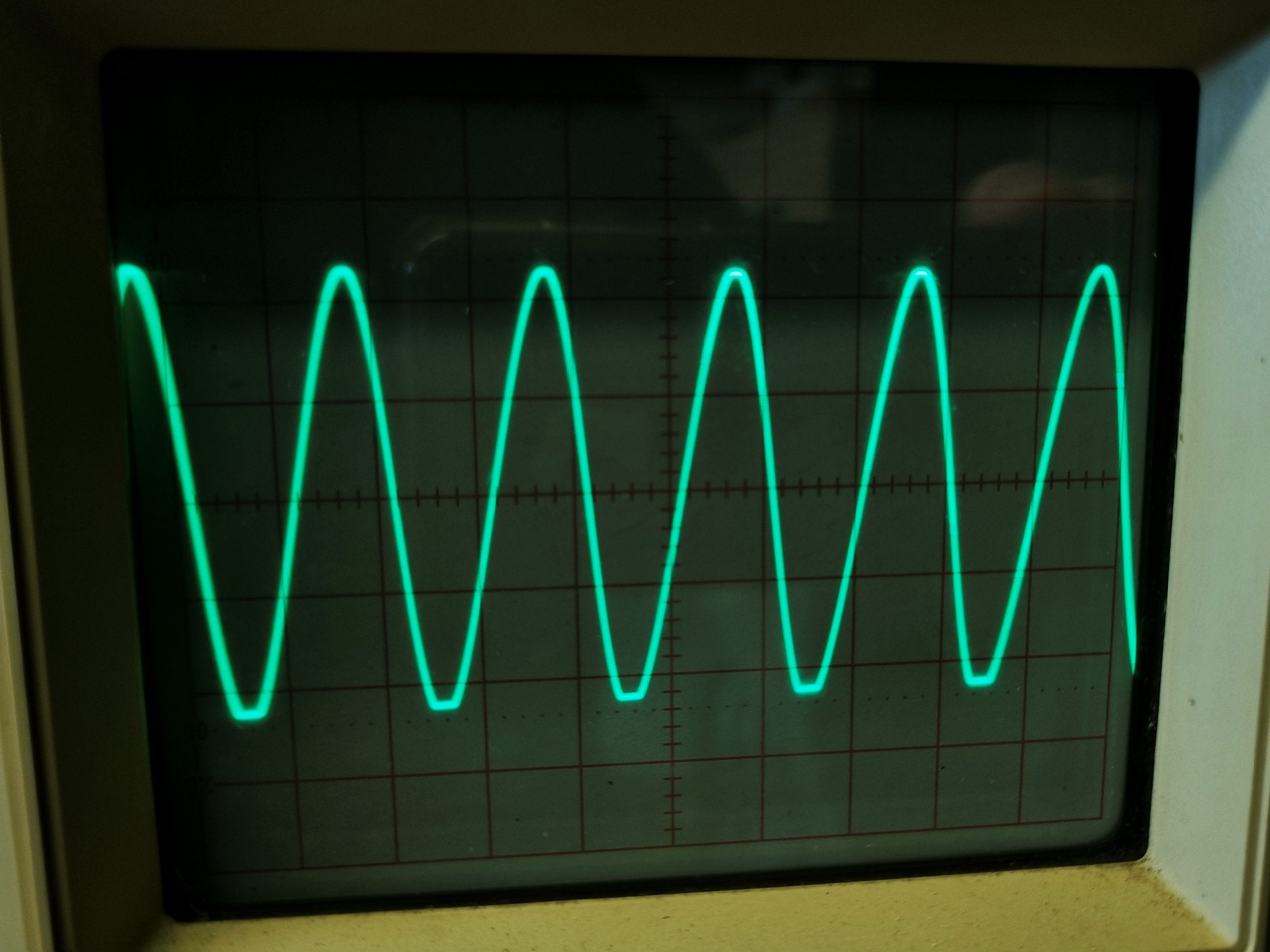

Clip:
9.89V into 7.5 Ohm = 13W output power.

Pictures:
Setup:
Clipping looks like this:

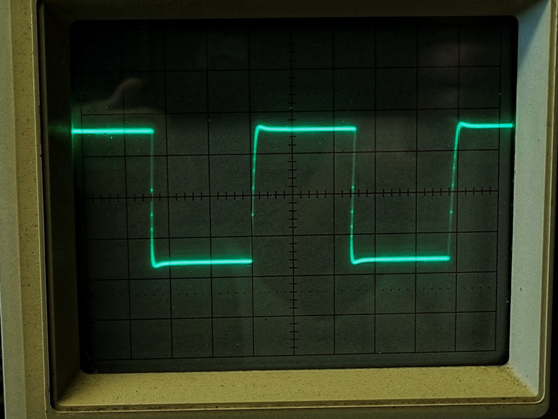

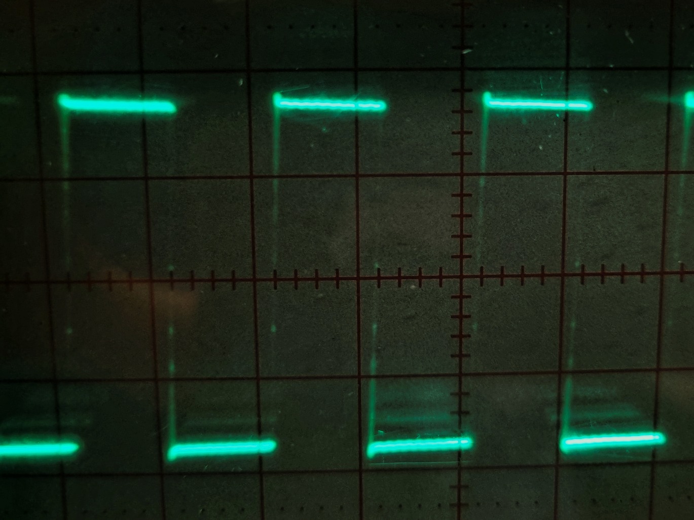

1KHz Square wave:
10KHz Square Wave:

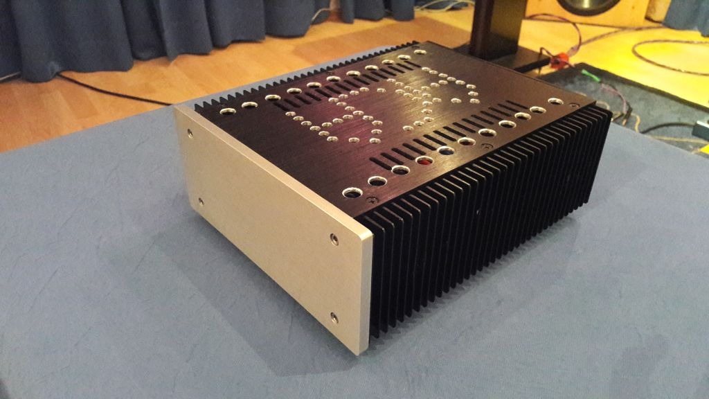

Second channel went fine. A little more temperamental with the DC offset, but centered at around 6-9mV which is well below my personal acceptance level of <50mV.

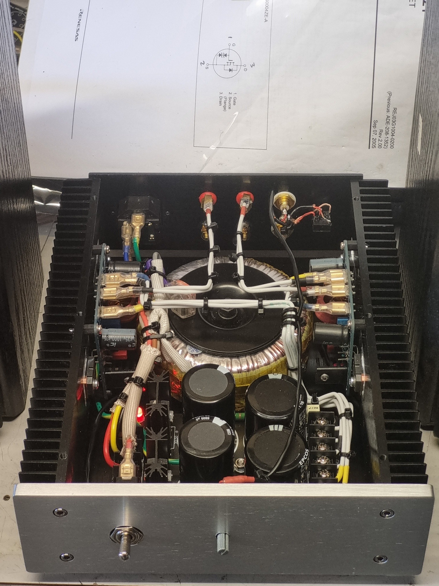

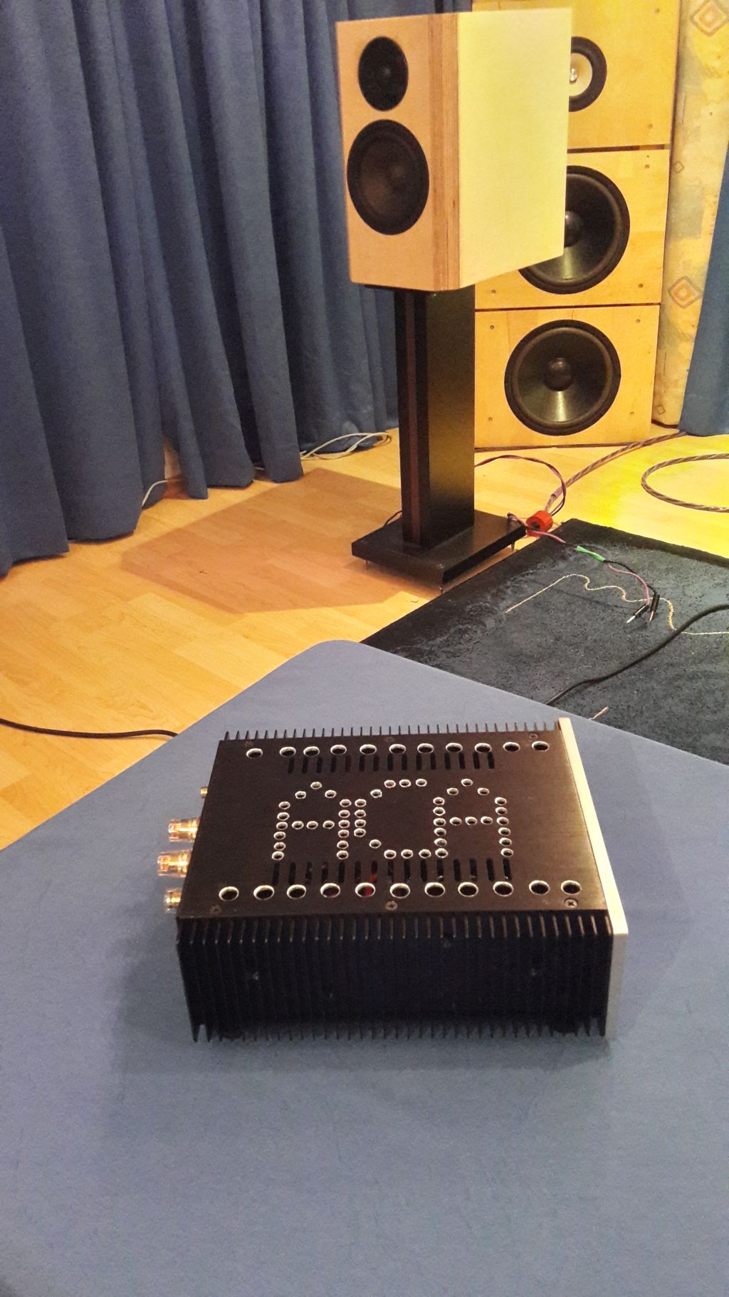

I went ahead and completed the amp with the case I had (need to put the knob on still):

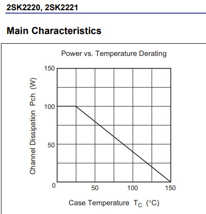

The heatsinks are a tad(!) too small, although the mosfets will happily bask in the heat up to ~140deg/C according to the datasheet at the power levels this amp runs at, and I've only seen ~70deg/c:
Amp sounds great so far! No audible hum, even when packed in tight with the toroid (I did add a little extra screening around the transformer though).
I put in a 3.5mm jack / RCA inputs as option. Thought about putting in a speaker protect module, but didn't want to have another transformer in there taking up space and generating EMI.
Pretty happy with it so far. Going to see how well it lasts and might look at either active cooling to help the puny heatsinks, or consider moving homes to a larger case and repurpose this setup for something that runs cooler...

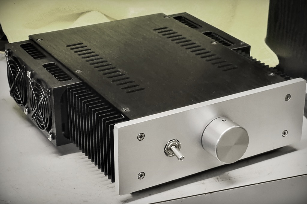

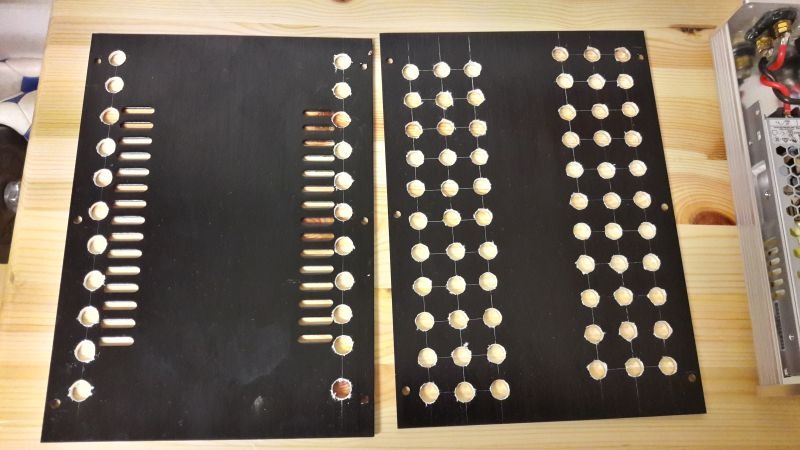

I decided to go with active cooling for this one in the end rather than wait for holiday season China shipping and spend time moving it to a new case.
So I 3d printed a couple of housings to fit over the heatsinks at the hottest area and mounted 4 silent 6010 fans:
The fans are wired with a switch to allow for half speed or full speed, simply by putting the fans in parallel or series.
The fans are 24v units running at 18V high and 9V low. I measured ~30dB at 1m with the fans on high. I ran the amp for an hour in 35deg (celcius) ambient with the fans on high and the heatsinks stayed cool and the chassis was warm to the touch (but not overly hot).
The amp sounds great on the test speakers and has behaved well so far.

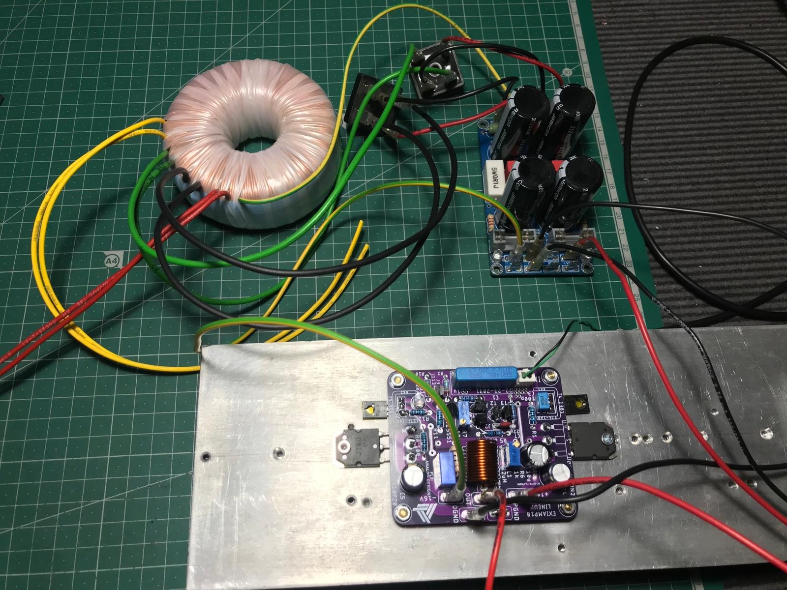

I've finished assembling my amplifier circuit.
  • Output mosfets 2sj160-2sk1056
  • Supply voltage +-18vdc
  • Quiescent current 0,75Amp
I cannot reduce the offset voltage below 3.3v. The sound is fine. Although the offset voltage is 3.3v, the speaker protection circuit does not cut. I'm waiting for your help where I'm wrong.

Hi my friend .
congrats for your building.
with all respect i think you must raise a little the compensation cap.( these small cracks at vertical line and the litle overshooting in corner ).
