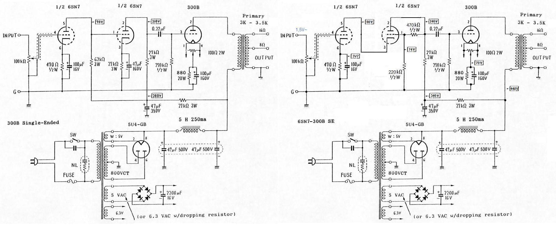

The question with this feedback idea is what does it give us. One thing I have learnt from this is I should make myself my fake 211 driver idea as I have all the parts and I have never seen it bettered. It has SE spectrum with PP DC conditions. I only have 43% UL with parts I have and will have to try it as a new idea. I doubt I will use loop feedback. It migh work with my old Magnepan SMG'a as they claim a purely resistive 4R load.
What could work is UL output and pentode in. It might need some shunt input feedback to make a nicer spectrum. 1% THD 12 watts is the target with 0.3% 5 watts.
The design would tollerate one sided Schade. I shudder at the idea, if it works then why not? Notice the valves were badly mismatched. When matched it was slightly better. The whole idea was to use a cheaper transformer. Mild DC imbalance might promote a better sound as it is a bias of the BH curve like old tape recorder DC bias.
The CCS's were to be certain what was possible. As transistors are highly linear as CCS's I feel they are a good thing. The 3 diodes are to make them as near a resistor with current gain as I can get. If not slightly more second harmonic. The BD139 exactly as a LM317 if so. One feels a BD139 must be a better choice if bolted to the chassis.
Can anyone recomend a cheap triode for this use? My hunch is it will be hard. A double ECC81. I doubt it would be as linear. It will need to swing about 60 Vrms ( think I saw 77 Vrms into a dummy 470K load ). If my notes are right the gain is about 28 for the triode stapped EL84. There is a warning that 7199 is not suited for use below 100 mV rms in when audio use. I think the EL84 would be similar. My notes aren't always as good as I would like for the forum. Please forgive. I tried distruction testing the MJE350. The two constant current actions of it and the EL84 always pevented anything bad happenining. Whilst I can not say it can't be broken I doubt it would have a problem. Note, I go as far as one would dare with the MJE350. With a 211 in SE I suspect a pentode EL84 curve would be better. BTW, EL84 is one of the best sounding valves I know of. It also is good from many makes.

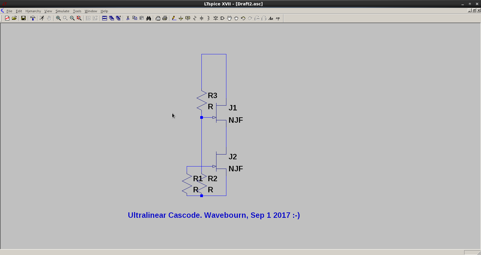

By the way, was an "ultralinear cascode" of 2 FETs already patented?
If not, I claim the priority! 😀

Umm, except the bottom FET is not acting like a triode. So the UL Fdbk above it will not help linearize that. Nice try though.
Could put a triode at the bottom. A Fet cascode up top, with UL Feedback on it's gate.

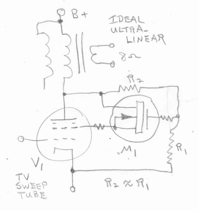

Being easier to get high current (power) beam pentodes, suggest the improved UltraLinear design below:
All screen current returned to the OT. Screen grid V lowered below the plate V for TV Sweeps. Could make the R1 DC return to a +Vg2 (maybe +60V), instead of the cathode (as shown) for more power capability. R2 could go to a UL tap on the OT also, probably better coupling to the secondary there.
All screen current returned to the OT. Screen grid V lowered for TV Sweeps. Could make the R1 DC return to a +Vg2, instead of the cathode (as shown) for more power capability.

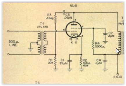

Then some people would chime in and claim that current drive of a resistive feedback divider is equivalent! Then, of course, 2,000 pages later, it will go to The Lounge, switch to cars & boobs. And to Blowtorch Preamp. 😀
hpeter: "this is real schade with transformer drive: ...."
The problem is that real Schade does not have sufficient bandwidth for use as a local loop within global or nested loops. Plus it requires an expensive inter-stage xfmr.
And the "fake" Schade (with resistors) just transfers the linearity problem to the driver instead. Although the RCA 50 Watter version handles that well (added driver cathodes Fdbk).
This all being why I mentioned the N Fdbk to the driver screen grids local Fdbk version (a la Jan Veiset). Or the N Fdbk to the driver cathodes (a la RCA 50 Watter), or the UL local N Fdbk (especially the improved version above, post 188 )
