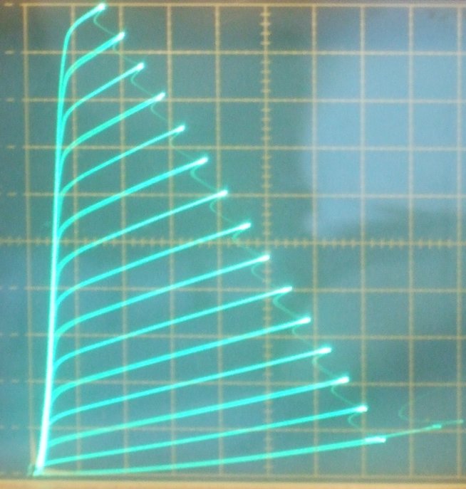

Not too surprising, considering that tube grid 1 response is mostly square law and Mosfets are too. Control of gate Cap. would be key. Square law in P-P mode with class A operation gives constant net gm, Shangri-La.
However, we have Crazy/Twin drive now, for constant gm in near class B, P-P, --without-- all the heat.

Space age constant gm tubes (most any TV Sweep tube eligible):

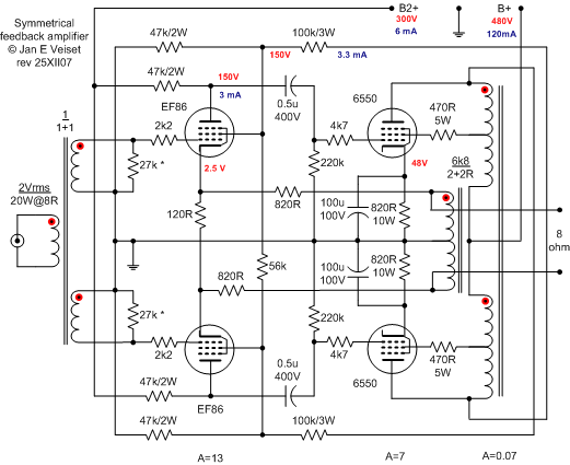

Here is Jan Veiset's 2007 complex driver scheme:
Feedback scheme.
I think he didn't get this working due to instability problems, last I heard. (CFB phase issue?)
The two interesting points are the driver stage with crossed g2 feedbacks, and CFB from the secondary back to the driver stage cathodes.
Adapting this to the RCA 50 Watter:
Remove the "Schade" like P to P Fdbks. Use the crossed g2 Fdbks instead. Fdbk attenuators are designed so that the driver plates and g2's are kept in voltage proportion. That keeps the % distribution of screen current to plate current constant. (so the g2 loading impedance stays constant, otherwise Mosfet followers needed for the screen drives) Using this local N-Fdbk, instead of the "Schade" Fdbks, keeps the loop gain high for the driver, but the driver behaves like a low Mu triode for overall gain control (Fdbk-wise). (but still has high loop gain from the pentode outputs)
The driver stage cathodes could still operate as in the RCA design, or could use the secondary winding as CFB (like in Veiset's schematic) -if- it can be made stable. The secondary has phase shift from loading across the OT leakage L, and the gain is high at the driver cathodes. (much safer to stick with the original RCA approach here, using the primary side, or UL taps)
