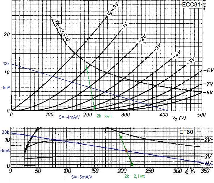

I show 1uF 2K output. If wanting to measure low frequencise and not willing to calculate differences use 10uF and 5K output pot. If you have 5 Vrms to play with even the 1uF 2K should be OK as long as you calibrate your in with out. Thought it best to say as it is a small defect in my design which is meant to be made for pennies. 1uF 63V being very cheap.
For valve designs 1uF 10K should be fine. That is 16 Hz -3 dB.

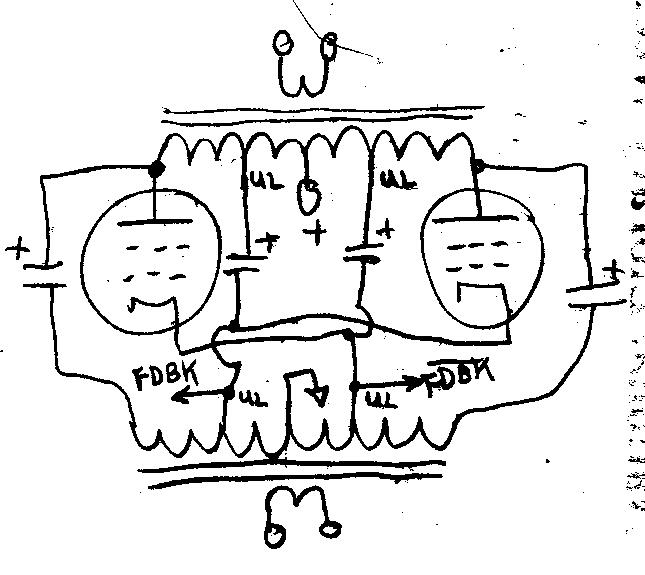

The Elliptron scheme below can provide 28% CFB using a standard 40% UL OT. Only a CT'd inductor is needed for DC current feed to the cathodes, rather than the full 2nd OT shown in the diagram below (ie, the full Crowhurst Twin version is shown).
One issue with using the secondary output windings for CFB, is the phase shift from the leakage L between primary and secondary from loading. (same issue as for global N Fdbk) One needs an unloaded CFB winding to avoid this problem.
However, the amount of CFB NFdbk is typically so small from the secondary as to not matter in any case. But the secondary CFB approach seems somewhat futile for avoiding global N Fdbk deficiencies.

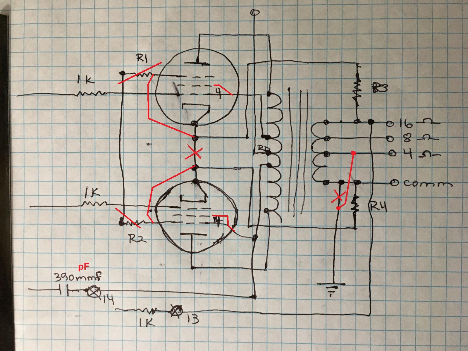

Hi there, about 2 years back, i made a PP EL34 amp using EICO HF87 OPT and the RH Universal circuit. Essentially it was 2 rh amps per channel each amp driving the mirror image signals. For the phase splitter i used a Lundahl input/splitter transformer. I also used fixed bias to have the operating point adjustable via the bias voltage/current. The implementation was a success and the amp sounded good but for the effort and lowish power which was about 14 watts per channel I felt that it would probably be easier and sound better to just go with a SE KT120 amp. This i also built using the same power supply and as expected this turned out to sound better with more power.I was wondering if I could get rid of my global feedback and apply schade feedback to my dynaco st70. Output tubes are currently 6p3se russian. What would be involved and could it be applied? Here a pic of the schematic:
It is probably true the the PP EL34 could have used some tweaking, maybe a lot of massaging, but i found out what i wanted to in my build. And that is the driver stage needed to perform better to get better results. If you google RH Universal amp you will come to a lot of info about this amp. cheers.
Lets just repeat this again - don't use a triode driver in a Schade amp. You are asking for trouble. Pentodes, FET's or transformers are the only suitable drivers.
