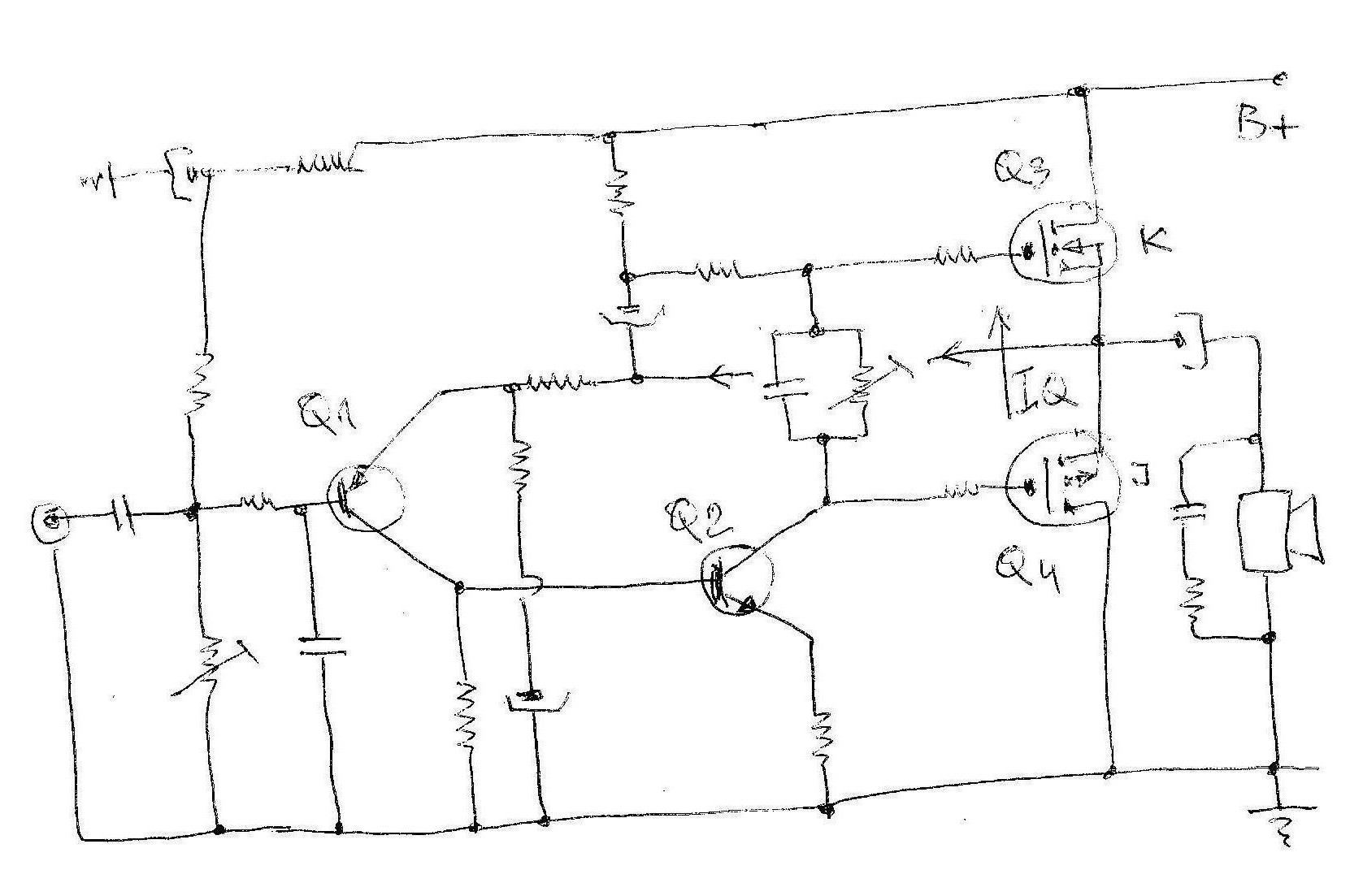

Appreciate very much JLH work&designs but I don`t understand why hi used BJT/LatFet hybrid CFP pairs for OPS ? , same performance can be achieved with conventional 4 transistor approach , where OPS FET pair is driven directly from VAS stage , maybe I`m wrong but I think that you have presented similar simple design somewhere .
BTW , I`m still convinced that very good sounding SE or PP tube amp can be done in common grid configuration , with output power tube grid tied to ground and cathode driven via small Jfet`s .

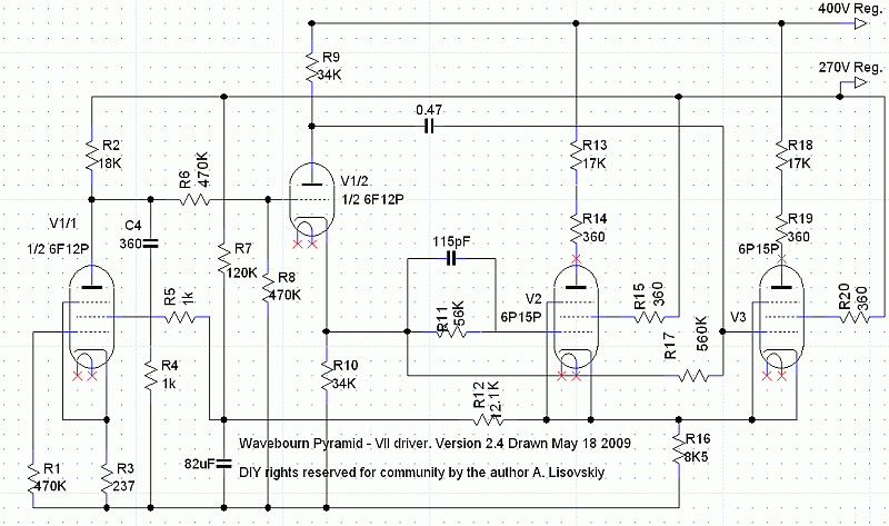

The Kitic saga was largely before my time, but the last time I replied on one of his RH threads here, and myself trying to stay neutral even, he was absolutely adamant that no FFT need be taken to see what the RH results really were. His Spice simulation was the last word, and that was it. So all arguments were endless theoretical ones.
Not seeing any pentode in the triodes here, but I certainly do see the triode in the pentodes. For me, the pentode is just a triode with separated output and feedback (screen) terminals.
Analyzing the RH circuit with a triode driver, there are some subtleties. Its true that the triode driver Rp is varying, and so varying the N Fdbk ratio. Normally this would be bad news. However, the effect is benign in this case if controlled correctly.
When the output tube is reaching high current, with low Rp and high gm, the driver Rp is going high so that more N Fdbk is allowed to tame that aggressive output. Similarly, when the output tube is near turn-off, with high Rp and low gm, the driver Rp is going low, to reduce N Fdbk, so assisting the weak output tube to go further off. This is 2nd harmonic cancellation. The RH miracle 12AT7 driver triode has strong Rp variation (compared to constant Mu triodes). It is likely this was cancelling 2nd Harmonic of the output tube. But with no tests allowed, and cancellation denied, we'll never know. I'm not surprised there are hard feelings all around.

Sorry to other to discuss this when about valves. The Better MOS FET amps should please people here. I think the link with FET's and pentode is small when power stages. It's the way they simplify a circuit I like. That circuit you show is so like one I did.
The JLH design is remarkable when it's time frame is taken into account. He goes back to capacitor coupling is one reason to say that. The 1980 amp is a little bit like a Quad 303. It was a triple using fast TR1 and then ultra industrial MJ Darlingtons. The MOS FET's do the same job as the Darlingtons. The beauty of the JLH is the VAS has less work to do, less than most preamps really ( can be 2 mA ). The output stage is a bit like the Schade idea in having local feedback. No long tail pair input which forces a better distortion balance. Like the 303 it is very low. It also avoides the VAS cDom stability idea which I suspect causes touble. I call it the one legged cyclist. I recently updated the PW Texan and got it to work ( use similar idea,voltage gain of 3 to 4 I find best ). I was given some 1935 Practical Wireless and Television. I think I see 1935 as a very modern time. The war put a stop to it. The written stuff is very modern and wise. The £4 Superhet and the WB Stentorian speaker. WB made the Quad ii output transformer ( I might be one of the few that know, Ross Walker told me and I spoke to WB who no longer did audio ) and I guess the ESL transformer. The WB had a built in transfomer. Loudspeaker outputs were at HT.

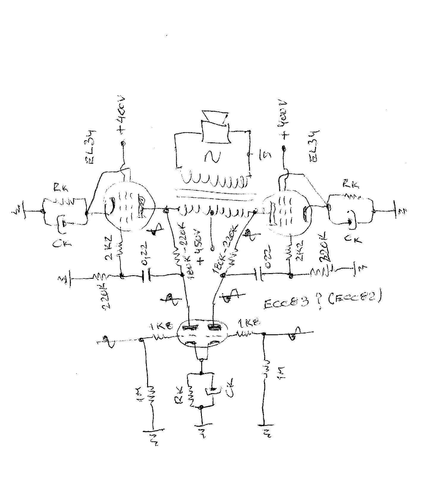

I think that your concept of Shade Fb on that A-class PP amp is very good ,
but I will maximize driver stage voltage gain before Shade Fb is applied ,
btw , what you think if `Shaded` EL34 PP-OPS works with fixed G1` negative bias closer to economic a/B class with let`s say B+650V and B+G2= 325VDC and with 6SL7 driver stage ?
Wouldn't it be nice if it got built. I am moving house soon. My big baffles are taken down and just an Armstrong 625 with Mission 760's to use. It won't be me this year. I have a PSU built of nice junk housed in a decking wood plinth, looks good and very cheap. It has a melamine top ready for valve basses. I then have some EL34 UL PP transformers I can use. The PSU is very quiet. Tested into series 100 watt 230 V lamps which seem to be an exact clone EL 34 load at 470VDC/2! The heaters are 3.15-0-3.15. I only found 2 dB noise reduction using DC. Even that was at 50 Hz. At 100 Hz they were the same. As 100 Hz is the problem no real advantage ( hum - 83 dB below 1 watt, heater and HT ). Don't be fooled into thinking DC is better, also it brings problems some say ( I have no idea ). This was on my SE design. When PP it could be better. The PSU is a FET capacitance multiplier. Without it, it has no hope of working with my 100 dB/watt speakers. The SE in PP out design was only - 60dB hum without it.
In UL I am told we should not run above 500VDC as at times the voltage seen is above the 800VDC safe working due to effects of cross coupled EL34's ( TT21 should be OK ). I had a Siemens Berlin cinema amp which in the UK ran at 820V ( 246 VAC UK against 227 VAC Berlin ). I really liked it's raw sound. The voltage on cheap National EL34 did not kill them. Two pentode that might have been EF41 and two EL34. The phase splitting was by long tail pair with 9 dB of loop feedback. 1.3 % distortion at 10 watts and 13 % at 100 watts ( fixed bias I think and standby mode, Class AB2 I think ? ). At 1 watt it was not bad. The EL34's ran with raw DC at the anodes and the G2 etc highly choke filtered. The blue colour in the EL34's said it was having a party inside the bottles ( not the best vacuum ). As you say 650VDC could work in pure pentode. The output transformer had a tap that could run 8 ohms. Test mode or in the projection room I guess. Circa 1958. As far as I remember the HT was at 600V on standby. What ther G2 the other voltages did I don't remember. The current was greatly reduced. I hope Frank still has it. As he really loves Siemens of his home city I think he might. I refused to change how it worked.

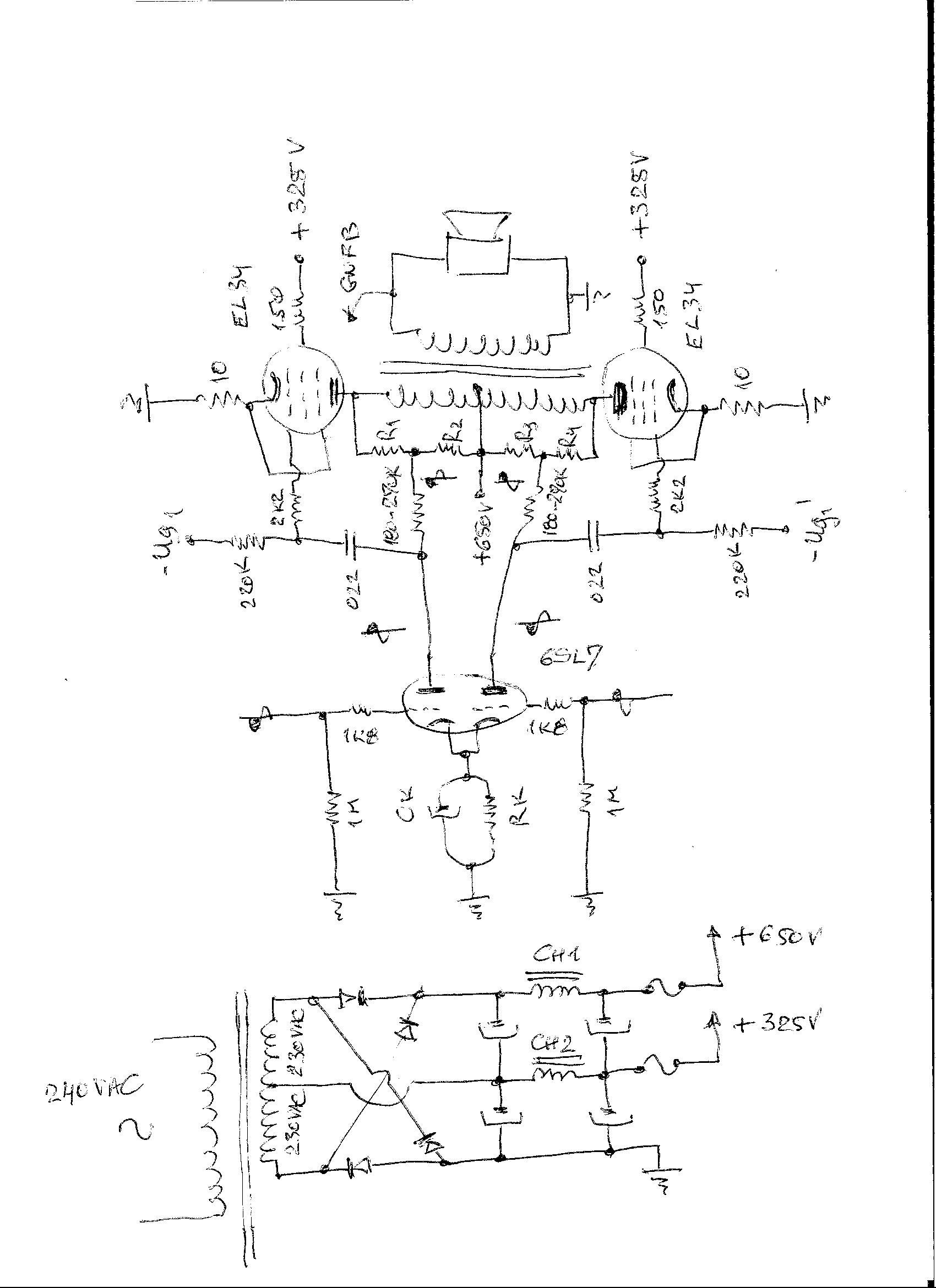

For maximum output power& long life those EL34 likes high voltage B+ and 1/2 B+ G2` biased in economic a/B class ,
ratio of R1/R2&R3/R4 can determine applied Shade Fb percent ,
B+ PSU can be done with small two isolation transformer 240V~/240V~ and with secondaries connected in series .
The g2 voltage depends on the loading and its upper limits. this 'half' number is just a guess...and not too useful at all.

Check Philips or TFK EL34 datasheet for PP 100W in pentode mode , they suggest 800V/400V , even Tung Sol 6550 suggest 600V/300V for PP 100W ,
after all I have made two unit based on Philips/TFK application note , one was RF/AM modulator with 4xEL34(KT90) with 850V/425V and second was
one Marshall SL clone with 4xEL34 750V/375V , those EL34 last and last.
