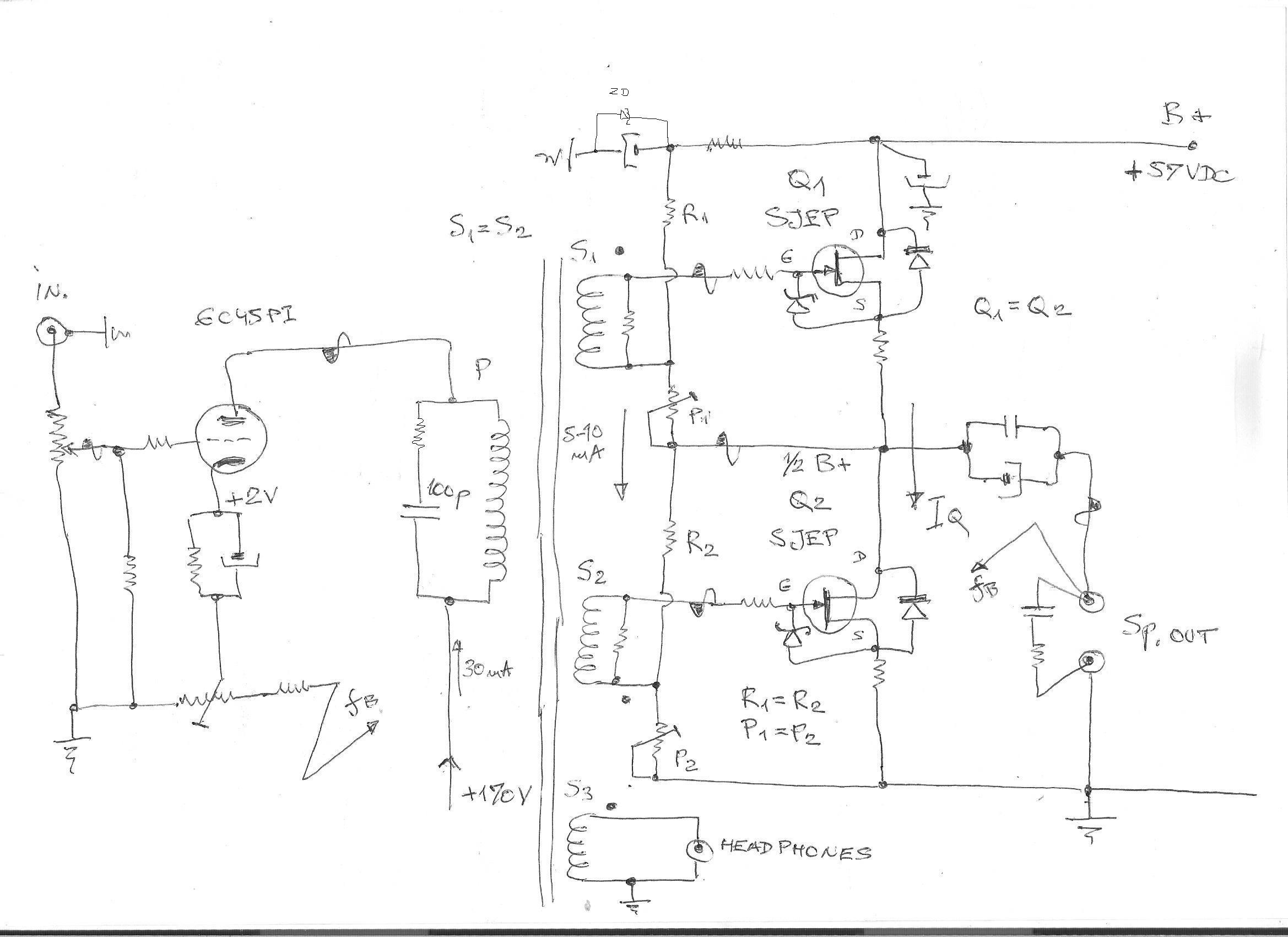

Zdravo Druze ! ( Hello Comrade ! )
Yes you are right that`Shaded` type of PP-OPS need driver unit with very low Z to get satisfying OL-BW , need to experiment with different driver tubes connected as CF , thinking about EL84 or even 6C19P for that position ,
maybe is interesting for you ,here`s one of my audio amp design(SET+SEPP) using driving transformer which also wait to be completed , all parts are here but no extra time for realisation 🙁 , those SJEP power J-Fet`s can be replaced with K1058 L-Fet`s , amp works very good in simulation with nice output THD spectrum , where Q1 is source follower and Q2 is `Shaded` drain follower .

hpeter
One very good option for that step-down driver transf. is Lundahl- LL1671 ,
anyway with that around 1W SET on the primary side you can explore various configuration on the secondary PP-SS side and to find what sound wise you like the most , on the secondary side it can be SEPP , Circlotron or PP complementary pair power bridge .
