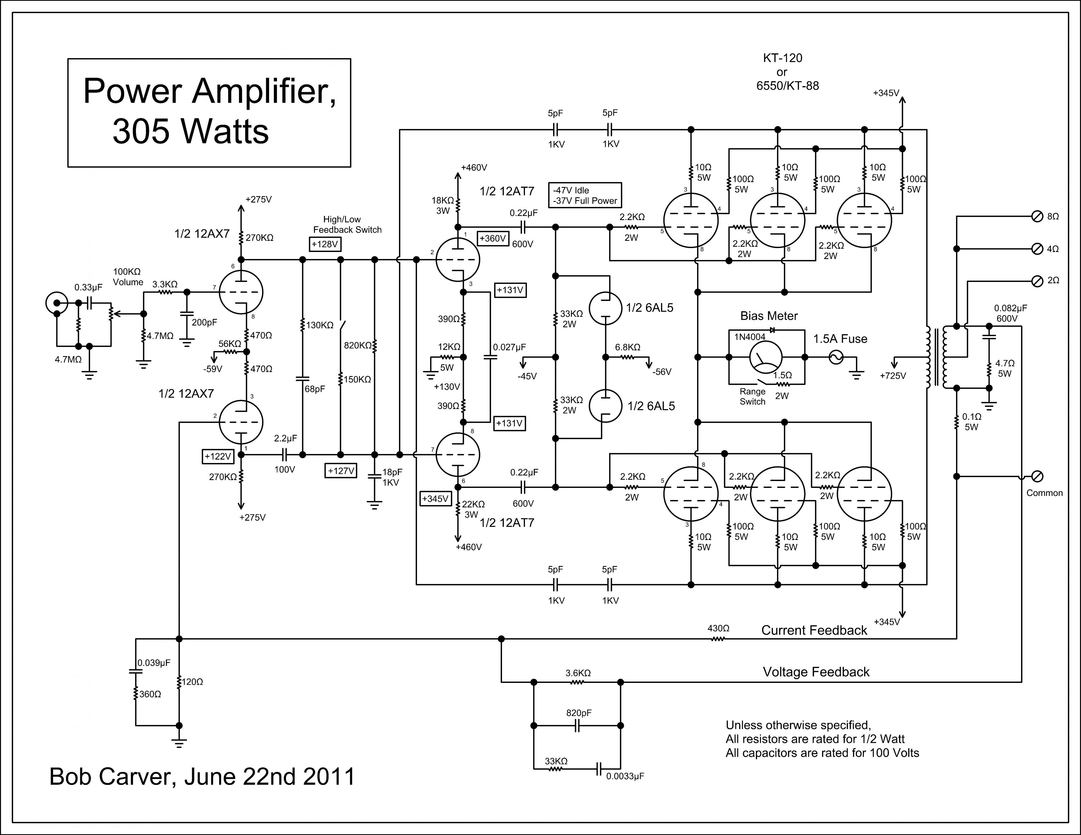

Check Philips or TFK EL34 datasheet for PP 100W in pentode mode , they suggest 800V/400V , even Tung Sol 6550 suggest 600V/300V for PP 100W ,
after all I have made two unit based on Philips/TFK application note , one was RF/AM modulator with 4xEL34(KT90) with 850V/425V and second was
one Marshall SL clone with 4xEL34 750V/375V , those EL34 last and last.

At that time I have no drawn any load lines , but that modulator and guitar amp works like charm for decades altogether with incredible output dynamics ,
btw, recently I have noticed that B.Carver use similar approach(725V/345V) in his very powerful audio amps even exceeding power tubes (6550) max. voltage ratings suggested from tube manufacturer (600V/300V), why ?
That's for Class B operation, perhaps ok for PA applications, but not hi-fi...Check Philips or TFK EL34 datasheet for PP 100W in pentode mode , they suggest 800V/400V<snip>
Than can we say that Carver`s high power tube amps are not hi-fi but perhaps PA ?
Regardless to Philips or TFK app.note that says is class B operation for me personally it is still one very lean biased AB1 class of operation , since I consider that pure B class of operation is than when at zero input signal output power tubes are biased exactly at point where anodes currents stops to flow , Ia/Ia`=0mA.
I made no comment on Carver's amplifier which has a sliding bias scheme... For the Philips TFK example whether it's Class B, or lean biased Class AB1, it really does not matter, since neither is commonly associated with hi-fi reproduction, but if you like it, that's that...

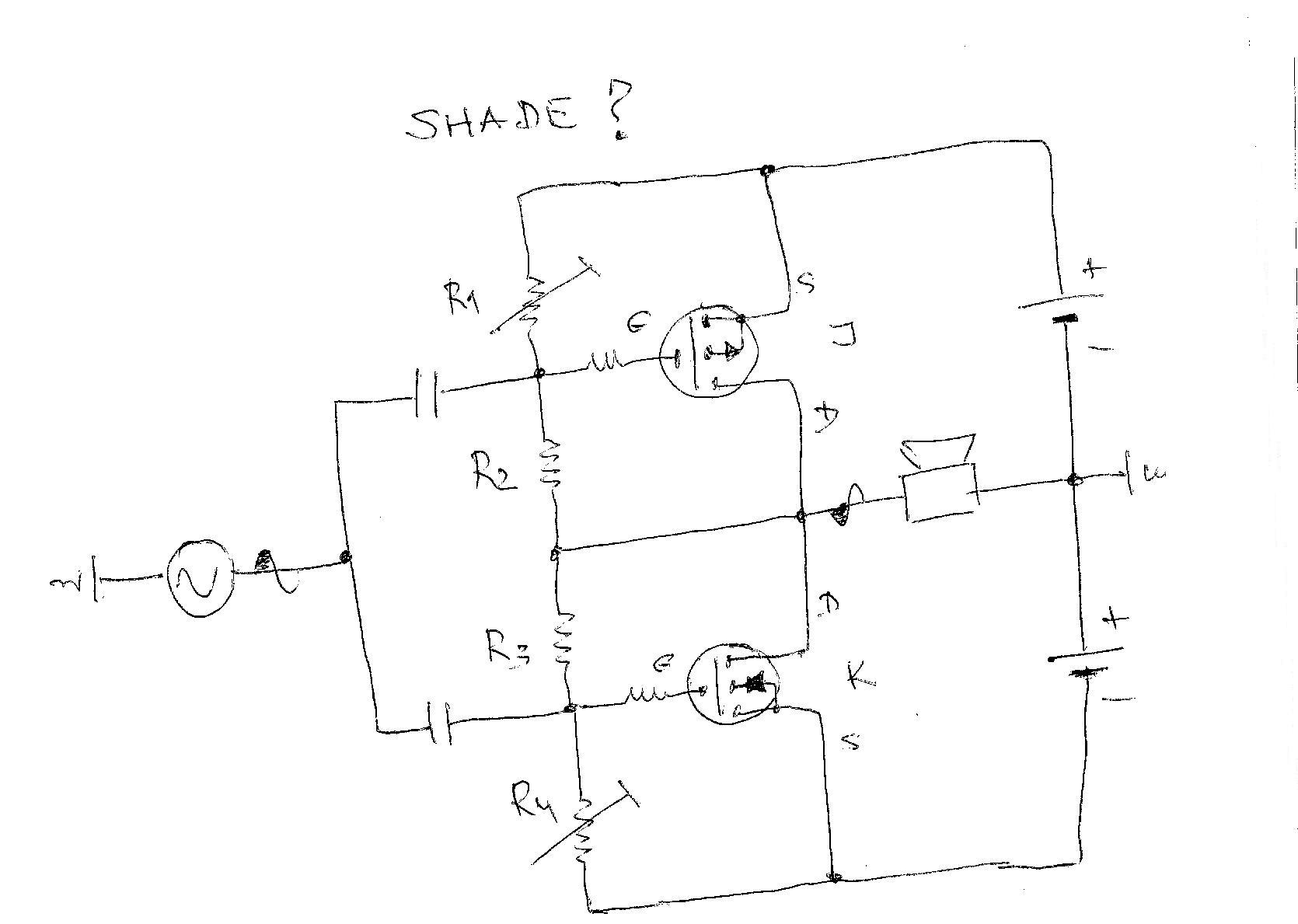

Nige and other members what do you think about this simple(simplified) complementary power bridge , is there Shade Fb or not?
ps, if moderator find that this post is off-topic it can be deleted , no hard feeling from me.🙂

I have seen that used with a ECC88 driver stage I think. One idea I had was 500V cheap IRF MOSFET's in LTP. It sort of feels right if any LTP is right. Off topic isn't a problem if it looks to return to the topic. Mostly how to find the Schade Window.
Having given it much thought I can imagine in some ways Schade is the better feedback if it really did cure the weakness of the 807 over lets say a 2A3 circa 1937. That is to be most like a triode whilst having gain or impedance advantages. I could imagine Mr Schade was dubious about UL feedback. Not least as the output transformer designs would need to change to take advantage of how it could work. It is a bit of a black art to get it to work. I have recently hit a brick wall with a mains transformer design. The guy at the transfomer company was a bit shocked I solved the problem. I did it at very reasonable price also, regulation being 50% better than off the peg designs. I just pretended it was an output transformer. It's only downside is size which I sort of like, Big is Beautiful.

That inverting SS (Lat-Fet) power bridge can be driven in several ways , here`s couple simplified examples how that can be done ,
in fig.1 VAS/driver tube can be Ecc88 or even better Russian triode 6c45p ,
in fig.2 VAS/driver tube can be Ecl82 or similar triode/pentode tube , where triode part is VAS stage and triode strapped pentode part is buffer/ low output impedance driver tube .
from many reasons I prefer solution from fig. 2
