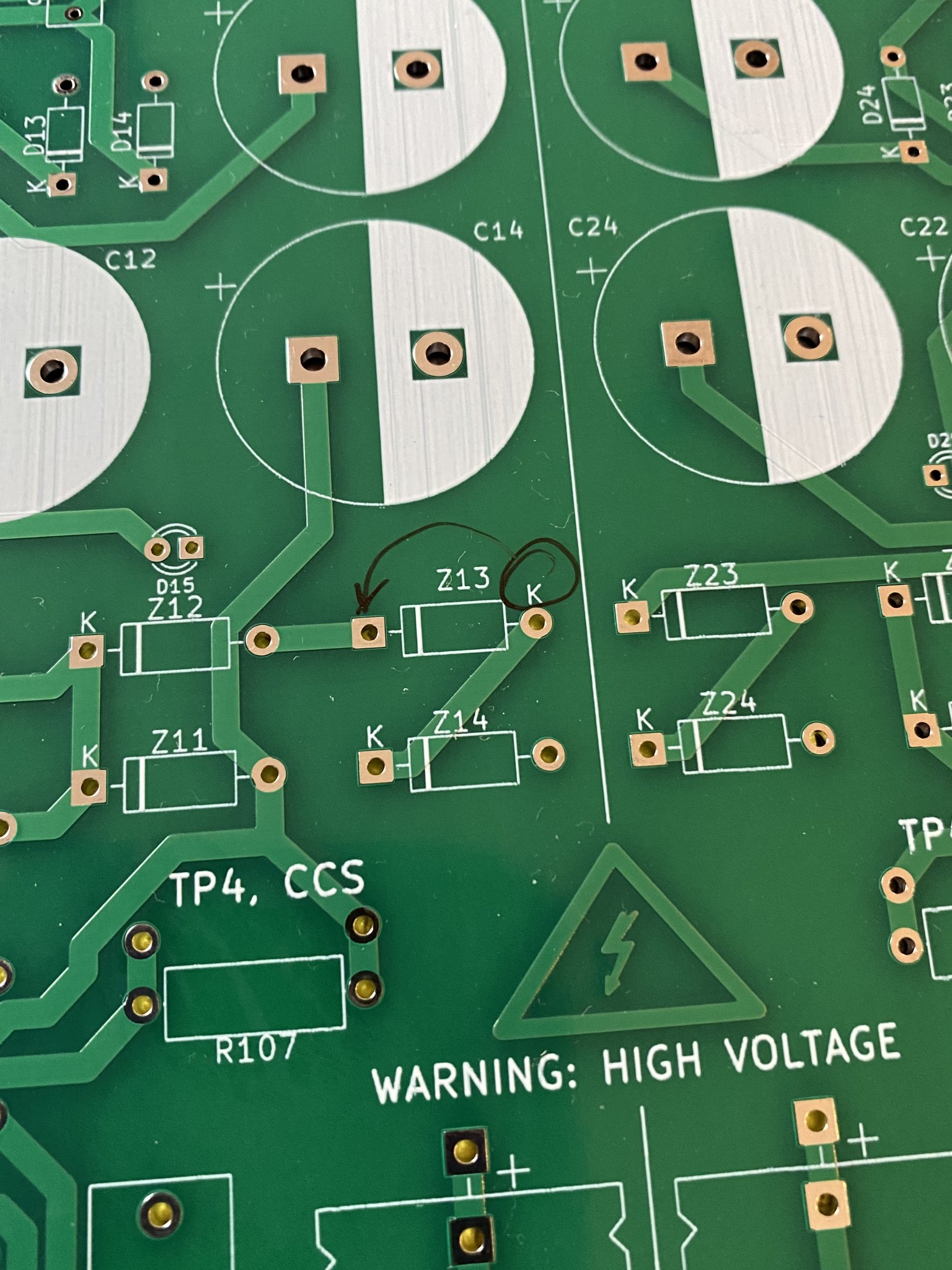

On the parts list there are different values for the zener string for "left" and "right" channels. I decided to meet them in the middle with 116 volts. (I got my zeners before the list was published)
There is a misplaced K on the circuit board for Z13, I think it is. The band markings are what matter, anyway.

Vunce, Thanks! Wow, not sure how that happens because that label comes from KiCAD. I will add it to the fix list.

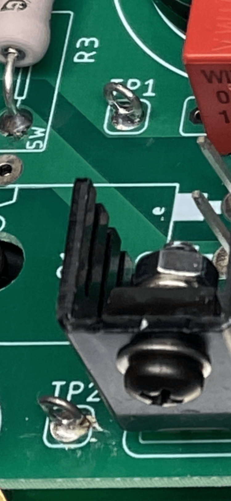

I am going to use lengths of wire in the TP holes to make the ZM approved solid connection with the test points and allow 3 meters to be used easily.
I figure 18 gauge solid wire is the biggest one could use but I do not have any so am asking before I buy some.
Is that as large as it will accept?
I do exactly the same thing. In fact, I have a collection of cut off resistor and cap legs, ready to be pressed into action.
Hole size is 1.2 mm. Hope I'm reading that right. Edit: yes, it is 1.2 mm, just measured.
