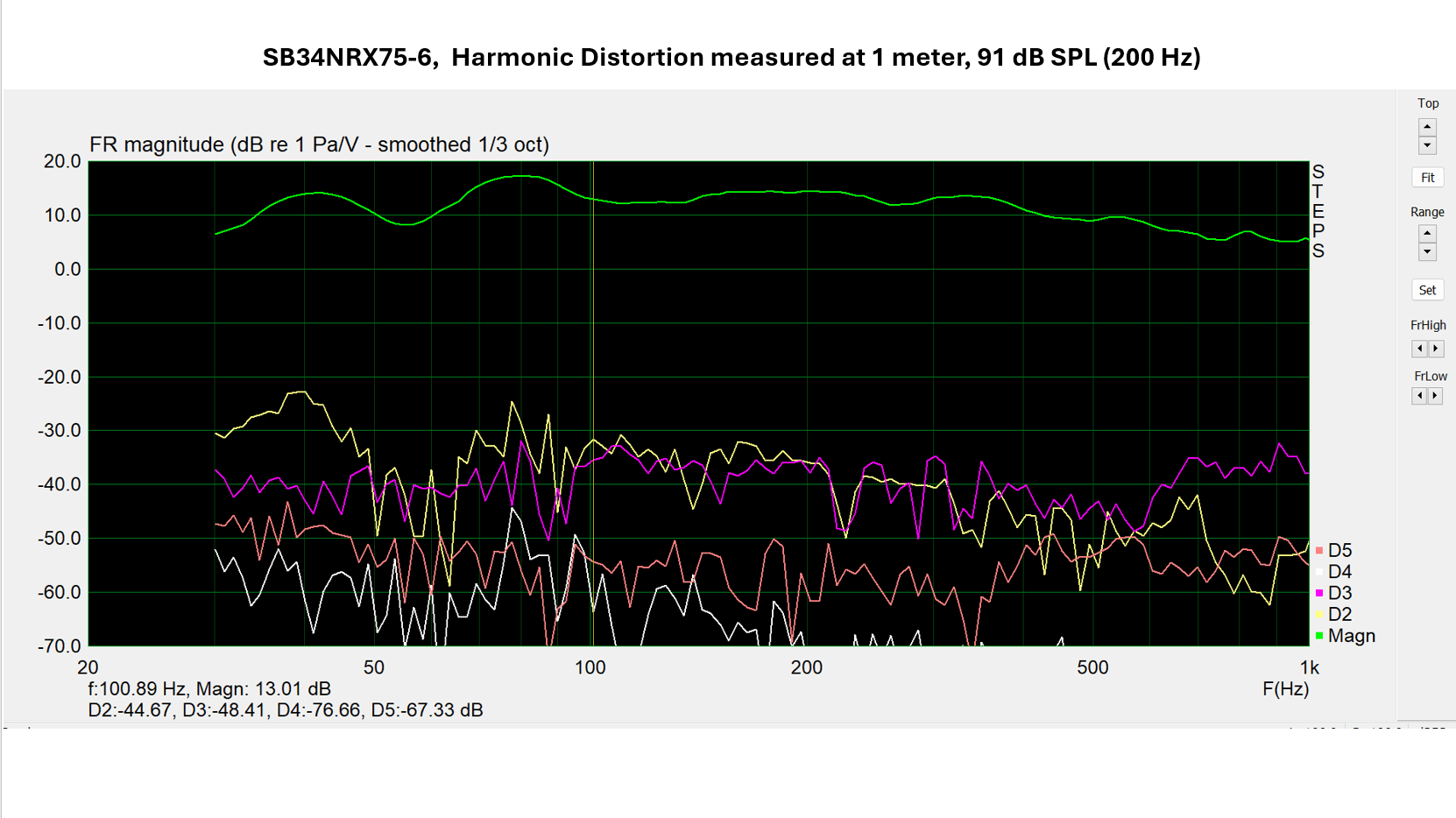

In @IamJF 's other thread, I mentioned that I wanted to test my SB34NRX75-6 drivers for distortion, to compare to these measurements. This seems like a logical place to put that information.
The SB34NRX75-6 is similar in many ways to the woofer that @IamJF tested (SB34NRXL75-8). But one crucial difference is that the NRXL driver has a superior motor with Faraday shorting rings.

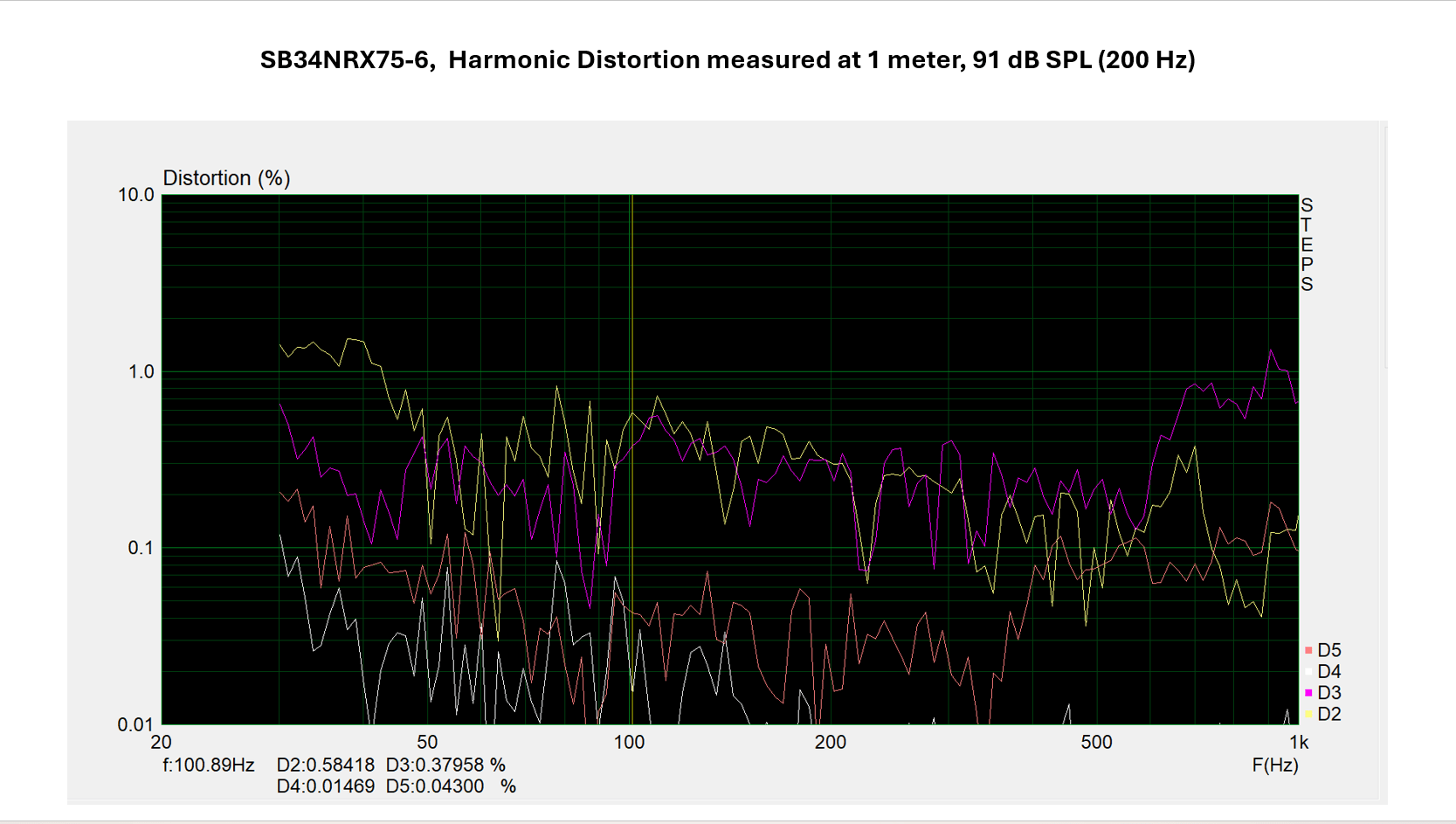

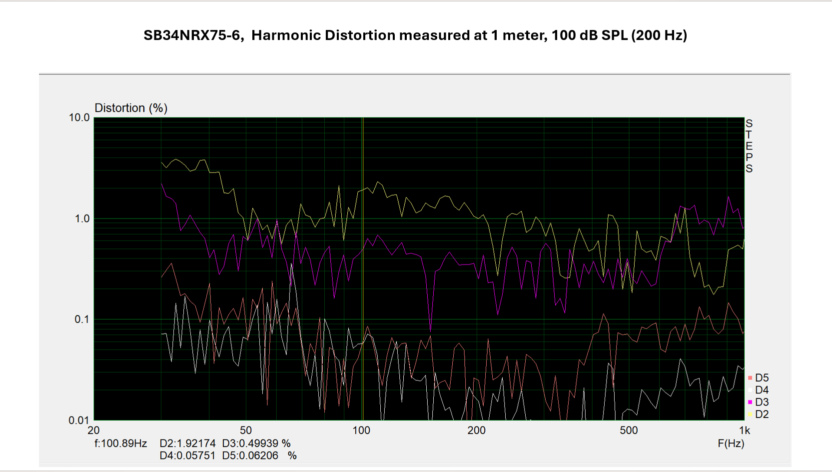

I tested my woofer at two different levels, 91 dB SPL and 100 dB SPL, measured at 1 meter at 200 Hz. I used an Audix TM1 mic, a Motu M2 interface, and the ARTA STEPS software. I ran sweeps from 30 Hz to 1000 Hz. I could not go below 30 Hz because the excessive buzzing and rattling of the windows and other stuff in the house corrupted the measurements.
Here are the results:
I have not fully digested this data, but one thing that I noticed is that above 100 Hz, H3 H4 H5 do not change much from 91 dB to 100 dB. Only the benign H2 rises with total SPL.
I will have more to say about this data later.

My personal guidelines regarding harmonic distortion are this:
At normal "peak" listening levels, I want H2 to be less than 1% from 100 Hz up. For my main system, this is 95 dB SPL.
At normal "peak" listening levels, I want H3 to be less than 0.5% from 75 Hz up.
I want H4 and H5 to be less than or equal to H3.
So from my standpoint, this woofer meets my requirements.... but I am curious about the SB34NRXL, so I may have to get a pair...

Thanks for contributing!I have not fully digested this data, but one thing that I noticed is that above 100 Hz, H3 H4 H5 do not change much from 91 dB to 100 dB. Only the benign H2 rises with total SPL.
That's about the behaviour of the 10" drivers - they have some H3 which doesn't change a lot over level. This is no problem for low frequencies but I would not use them with higer rossovers in a 3-way. NRXL version doesn't show that behaviour and has lower over all THD and higer sensitivity at higher frequencies (= strong enough motor).
So for a 3-way ... you may have to get a pair 😉
And I forgot to ask- is this a ground plane measurement?
I made the measurement on-axis with the woofer in its standard loacation, which means the mic and woofer were both about 16" above the floor. STEPS is not a gated measurement, so there is no way to avoid room modes being part of the response.
