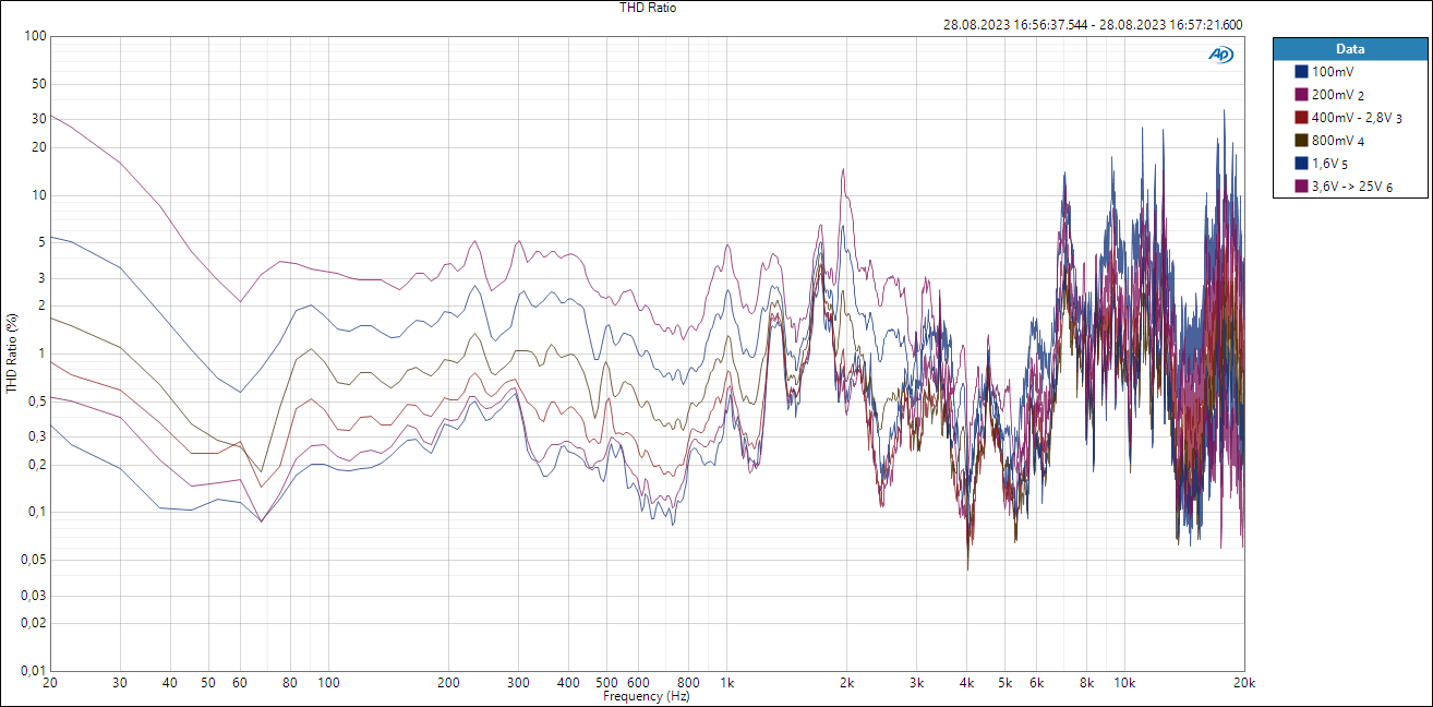

Let's continue - SB23MFCL45-8. Don't forget, that's a longstroke, heavy membrane subwoofer chassis. I'm still interested how it looks up to 2-300Hz for my next project with this chassis.
The prototype housing I had on hand had a to small baffle hole - so the driver is mounted with the magnet outside! Don't take frequency response at higher frequencies to serious, there will be an influence.

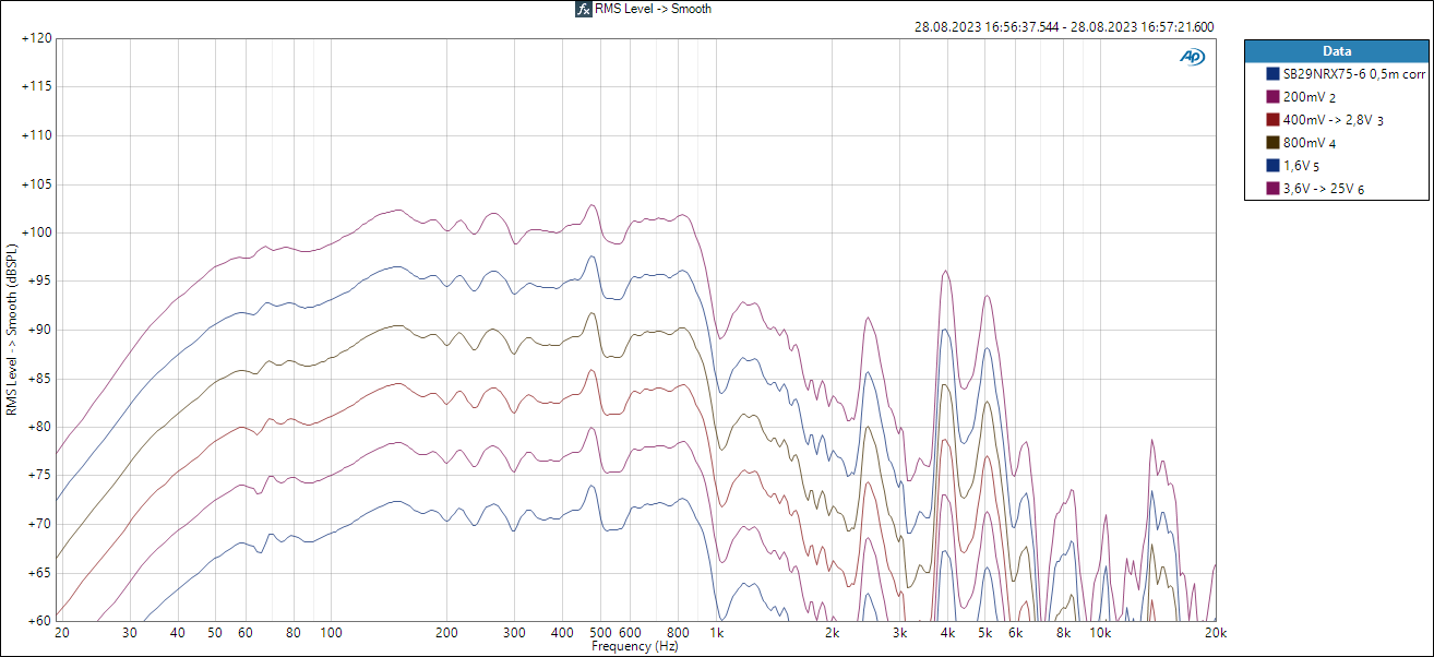

While doing some wobbling to prepare the chassis I detected a liiiittle noise when swinging free air. That's not unusual, just the other dirvers are really dead silent till pretty high excursions (normally at 10Hz - so you only hear noises and higher THD).
THD is not Purify level but very good for such a heavy membrane long stroke chassis! SPL level <100Hz is 2-3dB lower as with the 10" chassis, keep them in mind when comparing THD curves - these are not level matched!
Still - THD at 30-80Hz is very good.
Volume was about 24L with sheepwool inside and magnet outside - plenty for this driver.
Looks good to me. L is changing with excursion/power at higher frequencies - High End chassis do better.

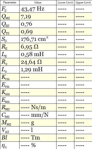

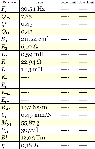

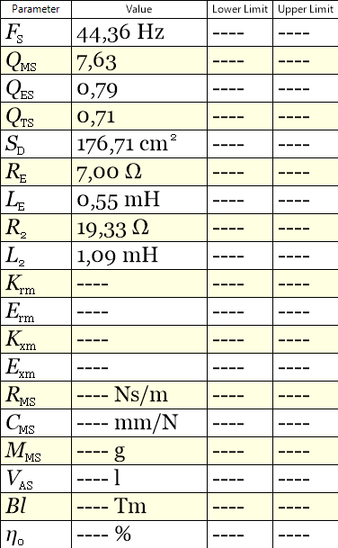

I did some TSP measurements. Small signal, very little exursion of the membrane. Added weight, 40g of blutack. I forgott to measure DC resistance per hand and not let the programm estimate it - so I redid all the measurements ... 😏
The 10" brothers. left 6R, right 8R.
That's pretty different as the datasheets. Looks like pretty the same speaker just with different coils resistance. As I guessed after looking at the measurements. Q is very often higer when you measure as manufacturers tell us - also the reason I have higher Q in the subwoofer housing. But nothing dramatic her.
SB Acoustics wants to tells us Mms of 78g and 59g for these drivers. When someone bets for a few hunderd bucks I get out the knife and measure 🤓
but I would say these are pretty similar and not 20g different.

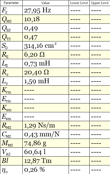

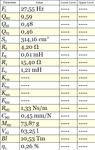

The 8" long stroke:
This fits nicely to the datasheet! Just with less Vas. Looks pretty good for such a long stroke chassis. Qms is pretty high.

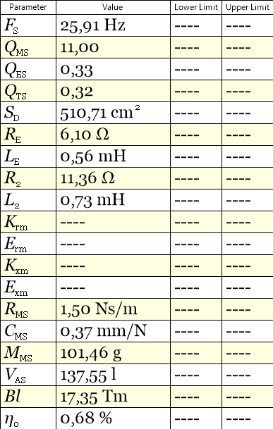

One TSP is missing. I can't unscrew the actual SB34NRXL75-8 cause I need it for my experiments. But I quickly measured a brand new out of the box one - better as nothing.
All these drivers seem pretty similar. Qts is lower with this one - as expected. Mms a little heavier, Vas smaller. SB Acoustics seem to measure different as I do 🤓 . Bl is a lot higher with this driver! Btw they are pretty conservative with their Sd - I would have measured more with the "half surround rule", esp. with the 8" but I used a value similar to the original datasheet, they probably know better?
