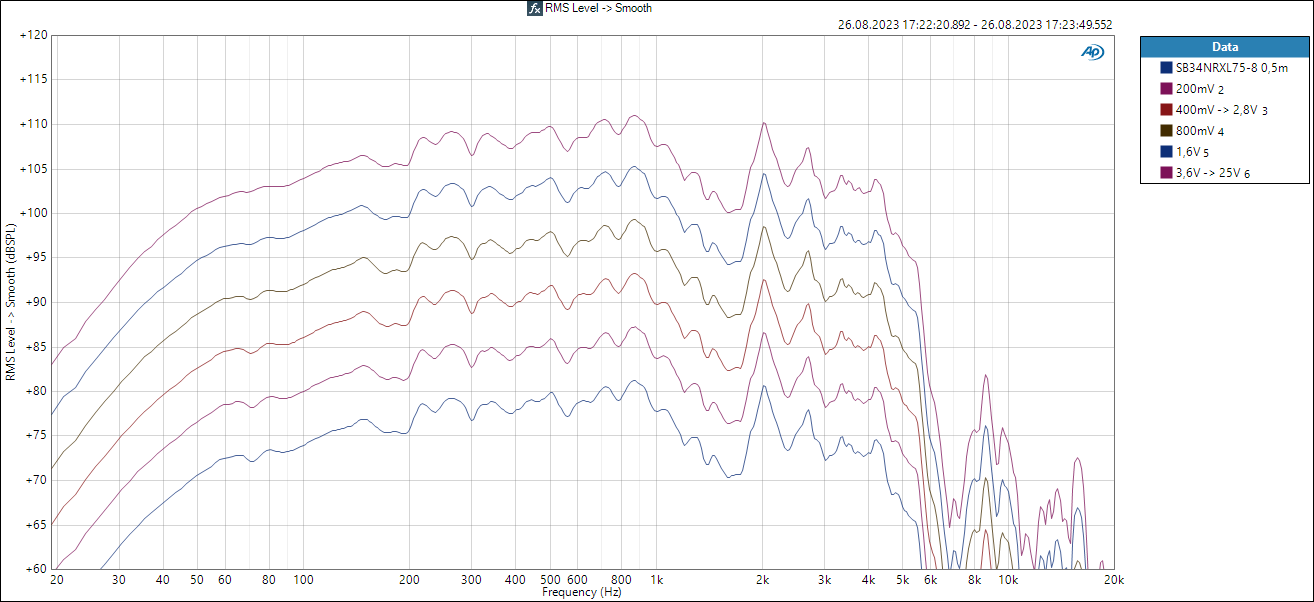

First SB34NRXL75-8. One of the best drivers I know, especially for that money. Very good use for a 3-way but could also be a subwoofer.

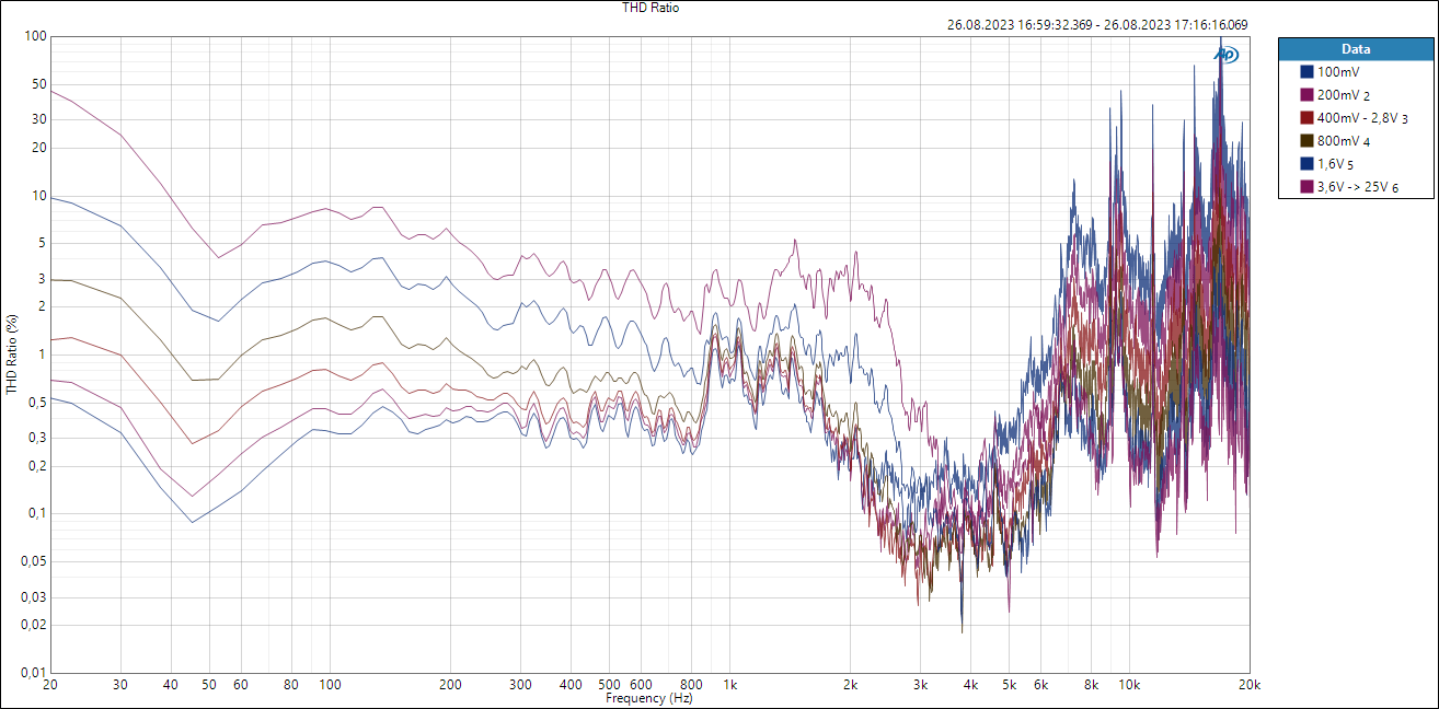

THD is incredible low - 1% at 105-110dBSpl! I use 2 of them in my new speakers ... that's enough for most rooms ;-)

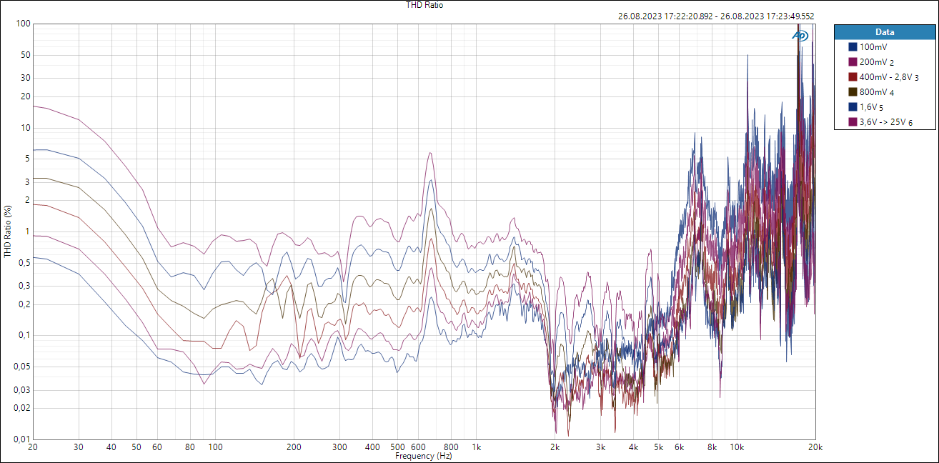

Also 0,05% THD ... not often I measure that with a speaker!

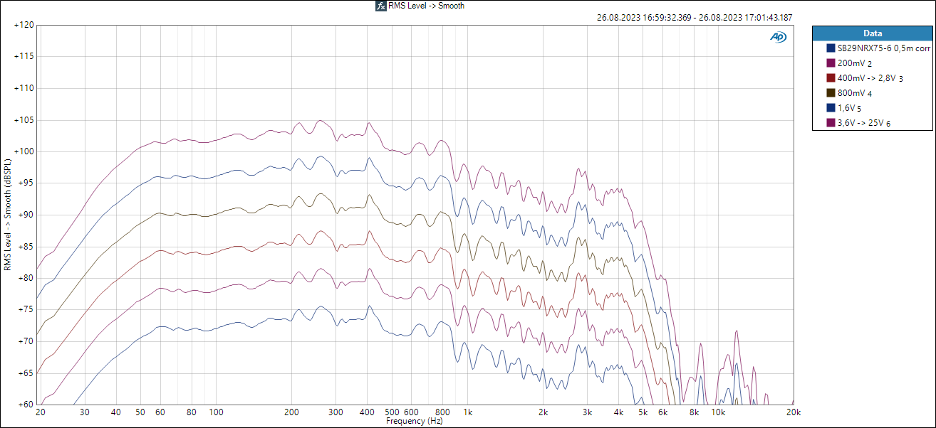

Now SB29NRX75-6. My goto chassis for closed subwoofers, put 6 of them in my homecinema as SBA. Not expensive, doesn't need a big volume, not to heavy membrane, huge venting hole, 75mm coil, not to heavy membrane, noise free Xmax.

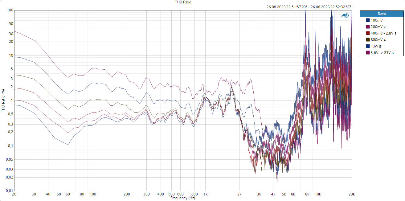

Frequency response already shows us this is no midrange chassis. THD is good at low frequencies but doesn't scale as it should at low levels! I know this behaviour from PA chassis, didn't expect it here. No problem for a woofer - but I would not use it up to a few hundred Hz.

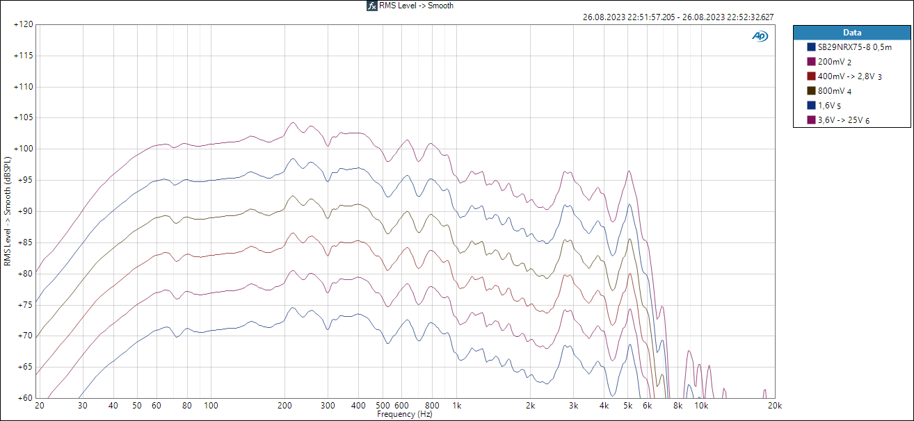

And now the SB29NRX75-8. I expected something in the middle between these 2 according the datasheet - a smaller and cheaper alternative to the 12".
Nope - that's not what I need for a low mid driver. The same THD behaviour - it looks like about the same driver just with higer impedance coil.

I never measured the Volt driver. The measurements here show pretty high THD and H3 peak at 210Hz which corresponds with a peak at 600Hz:
https://audioxpress.com/article/test-bench-volt-rv3143-studio-monitor-woofer
Audio Express measurements are a little "special" but when true it would not be ideal. Also Xmax is lower. But I really like the construction of these Volt drivers!
