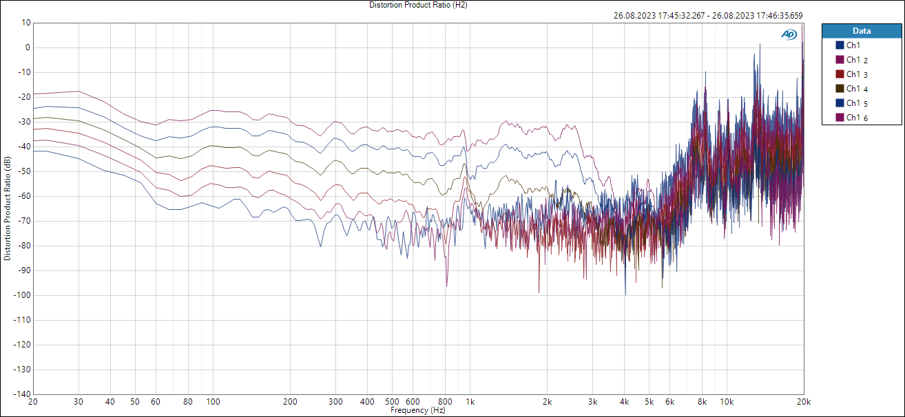

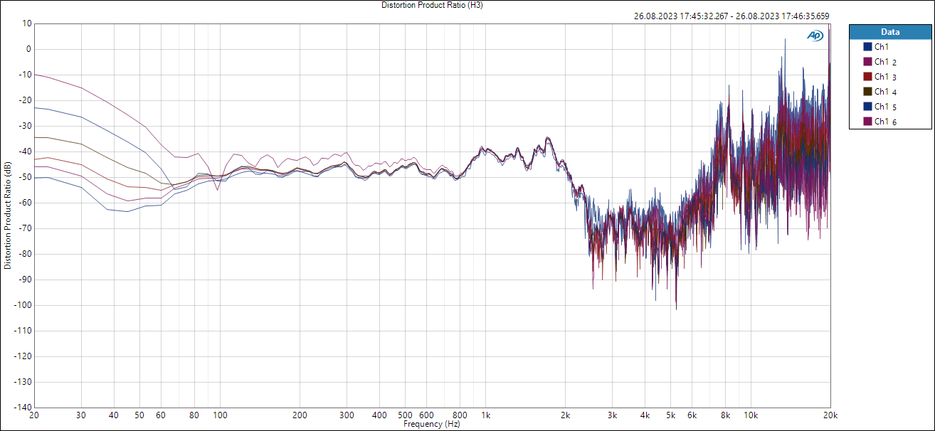

Of course I don't stop with measurement results like these ...
Here H2 and H3 from the SB29NRX75-8 (good I whish for an easier name for these drivers after typing it 30 times today)
H2: looks good and normal.
H3: Opps. Only starts raising at very high levels and causes the higher THD at low levels.
It's still not horrible - that's about 0,5% THD. But some part in this driver produces "symmetrical" limitation. (like soft clipping, peaks of the positive and negative wave seem not perfect)
SB Acoustics - are you reading here? What's going on?

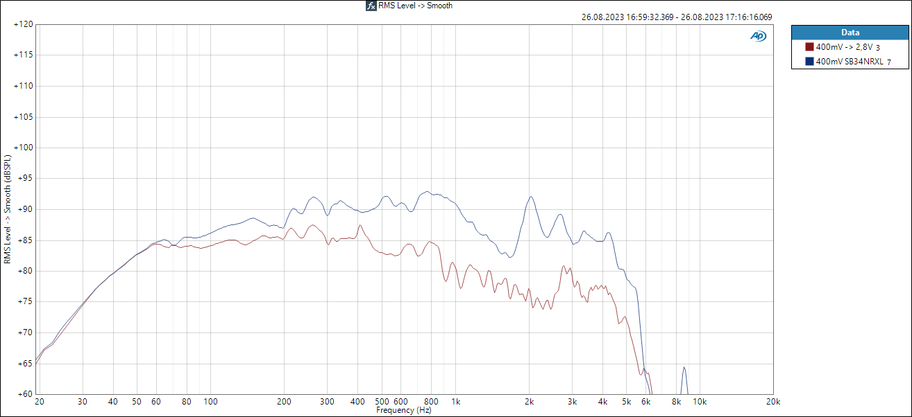

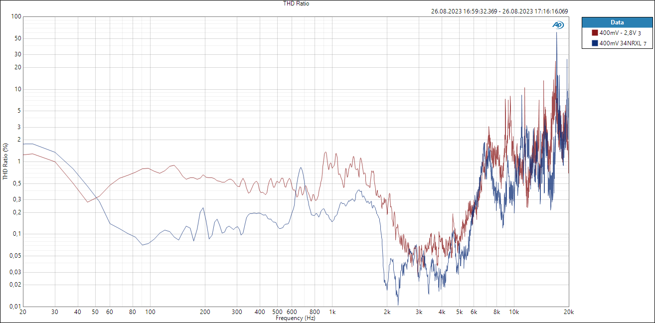

And a quick comparison of SB29NRX75-6 and SB34NRXL75-8. About 2,8Vrms at the drivers.
The 12" has the magnet strenght to be a proper midbass driver. But don't use it over 5-600 Hz! I use them with the Bliesma 3", works fine so far.
At low frequencies you don't gain sensitivity over the 6R chassis. So for a passive design all of this sensitivity in the mids doesn't help a lot - but would be perfect for a 3.5 system.
THD ... that's the difference between a state of the art driver and a normal, solid driver.

@IamJF The almost tenfold reduction in THD according to your measurements is quite impressive with the NRXL version. It does have some of the cleanest lower mids of any hifi 12" driver I've ever heard and it costs much less than comparable performing drivers.
The only negative thing about it is the 700 hz spike in HD and a kink in FR, but that can be easily avoided.

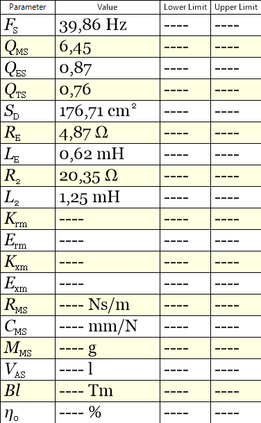

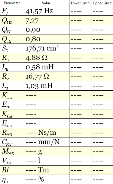

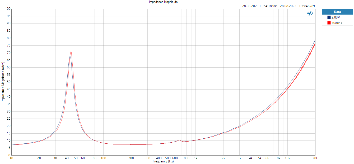

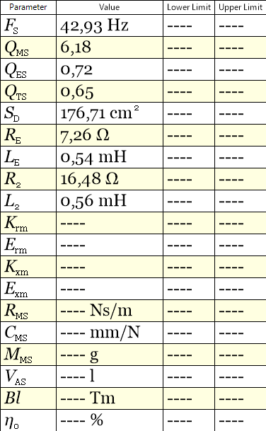

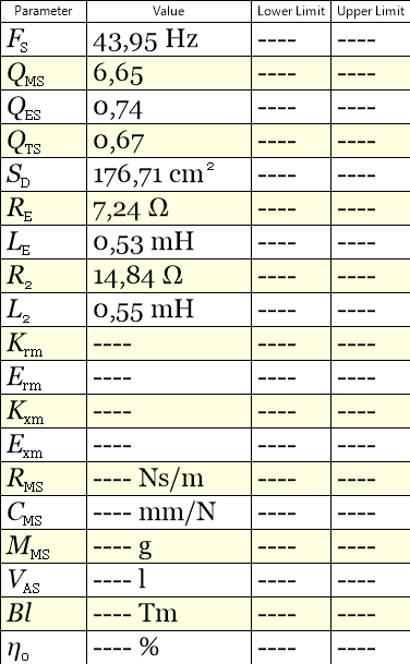

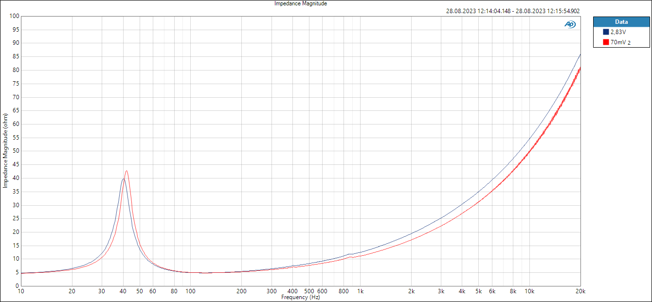

In box impedance measurements. Both speakers didn't run very long but should have enough for break in.
SB34NRXL75-8:
You see the impednace hump at about 650Hz - keep away from this area. I would say that's a surround resonance or something similar caused from the low loss surround (Qms is very high for such a driver). That's the price you have to pay for low losses. These dips are way less critical as membrane resonances but of course still to avoid. Qts is stable compared 1W vs. small signal.
SB29NRX75-6:
Impedance is clean, little hickup at 860Hz. Qts is a little higer - wanted to stay with the small volume. It goes down btw with higher excursion - I normally measure these speakers with a realistic wattage for real listening, but these numbers then don't line up with manufacturers.

SB34NRXL75-8:
SB29NRX75-6:
