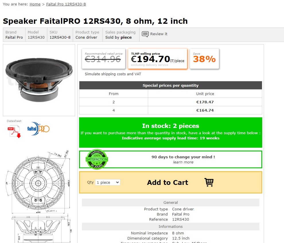

did you see it : https://faitalpro.com/en/products/LF_Loudspeakers/product_details/index.php?id=151050115 ? Vas is not so high relativ to SB or SS.
12RS430, models well in 80l BR 28Hz. Almost 300eur + need to manufacture the trim ring to hide the foam basket.
