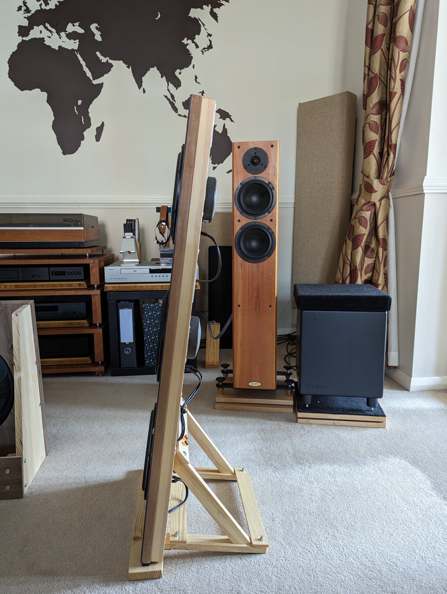

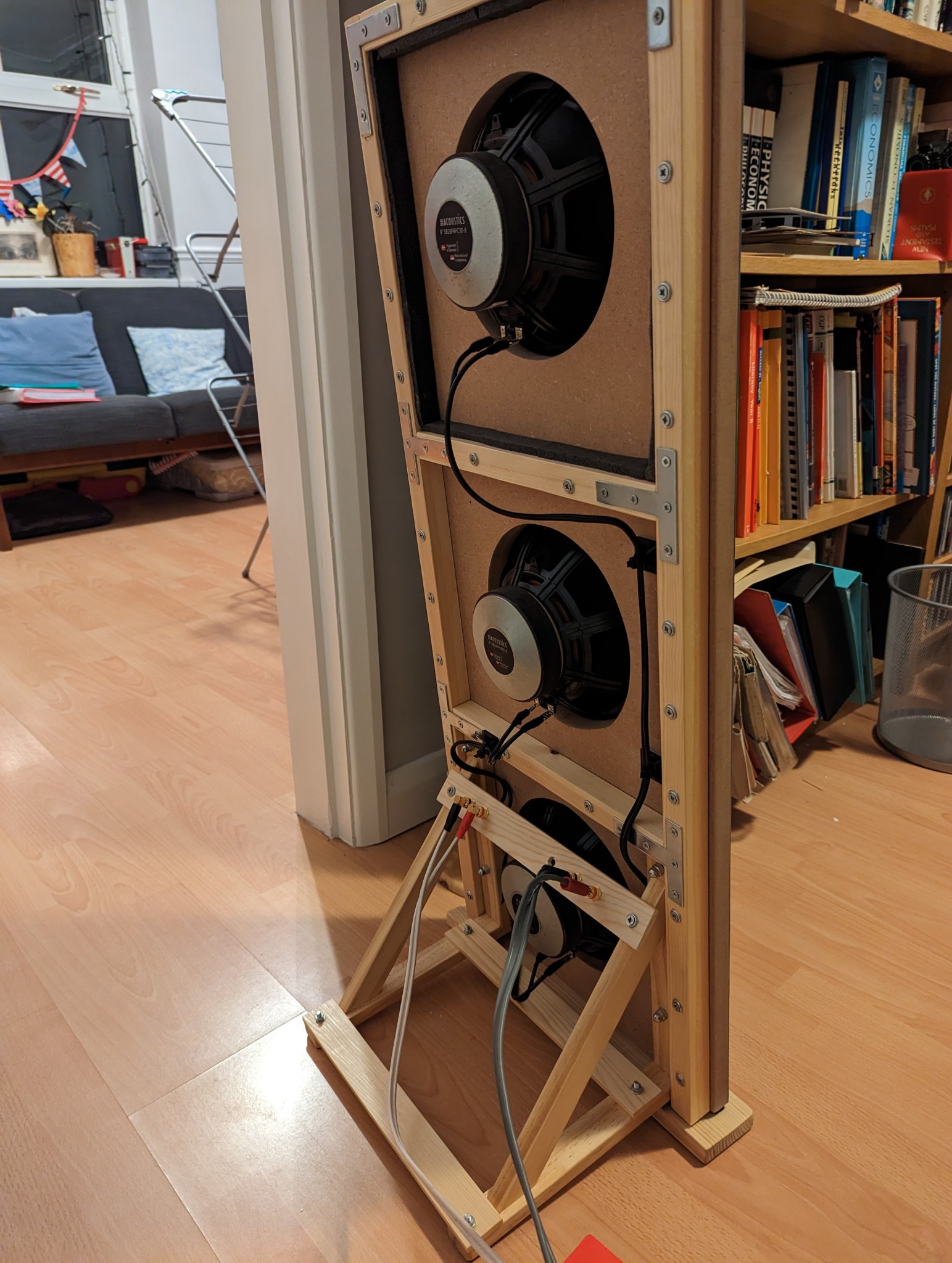

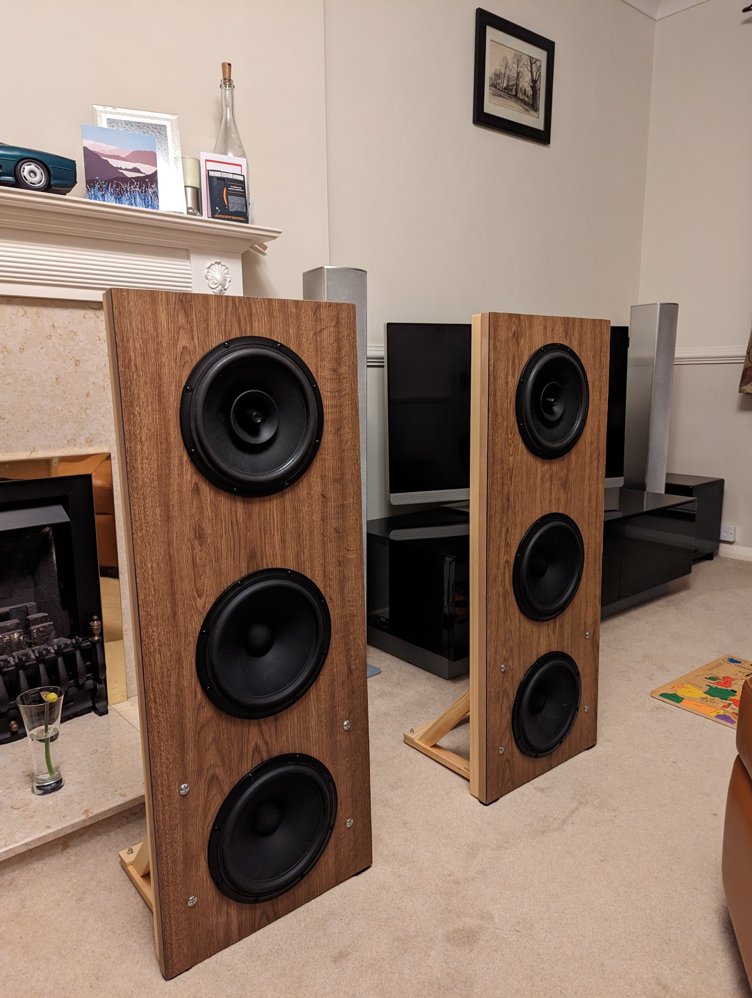

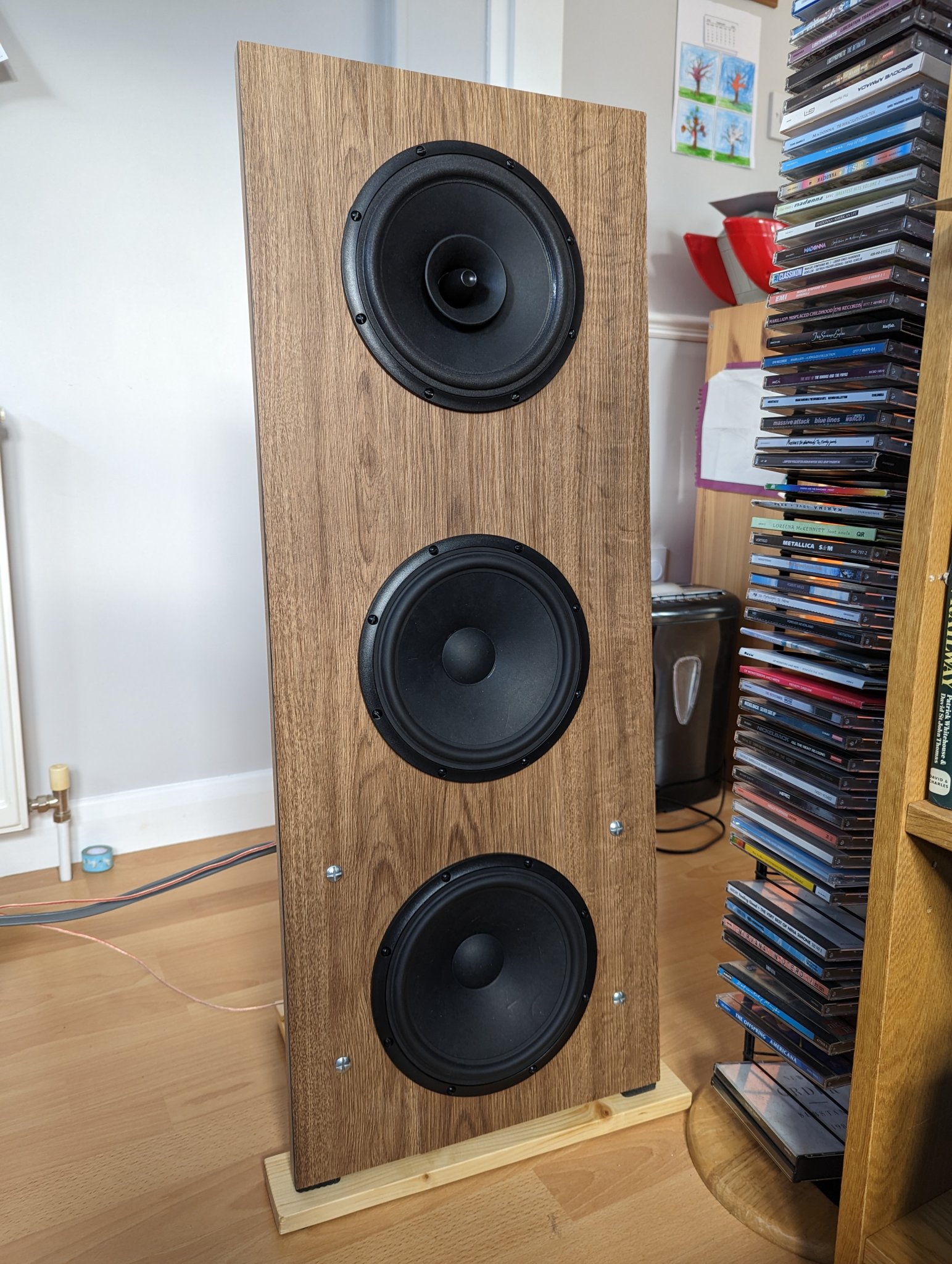

A few updates since my last post.
First I changed the baffle from pine to a slightly smaller version made from 18mm MDF and 'finished' with self-adhesive vinyl flooring incorporating a 2mm rubber layer - has resulted in much better looking (IMO) speakers that are acoustically more inert.
The most recent step was to add 2 x SB Acoustics SB20PFCR30-8 wired in parallel in each baffle. Myself and my son fitted them on Friday night and they are actively driven (in stereo) and low passed at about 130hz with a 12db slope.
These speakers no longer need any bass support from sealed box woofers and they have a lovely, tangible bass that sounds very much like real instruments. They produce excellent punch at low amplifier settings in the small office. Eventually they will be in a room twice the size (circa 3m X 5.5m). If need be I will run a pair of SB Audience Bianco OB 12s or even 15s in H frames off a plate amp to add a bit extra in the larger room.
I've tested them (full range driver only - no passive crossover) with an Arcam A18 (now set to flat) and an AVA Media Maestro 50 that produced great results. As said, the woofers are driven actively so just require slight tweaks with a room/amp change.

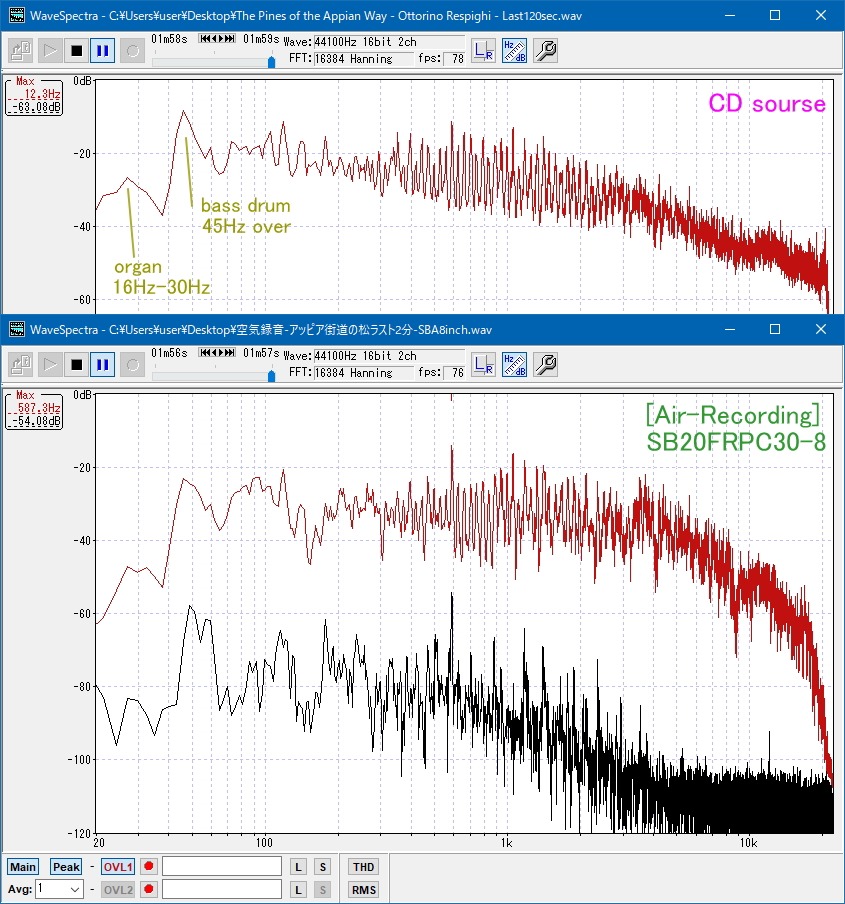

Having finished aging the SB20FRPC30-8, I made an air recording of "The Pines of the Appian Way (last 2 minutes) - Eiji Oue".
Compared to the spectrum of the CD source, the sound pressure is at best up to 70Hz, which is the same level as the mid and high range.
The response is up to about 30Hz, but the sound pressure is about -15dB at 45Hz, -20dB at 30Hz, and -30dB at 20Hz.
I think this performance is sufficient for an 8inch full range.

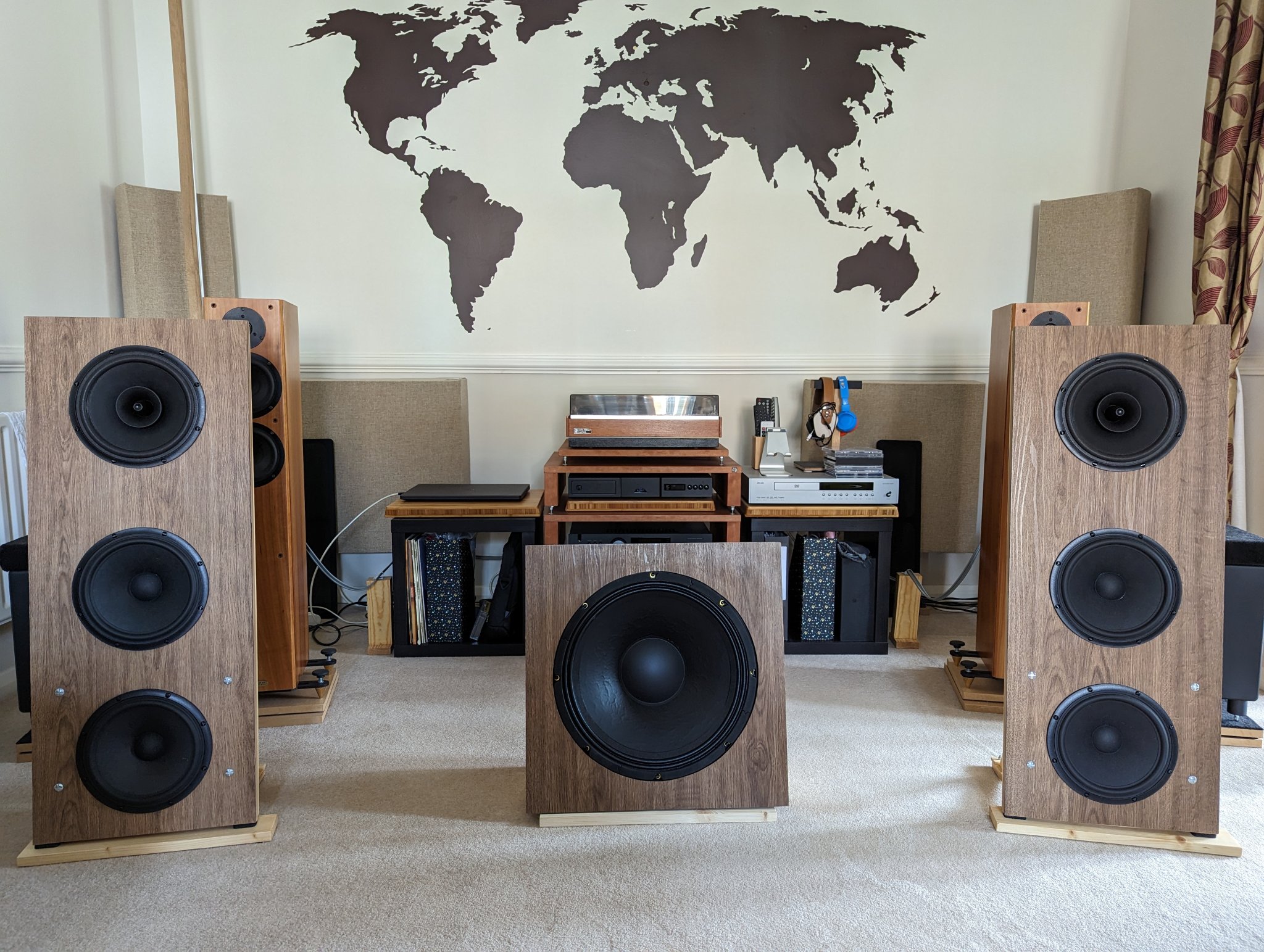

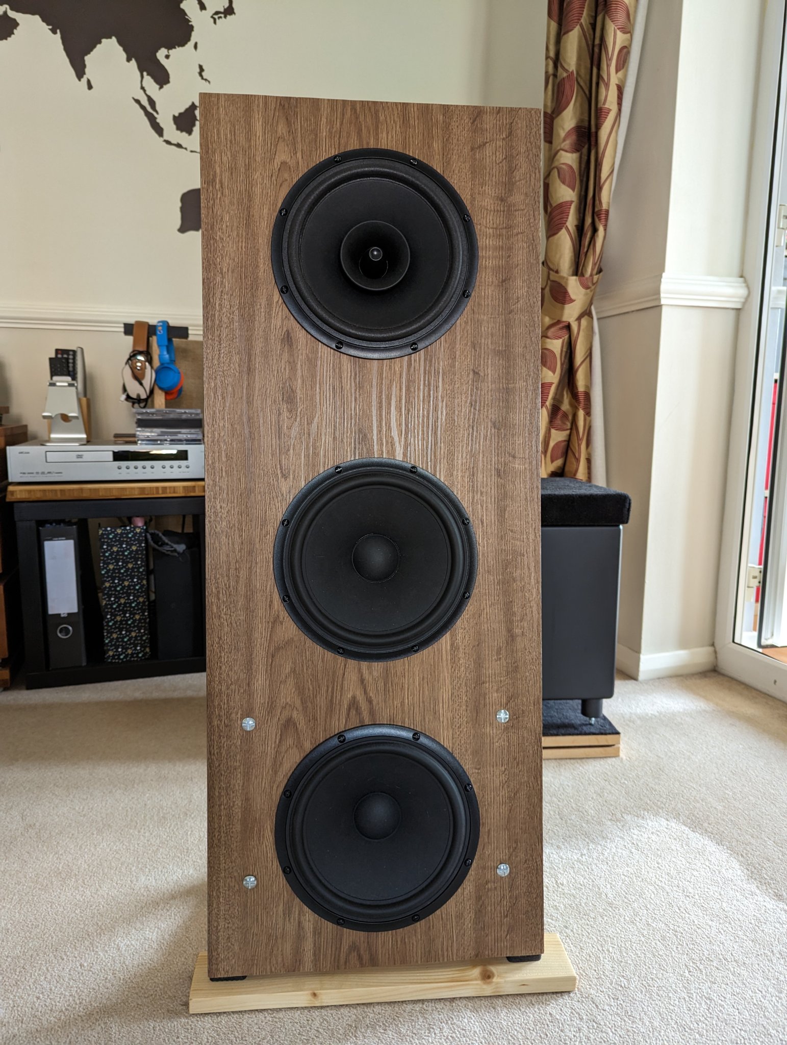

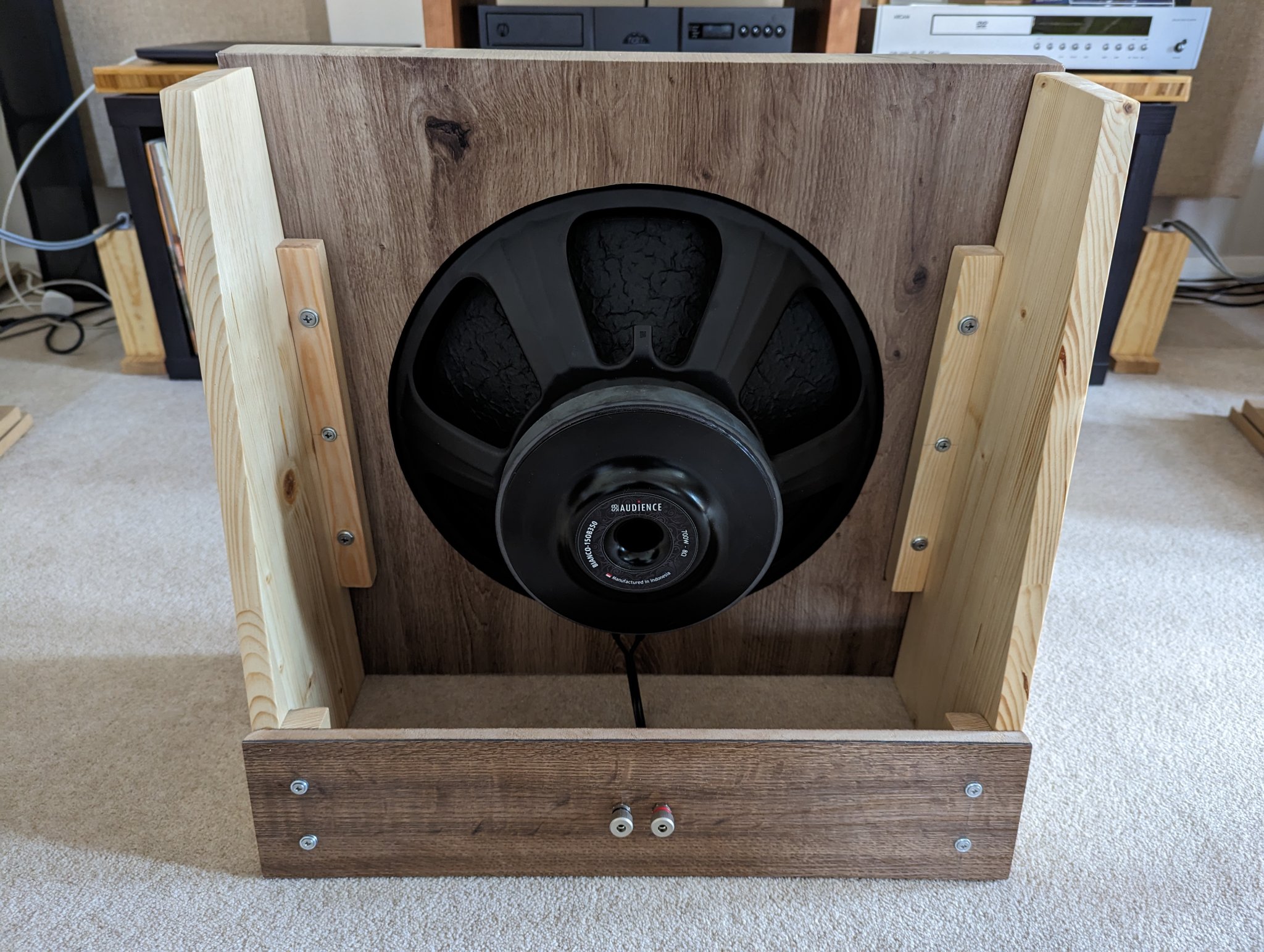

The speaker part of my OB project with this driver is finished: I've added an SB Audience Bianco 15OB350 in its own baffle with small side wings. In combination with the existing 'towers' the system fills the room (7m X 3.5m approx) effortlessly.
Bass response is strong and 'large' - to use a car analogy it's like the big driver produces lots of torque. Of course, this all helps higher frequencies too which sound very clean, and natural with excellent tone and body across the frequency range.
Everything is fully active using 5 channels of amplification (stereo amp + 3 desktop sub amps) which I'm sure helps, as does the sensitivity of the driver's.

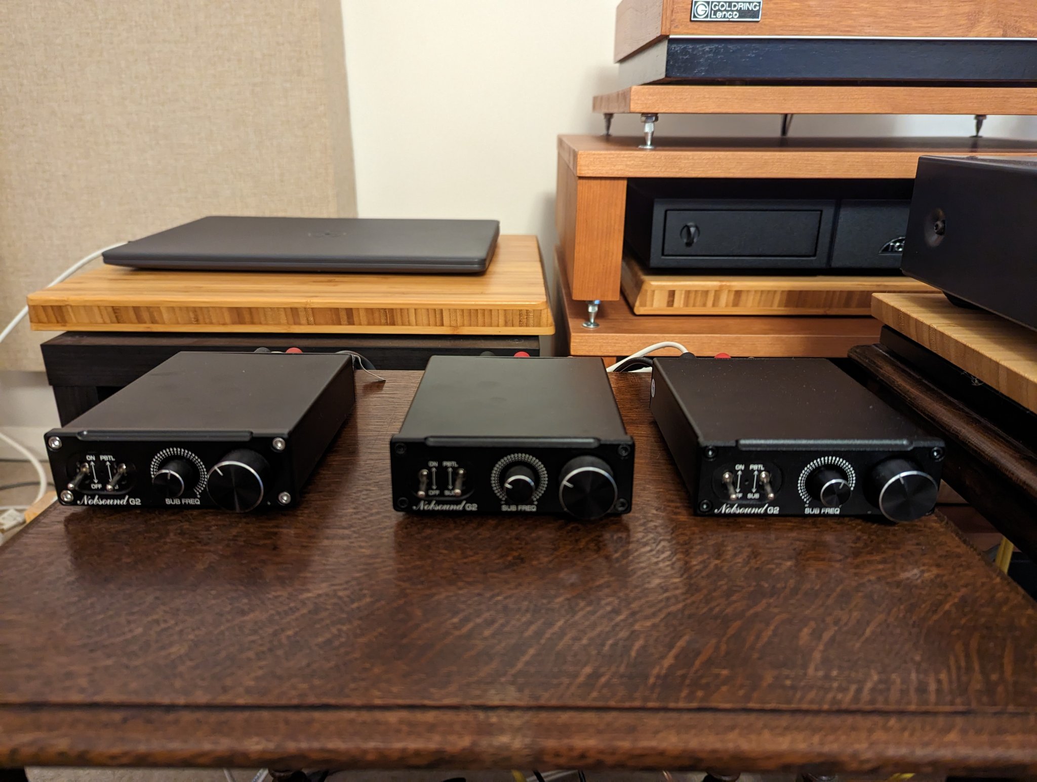

It's a fair question. The FR drivers do not have any crossover at all. When I did my measurements with the app I found that their response only started to drop off below 200hz due to the OB design. Research into OB bass loss indicated that this is correct given the width of this particular baffle. When run on their own they are clearly very bass light. Being an 8 inch driver they don't seem to need any protection from low frequencies (a smaller driver might need this).
The lower woofers have no passive crossover, instead each G2 amplifier has a variable crossover (40 - 300 Hz/12db slope), variable gain (set by dip switches) and adjustable volume. I currently have this set at roughly 150 - 160 Hz so for the SB20s. The Bianco, on its own amp, is currently set at about 55hz but I'm adjusting that.
The advantages of this set-up are:
1) I can adjust things to experiment and also to different rooms and stereo amps powering to FR drivers.
2) no efficiency loss due to a passive network.
3) I'd need to have more knowledge than I do to design a set in stone PR network.
4) any crossover that there is operates low down the fr range.
I considered investing in a mini dsp type set-up (I still might at some point) but, thanks to this particular combination of drivers and the way that OB bass interacts with the room I didn't think it was needed. I also wanted to keep the signal as 'pure' as possible and retain the ability to swap around the stereo amp powering the FR drivers.
Hope that helps.
I have attached an image of the amps. The middle one powers the Bianco. The other two the SB20s. I have also just ordered a high current 12volt power supply so that I could use my Genesis Four Channel Class A/B car amplifier instead. It has LP crossovers up to 200 Hz on all four channels so I will run it in stereo for the SB20S and bridged mono for the Bianco. It also has adjustable gain for front and rear.
