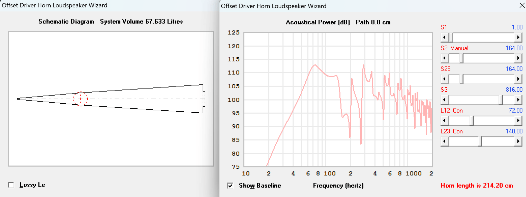

Do you think it might work well in Troels' TQWT ? http://www.troelsgravesen.dk/DTQWT-mkIII/TQWT-mkIII.png
I'm thinking of using it as substitute for the JA8008HMQ

Here is quick approximation in Hornresp (file attached), no filling. Filling smoothes out peaks and dips, more effectively at higher frequencies, and reduces efficiency a bit. this doesnt account for the fold, but it shouldnt have a major effect at the low end:

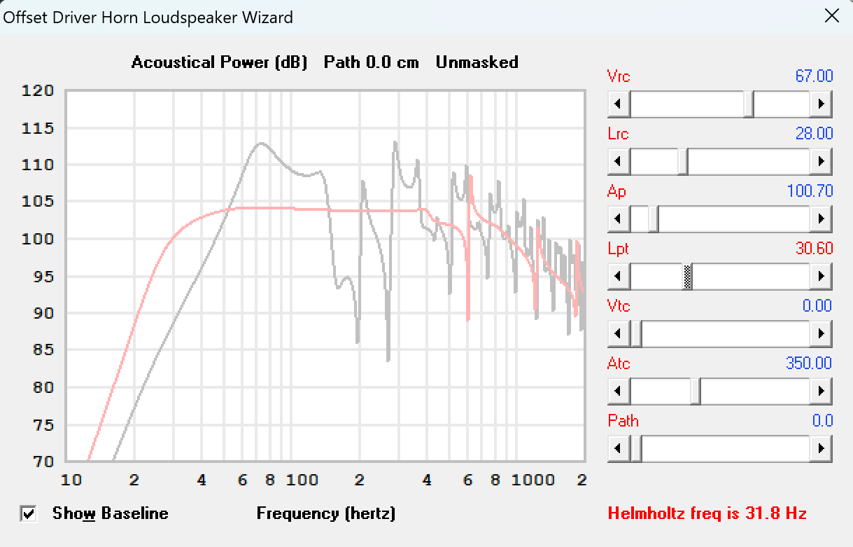

Here is similar volume BR for reference, tuned to 32Hz:
Well, that's pretty bad.
I'd say forget that Troels in this instance, and go for a MLTL, that simulates quite nicely.

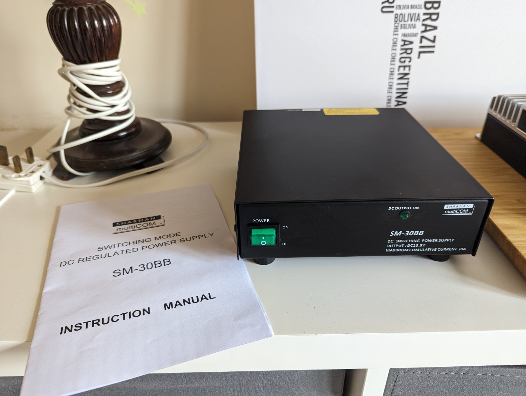

The 12v power supply arrived from Radioworld yesterday afternoon so, as soon as I get a chance to make a stand incorporating all the cabling four the Genesis amplifier I will test the FR drivers using an active HP cut off.

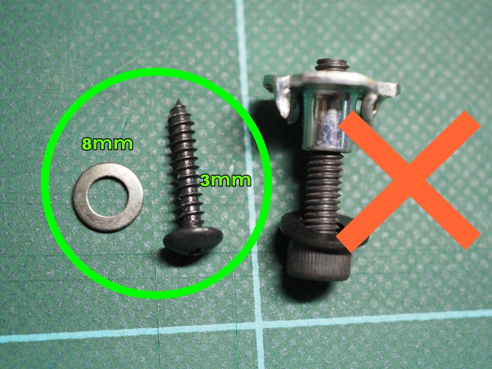

Has anyone had any issues with the plastic chassis and surround? I worried about cracking it with too much pressure from mounting screws?
Annoyingly they're just a few mm wider than my current cheapo 8" so I can't do a drop in replacement to test them.
More bad wood work is called for 😀
I am careful not to overtighten the plastic basket as it will distort.
I use 3mm wood screws.
No issues per se, but yes: don't over-tighten or you can run the risk of cracking the basket, or more likely, warping it out of alignment. Polymer baskets have some advantages over regular alloy / steel unless you really go to town with fairly 'involved' methods of mounting them to the baffle -they usually have better self-damping for a start- but you do need to go a bit easier when fixing.
