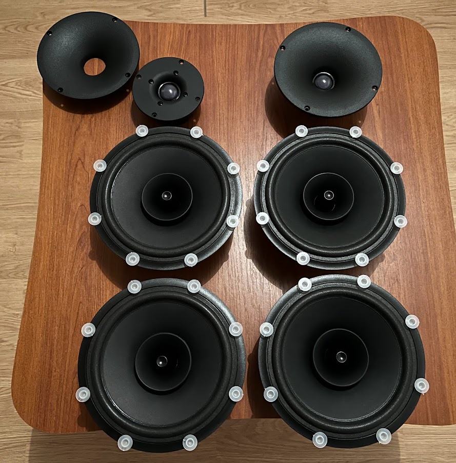

Received my pair from TLHP.
Should I build the ddvp-20?
What would be a recommended box size (and port) for vented?
60-70 liter..Received my pair from TLHP.
70mm port
Go for ddvp-20

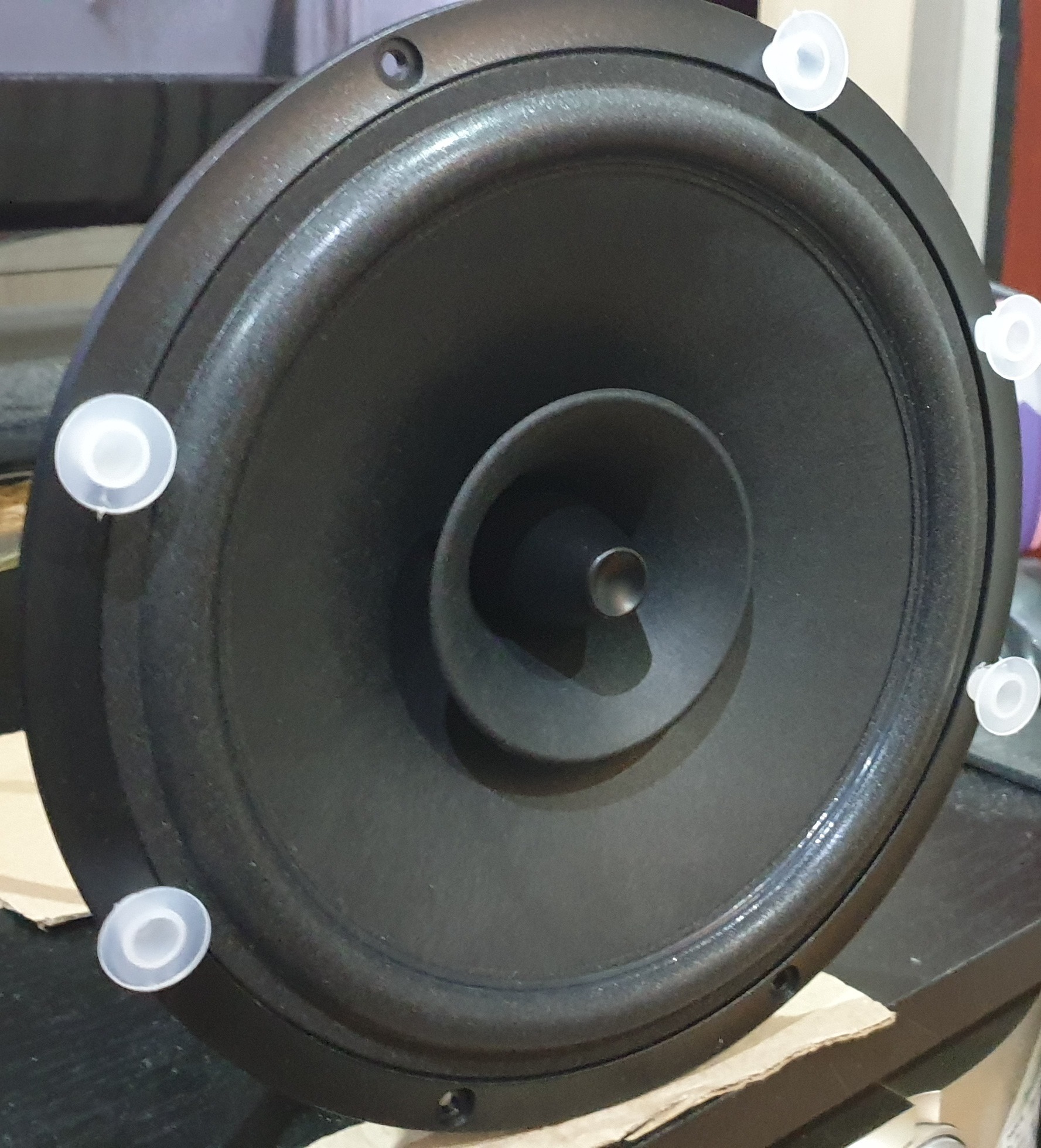

Does anyone think it's a good idea to cut off the whizzer and use it only as midwoofer?
Or waste of money?
Or waste of money?
I have had a pair of them for a few days now and have been wondering the same thing.
It could work but without a measurement setup it would be a shot in the dark.
From what I found the main issue that can arise from removing whizzer is imbalances in the response, typically a huge peak(s).
Examples I've seen were drivers without phase plugs, so who knows how this will respond, is the phase plug designed for the whizzer or will it function about the same?
Also whizzer will be adding some level of stiffness and strength to the main cone, high distortion could arise.
If a fairly balanced response was maintained and no other problems I think removing whizzer and reducing mms could potentially make a very dynamic and snappy sounding midwoofer.
It would probably be a better sounding FR driver too, accepting there may be treble roll off and/or intensified beaming. They are a bit hot on top (I was expecting a lot worse from an 8" FR) treble roll off might work in it's favour while lower Mms may add some refinement at the same time.
Seeing as it's a relatively low cost driver hopefully we will someone xperiment with this eventually.

The whizzer is covering the ~ 3.5 - 9 kHz BW, so not a good plan to remove it and since it's glued to the VC it doesn't add any stiffness, just causes a higher Q peaking at the joint as shown around ~3.5 kHz.From what I found the main issue that can arise from removing whizzer is imbalances in the response........Also whizzer will be adding some level of stiffness and strength to the main cone, high distortion could arise.
FWIW, I almost ~always kneaded the whizzer by hand to literally get the starch out of it and if it got too soft, etc., sounding would use either super cheap lacquer hairspray or airbrush however many mist sprays of Dammar/whatever to suit.

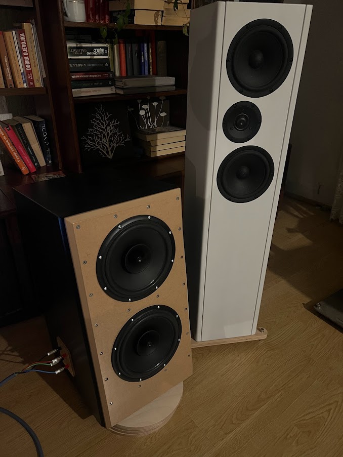

I'm listening double dose of these drivers for a few months now. They are mounted in sealed test box of 55 liters. This volume is a little bit too low (boom box), F3 is somewhere under 70 Hz, so no real bass in big room. I think that around 80 liters would be optimum for depth and precision of the bass. I wanted to try sealed box because plan is to do high sensitivity 2.5 way (I'm not fullrange religius) which will not go too low - loudspeaker that could stand closer to the wall in average EU room and not to excite all room modes and also be adequate for smaller Alephs and tube amps...
I tried it in big room with more than 50 m2, 20 m2 room and in small 15 m2 room...
Driver has really nice sound, full bodied and has great resolution. In big room 4 of these drivers could easily fill the space with music and big soundstage. And they can go really loud. Imaging and spaciousnes is great, All stereo details are sharp and transients are very fast. Vocals were big and natural with scale. Very dynamic and fast, but of course lacking drama of missing bass frequencies. I tried also 6 dB baffle step correction, but that was too much with drivers close to the floor, even far away from walls. Sound was dull and I continued without any filtering for now...I don't have other values to try smaller BSC...
On axis sound is too much forward, very of axis it lost presence and higher tones, sweet spot is about 10 degrees of axis. Even driven loud on axis drivers don't have any hiss, or iritating sibilance or grainy highs. Just would needs small RLC to bring prominent middle down a little bit.
In small room, sound changed completely, bass is there, very controlled and precise, drums, strings of double bass and piano sound very realistic and live. Again it needs some filtering, it has too much energy in middle, especially when you go louder. But it is amazing difference between bas reflex bookshelf and this sealed box with big cones. Everything is more clear and room modes are not excited, no muddyness and bloom...With this sensitivity you get concert level with pot on 8:30 h and cones didn't even start to move visibly yet.
In rooms under 20 m2 I guess it could go only with minimum BSC and to maintain high sensitivity. four of these have more than 100 dbwm in room without any filtering.

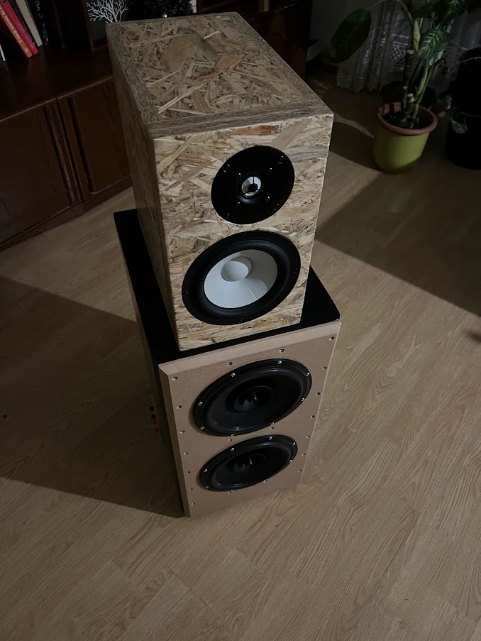

I compared it to Troels' SBA 16 MTM and with Eka Ceramic bookshelf with SB CAC drivers. Yes I know, house full of SB units. 🙂
Conventonal tweeters will have more air and a little bit more extended treble. Decays and fast transients are better with dome tweeters and Satoris are from another world so comparison is not really fair. Also price comparison is way on fullranger side...
I will try to make 2.5 way in 80 liters sealed box with waveguide tweeter (old Monacor DT300 93 dB is on stock) with maybe 1st order cross between mid and tweet and 0.5 bass close to the floor...And real 92-94 dbwm on 4 ohms....Maybe I cut whizzer and make measurement on one unit, but this will not be in next few days...
