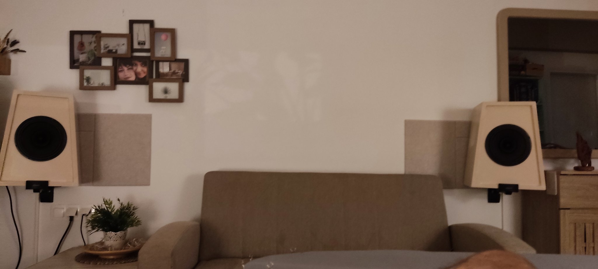

Good morning from Greece, I have bought this 8” SB20FRPC30 loudspeaker, I have installed it in a 26 liter closed-type cabinet and although it has been playing for 15 hours, the sound continues to be somewhat harsh and with strong peaks, resulting in some tiring listening. did you suggest me to do? To add that I use an svs sub from 150 hertz and below.
Try off axis? It gets very balanced when it is not looking directly at your face. And yes 26 liters is too small, try 40, sealed or vented....
Also sound depends largely on room acoustics, if the room is too empty and reflective I can imagine that fatique comes quickly...
Play with the stuffing, it has drastic effects on the sound, too much and too close to the driver can very detrimental effects.
More volume also help beyond the bass, having more space for backwave to dissipate.
The driver has a likely intentional lift in the upper end to provide better off axis response, which it does, you may need to apply a high shelf filter around 2-3kHz to get more balanced sounding response, or as suggested listen off axis.
off-axis actually sounds pretty good but the EQ is good option to consider if you are listening loud, there will be less power into the driver (and amp in the case of active or digital) and less unnecessary HF energy being dumped into the room.
With passive high shelf (resistor+inductor parallel) driver will see a high impedance at these frequencies, this could help soften the sound up by a different mechanism.
