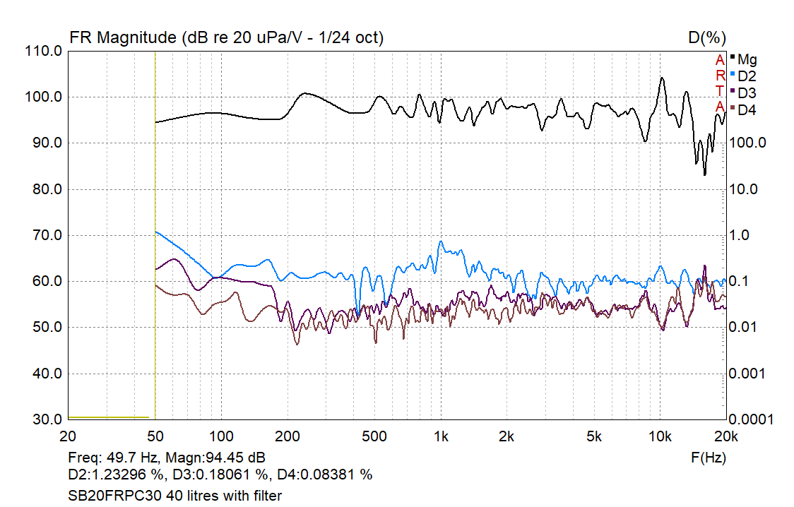

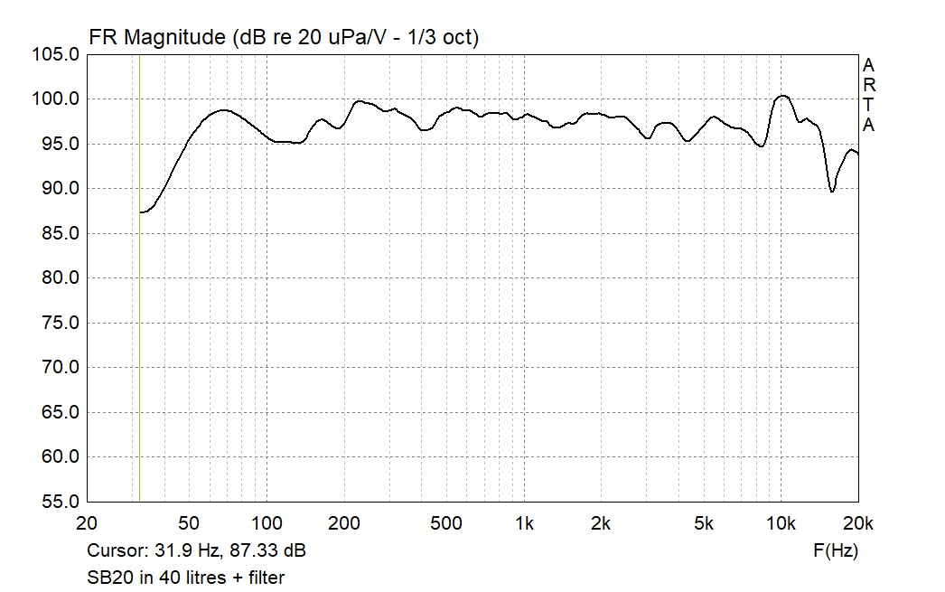

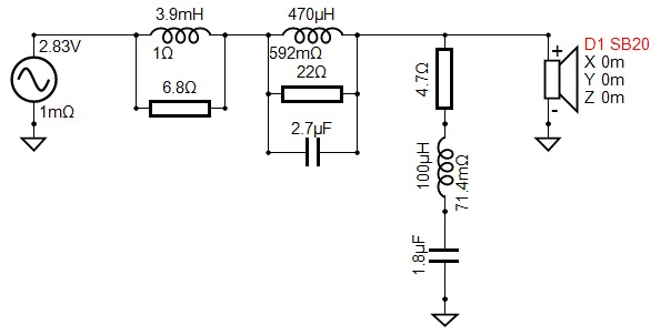

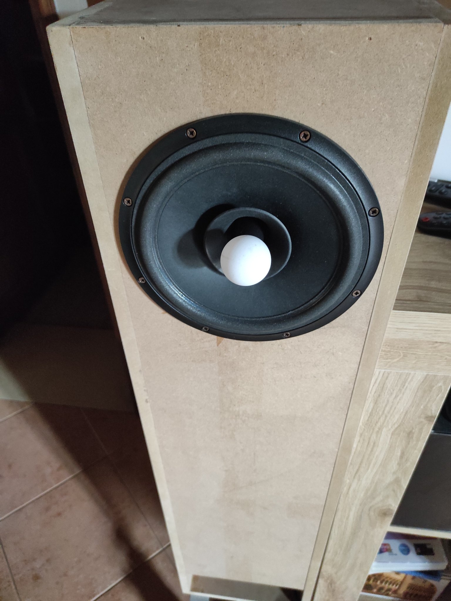

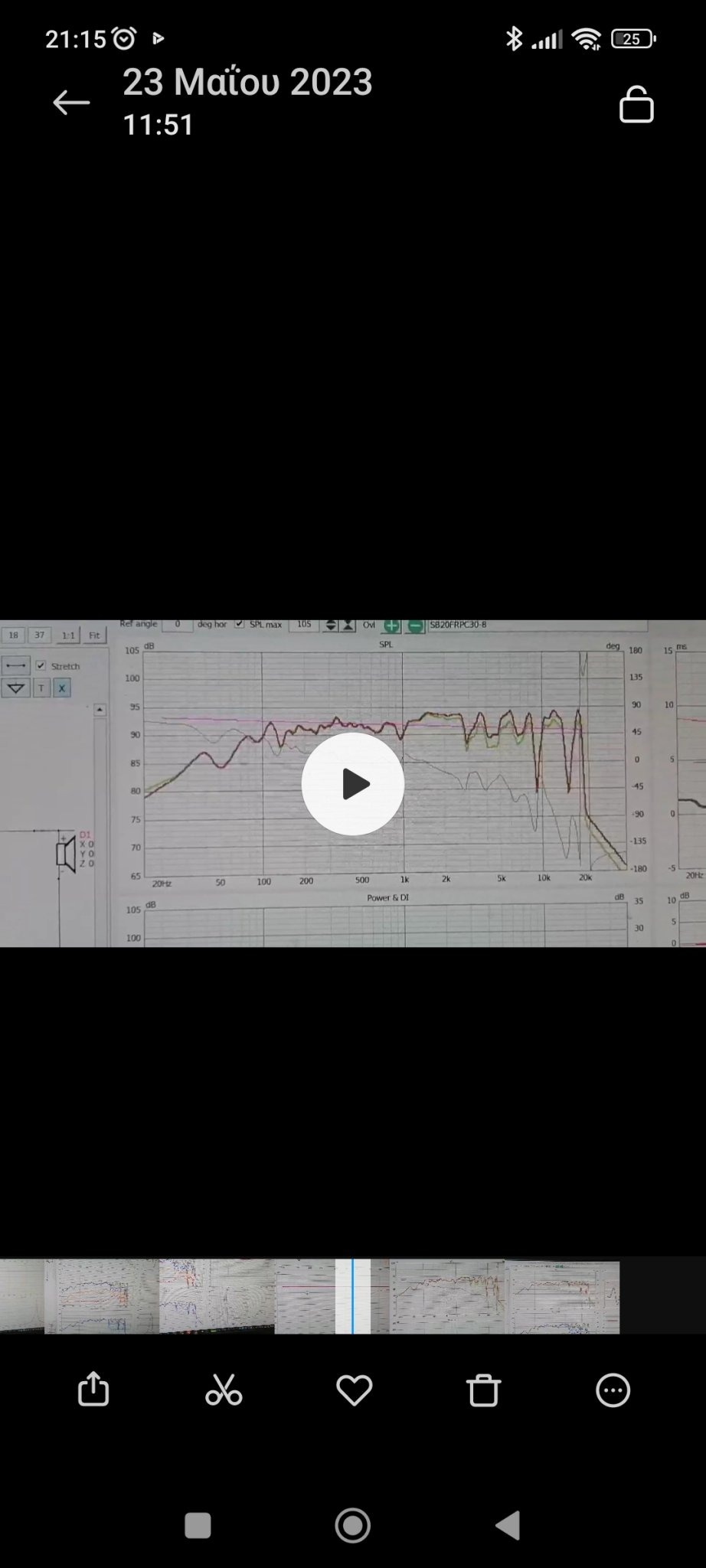

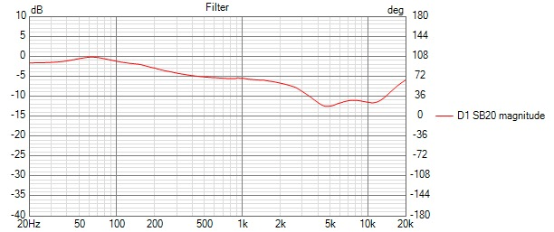

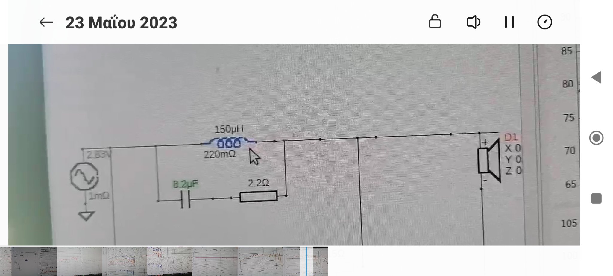

Thank you all for your valuable advice, they all played their part but once I made a filter and balanced the loudspeaker, one is the word "magic". Really vivid natural and massive sound.
