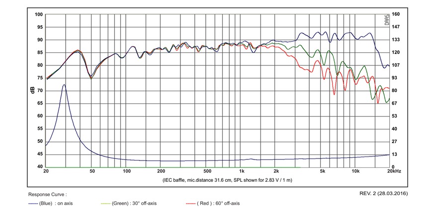

SB Acoustics SB20FRPC30-8 (8" Fullrange Cheap Monster II)
I’m thinking of building an OB line array with these SB20FRPC30-8 drivers. It would be my first attempt at a line array. Should I do it?
I know comb filtering can be a problem. Should I use a single tweeter in the middle of the array?
I was also thinking about blending from a single fullrange unit at high frequencies to a full array below the c-c wavelength. Has anyone ever done something like that? Instead of power tapering, high-frequency tapering?
Or with the driver’s rising on-axis response above 3k maybe comb filtering won’t be a big deal?
Not a good idea…..combing will start around 800hz and you’d need massive EQ and the off axis response would still be awful. The purity of the fullrange solution is a single point source within a 3D space which creates a startling soundstage……if that’s what you’re after (most people are) use it as intended with help from (sub) woofer if higher output is needed.

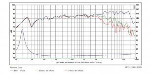

Hi all

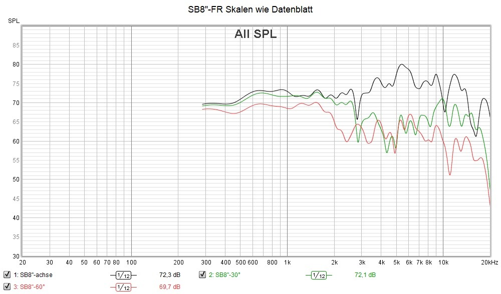

another look on the measurements i did....
here in same scale of the axis as the manufaktorer data / specs.
Difference im method: SB in lab contitions ca 31cm distance, my measurement home, 1m distance in an enclosure
Enjoy..
Reactions: lasercut
It is nice to see good data without photoshop directly from the manufacturer...🙂
Very nice correlation between measurements, you have diffraction bumps and baffle step loss, otherwise everything is the same....

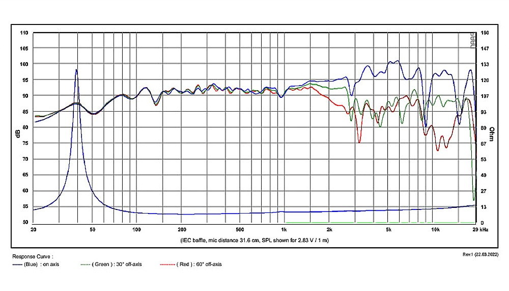

Fun fact:
Satori MW16P is actually one of the best fullrangers on Earth, just nobody calls it that way....🙂
If somebody can, it would be nice to do FR measurement with whizzer cone slightly damped with piece od damping fiberglass or cotton or wool.
Just to stuck small quantitiy of damping all around between whizzer and main cone....5 minutes of job and it is reversible...🙂
