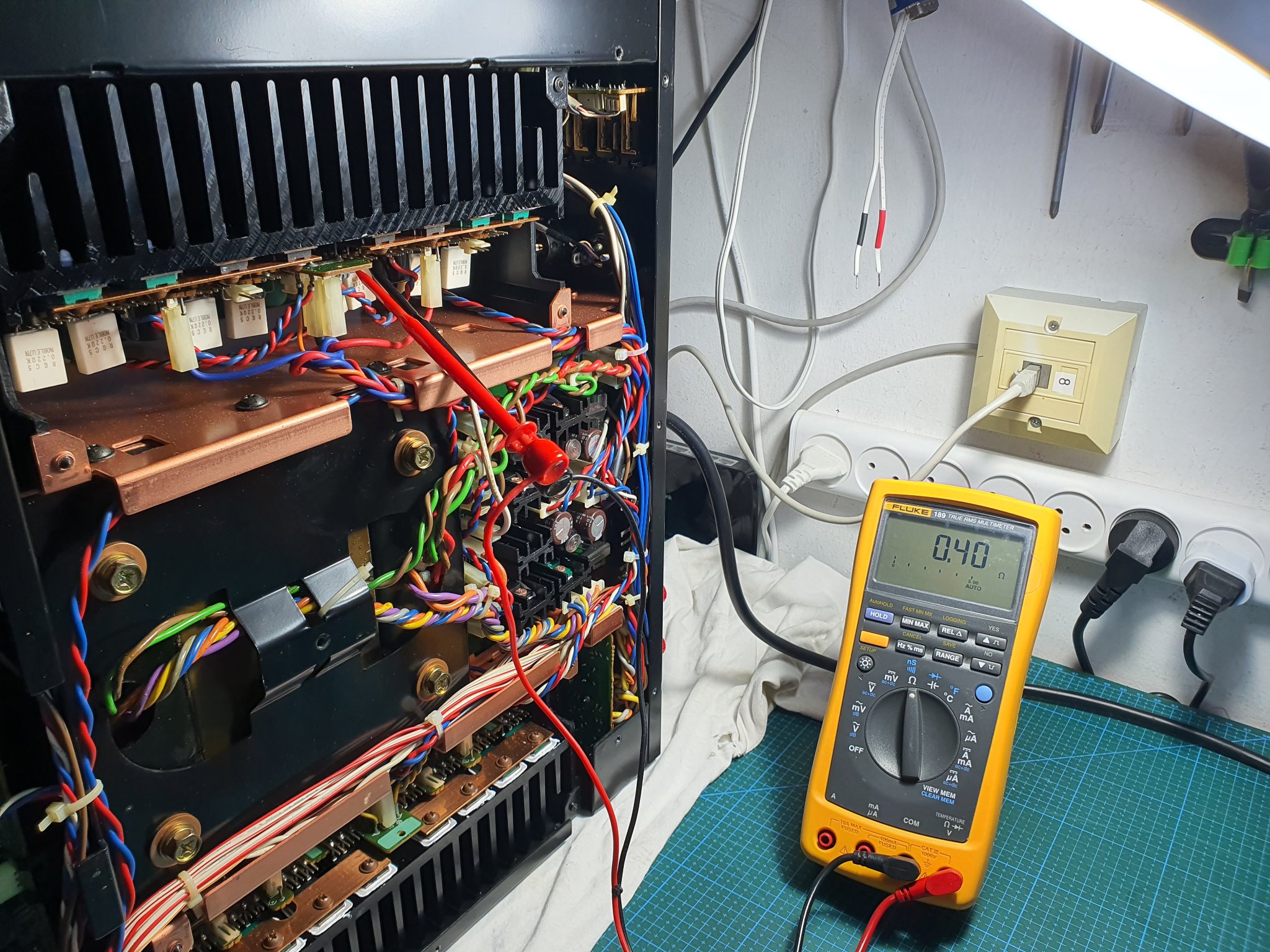

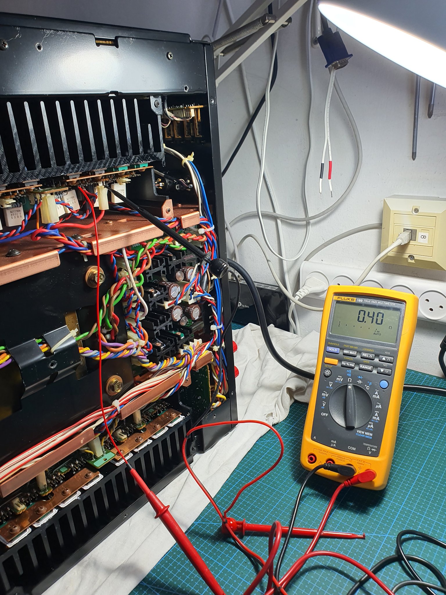

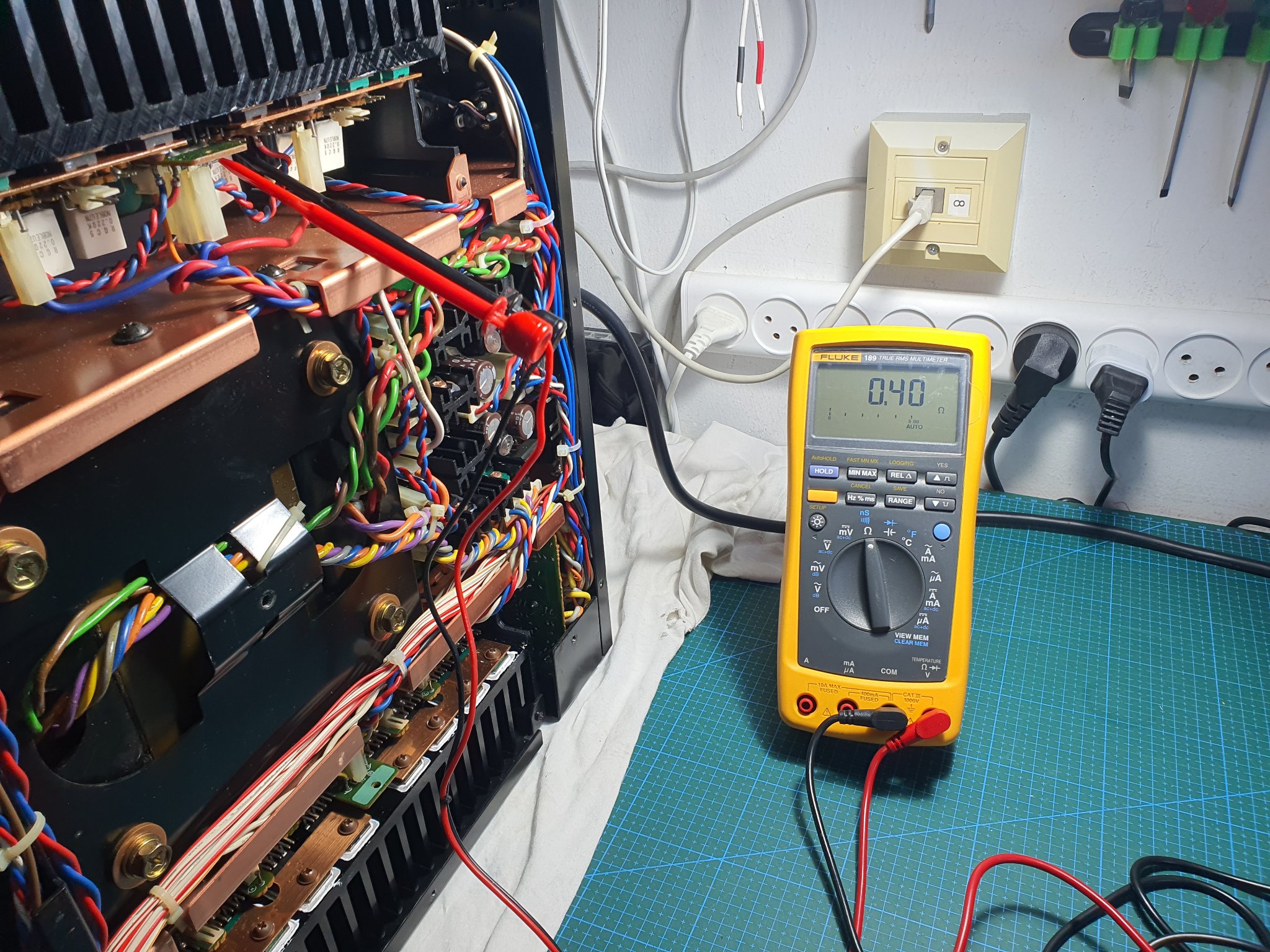

Hi, the resistor behind Tran #6 is 0.39-0.41ohm and it seems to be OK.

Ok, still from yesterday: resistor of Tran 6 on the good channel has around 25 mV ?
From now on everything is only about the bad channel Tran 5 to Tran 8.
Gate voltage about 2V on Tran 6 is ok ?
You could measure temperatures again.
Resistors and Trans 7 and 8 should have medium values.
Resistors and Trans 5 should be more hot.
Resistors and Trans 6 should be more cold.
As the resistor 6 is ok it all points to Tran6 is open.
