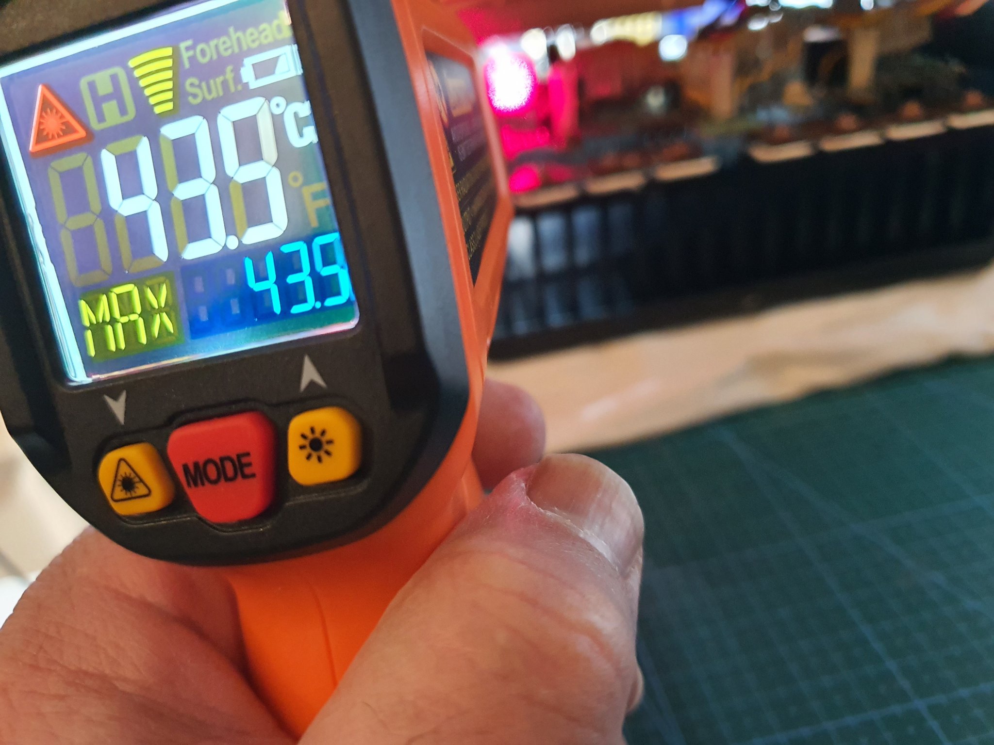

Let say that it's better when it's hot than when it's cold but it's not stable when it's hot. BTW the difference in °C between right and left is 10°C when the right side is hotter. Left 40°C right 50°C

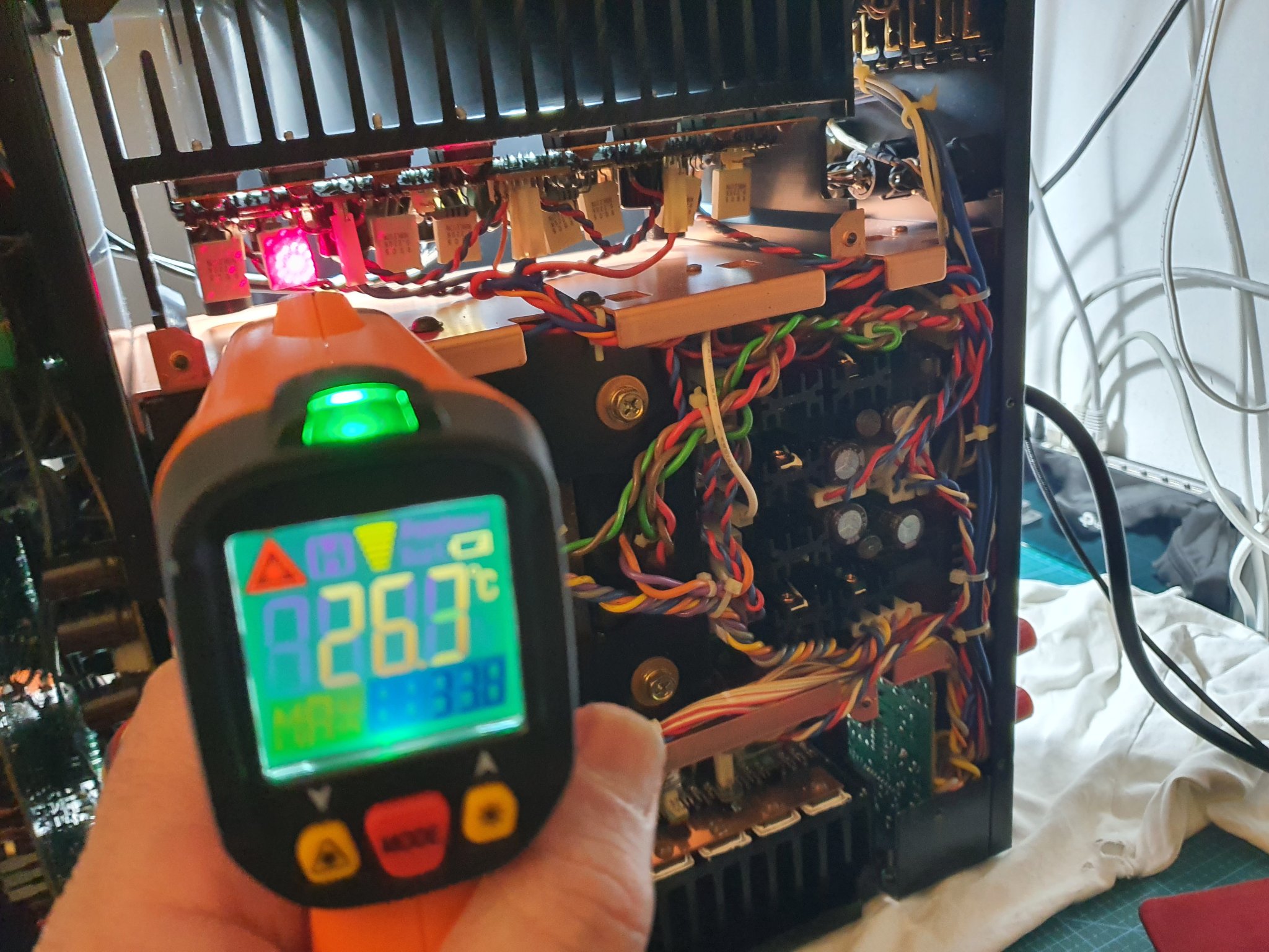

I turn on the amp now and this amp drives me crazy. The amp cold and for at least 5 minutes the sound appears on the both channels and after a time it start to make the problem with right side and again after it becomes worm it's again OK. The resistors on problem side (the right side) are much cold then left side but the temp on the transistors are opposite right side hot left side 10°C less. Green right red left (for the resistors).

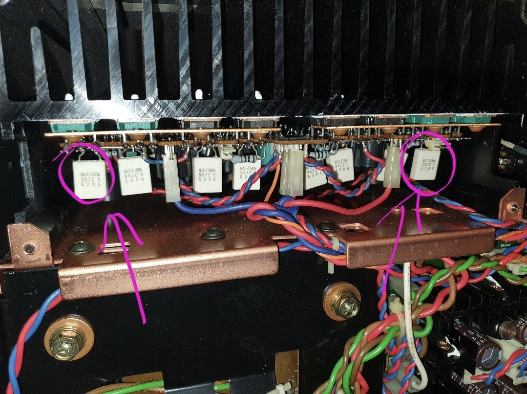

On right channel the temp of the 2 last resistors are higher than the rest. On the left side the temp is +/- the same on all of them. OK I will try tomorrow to check the voltages across the resistors. Maybe bad 2 power transistors on the right side that are not in the spec.

That's why I asked you to measure every resistor voltage 😉Maybe bad 2 power transistors on the right side that are not in the spec.
And the two neighbouring resistors ?On right channel the temp of the 2 last resistors are higher than the rest.
2 corresponding transistors temperature ?
If those 2 resistors are hotter, it means more current, so you will measure higher voltage.
Something shorted / partly shorted / open.

1:30am quick guess:
The 2 Mosfets or 2 resistors which are direct neighbours of the hot resistors are open = bad. So no current flowing, Mosfet and resistor are cold.
Because, seen from board edges, 1 pair of parallel Mosfets on both sides of the pcb. If one Mosfet / resistor fails and is open, the parallel part must take double current to establish the idle bias and get hot.
Mosfet open or resistor open.
Or bad solder connection on resistors, unlikely...
Best check the 8 0.22ohm resistors of bad channel as next step.

Thanks for all the comments. Yes I have a scop. I will check today voltage across the the resistors. When I turn on the amp, when the amp is cold, at the beginning the right channel act like it should for the next 5 minutes. The behavior is like parabola.
The pcb has those forklike contacts on the output FETs. You could measure there, the 3 points give you: bias voltage, gate voltage, rail voltage.I will check today voltage across the the resistors.
