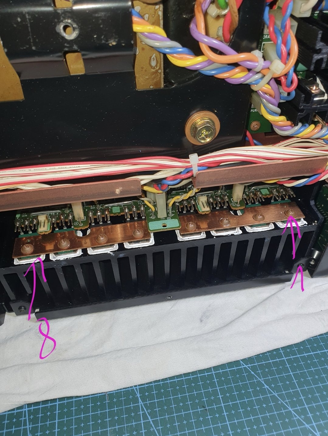

To do the same with the hot on Tran. 5-8 on both channels?

Left channel: hot side
Tran. #5 22.1mV
Tran. #6 22.7mV
Tran. #7 -26.4mV
Tran. #8 -18.5mV
Right channel: hot side
Tran. #5 67.4mV
Tran. #6 2.7mV
Tran. #7 -26mV
Tran. #8 -44.6mV

Thanks, now I'm a little confused.
Before when measuring to the ground, on the left channel tran 6 only had 5mV:
Or did you mix up the channels ?
Now the right channel tran 6 only 2.7mV which looks like something wrong either Fet or resistor.

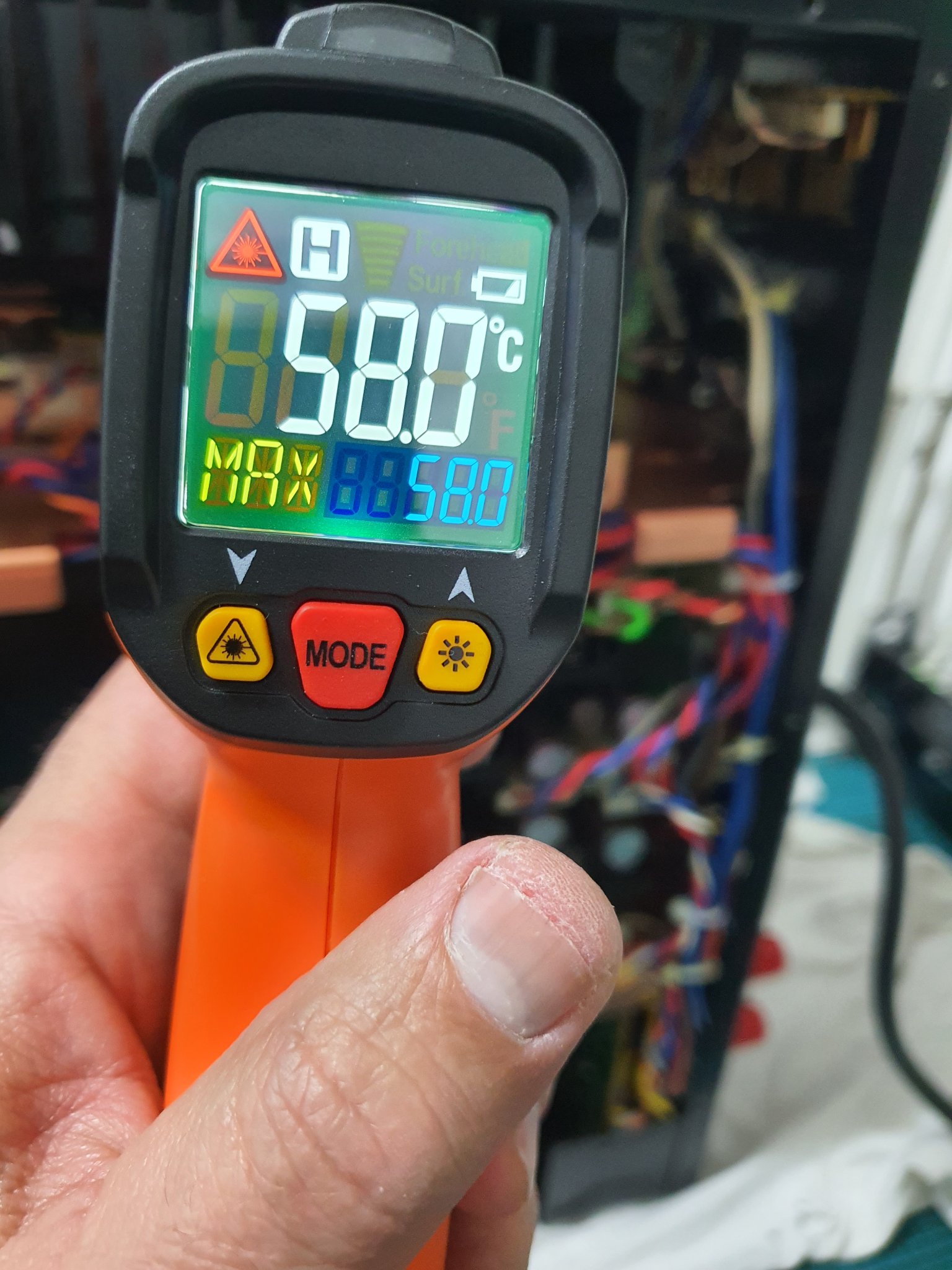

The upper heatsink ?The temperature on the heatsink rises to 58°C on right channel hot side
Tomorrow measure the resistor behind FET 6 if it is ok or open
Just turn the amp off, keep the black clip on the pin and the red one on the left fork of FET 6. And measure ohms.
