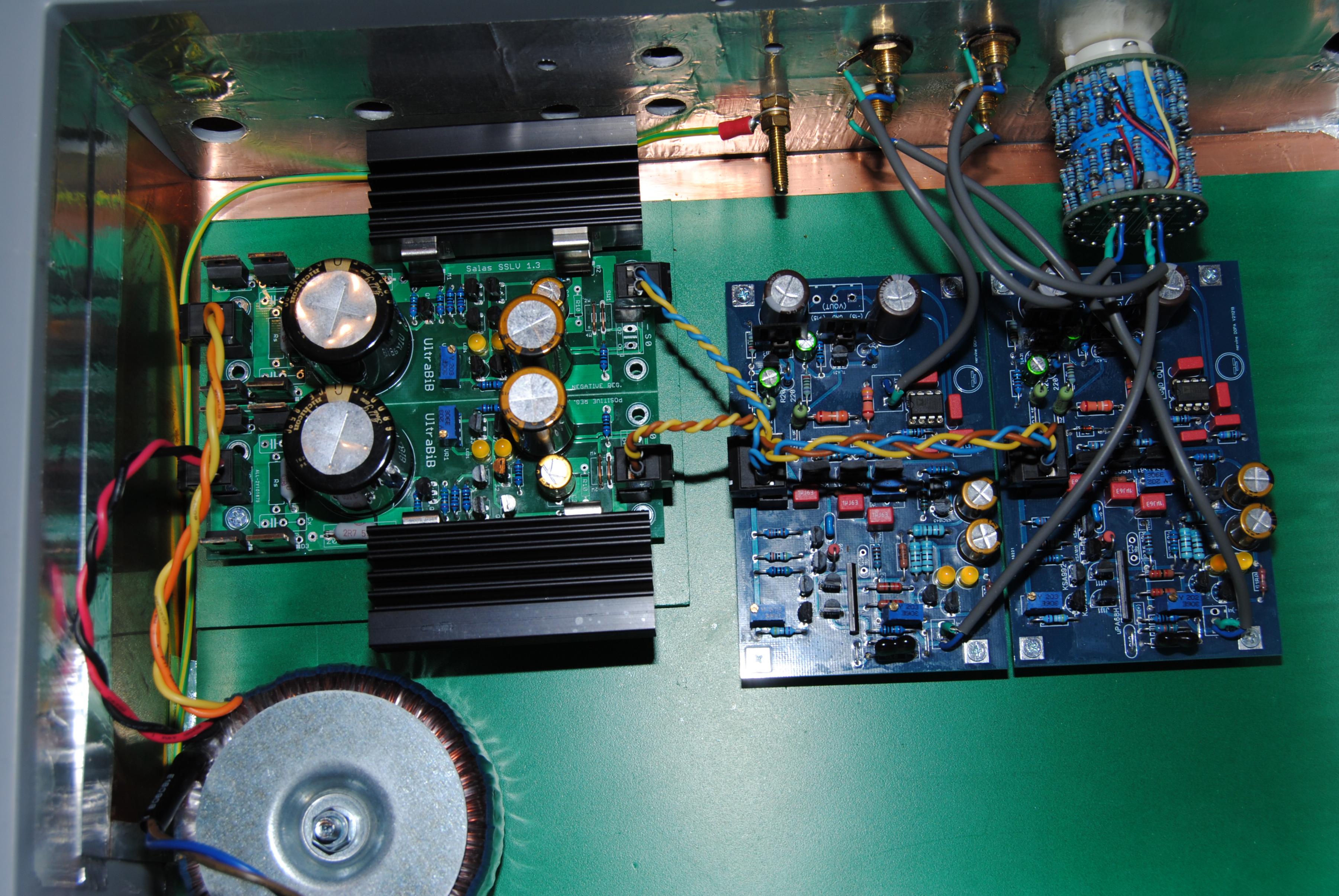

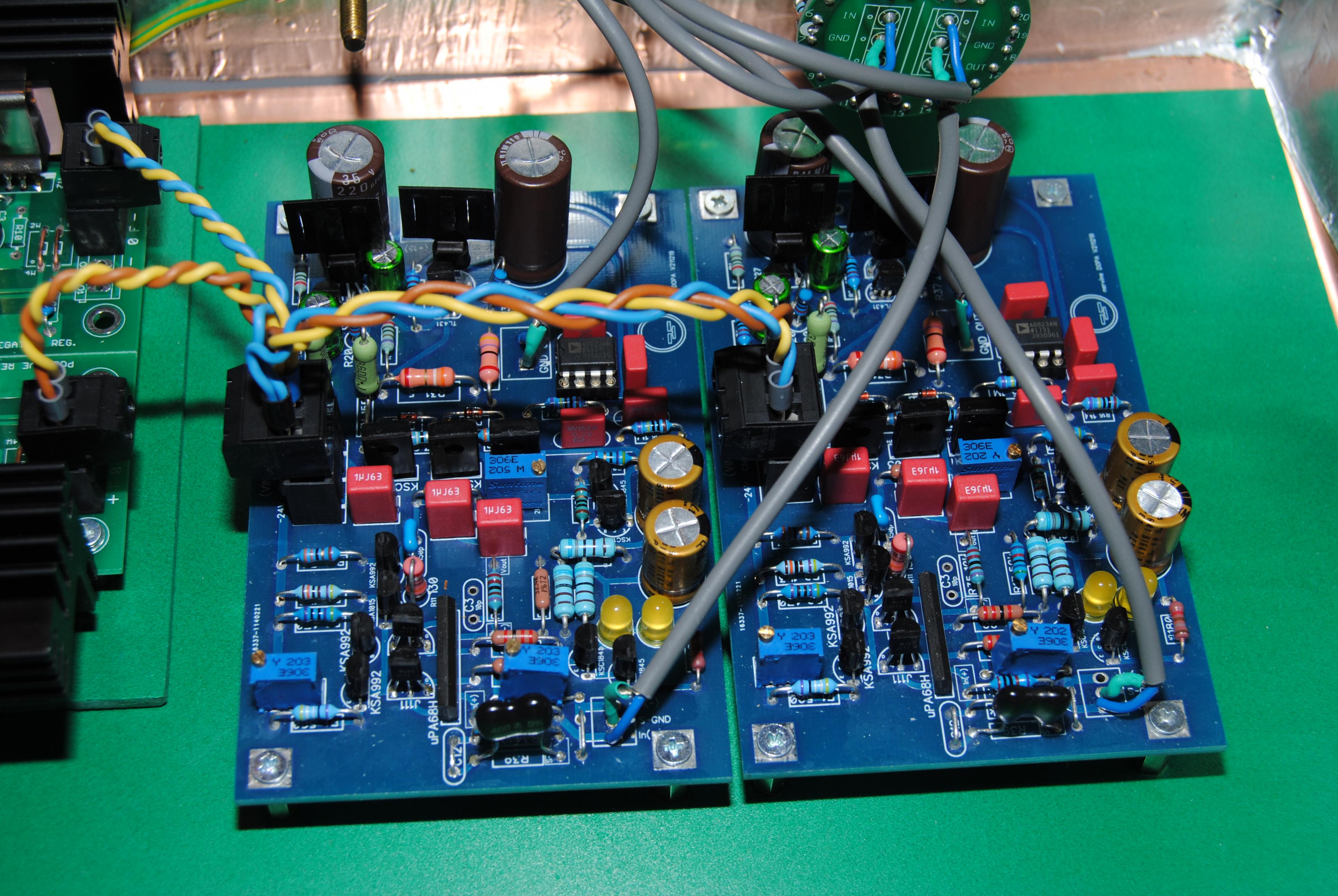

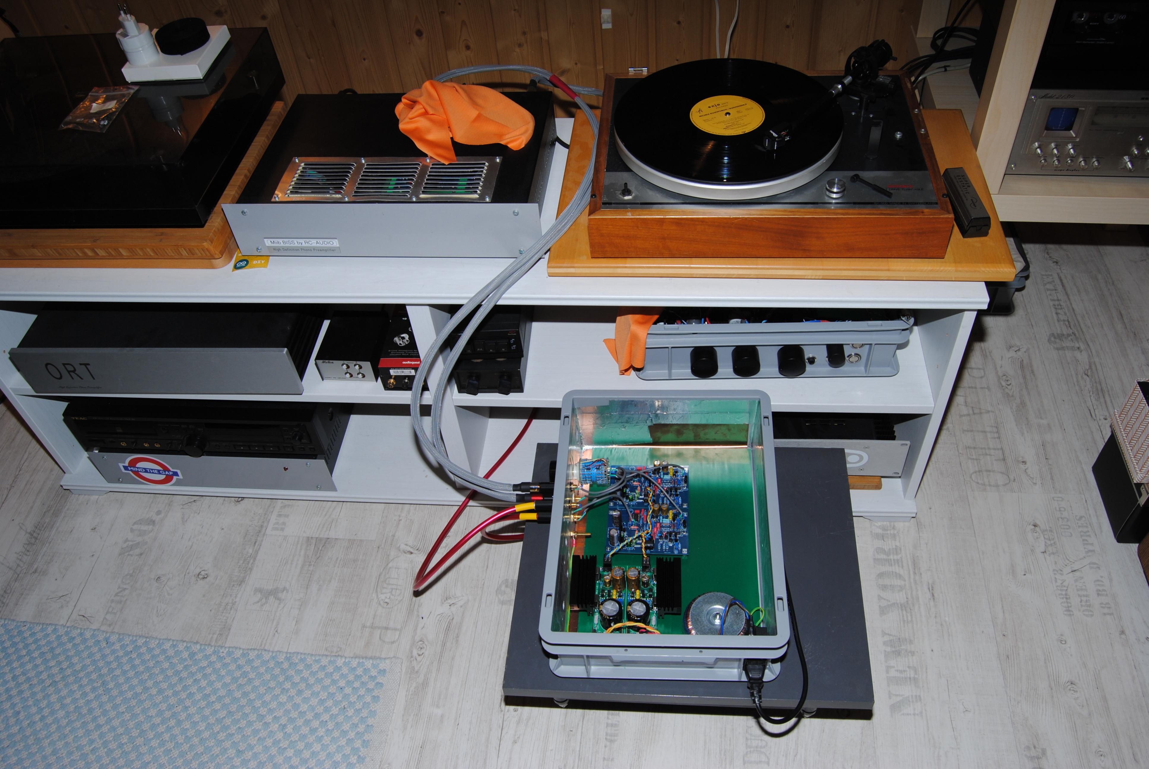

Look at my new rig..... it is a DOPA powered by the truly rare proto board Ultrabib.
The DOPA uses a upa68 LTP IPS, a VAS with beta enhancer loaded by a ccs... the vas output is loaded by the output followers biased by a bjt bias spreader..... it is a mini LIN amp unity gain stable and capable of 40X gain (now set to 3X).
PSU is the ULtrabib that seems to sound even better than my prefered shunt... there is a presence in the low mids without loosing the uber high end definition.
The ultrabib is really good sounding ..... I also use it in my special RIAA (Scandal in Paradise) and there I notice the same sound signature....

The offset is controlled by an opamp..... sounding very high definition now.... it is extremely sensitive to external electrostatic charges.... I can hear soft clicks when I lift the record from the TT.... apart from that it is dead quiet (zero hiss and zero hum), even in my plastic box without a lid...

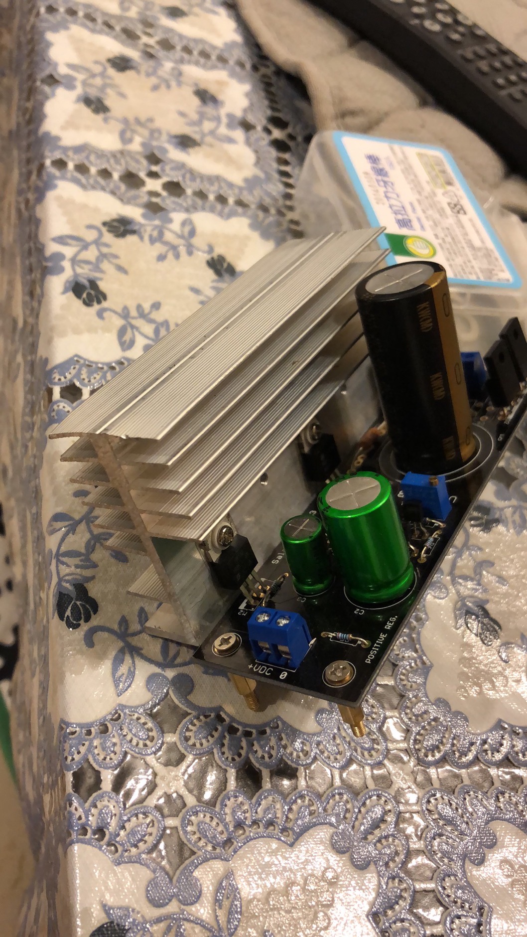

I am using 5V @ 800mA. The fins in the photo still don’t seem to be big enough. The temperature is getting higher and higher. After 1 hour, the temperature of the fins should reach 60 degrees that I can touch it for more than 20 seconds, but I feel it too hot.
In this case, even if it is locked in the case, it should be difficult to reduce the temperature, because even if the case is large, it will be limited by heat conduction and the heat will still be concentrated near the transistor chip.
In actual listening to music, Salas SSLV1.3 UltraBiB is indeed slightly better than twisted's Placid HD Supply, but UltraBiB is really too hot for a long time. I used to test Placid continuously for 24HR. It still works normally, and the temperature does not keep rising.
Maybe you spare more input to output voltage and standing current than necessary? Could you set it more efficiently for the task at hand?
There is not much difference between input and output voltage.
Can I change Rf to 2.2 ohms 3-5W to improve the problem of high temperature?
