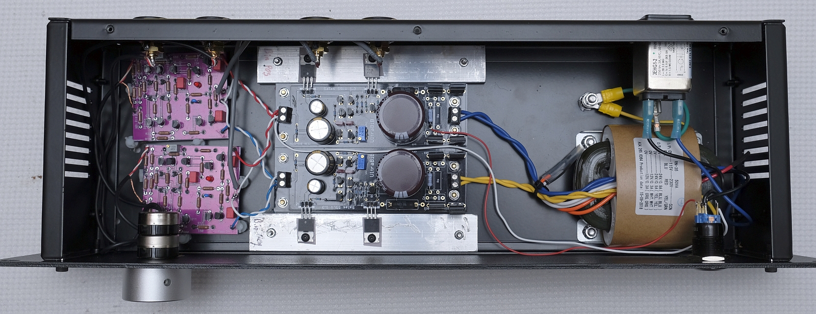

Nick just completed a BiB powering a pair of Wayne's BAF2018 line stage. All is working very well at 18vdc with M1 & M2 temps at about 34c. Plus it sounds very good.
My question is, if I take a feed off of the +ve for an LED power indicator will a cause an imbalance? The leads would be at least 25cm.
Present +ve and -ve leads are about 5cm.
Tnx
David
Hi, better tap raw DC from C1's + pin. Through a current limiting resistor. Return to its other pin. ILed=(rawDC-Vf)/R. Not to possibly introduce any noise on V+ output from a virtual antenna.
Did you previously use some other regulated PSU for Wayne's? Any pictures from the build?
Copy that Nick. No, this the first build for me using Wayne's boards. I have had the parts in a box for almost a year and finally got to building both the linestages and BiB.
Both builds powered on first time. Kudos to you and Wayne!!
Pics to follow.
Here is a photo of the setup. Thanks for the suggestion where to tap the +vdc for the LED power indicator.
