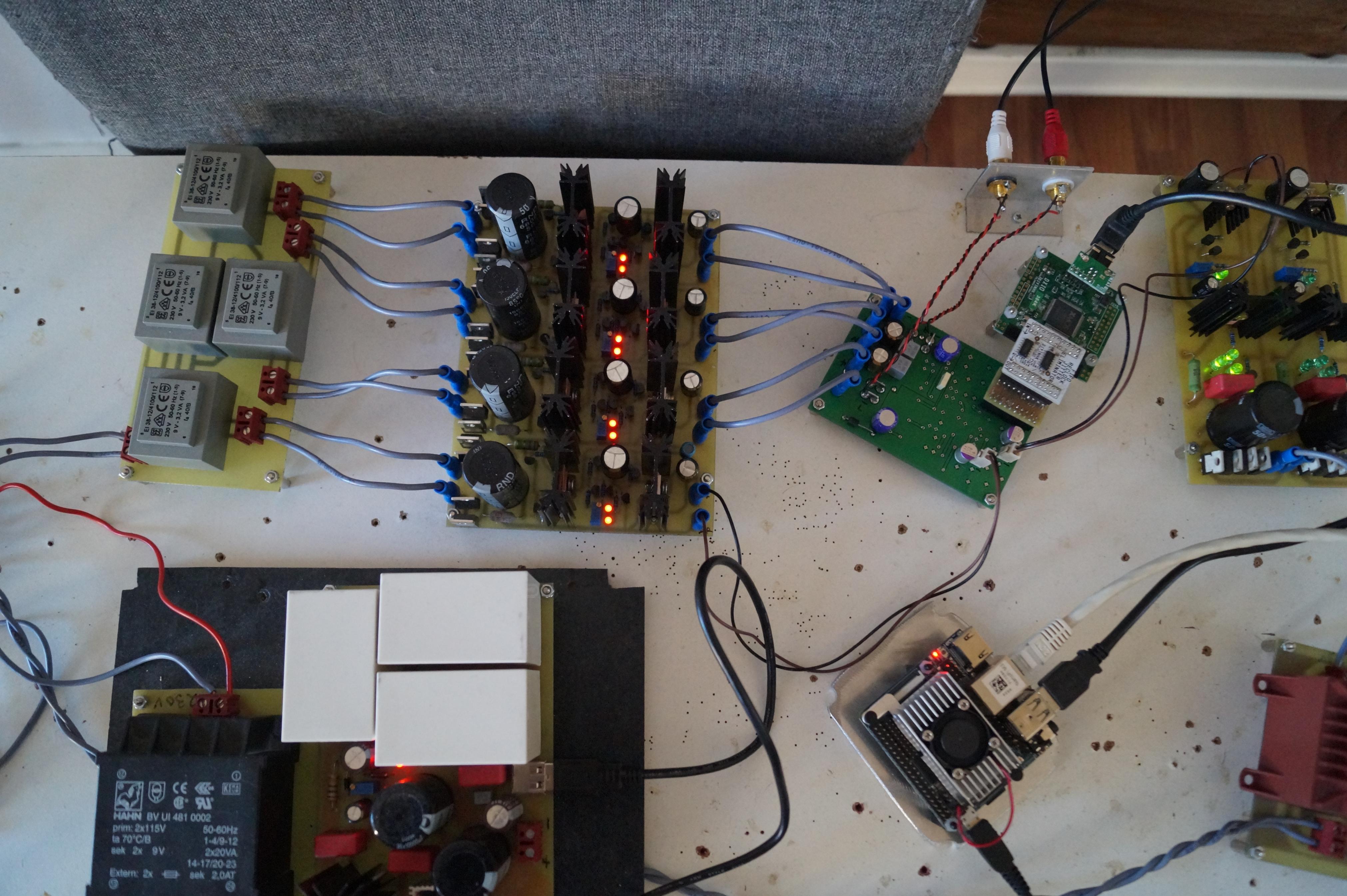

I have build one for a diy AD1865 dac.
Actually 4 😀
3x +5v and one -5v
Sounds is very good.

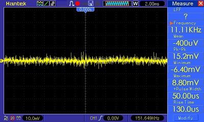

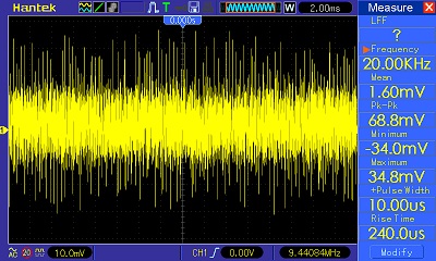

On the scope under load it showed some RF thing on the output,nothing big i could hear.
I tamed it with a little coil of 220uH in series with the output,and to be sure i put a ferrite beat on every gate of the big Fet,s.
Everything is running cool not overheating.
The scope pictures are from before and after.

Hmm the layout is fairly critical for this circuit and there is no ground plane in your utilization so in the end you did not do too bad with measures against RFI

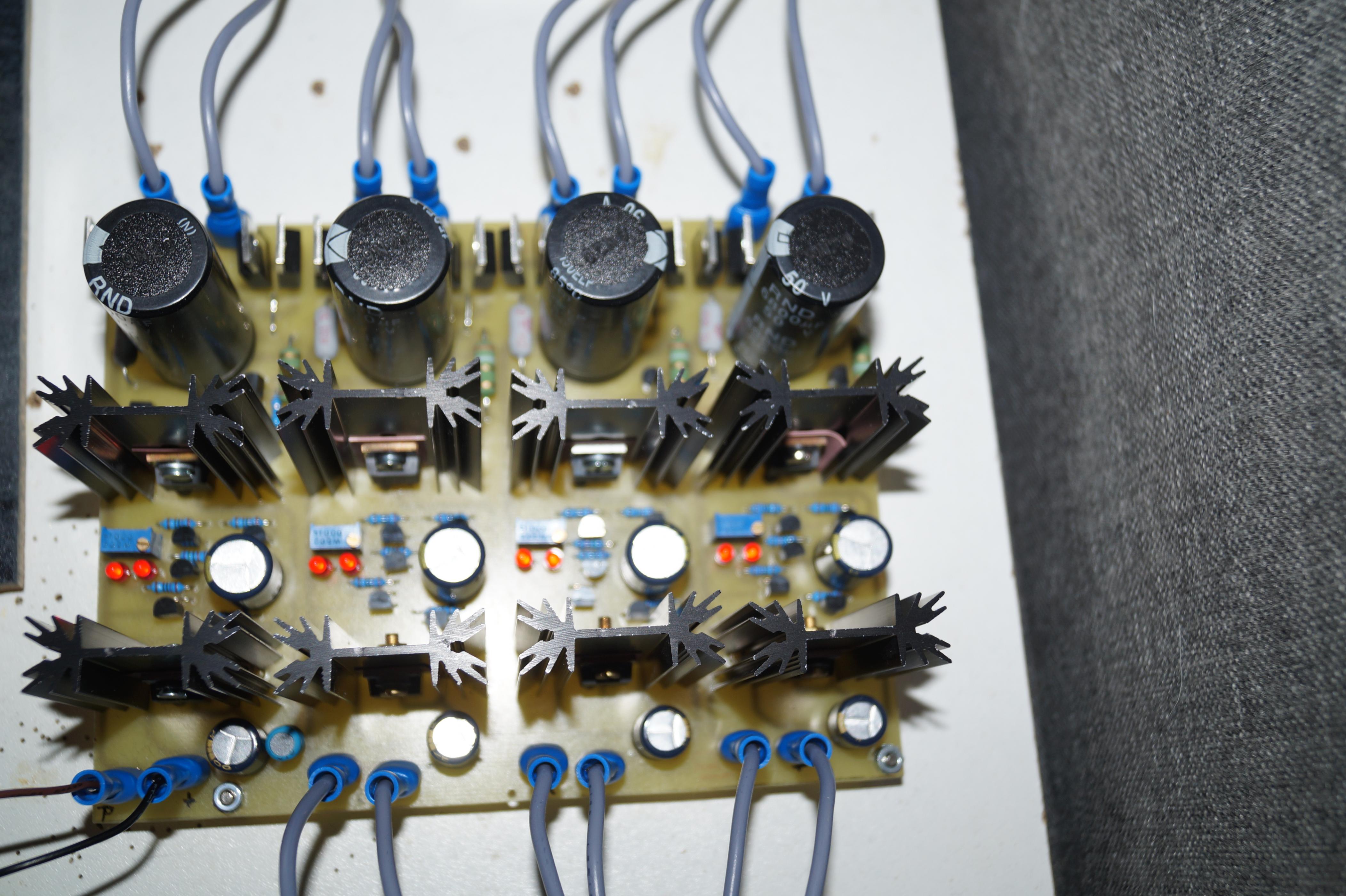

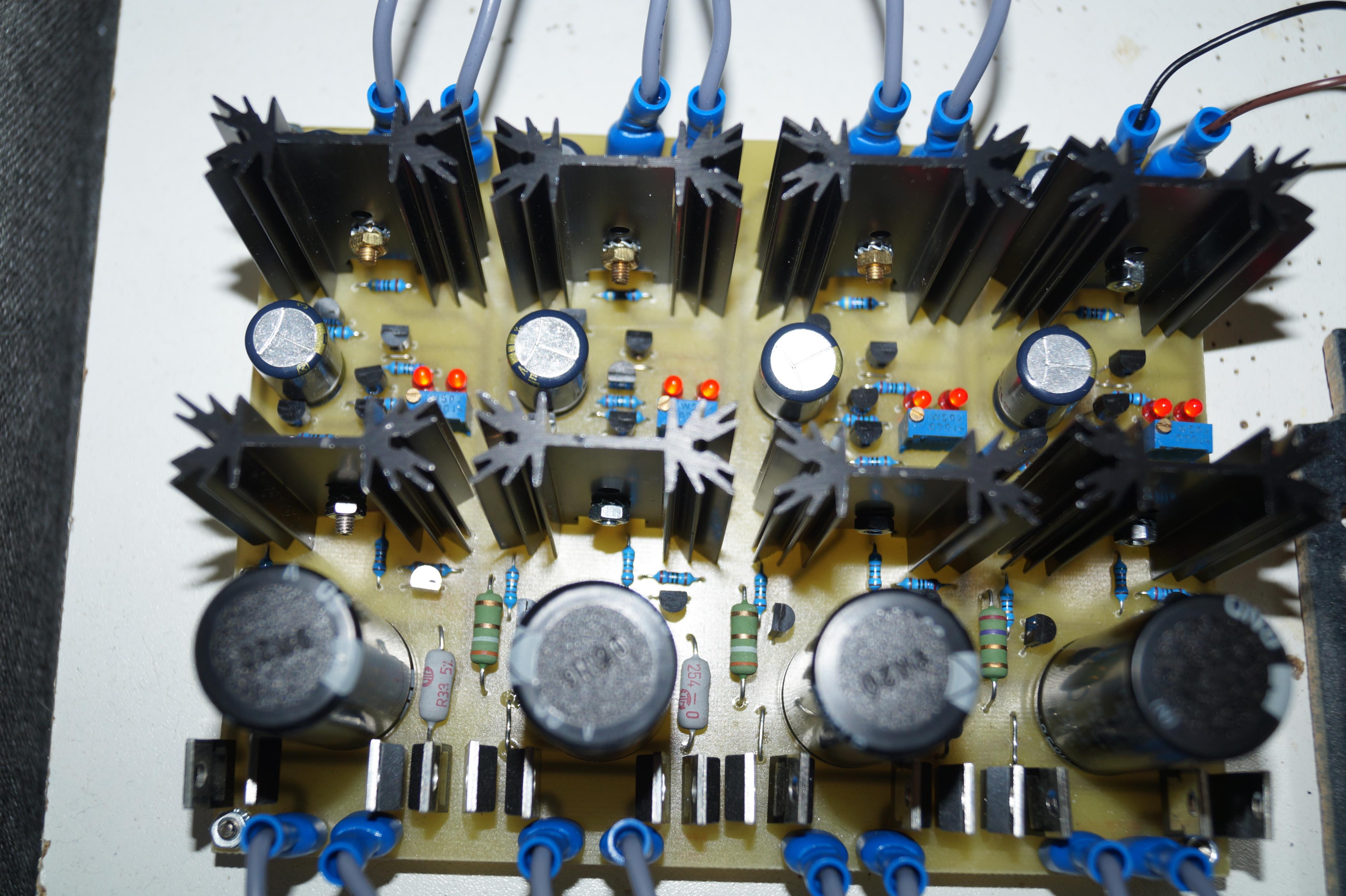

Without ground-plane, the placing of the C3 was the most critical.
C3 not as output cap but as close to the last Fet M2,and as far as possible away from the heath sink.
If it is to far from M2 it will oscillate.

Correct remarks, the layout of this reg has some points of caution you could stumble on when spinning your home board, I went through a couple of prototypes to optimize the GB board too.

first heath sink measured +- 40C after feeding the dac for a few hours .
second sink less
