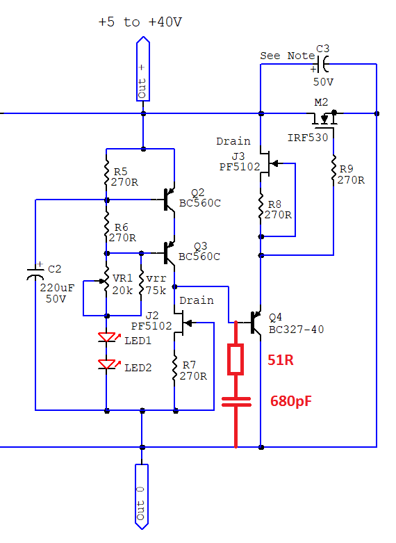

An RC series network placed between the base of Q4 and ground successfully cured any desire for oscillations. A resistance of 51R and capacitance of 680pF did the trick.
Now listening tests are in order :hphones:

That's compensation, not a native solution by layout and parts choices, but its alright for your experimental 1.3 inspired & self made reg on the quick. You know, I never released the 1.2R for a GB because of its sensitive nature on such things and its use of expensive and widely faked NOS JFETs. I understand the test building and load matching difficulties for a higher spec shunt from experience. So it remained the favorite shunt reg of few skilled and basic lab equipped DIYers that took on the battle to successfully put it together. To make the 1.3 reliable to build and universally useful, when it has even more internal gain than the 1.2R while behaving itself also, wasn't an easy task at all...

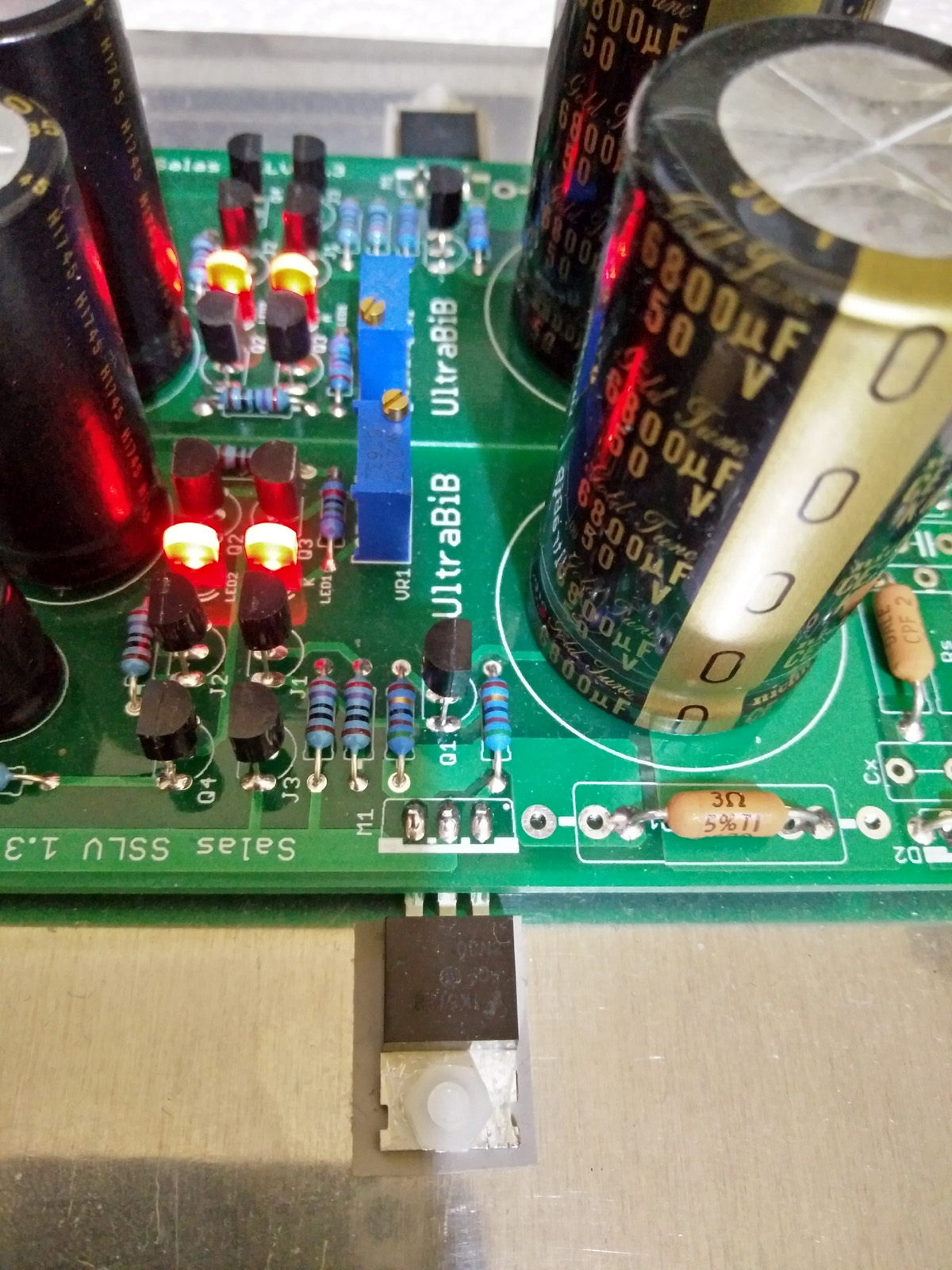

This probably be a stupid question.
From your schematic for Neg rail, emiter of q1 is connected to negative side of c1 but in the picture of PCB I can see a trace running from -c1 to collector of q1.
Also an emitter of q1 is connected to r3 and r4. Should it be an opposite or am I missing something?

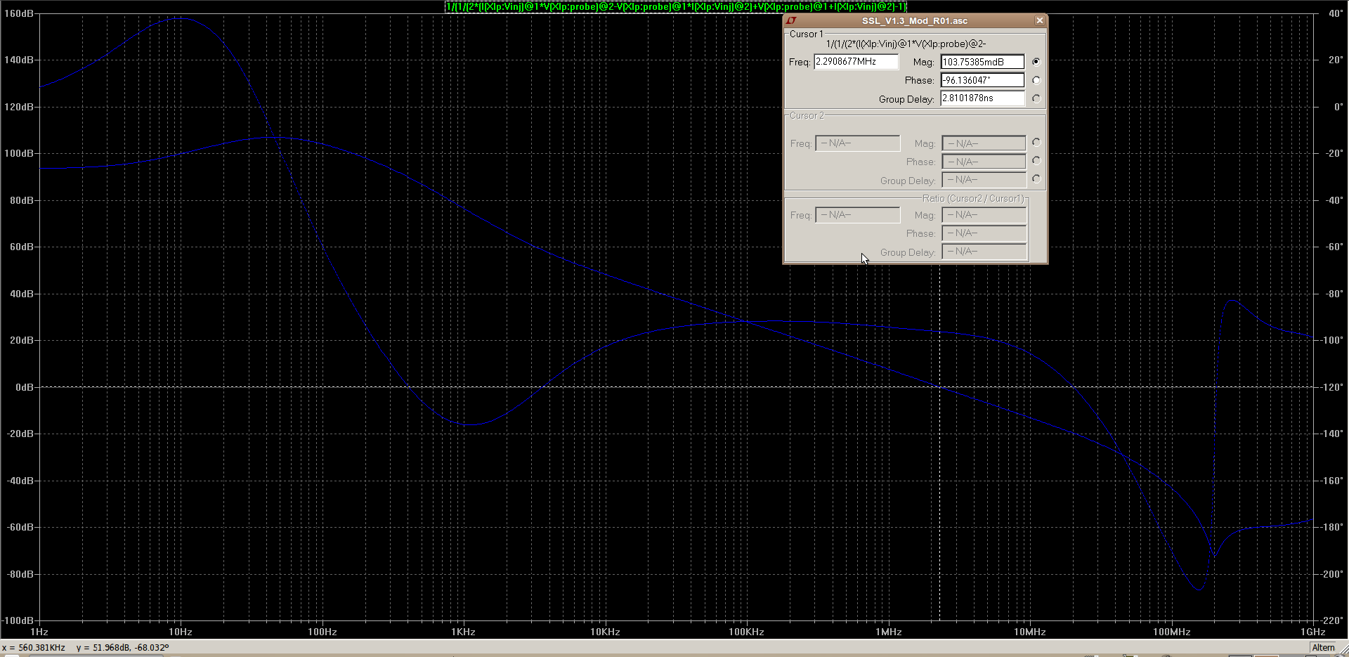

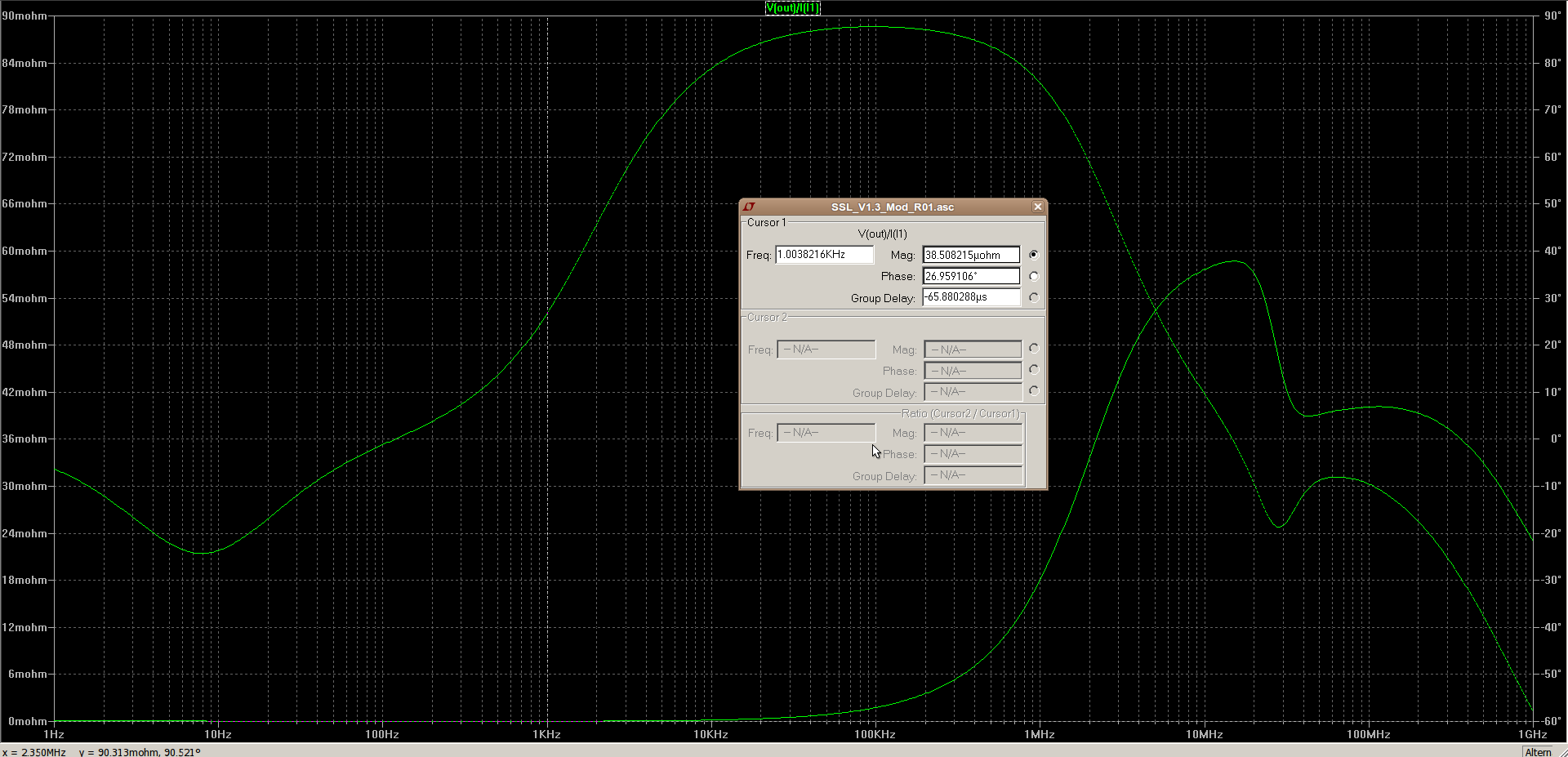

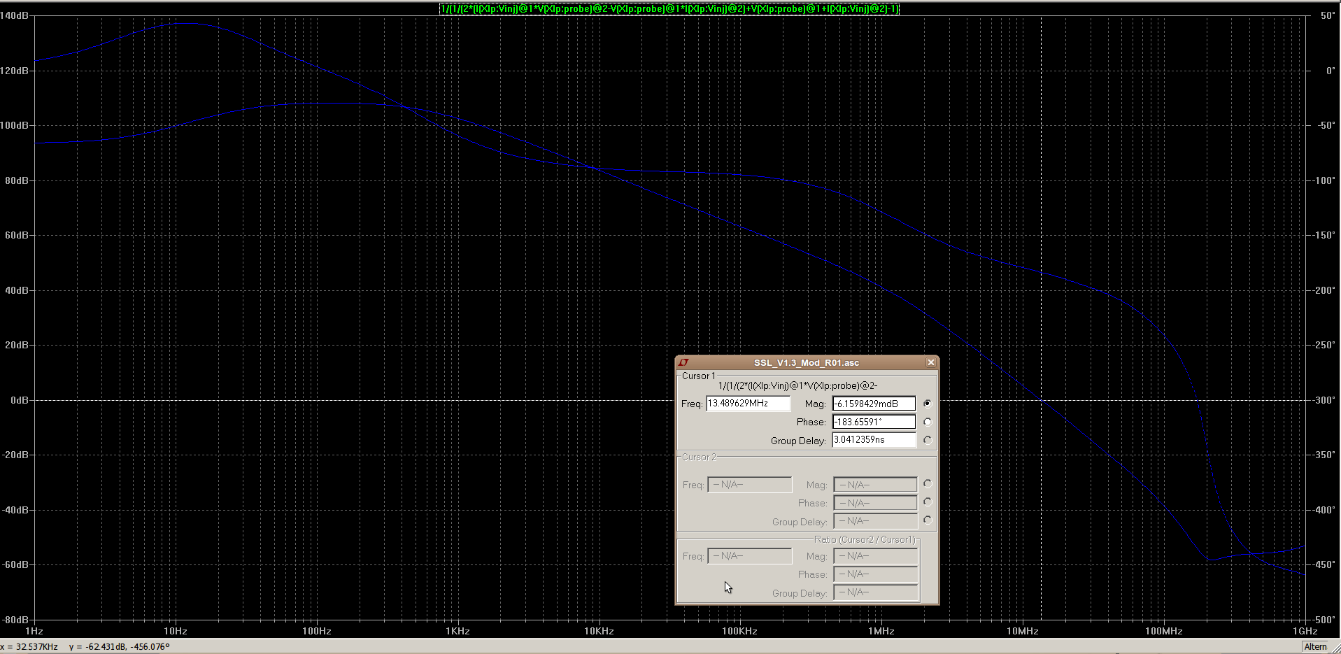

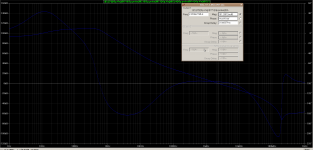

Schematic is intrinsically unstable in its initial version, see the OLG in the first attached file - the ULG is 13.5 MHz and the phase shift is -183 deg. No more words are needed.
Introducing the RC frequency compensation network proposed by @Selfy (R=100 Ohm, C=1nF) the OLG becomes as shown in the second picture - now the ULG is 2.3 MHz and the phase shift is 96.7 dB which is much, much better - the phase margin is more than 80 deg.
The only thing which scratch my eye is the big phase excursion in the region 1 kHz - 100 kHz.
The both simulations are performed with output capacitor 100 uF with ESR=0.1 Ohm as suggested in the initial document. BTW, finding such capacitors and relying on their constant ESR over time is not an easy task.
And combining with the fact that the capacitance added on the regulator's output via attached load is almost impossible to predict a-priory, the possibility of oscillation becomes bigger and bigger.
However, the other advantage of the proposed compensation network is that it permits on the regulator's output to be used bigger capacitors with more "normal" ESR of, let say 50-60 milliOhm.
On the third picture you can see the OLG with attached capacitor 1000 uF, ESR=0.06 Ohm on the output. The nasty belly is compensated by 20 dB which is not bad, isn't it?
And on the fourth picture is plotted the schematic's output impedance - 38 uOhm on 1kHz. This proves that the insertion of the compensation network does not deteriorate the regulator's output impedance.
In conclusion - very good results for such a simple schematic.
Two shortcomings though - the poor phase linearity and the poor thermal stability of the output voltage.

No you are not missing something. Crt missed something and I did not catch it. Q1's orientation print in the negative rail should have been reversed. Tricky, it works all the same in test for steady circa -0.6V across R1 following well with the positive section's R1 voltage. That is why the glitch passed unnoticed. The negative section's Q1 can be positioned the other way around than its now printed of course because the base pin is the middle one in those types. To be typical and have closer base current to Q1 positive.
I will put this corrected orientation down in the build guide and will see to reverse the solder mask print in the future pcb runs.
Thanks for noticing.

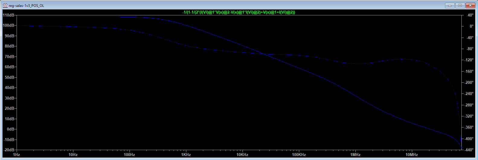

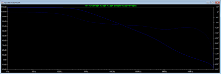

Are you talking about Selfy's initial and then the compensated?
Because the UltraBiB simulates like this for OLG:
