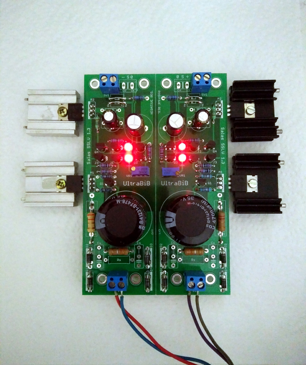

Green and HASL with lead was actually the cheapest protos I could make in quantity of few for test. Looking nice until I reworked it. Cheap always looks nice at first. Sticky desoldering even with a vacuum gun and a pads disaster. No contest to what I was used to with my thick copper double immersion gold padded 1.1. regulars. And such high quality it will be for 1.3 too. Rest of those test boards I gave to the beta guys. In any case a Back In Black regulator owes to be naturally black 😀

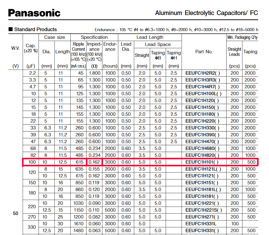

For the C1 power tank and C2 Vref filter you may use whatever you like but for C3 there are rules else you will make it oscillate. Read the 100kHz ESR and capacitance range notes on the positive schematic. There is an impedance at 100kHz column in some high spec electrolytic types datasheets like the Pana FM etc. Those figures are usually reliable. I found them close when testing at 100kHz with the LCR Meter. So you don't strictly have to verify but simply choose from the datasheet. When the 100kHz permitted impedance range is met (0.12R-0.22R) choose the lower uF value model that falls in range. No more than 100uF though regarding its capacitance. There are also alternative lead spacing pads for C2 (7.5mm 5mm) & C3 (5mm 3.5mm). Unspecified for 100kHz impedance C3 capacitor types must be measured on 100kHz LCR for ESR first.

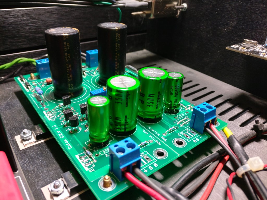

In the previous post's photo you can see it with EPCOS power tanks (4700uF/35V) and Panasonic FM C2 (470uF/25V) C3 (100uF 35V). Also in post's #14 second photo. C2 can be up to 16mm diameter and C3 up to 10mm diameter and there is some extra space around them also. Placed in a way that if you will mount the M2 MOSFET vertically they will not obstruct a screwdriver to fix it.
Nice for low profile in height caps combo. Robust for working hours spec also. I listened to it in the Soekris. Very nice. But when with Nichicon Gold Tune tanks and Nichicon ES (BP) non polars in later test it was simply better resolving and more melodic. Given the fact that the UltraBiB needs consume little spare current so it does not need (not even likes) Hot-Rod current setting, the M2's dissipation is low enough not to create high heat in C2 C3 vicinity. 85C "for audio" caps will also have a good life there. In my opinion the Nichicon ES (BP) Muse is a great affordable line of "audio" capacitors. Dead on for values and with very low DF & ESR in test. In first post's photo you can also see the Gold Tune but with C2 C3 Nichicon KZ Muse.

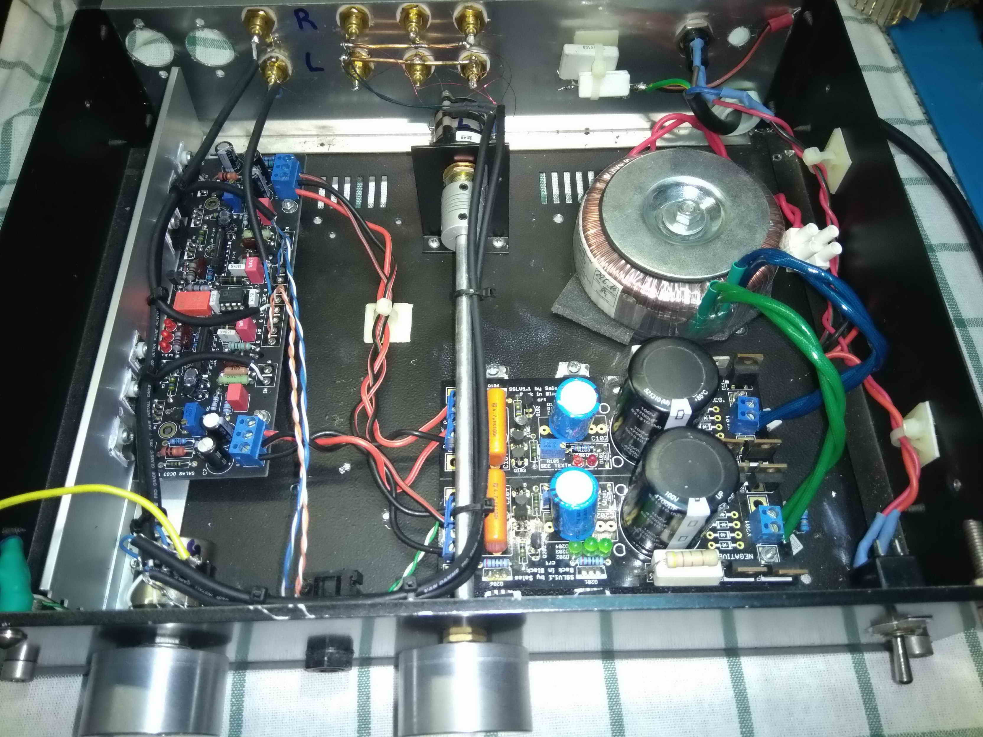

Salas also honored me to do also a beta testing on one of my DCG3 preamp.
I have two DCG3 preamps and this is the one I use in my computer (usually as a test bed) with headphones - DT150 and AKG 712 pro - or with speakers - continuums and a PeeCeeBee amp.
Did may test with components and I think Salas has the feedback and will let you know what components you can use in order everything to be stable. Keep in mind that if a capacitor is good for audio, it has to fulfill some criteria in order to be useful in this circuit.
I did enough listening before and after swapping the regulator mainly with headphones.
The change in sound to better was apparent at first listen. As other have described, better clarity and definition throughout the audio range, but for me it was also apparent up high the frequency where I could hear more power but without any harshness.
I am waiting for the final version and thinking changing the dual mono regulators on the DCG3 on my main system.

Tea said to me he will manage to squeeze it in the forthcoming GB (imminent). I had sent him the triple sections version* data as earlier on as possible to assemble and Beta test himself.
*Three regs on one board in breakable V scored sections. Positive, negative, positive, arranged. Exactly as in SSLV1.1 BiB. Same dimensions and mounting distances also (mechanical reference is the four green CCS Leds BiB 1.1 iteration board). Same transformer needs. Instant upgrade from BiB to UltraBiB. In case of installed sense leads if not bothered to remove them they can simply go along the main leads in the output connector.

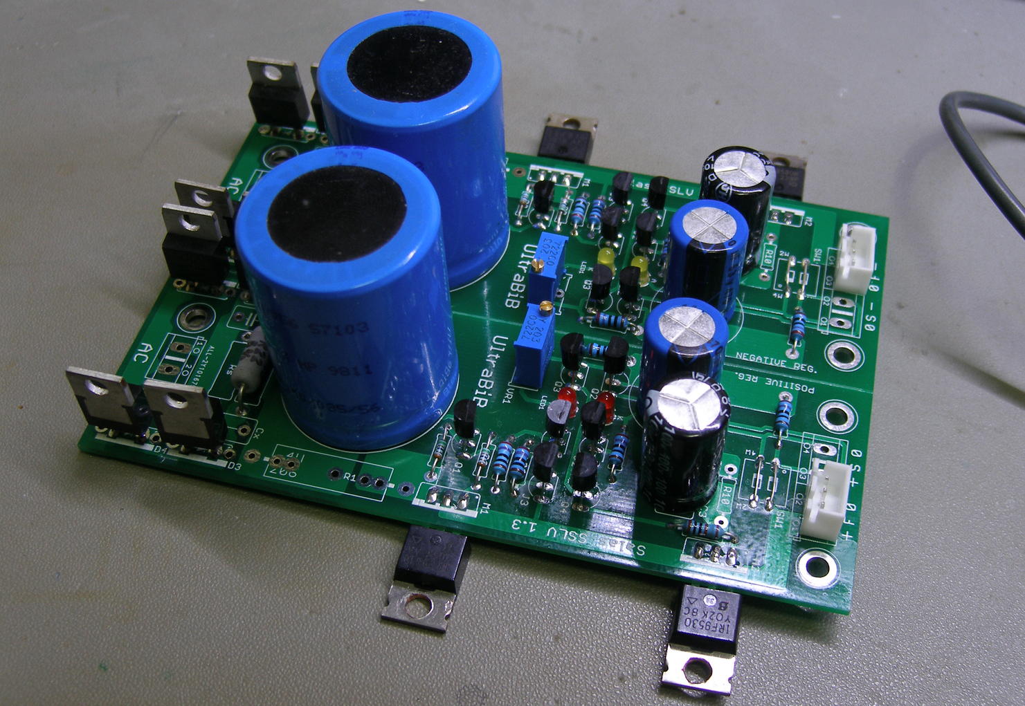

Looks great Salas looking forward for the group buy and I currently use 1.1 on my Soekris, so as per your post just a drop in replacement with 1.3 🙂
Regarding the Kelvin wiring on the outputs I see that all the beta testing is done without this, so we can go ahead without the Kelvin on the 1.3. I presume that we still need to use a load resistor of the actual source to set the DC output voltage as we used to do with the 1.1 version.
You may use a dummy load resistor to emulate the actual load and the final work heat on M2 for sinking and warm up drifting. But the output power node is already locally closed in the 1.3 so you can pre-set the Vout regardless of dummy loading or not. It takes 15 minutes and about 1-1.5% negative drift to thermally settle. Then on its rock steady especially after half an hour. For 5V to 25V applications only, the trimmer can be 10K giving more precision in that range. When first assembled you may see as much Vout as Vin due to a trimmer addressing the full Vout range (or a large portion of it), is set somewhere in the middle position when delivered from the manufacturer but turn it down and it will soon listen. Don't connect to a real load before setting Vout. Due to its large range of Vout possibilities (more than most bench supplies) you may forget it might start high on first step. Set it alone first.
Thanks Salas, yes thats a good point of not putting a load resistor for the first time setup with the trimmer being at the highest resistance which might have come from the manufacturer and we forgetting to reduce before soldering to the board. Once the voltage is setup with the minimum and then using a load resistor to set the required voltage is perfect.
