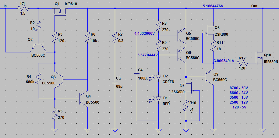

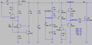

The stability problem with mine version could easily be the modified CSS part of the regulator.
In my implementation there are no source resistors for the 2SK880s. I use them only for simulation purposes (Idds).
I am tempted to try a diode (1N4148) in place of R9, once I figure out the reason for the instability.
You are treading away from the original's parts choices along with playing on different layout so many scenarios are possible on why it behaves differently. Sticking to the 1.3 basic architecture alone isn't a guarantee its a proper 1.3. If it was your CCS mod it would be spewing AC packets all the time but you only found them when playing with the load type. Replace the FM C3 with an FC at least.

I have the Ref-D design around low threshold. Diodes have tempco and some noise also so I don't know its full impact off hand. The less the impedance there the less effective the cap's filtering. Output contacts and cabling will swamp Zo differences at some practical value. For 5V its also alright as it is. If we will try to make this reg extend even lower at a point it surely has the parts positions for experiments already.
