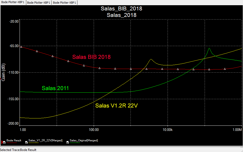

Since layout is critical when designing for line regulation, will have some boards made as close as possible resembling those illustrated in the first few pages of this thread.
I compared three versions of the design, one dating from 2011, the other the V1.2R 22V, the last the schematic illustrated at the beginning of this thread. The PSRR of each vary in significant degree.
The 2011 version measured 131dB when tested, or about 10dB worse than the simulation. The Salas was a real champ when it came to PSRR in the Linear Audio bake-off.

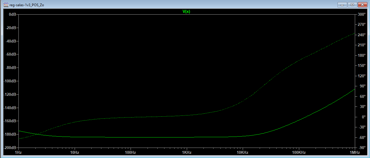

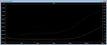

Yep, it was quite interesting how close your lab findings followed the simulation trends back then. This year's PSRR simulates like attached. The flat trend in audio frequencies is there, your attempt looks flat even in higher frequencies, about numbers I don't know what may be seen in the lab with real parts and boards practice. I will ask Tea-Bag to send you an original board on my expenses. Thanks for your contributions in measuring and for your interest.

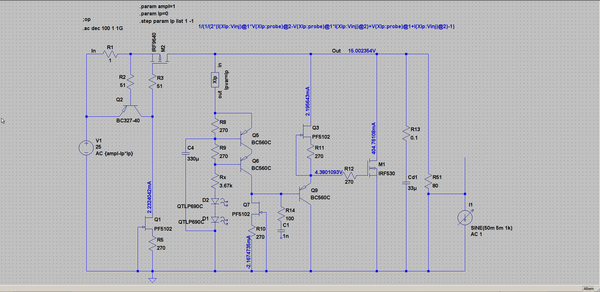

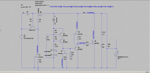

It is evidently correct. Same method on the 2011 one that Jack measured close to sims in all areas. Also, according to your analysis my prototype would have behaved more or less like Selfy's when tested with his same load parts but it didn't (posts #54-59).
Different methods different parts different models differentiated circuit sections. We will not have a chance to match those analysis.

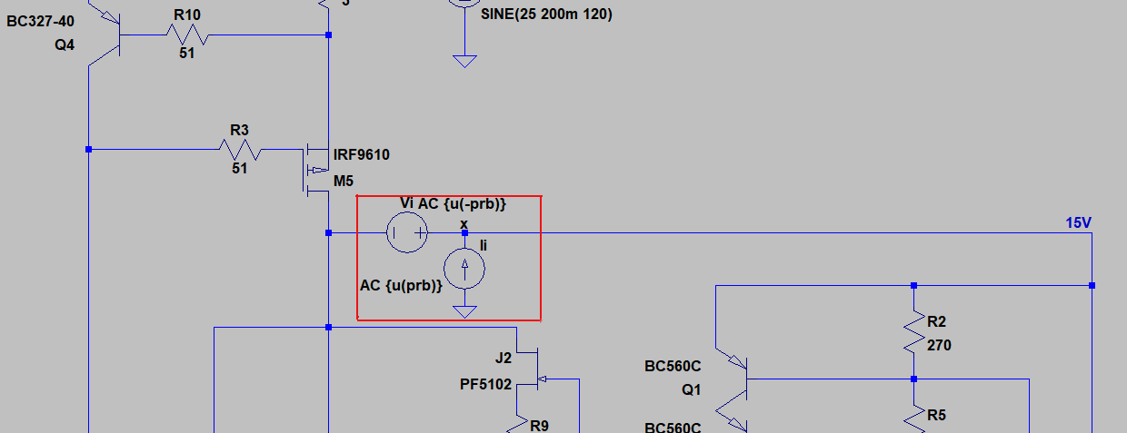

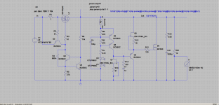

Thank you for pointing me out this great material but I think I passed the lesson about Tian's probe a long time ago.
What about your decision to insert the probe - I do believe it is wrong. Just imagine where the NFB comes from and where it goes for. Of course there mustn't be any parallel loops.
And if my initial drawing seems a little bit controversial to you, here's another one which will probably be more convenient.
Of course results are the same.

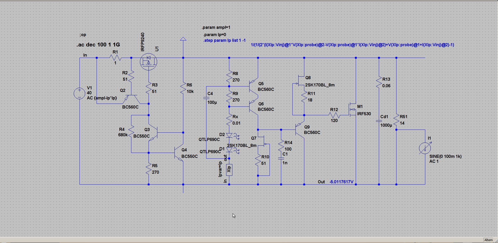

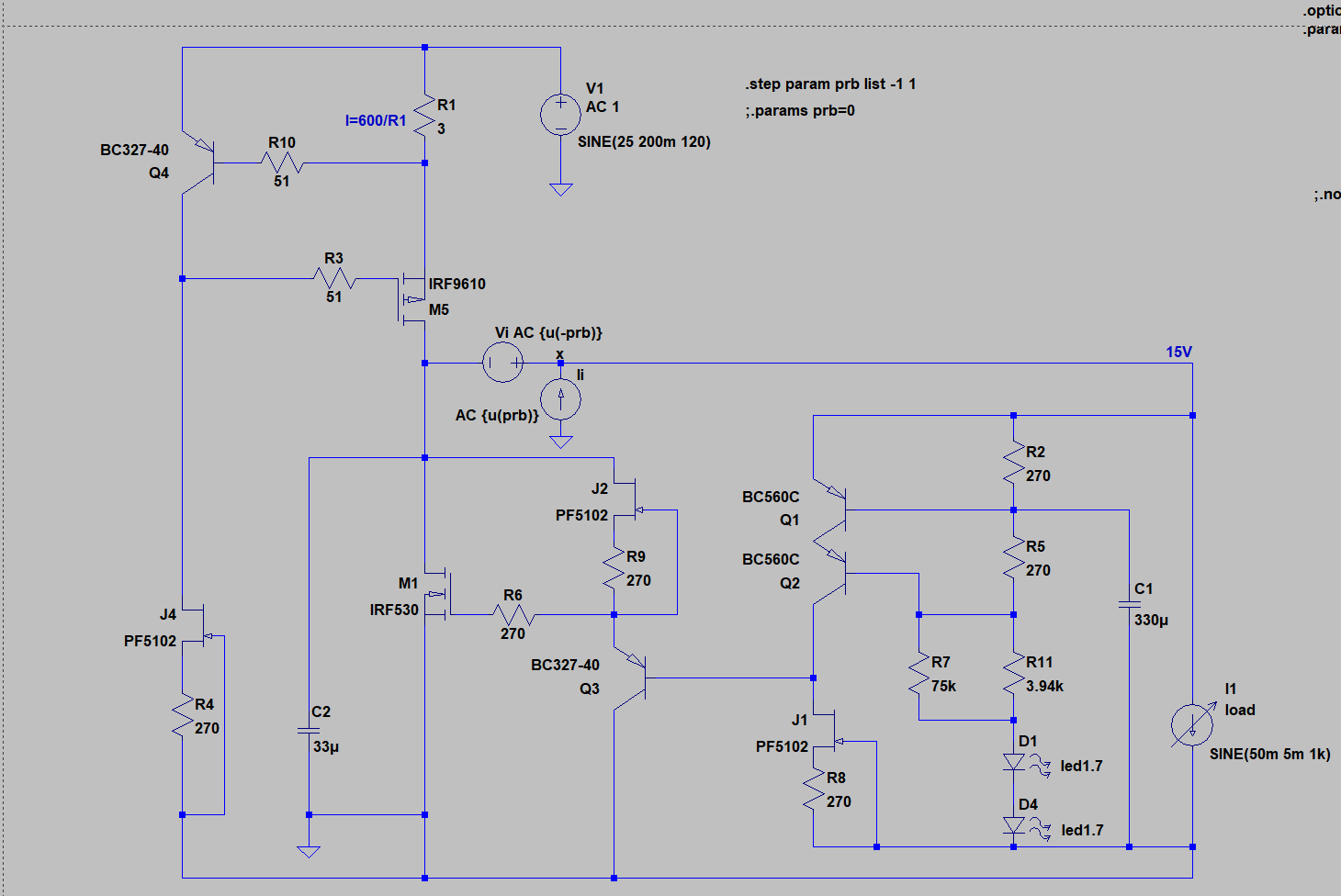

Yes, I saw this but I'm stressing you again - look for the NFB and follow it.
The CCS does not participate in the global NFB so there's no any reason to separate the CCS section and the voltage regulation one.
The NFB is in the voltage regulation part - just observe it thoroughly.

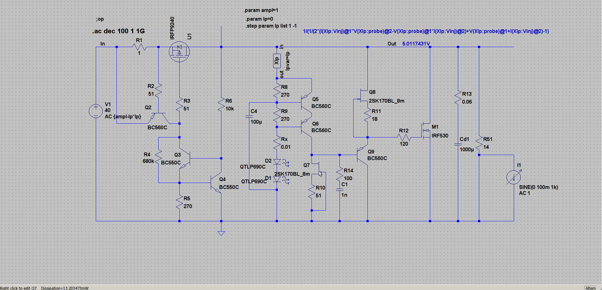

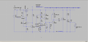

I see its at the same place as yours. The CCS and the CFP output section are on a same line and between that line and the Vref etc. there's a probe.
Yes, you're right. It was too late and probably I haven't looked carefully at your schematic.

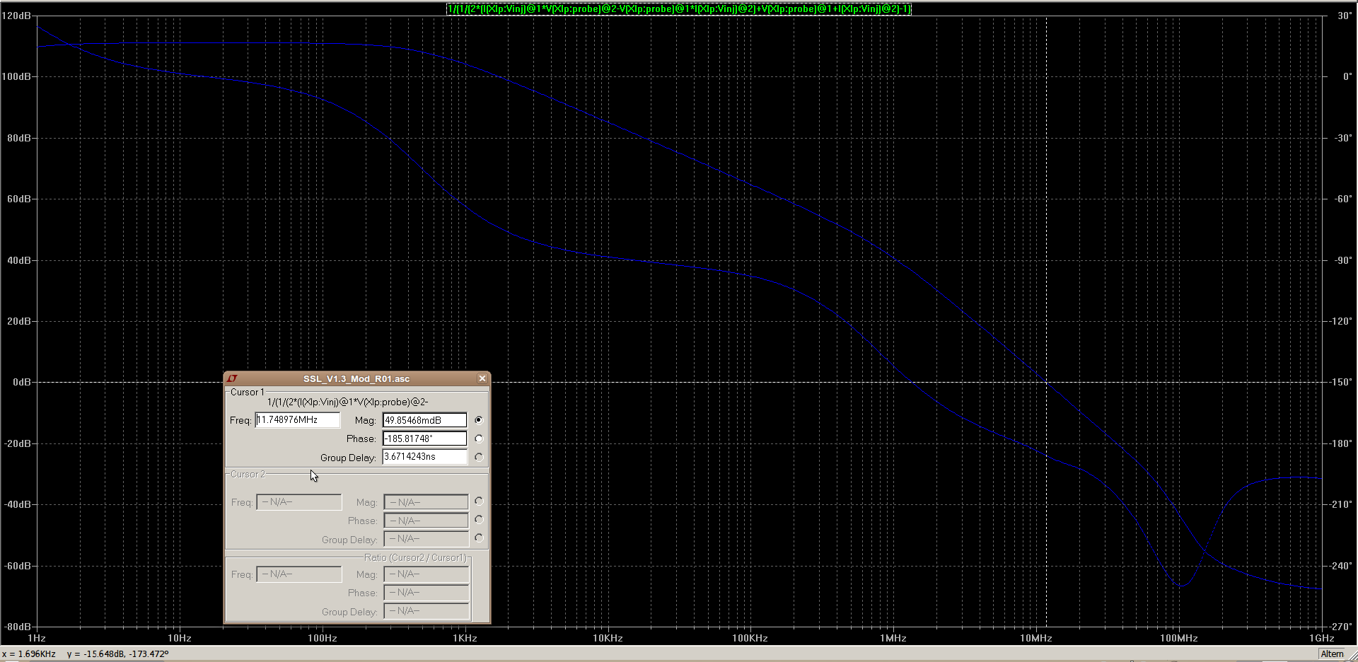

That's why I decided to correct my schematic as close to yours as possible, see picture 1.
However, no matter what I've tried I wasn't able to achieve your results - 11 MHz ULG and 80 deg. PM. My results are shown on the picture 2.
I'm not sure what's the reason for such big inconsistency in the results that's why I'm also attaching the Spice file I used for simulation - may be someone will check it and decide if I'm right or not.

Of course, thus rightly I couldn't see any difference in our probes placement. But no worries. Its the different drawing styles overall looks that perplexed you, but when looking again and thinking in nodes its clear. I don't have much time these days to go thoroughly through your analysis, but I will have a look at a point because its interesting to find causes. Maybe different semiconductor models (that you don't include). Anyways if I will manage to achieve analysis results approaching yours I will let you know the details. Others are welcome. In any case this line of regs goes several years back and the practical results are widely field tested. The new one is beta tested before introduced also.

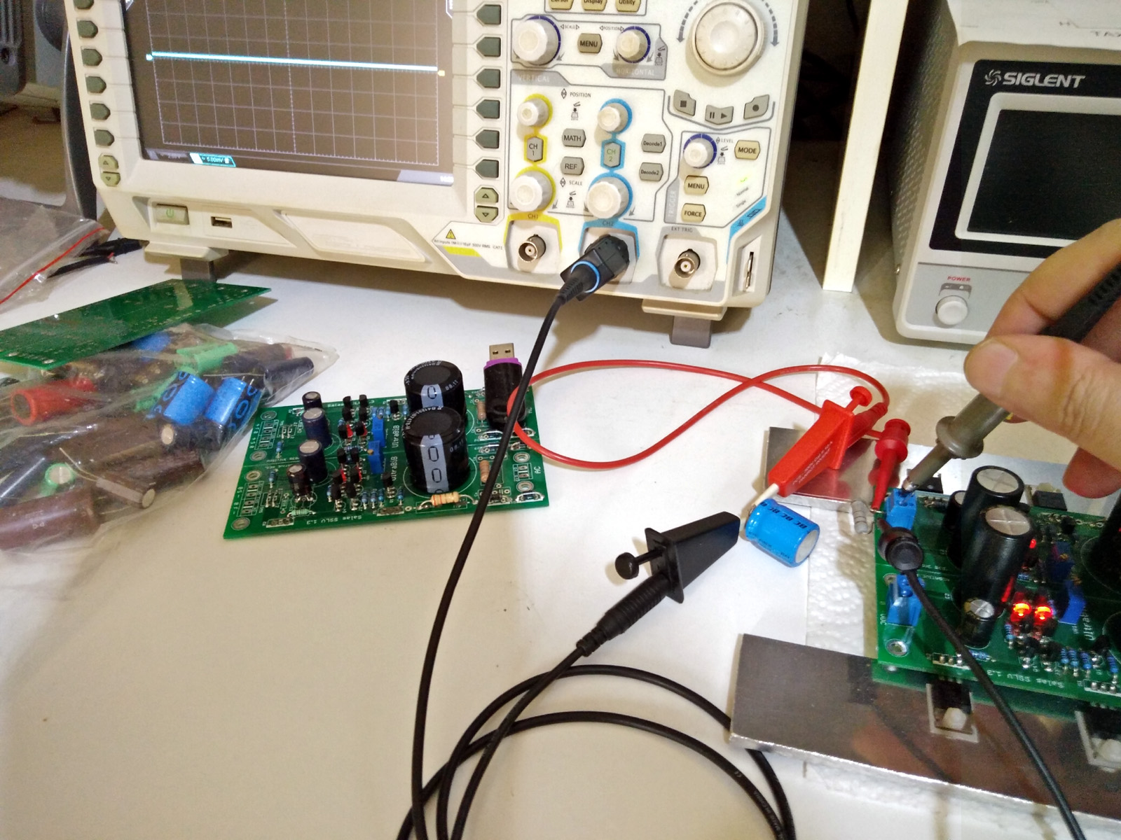

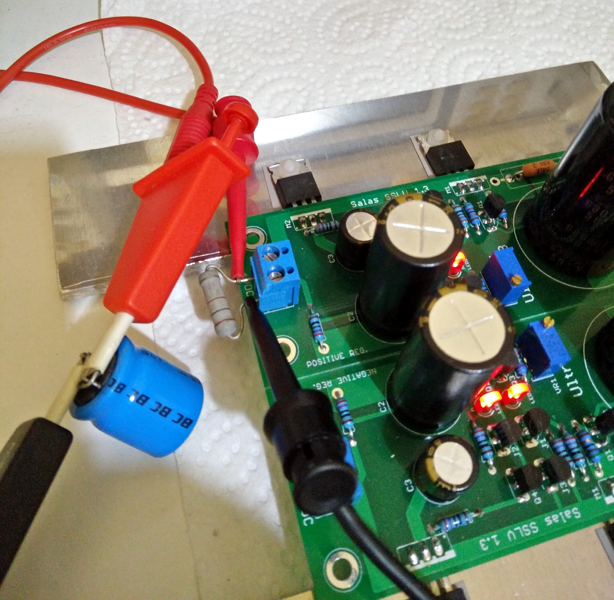

Here it is with 100Ω load and a 2200uF/25V BC cap hanging parallel on test leads. The reg not minding the silly situation at all merrily showing a flat line with the scope set at AC input 5mV/100uSec but to paraphrase a known sigline around here "Just because it can, doesn't mean you should" 😀

I don't like big capacitors after very low wide flat Zo regs especially because its a shame they hijack the situation to their own spec. Sounding always heavy IMO. In the previous versions we had RC film cap Zobel termination option even just to avoid big chemical caps if we could. In this one such a minimal option can't be had but when we can keep the regulated rail as simple and light as possible in any config I am a fan of such an approach. The reg alone should be able to give the energy needed fast and even to absorb kicks in case its a shunt type. Each one to their own persuasion of course.
