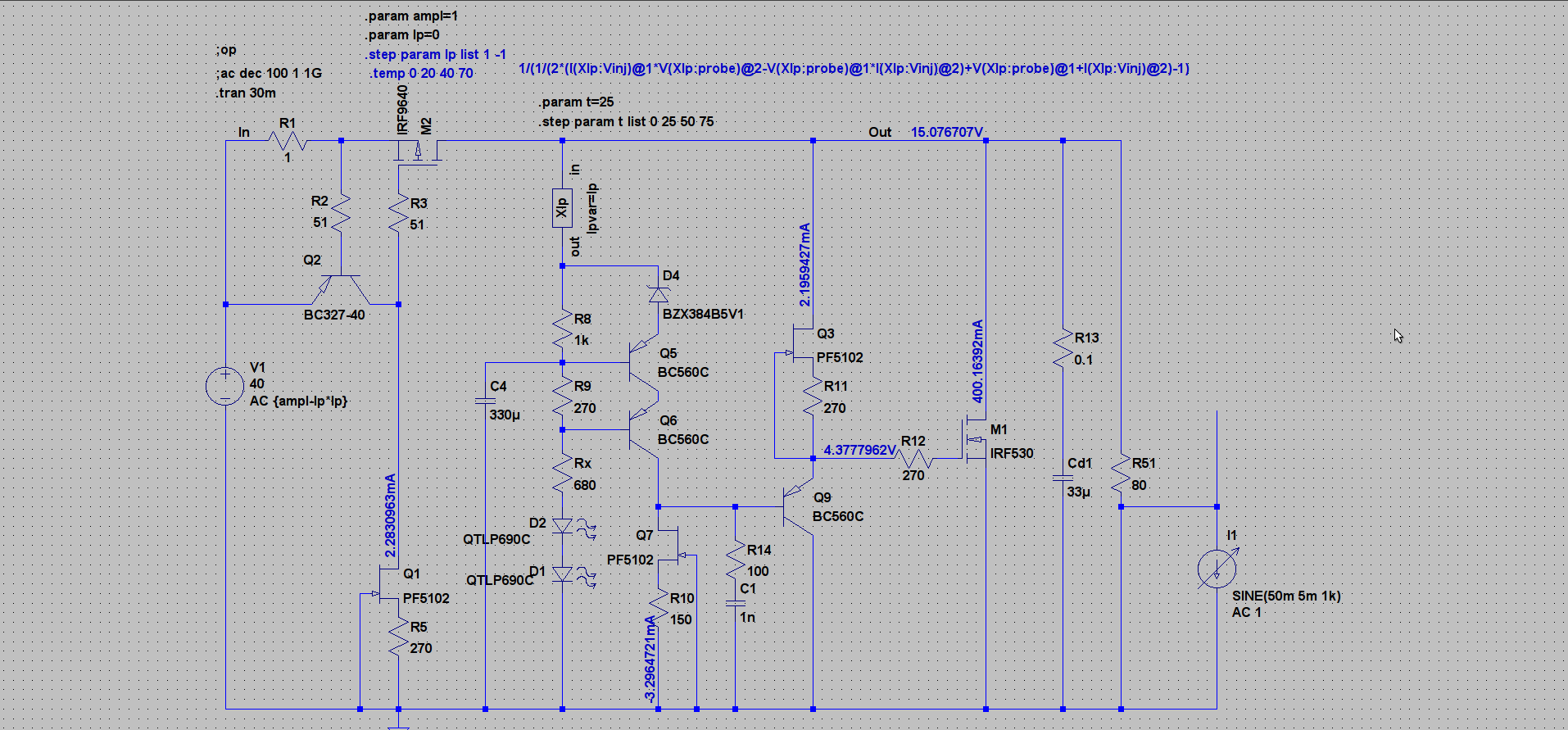

Hi Salas, All, Can you please help me to understand the working of this circuit.
(NAturally not the base is questionable, I know how a shunt reg works.)
But in this I do not udnerstand the Q2, Q3, J2 LEDs, and resitor parts. I know that the base role should be some kind of voltage reference, but don't get the point.
I remember in v1.2 a FET based fix current source simply feeded a resistor, and there a fix voltage could be counted, but here I simply don't get the point.
Q2 base is -0.6V from the top. Q3 base is -1.2 from top (on the 2 pcs 270 ohm the same current flows).
if Vout increasing the current on R5, R6, onVR1, and LEDs is increaseing . Q3 base will increase paralel with Vout (-1.2V).
Than Q3 will open more Q3 collector will "go" closer to Vout and Q4 close, and M2 close to, so Vout will decrease. That's fine.
But how does it give a fix Vout?
I don't understand

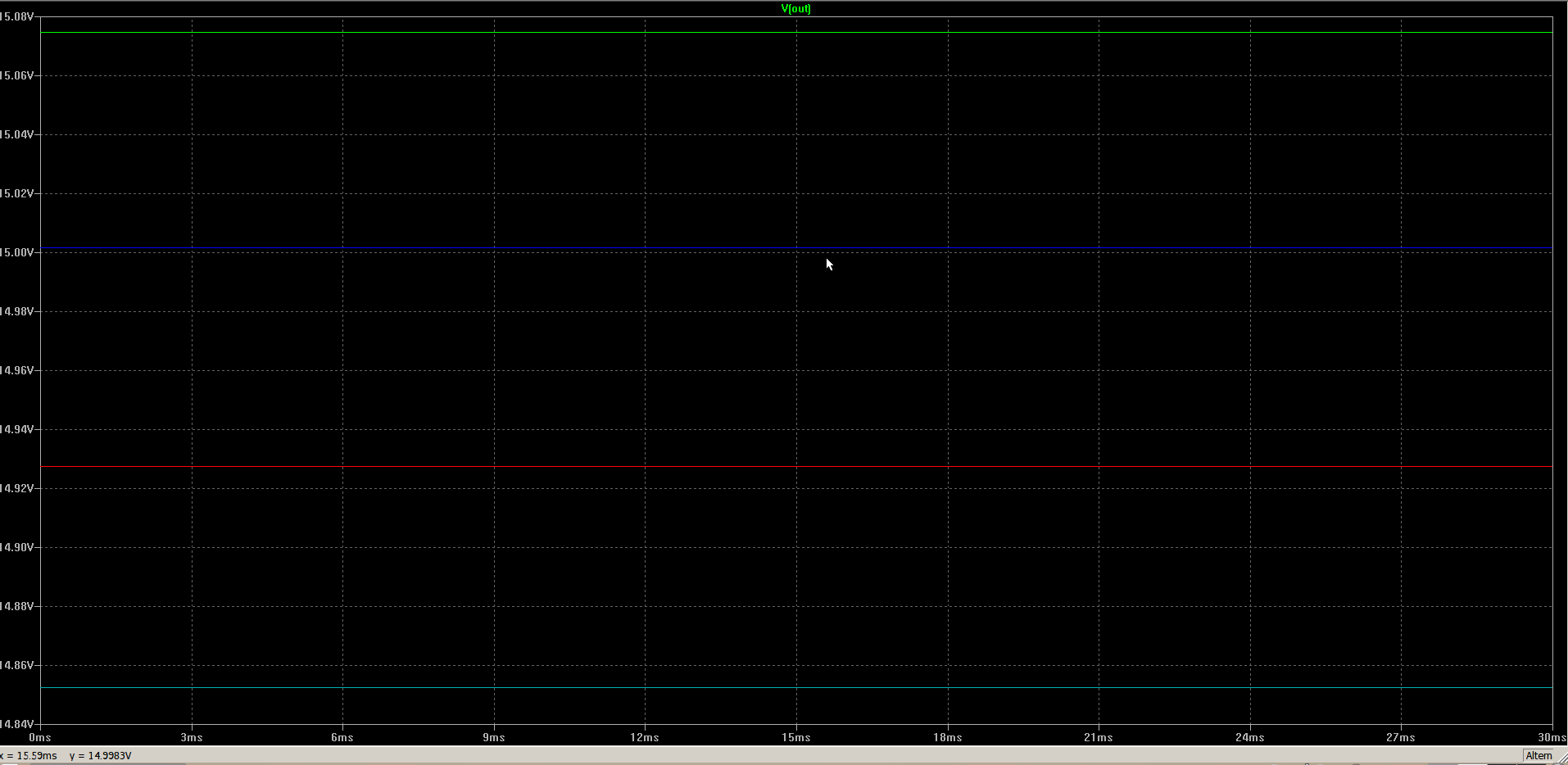

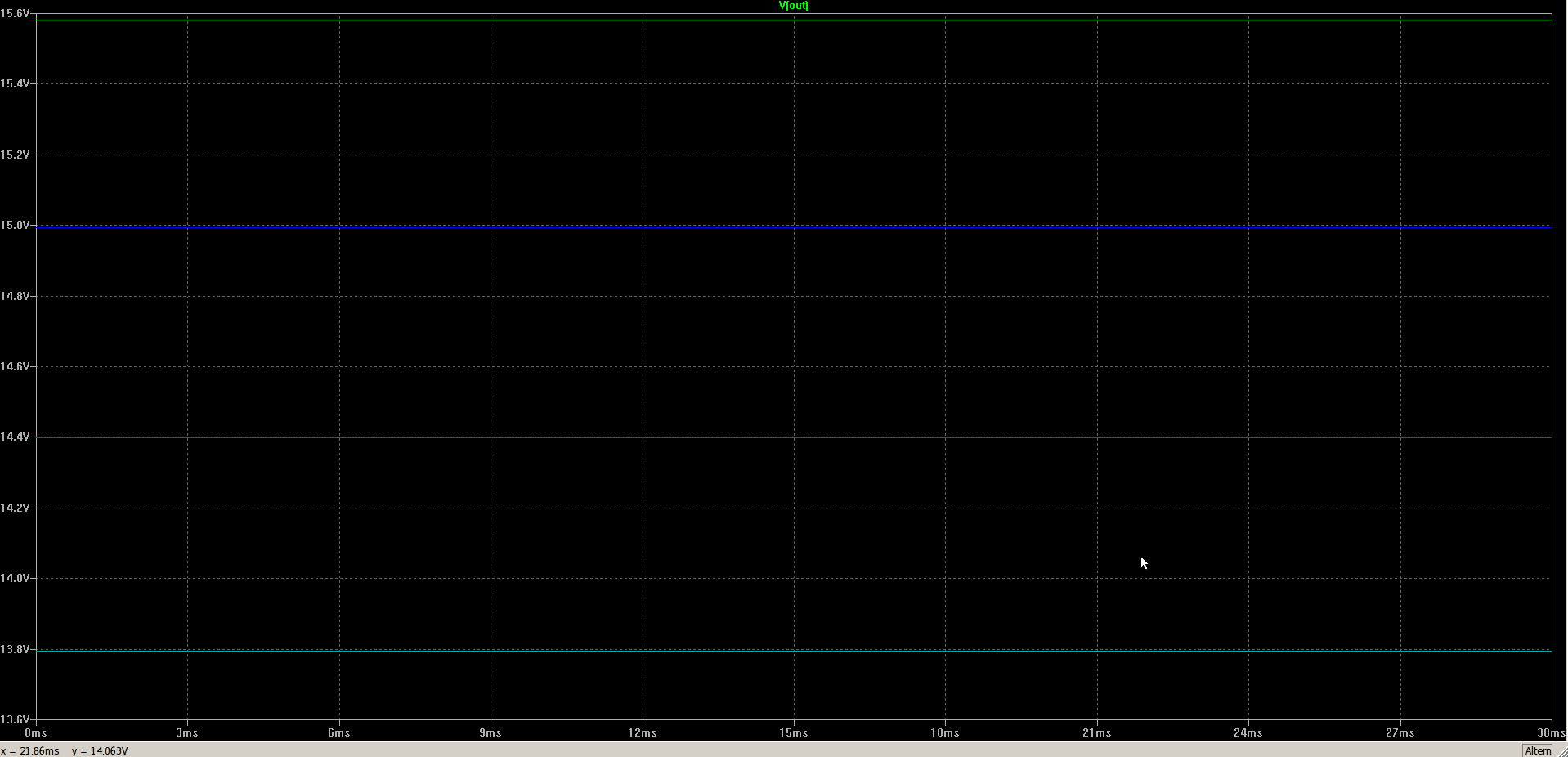

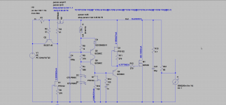

In one of my previous comments I stressed that this schematic has very poor thermal stability and this is normal since the voltage regulation relies to only a single p-n junction (which we all know is heavily temperature dependant). I did a simulation with stepped temperature 0, 25, 50, 75 deg. of the regulation transistor (Q5 on my schematic). On the first picture you can see the thermal drift of the output voltage - from 15.5V at 0 deg. to 13.8V at 75 deg. It's a quiet big difference, isn't it?
If a Zener diode is attached in the emitter of Q5, as shown on the picture 2, the things get better (picture 3) - from 15.08V at 0 deg. to 14.85V at 75 deg.

This zener will limit significantly the use of the regulator.
In practice it drifts -1 to -1.5% from cold to fully heated up after 30 mins. If it is set at 10.1V cold it ends up at 10V hot. If set when hot it ends up there again. That's all.
