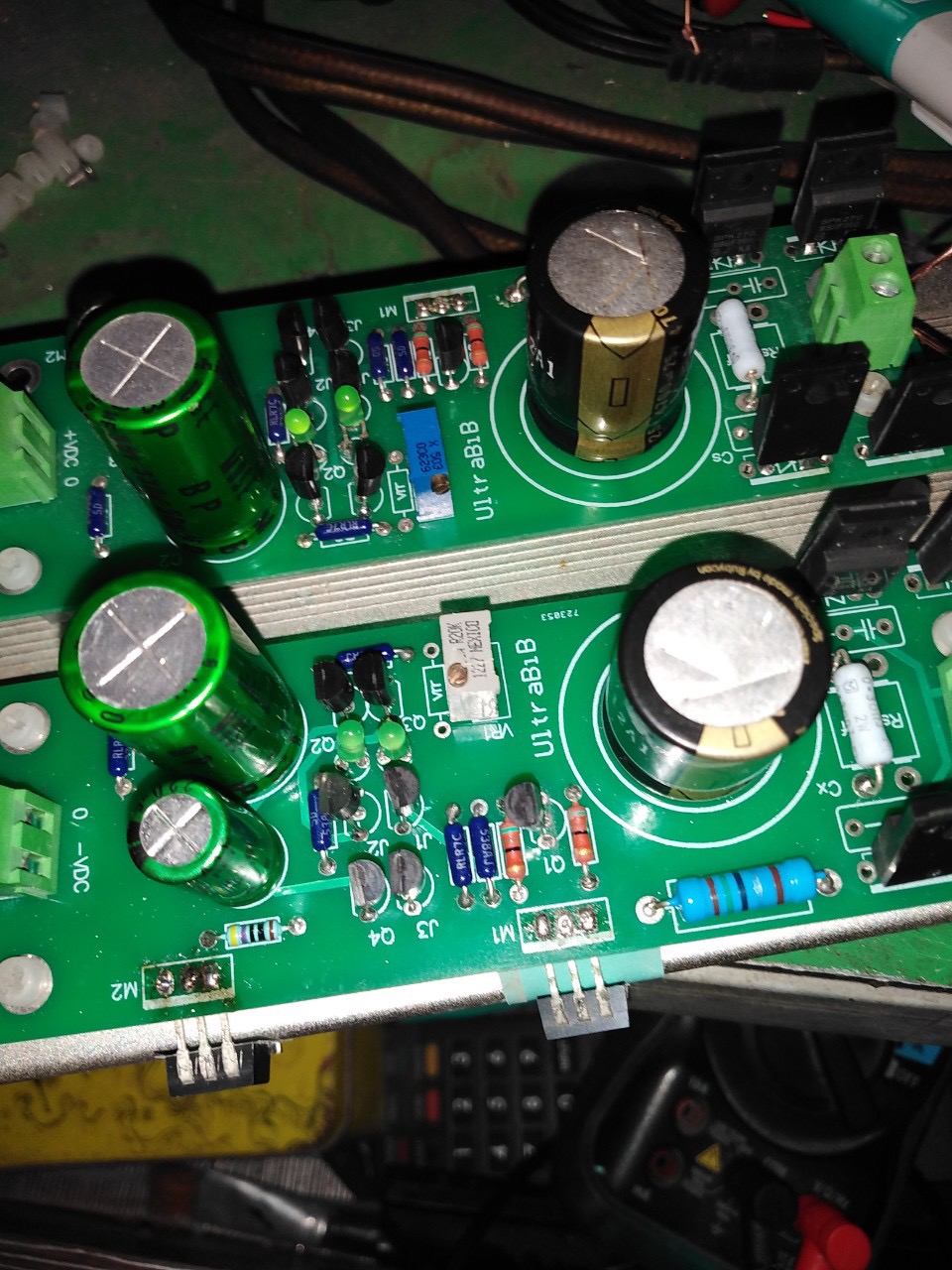

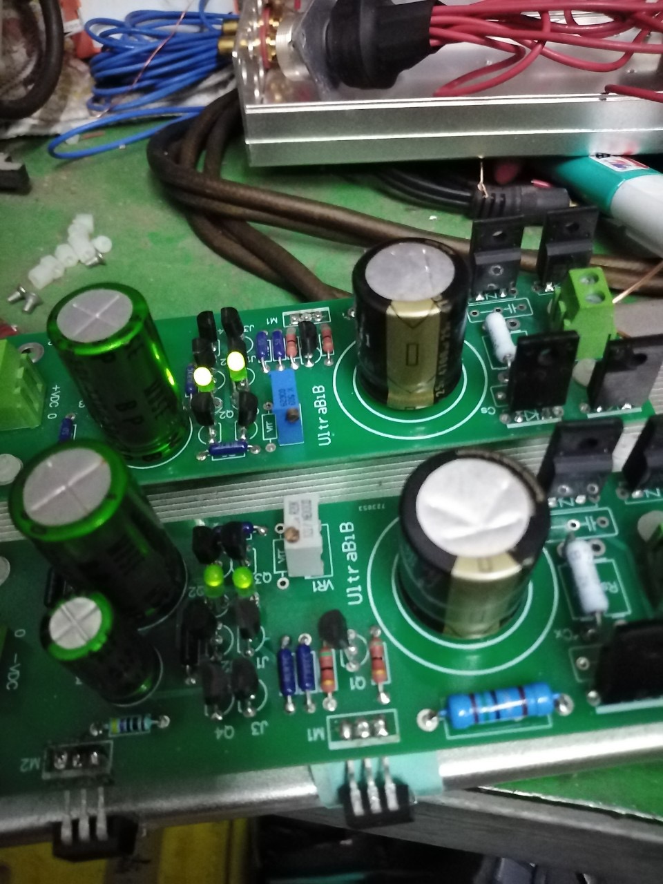

I get problem, the Led just dim with weak light, and I can not adjust output. Pls check the picture bellow and help me to fix it.

To understand better, you made boards of your own and positive works but negative does not? If yes, and you are confident about parts orientations, see if Q2 Q3 have good Vbe about 0.6V. If yes, next see if M1 has good Vgs 4-6V, M2 good 3-4V. Last if there is oscillation on the output. Takes a scope for that.
