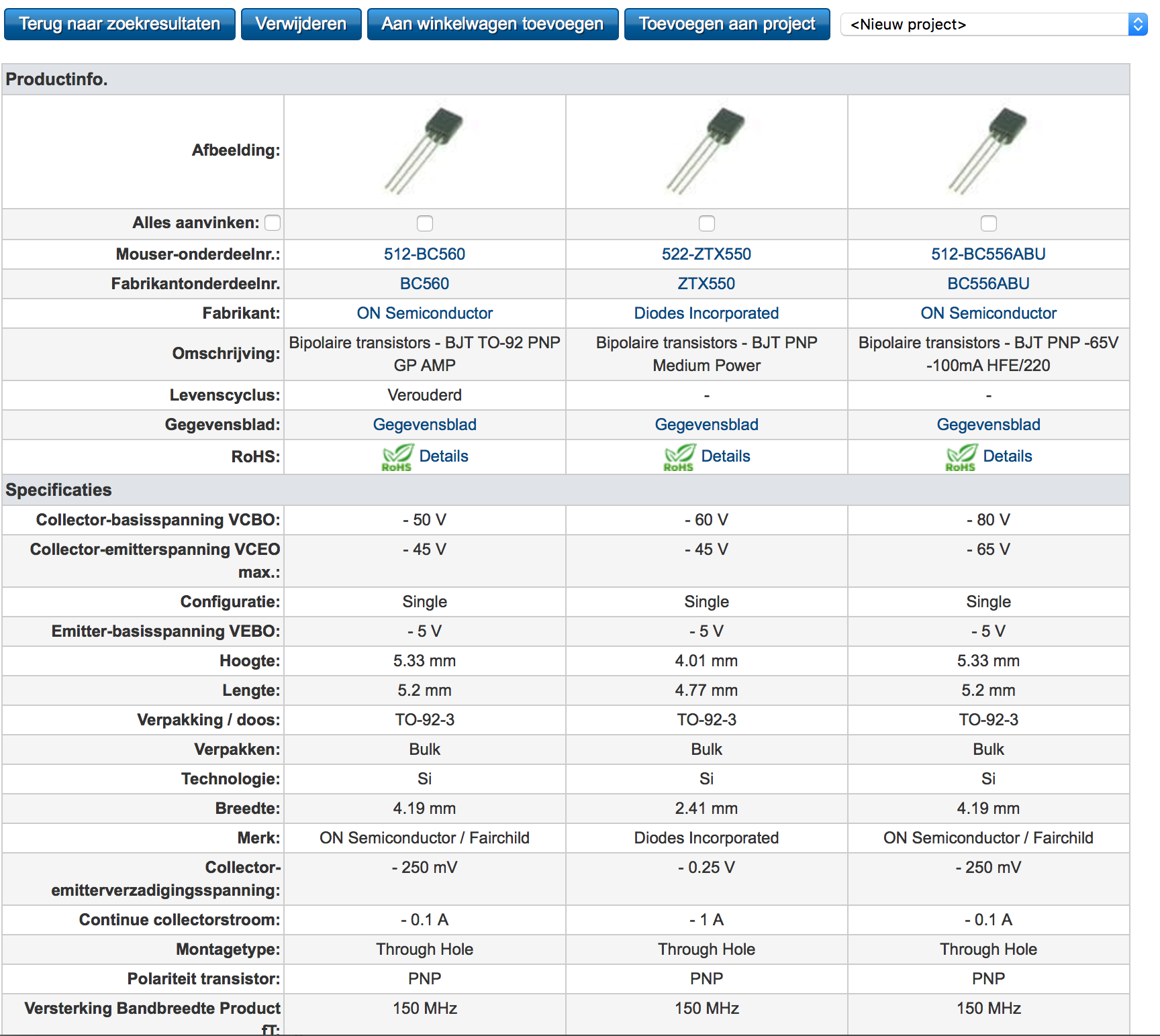

Hi Salas,
I am building one of your older SSLV1.1 boards, the negative PS.
It has a BC 560 listed but this is not available anymore.
I have found some alternatives on Mouser but am unsure which parameters are most important. Can you advise the best replacement?
See attached selection.
