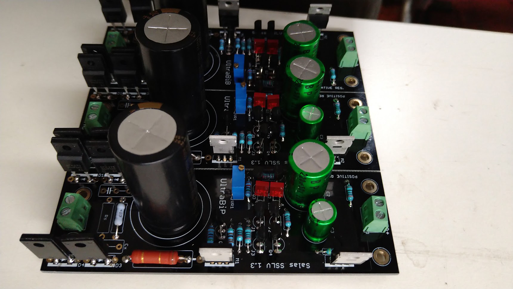

I just got my boards ready. And fired them up (with heatsinks) works well. Configurated for +-5V+5V. Will be driving Soekris DAM1921. So i tested load with 33ohms for ladders and 16,5 for digital. All works well and absolutly nothing to measure at (my analoge)oscilloscope. Thanks Salas for a good solution 🙂
Is it possible to make a dual power supply using 2 positive boards, connecting 1st board V0 to 2nd board Vout+ ?

It is possible when connecting them like batteries in series. Using their midpoint as virtual ground. That configuration demands independent transformer secondaries and independent bridges that SSLV original PCBs are already designed for.

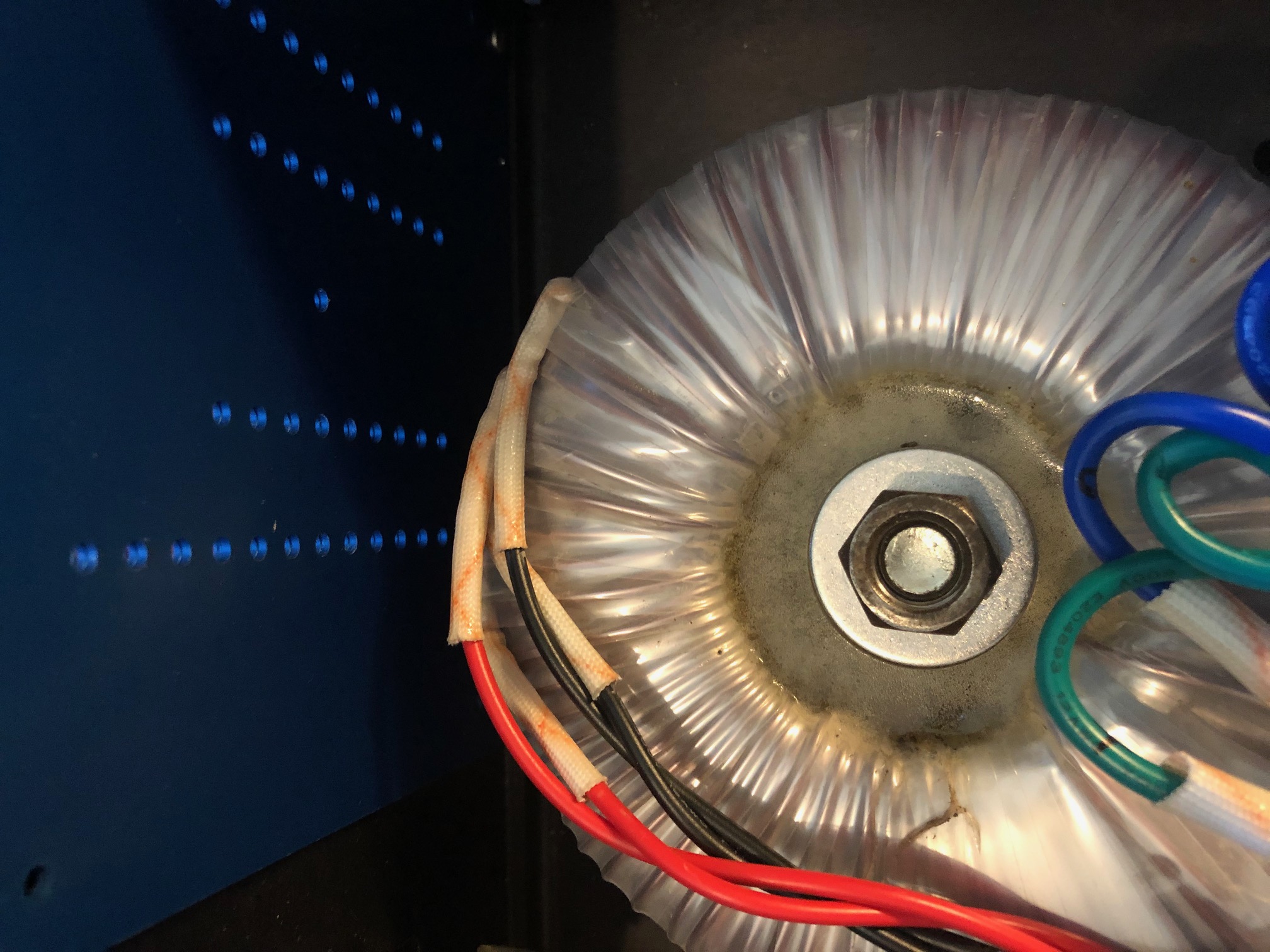

All these transformers come with a steel mounting bolt and cover. Any thoughts on whether nonmagnetic stainless hardware makes a better choice?

I don't know enough of their mounting hardware details.

I use the Antek transformers in most of my builds. Instead of the two rubber pads and the metal plate, I tape off the bottom with packing tape, mix up a small amount of epoxy and benotite (oil dry) and pour the thickened mixture in the center to about 3/4 of the way up. When it hardens, I drill a hole in the center for the bolt (what ever material for the bolt you think is best) and use the rubber pad on the bottom. Make sure the hole is drilled prependicular. The epoxy does not support combustion like polyester type resins do. I believe this is the same procedure that Avel Lindberg uses.
