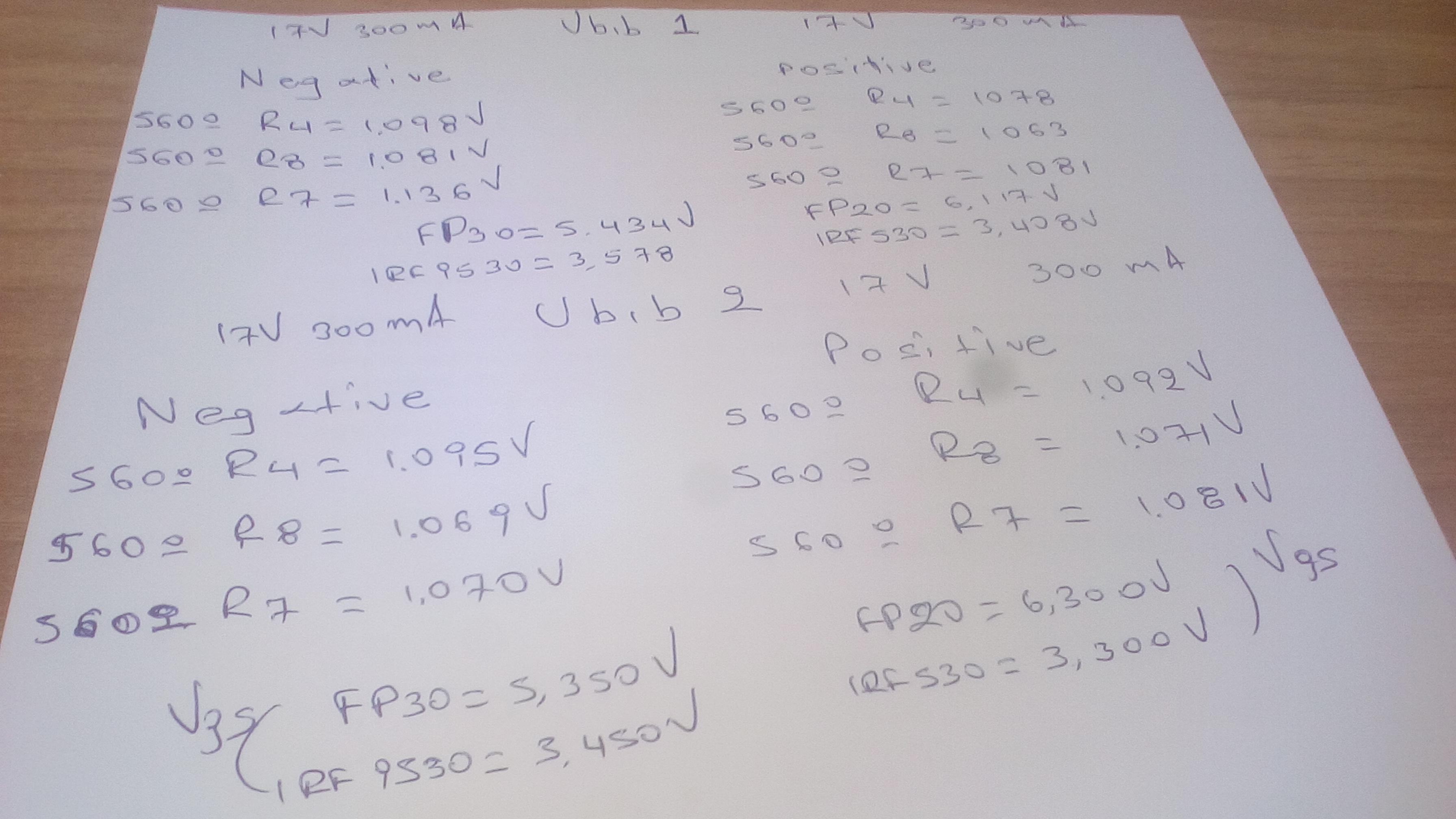

Nothing wrong with it, electrically very close to the original. But I would rather suggest WP113IDT as closer in shape also.
Nicely consistent DC measurements in the various semiconductors. 560Ω degeneration resistors instead of 270Ω are for J113s instead of PF5102s we should also notice.
I thought of the higher than standard max output voltage capability modifications for Greg 🙂
1. CRD diodes Semitec E-501 (100V 300mW 0.5mA current regulative diodes) instead of J1 J3. Soldered from drain pad to gate pad replacing those two PF5102. CRD's cathode goes to gate pad is the orientation. R4 & R8 may remain as they will be skipped out of circuit by that action anyway.
2. BC556C BC546C (and B) instead of BC560C BC550C for Q3s
3. 470R instead of 270R for R5 R6. 330R instead of 270R for R7
4. 50K VR1 330K VRR instead of 20K 75K respectively
The above modifications should allow for 5V to 65V adjustable Vout range. Or 5V to 50V if VRR is 100K. Watch the capacitors DCV spec regarding the new higher AC Tx secondaries and new higher Vout range, also remember that the M2 MOSFET will dissipate more as the output voltage goes higher.
