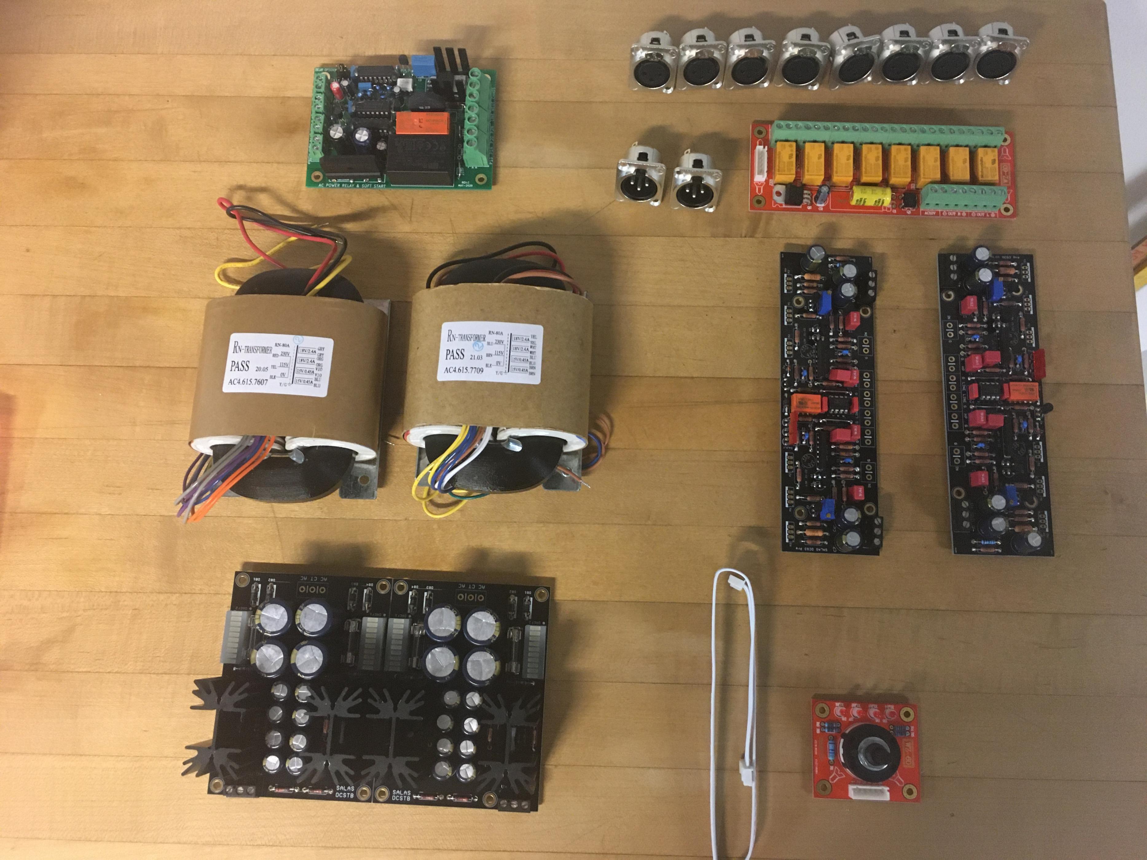

Hello Salas -
I bought a pair of DCG3 preamp kits from Tea-Bag to make a Balanced version. Tea-Bag was kind enough to match the 2 kits for me, I have a pair of R core transformers and just finished the relay control for the XLR inputs. The relay control uses two double relays per channel, so that both phases of each channel are switched.
I have three main inputs, two have Balanced XLR outputs and one, my FSP has single ended RCA's.
What would be the best way to wire the FSP to a Balanced DCG3 preamp? I have RCA to XLR adapters, yet I would like to have a pair of RCA's hardwired to the preamp inputs.

@elwood625,
Could you show a pic of your DCG3 separate PS box. Just starting on mine.
Thanks,
Don
I only have the preamp section chassis, I'll select the power supply chassis after I finish the 12vdc regulated supply.
Here is a pic of how far along I am.
