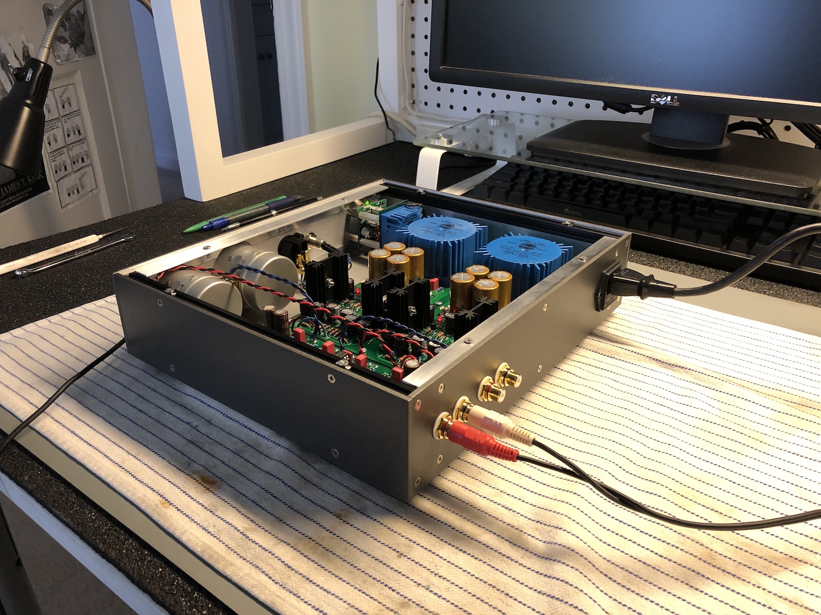

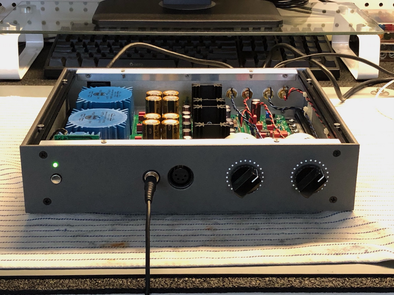

I delivered the amplifier to Kevin this evening. I'm leaving it to him to make a top cover.
I made some improvements this time around. I used MakerBeams instead of solid rails. They're super-cool and save a lot of building time. I moved the PC boards to the rear and reoriented the attenuators so the back cover latches are accessible. This will allow the contacts to be serviced. I installed a dedicated transformer for the relay board and, per Kevin's request, I put in an industrial-strength 3.5mm audio jack and left out the selector switch. Overall, I tried to do a cleaner and more precise job on the construction.
-Henry

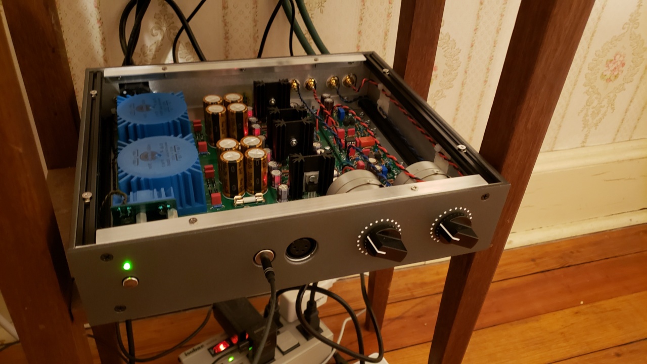

I'm thrilled Henry built this for me, I listen to music almost every evening and the DCG3 he built for me was a huge step forward from the amplifier in the DAC which is unlistenable since the DCG3 arrived on the scene.
It's very compact and fits into the limited space I have available and looks awesome doing it.
It is at a level of build quality that I would not be able to match. The entire chassis was designed and hand built from scratch, and to a very high level of quality, it is solid and non-resonant. It also has the industrial chic that I groove to.

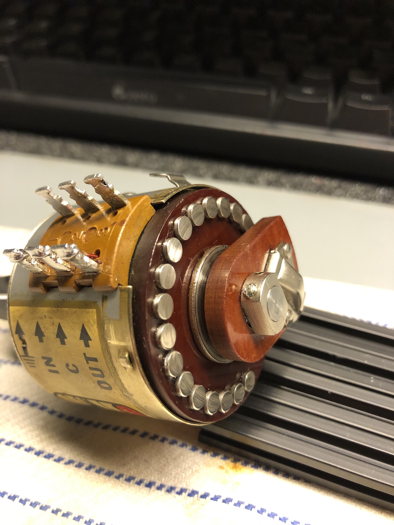

Immaculate build. Great looking casework. What are those two pots bulging out?

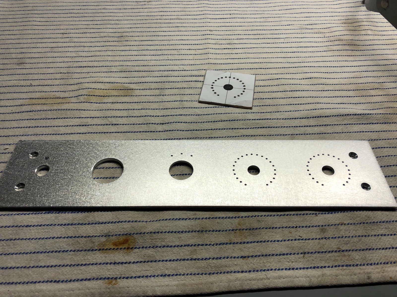

Since building chassis from scratch, the biggest "hurdle" I've found is really surface finish on the panels—I'm working with raw aluminum—putting whatever finish on it I want—level of brushed-ness—and waxing it in the end—it's not easy—are you working with pre-anodized sheets? Or anodizing? The material looks to be a gunmetal color. Printing on the front? Thanks!
The attenuators are vintage Daven units that I modified using a custom PC board and SMD resistors. I had a few of these in the closet -- two are in a friend's tube preamp now and four are in the two DCGs I built. There is pressed-in pin holding the rotor to the shaft that is almost impossible to remove. A friend of a friend found a way to remove the pins, but were I to get more of these -- they are becoming rarer and much more expensive -- I would have to find another machinist to help, or invent a tool to press out the pins. Also, on one of the units in the last batch the contact spacing was slightly off, making it hard to press on the board. This, in turn, skewed the contacts and I had resurface them to get the wiper to slide smoothly. In the future, I think I will need to find a different kind of switch.
The dots on the front panel are just little pits I made with a drill, filled with acrylic paint. I used Rustoleum self-etching primer and flat metallic paint for the finish.
In the past (e.g., my first DCG3) I've used 3/8" square stock, drilled and tapped. MakerBeam is easier, though the little sliding nuts aren't cheap. This time around, I used 1/16" angle stock and self-clinching nuts for the front and rear rails, which was also a time and cost saver.
I'm getting tired of building the same box, need to come up with something new to challenge me. My machine shop consists of a cheap table saw with a non-ferrous metal blade, a drill press, and a file. Decades ago, I worked for a company with a shop that had a bandsaw, a belt sander, and most important, a Bridgeport mill. That was fantastic, and I also enjoyed being young and better looking.

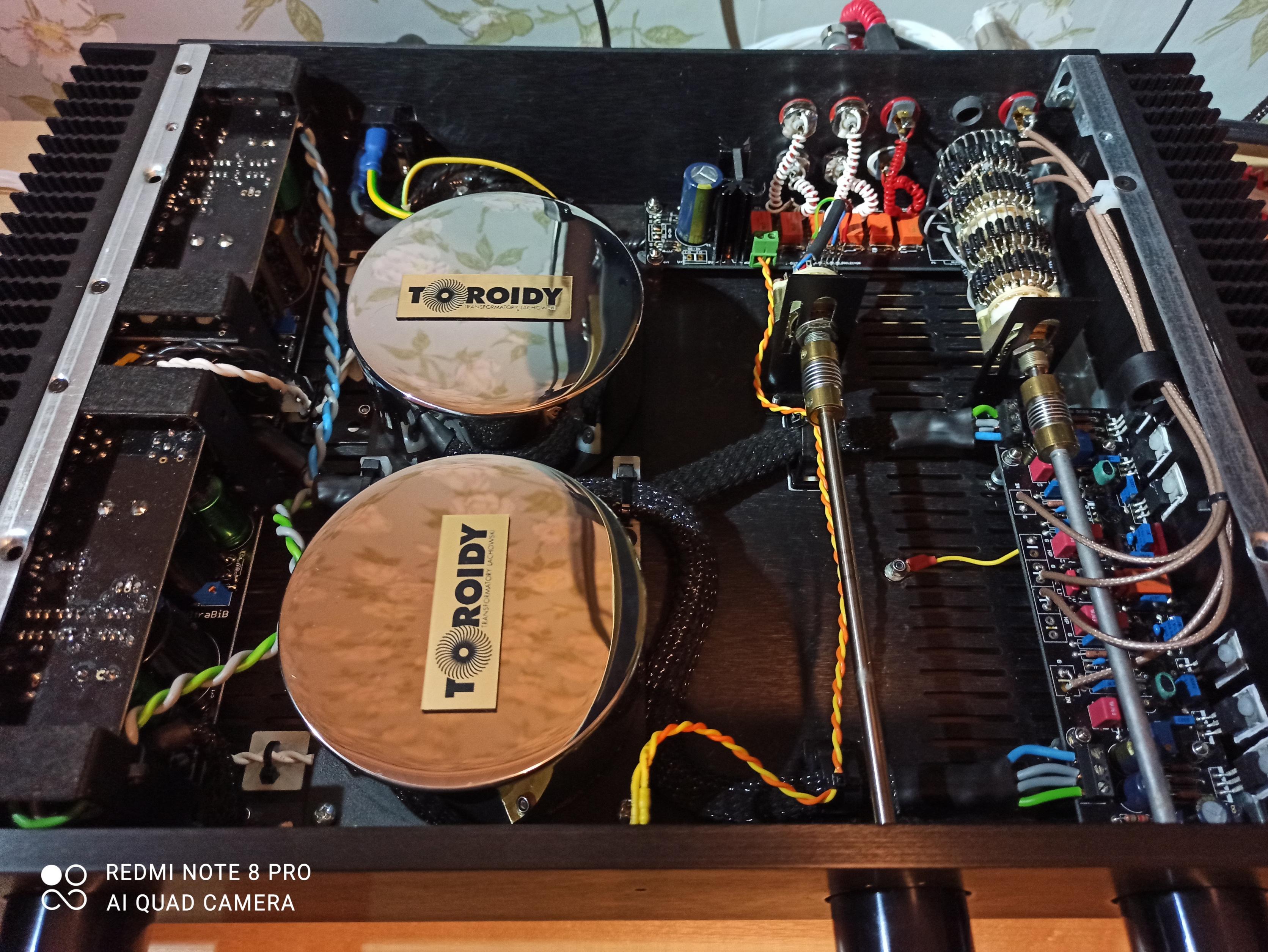

This is the v2.0 of this fantastic amp. I was pleased with my first build, in fact so much so that I build an ”all in” version.
Ubibs and 2SK170 (4x9.16 mA) and so on. This is so good now. Dynamics is better, bass is punchy and extended and the biggest thing: highs are like silk but still sharp.
Im very, very impressed!
Thank you again salas!

You are welcome. A very nice fully kitted out build. That spiral "shield" signal cabling technique I have seldomly seen only from some UK technicians. Interesting to see it in your builds.
