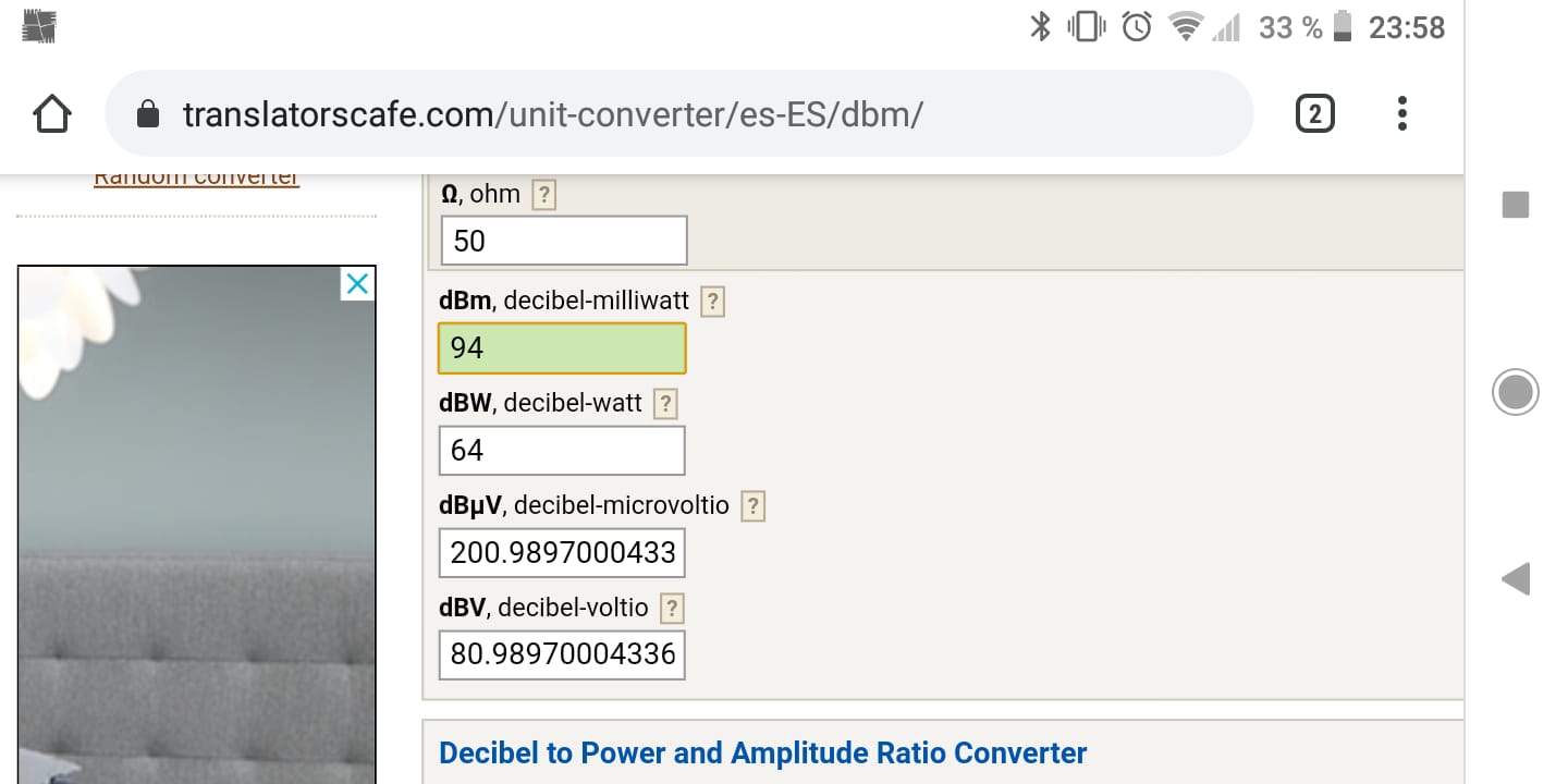

Please what gain for my headphones of 80 dB/V, planar magnetic transducer and 34ohm.
Now I must turn volume dial up to 9 out of 10 on headphone. Line output volume is much better at 5 out of 10 (on a 5x gain power amp)
Current settings on DCG are 3x gain and 150mA bias.
80dBSPL @ 1V sensitivity headphones need a 30W at 34 Ohm amplifier with +/- 45V rails and 24dB gain for 110dBSPL
Are you sure they are such a heavy a load?
If on the other hand they are 80dB/mW then 1W is enough for 110dB and that's possible if driven balanced from double DCG3 with 1.2W capability. Gain setting 6X should be compatible.
morning Salas
from specifications: 34ohm / sens 93dB / mW
I filled as in attach below.
Just wanted to balance amplifier and headphone loads more even in the middle of dial.
Anyway DCG3 can drive both loads, despite turning up and down the knob each time, no complains, sound is amazing no hum at all, even at 10 to 10 pot dial, .
In audio dBm is ref to 600 Ohm. When finally 93dB/mW sens (much more normal no need for double dcg3 bridged/balanced) try 5X gain.

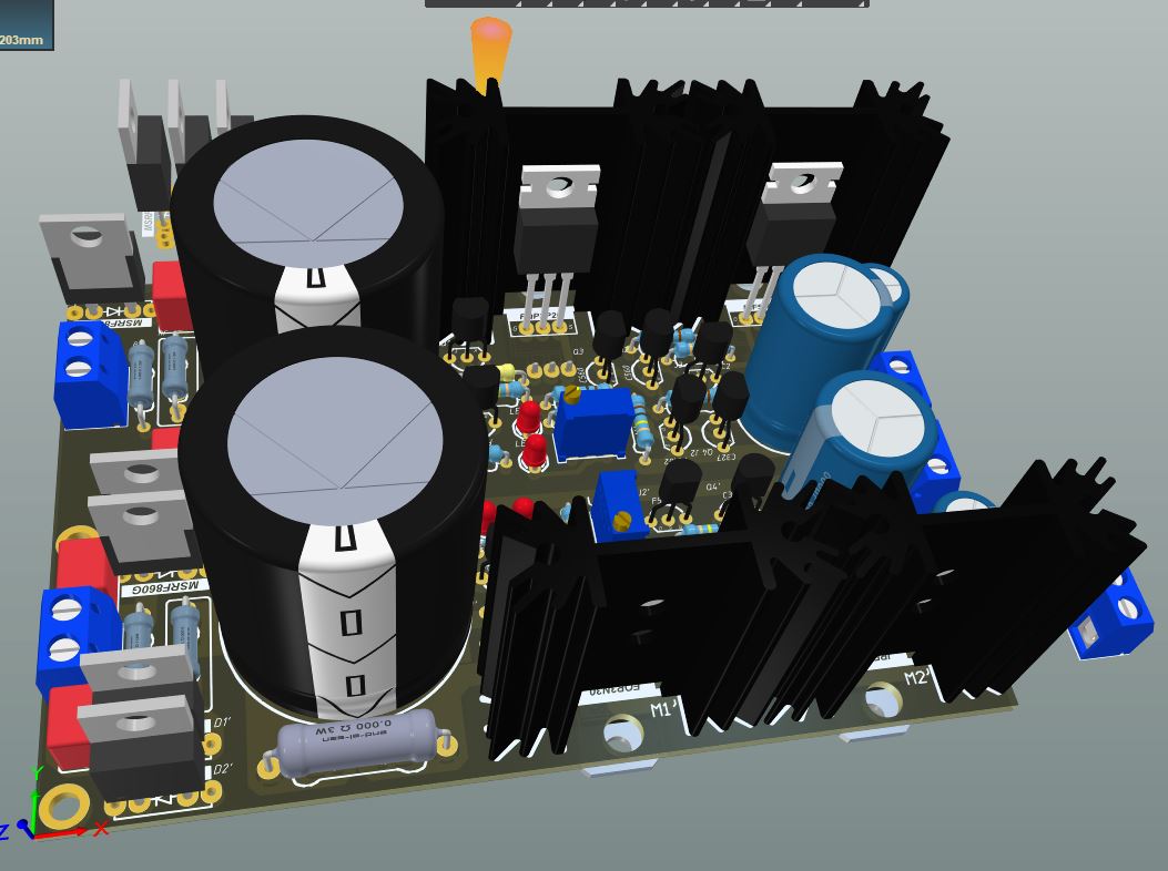

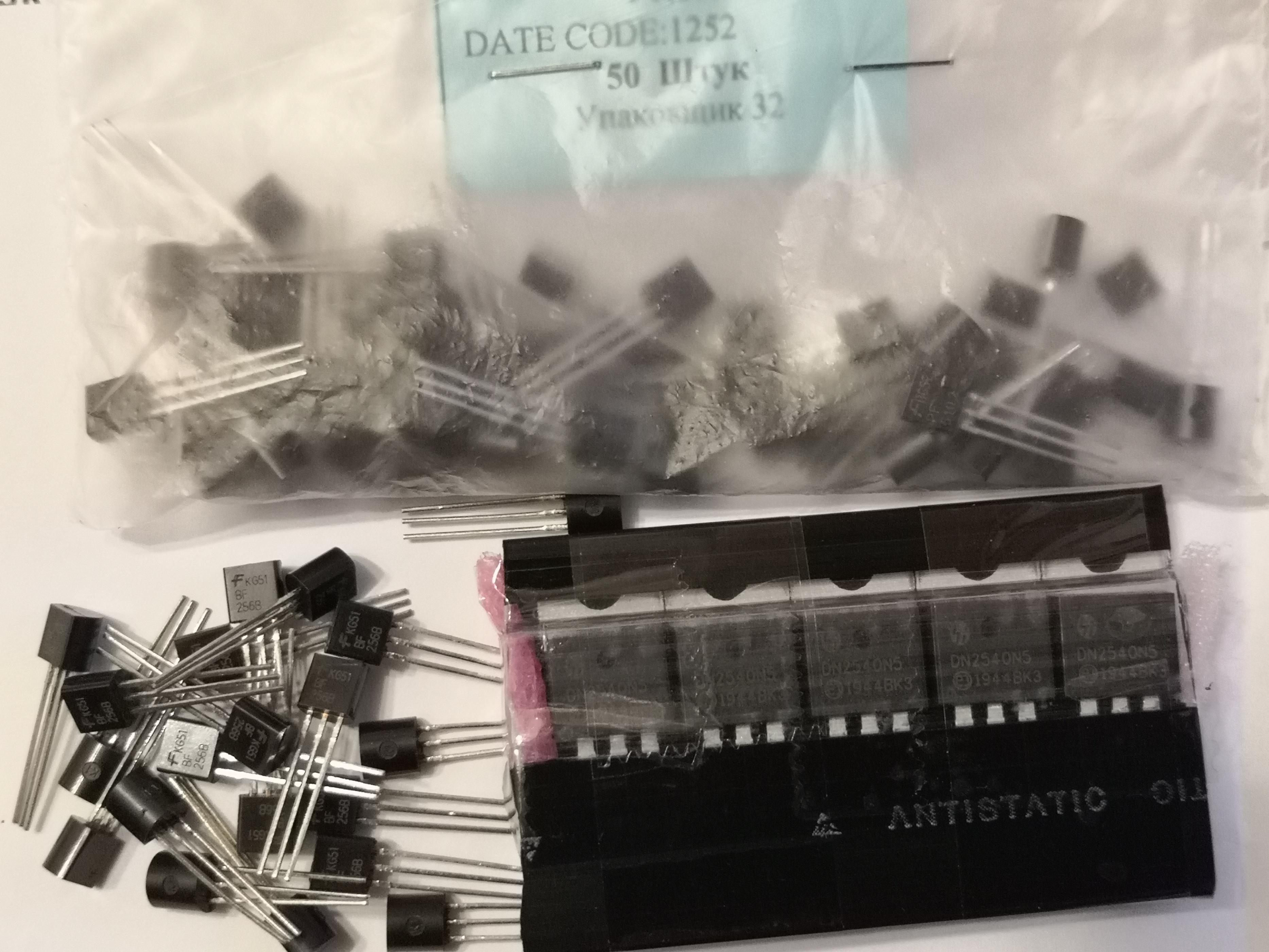

Hello, I received the ordered parts. Tomorrow I will test the necessary parameters. BC327 transistors from DIOTEC 50 pieces. selectively measured 10 pieces of hFE 450-470. Close enough you can choose. Who has such transistors, you can check whether the transistor pins are magnetic with an ordinary magnet ( I read about this method of checking for originality) My BC327S are magnetic. I ordered earlier MPSA42/92 also magnetic, there were no complaints about the work. Transistors BF256 and PF5102 are not magnetic. I'm making my UBiB1.3 board to power the preamp. there is a great desire to place the radiators on the board, but there were doubts about the size. Tell me the acceptable dimensions for radiators with a bias current of 100-110 mA. Thanks.
Such sinks will go very hot in shunt regs. This reg type works like a heavily biased Class A amp. Consuming as much as it gives out or more. If you can accept high sinks temperature it also takes very good ventilation not to impact a box's internal ambient temperature too much. And to use 105C or 125C capacitors in the vicinity of the sinks of course. M1 & M2 themselves can work at near boiling temperature but with a shorter life expectancy. Use three to four times better thermal capacity sinks.
