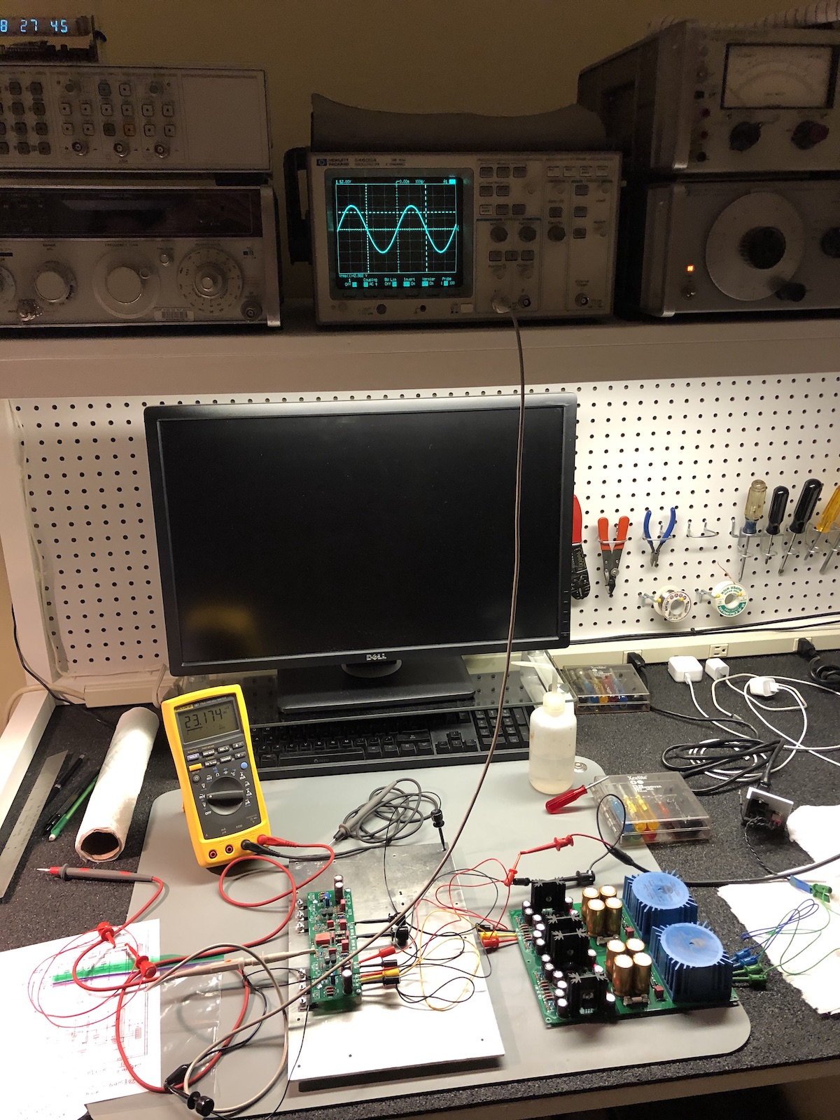

I got unit #2 running last week and built up a little breadboard over the weekend. I was getting a lot of hum and noise, and clicks when I plugged in the phones, but only with the sensitive PX-100s, not the AKGs. It was also really sensitive to hum pickup from the cables and power cord, and didn't like running from the Topping/RPi with wall wart power, though it was quiet with my AMB Gamma2 running off of battery power via my MacBook Pro. Touching the chassis would greatly modulate the noise level, as would putting my fingers on the JFETs.

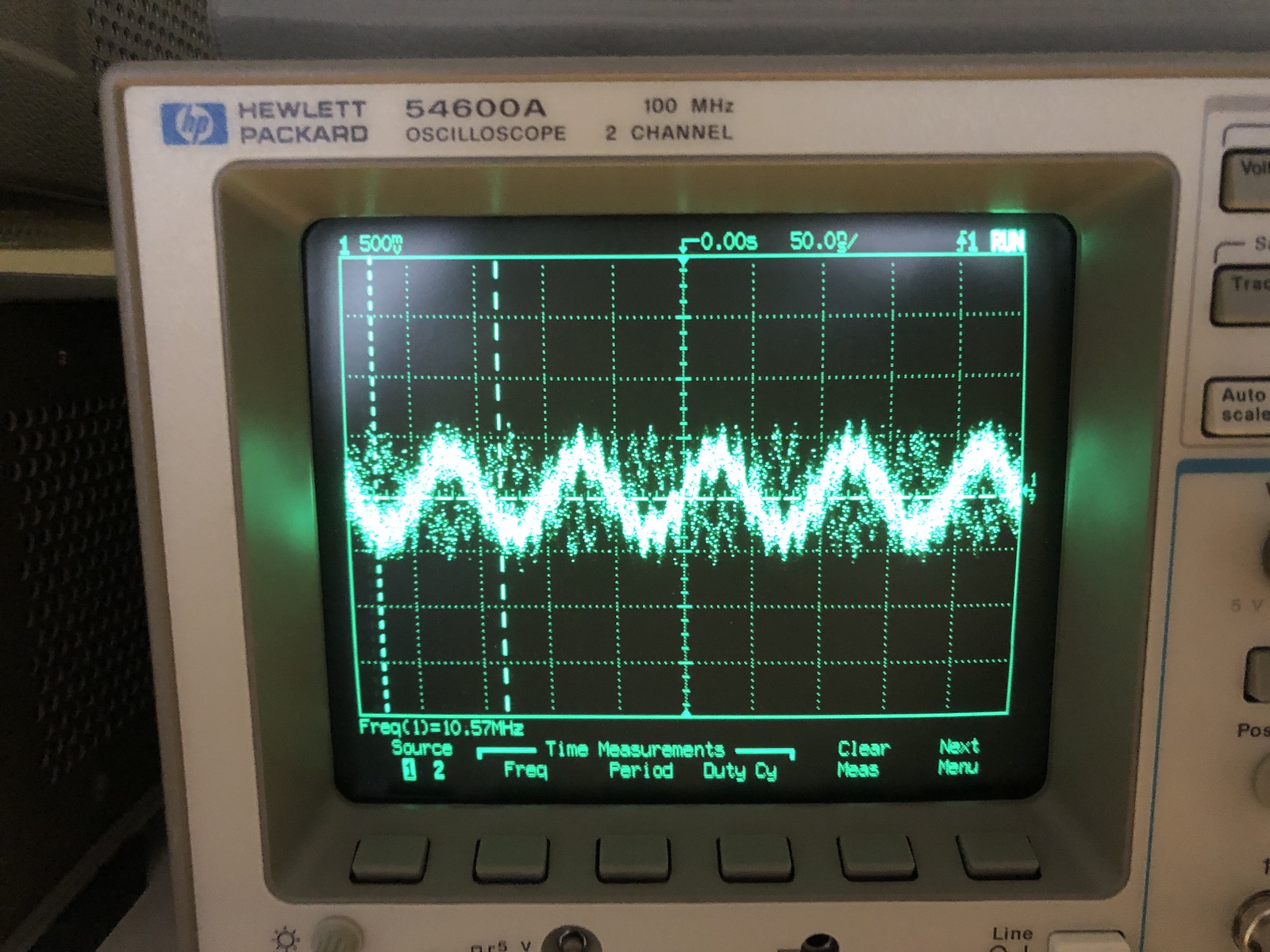

After driving myself nuts fooling around with grounding and fretting about common-mode noise, I finally went looking for instability and found a low-level oscillation in the 10MHz range, like with the prototype. I had routed the signal wires under the board which, in retrospect, isn't too bright. So I took everything apart and moved the wires above-board. I also moved the connector block away from the output stage. I was sure that would fix it, but the oscillation actually got worse. So I went and installed my 22pF compensation cap mod as suggested by Kevin Kennedy and that killed the oscillation straight away. Closed-loop bandwidth stayed the same, about 2.5MHz, with or without compensation. Hum was still noticeable, but consistent and not affected by touching the chassis anymore. I moved the connectors back to the edge of the chassis (away from the rectifiers) which helped, and then I wrapped the wires in aluminum foil which I connected to ground, and that dropped the hum down close to the residual hiss level. This is with a wide-open input and no attenuator.
DC offset is in the range of 1mV or less. I think the click when I plugged in the phones was caused by the servo loop getting a jolt when the oscillation started. Again, there were no issues with the higher-impedance AKG phones. Listening with the AKGs, I heard no difference with compensation.
This is all a little peculiar because my prototype oscillated with no load, but settled down when I plugged in the PX-100s.

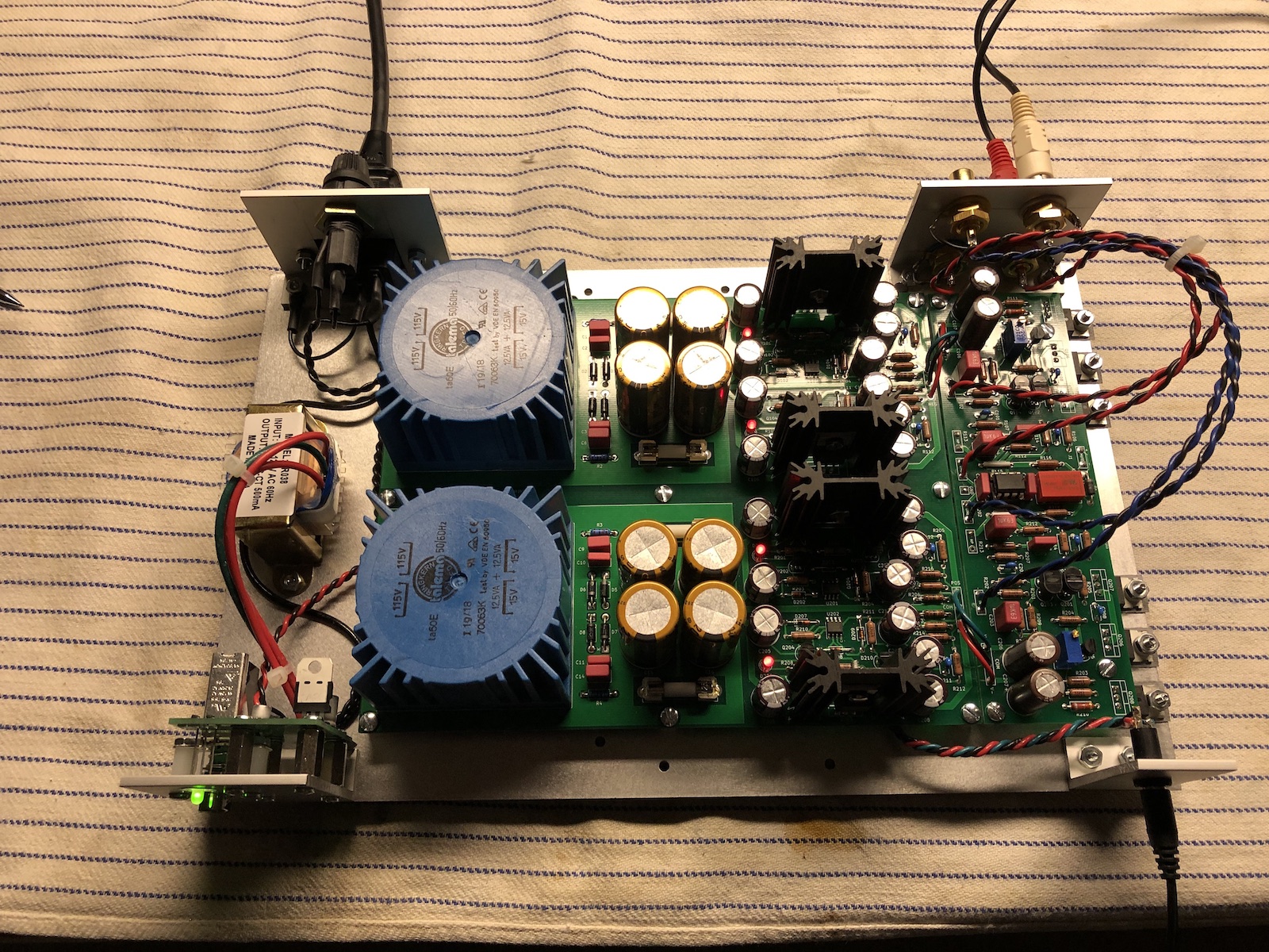

I took the amplifier over to Kevin's house last night and left it with him. He just sent me an email with his impressions. In a nutshell, he's really impressed. I hope he'll drop by in this thread and give a report.

Yup, I really like it. It was sort of an eye opener as I had thought the headphone amplifier in my Topping DX3pro was quite good - it's not. LOL The DCG3 demonstrated that in just a few minutes with my Oppo Planar 3 headphones.
It's extremely quiet, has much better performance in the LF, the bass performance with the dac was a bit anemic, this sounds more extended and better controlled.
There is more low level detail and a clarity without brightness - the dac headphone amp is both brighter/lighter sounding and considerably less resolving. I was surprised by what I had not heard before in about 90 minutes of listening.
It's more dynamic.
I'll be using this in my wind down time in late evening. I won't be tinkering with it or attempting to improve it. I won't be measuring it. It's well designed and suited to its purpose so I am just going to enjoy it.
Subjectively this is the best sounding headphone amp I have heard. I've designed a few over the decades and listened to a number of them in Montreal.
