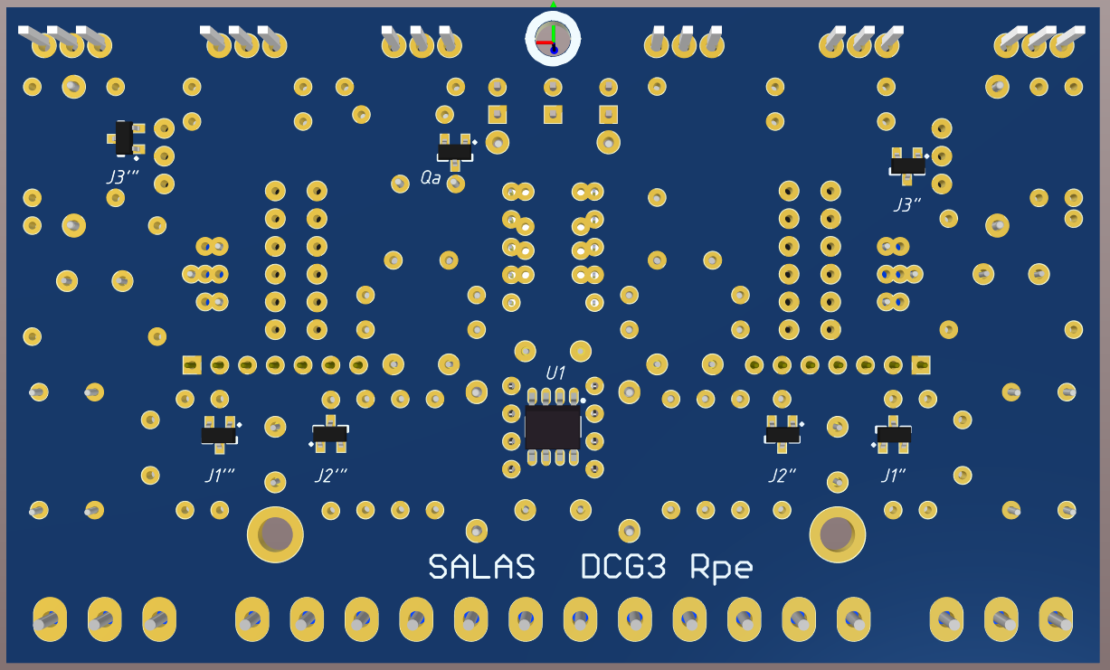

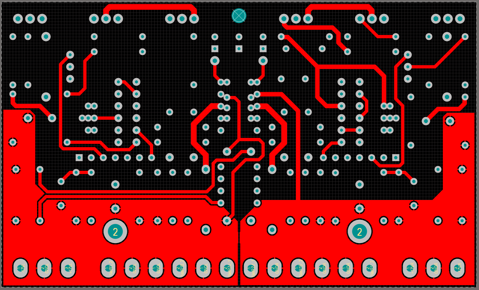

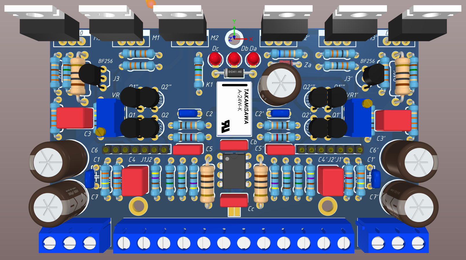

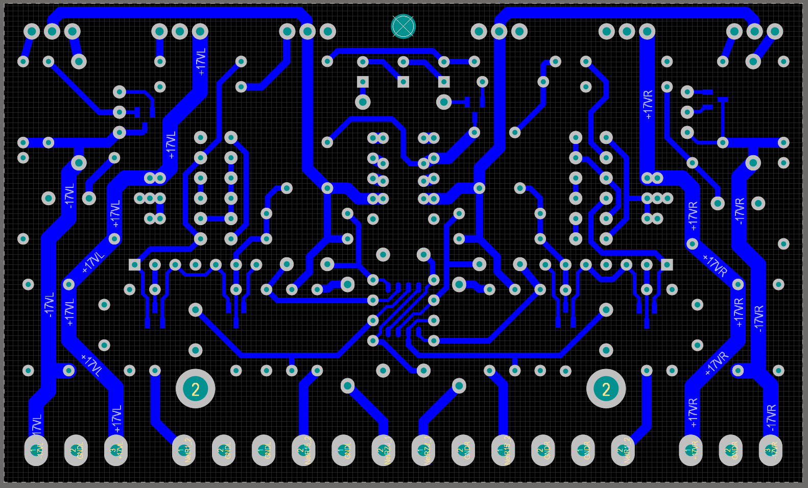

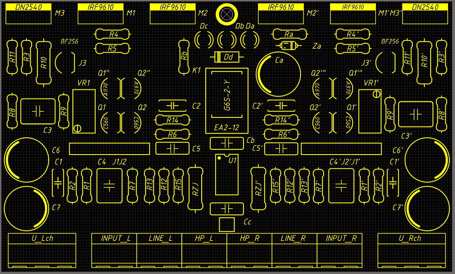

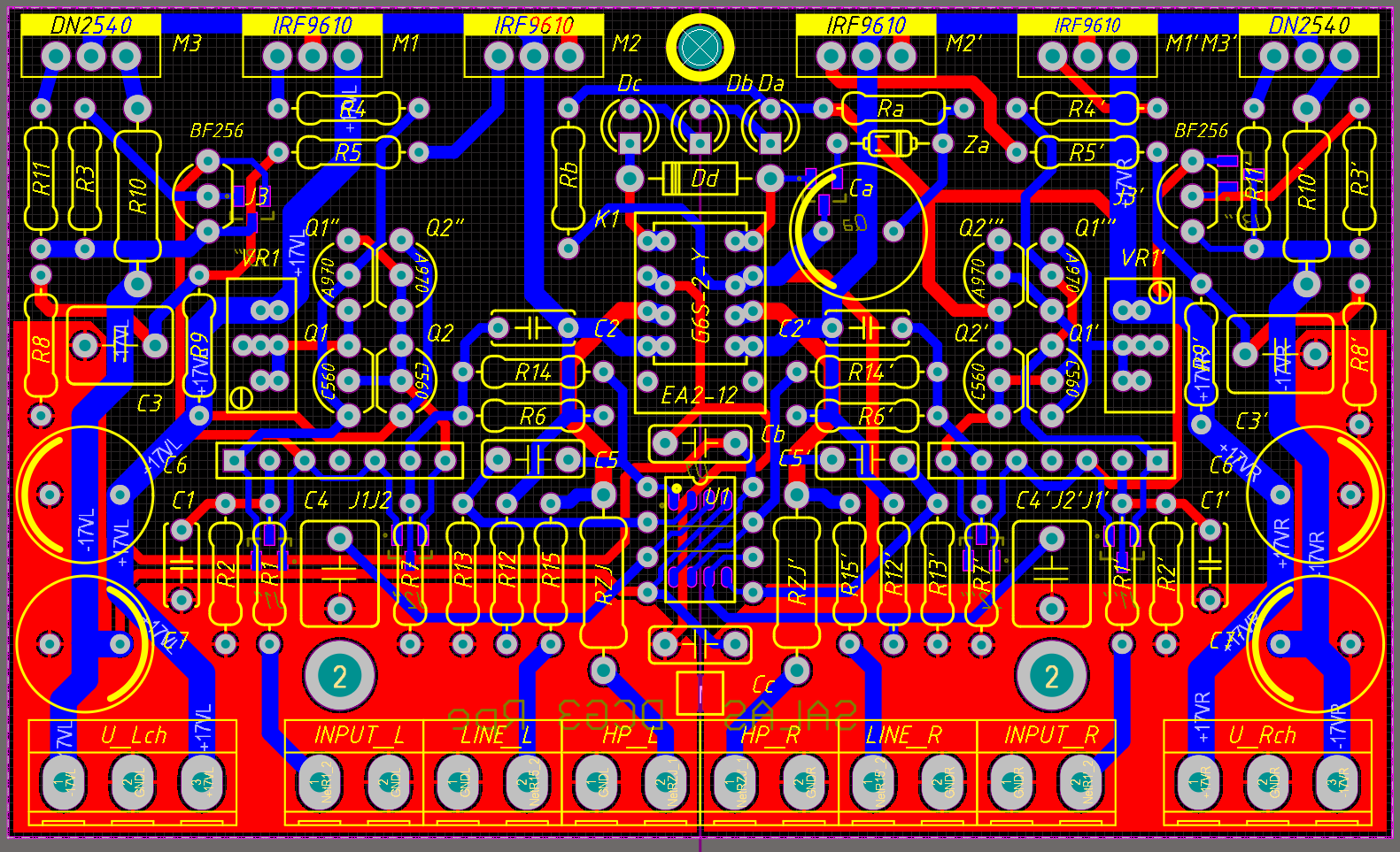

Since you are making a board you have the freedom to put a Toshiba 2SK209-GR(TE85L,F) surface mount for J3. Watch the pinout and use 1R R3. You can use this SMD as J1 J2 to substitute any suspect uPA68H as well. The 2SK209s usually come close for IDSS right out of their packaging. Keep R1 & R6 physically close enough to their gate pins. For through hole uPA68H or BF256B genuine & sorted out for IDSS, as well as for Vgs matched DN2540 M3s ask Tea Bag for help. He has a stash of proper active parts.
I'm already close to the final version.🙂

If I were to cook a second unit, the main differences can be made with a diffferent PSU, pot and opamp choice, correct? Bias maybe?
I also have a turn on/off thump, so I guess I should try a 22nF 630V cap on the switch.
Yes, different PSUs and other details choices are more evident on high resolution headphones. 150mA output stage bias can be bit better on lower than 80 Ohm cans as well.

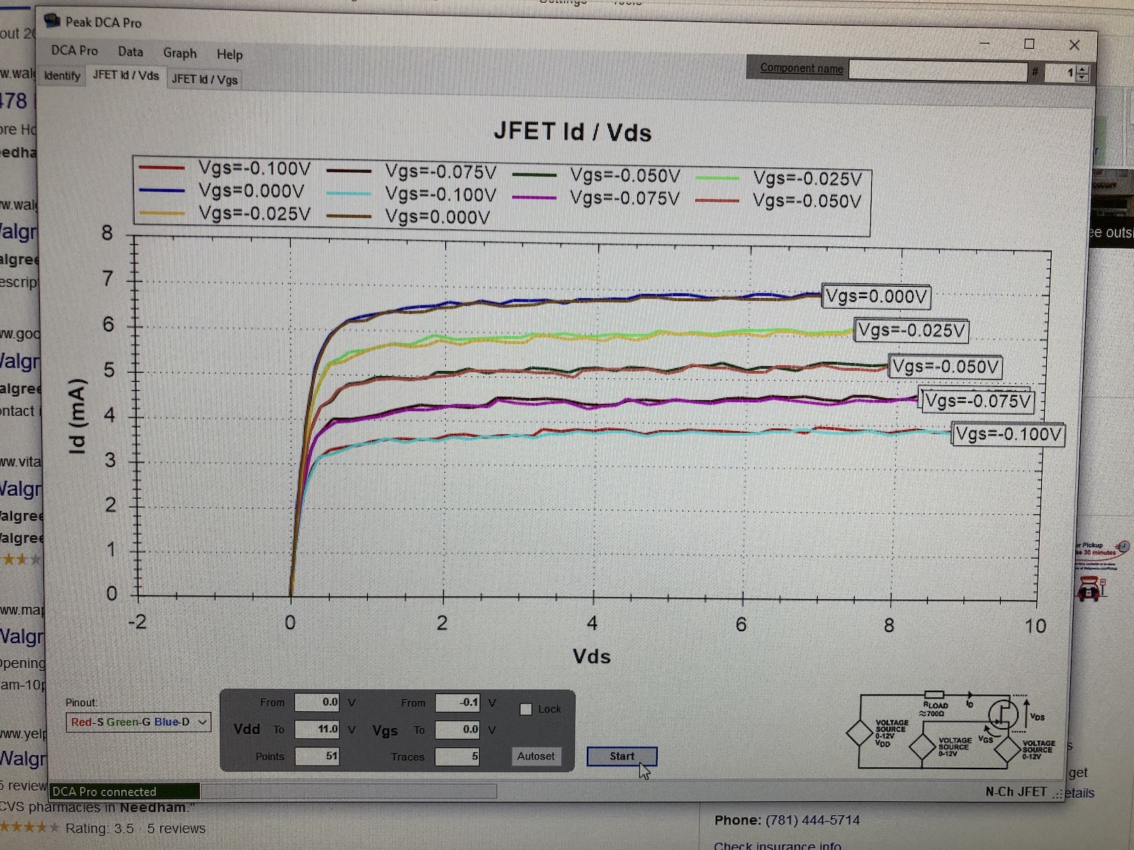

Tangential, but related: I've been thinking of building a new HPA from my own circuit and I was surprised to see that the published DN2540 curves don't match very well with the actual devices I have on hand. The bias current is much higher than would be expected for a given Vgs drop across the source resistor.
Also, as a follow-up to my previous post about the DCA75, I wrote to Peak Electronics and got a nice email back from the engineering director. He did offer to pay postage for me to send the suspect transistors in case a firmware update is needed. He also gave me some tips how to do measurements even when the DCA75 cannot identify the device.
On further investigation, it looks like I've got three blown TO220 DN2540s, one blown TO92 DN2540, and one blown IRF9610. The third TO220 went bad yesterday. I have no idea how the heck that happened, but I guess I need to get a lot more careful about my ESD protocol. The bad devices measure about 10K gate-to-drain while the good ones show open circuit in both directions.
I don't recall ever destroying a MOSFET or CMOS chip before, but it looks like it's trivially easy to do. So take care handling your transistors, especially in dry weather.

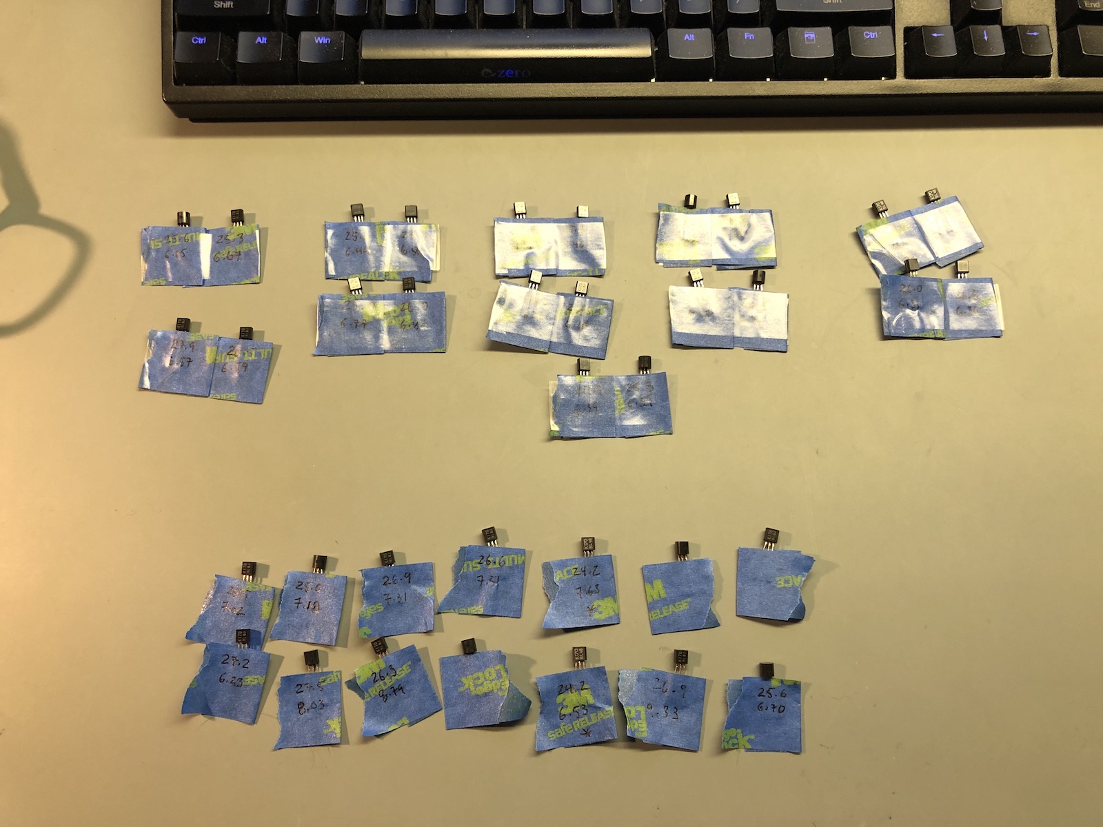

In happier news, I've been enjoying playing with my DCA75 tonight. I have thirty-six genuine 2SK170s and I managed to find eleven very closely-matched pairs (less than 0.05mA Idss, some pairs basically spot-on). I could probably get two or three more pairs matched to within 5% or less, but I have enough "perfect" pairs for five stereo projects, so that will keep me busy for a while.

Atlas is handy for small semis indeed. Let us know what will be discovered in the end with that weird identification issue on some of your D-MOS samples.
Yes... As I mentioned before, it looks like I destroyed a bunch of devices with static discharge. I don't see any fault with the DCA75. That leaves the mystery of why I'm blowing up transistors. It's been really dry here lately and though I have a Velleman anti-static mat on my workbench, I don't use a wrist strap. I need to be more careful.
Nice work!
I wonder, why you don't go smd for all the to92 small signal transistors? 😉
