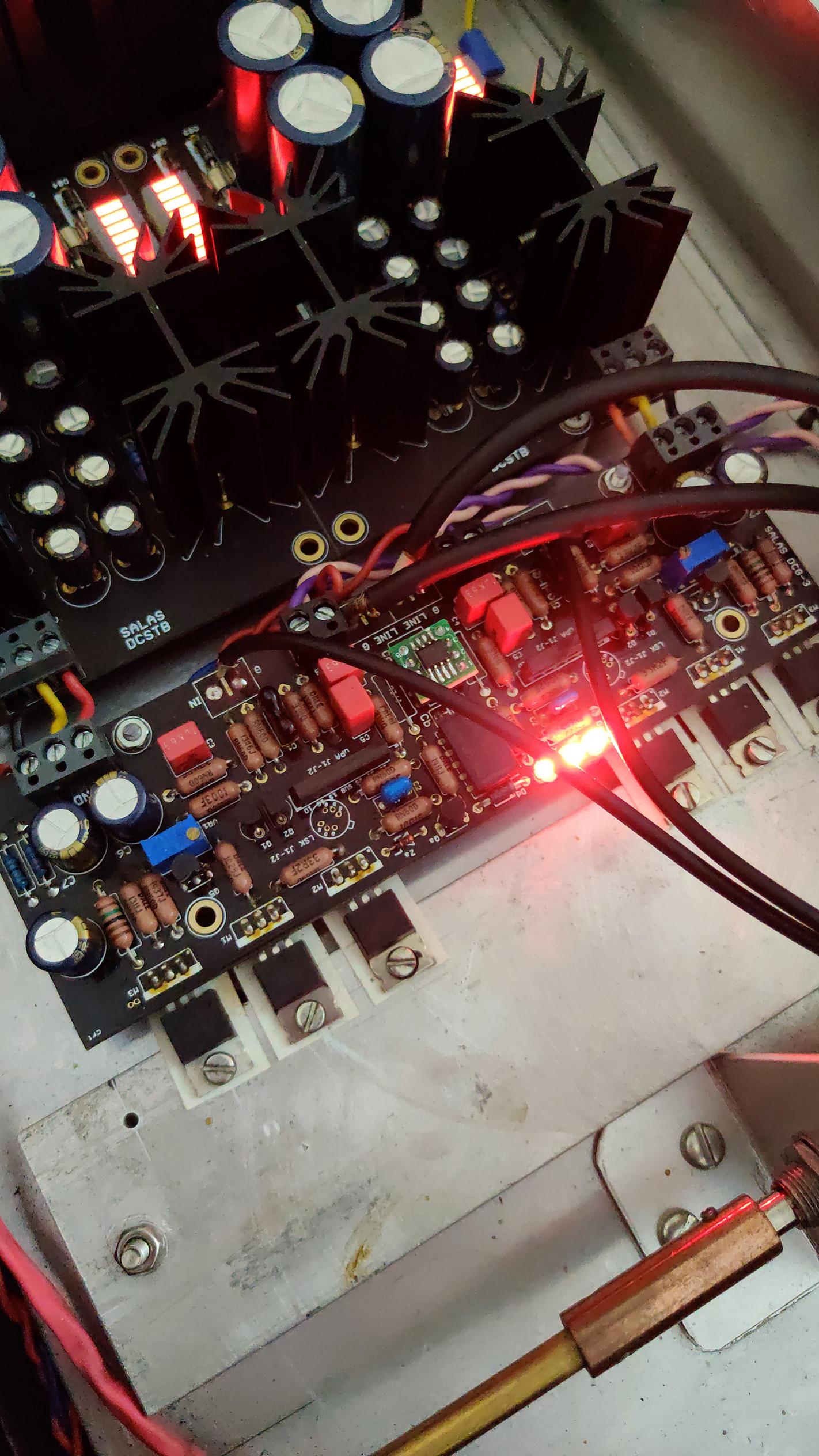

I will try with bc560 too and with a better offset controller.I have an smd opa2134 but i haven't pins for the adaptor.
My opinion on OPA2134 servo is it tonally blends more towards the newer high spec chips we tried in DCG3. I had one in DIP-8 package that I also swapped during the last U1 session. So its worth listening with it to see what suits your system and taste better. Try it before changing the mirror transistors so not to mix impressions.
