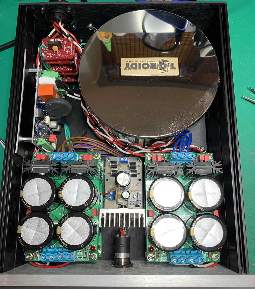

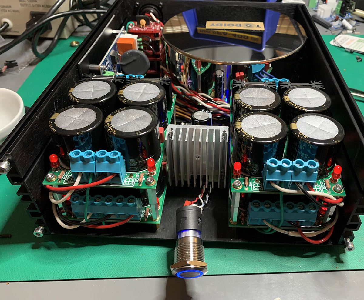

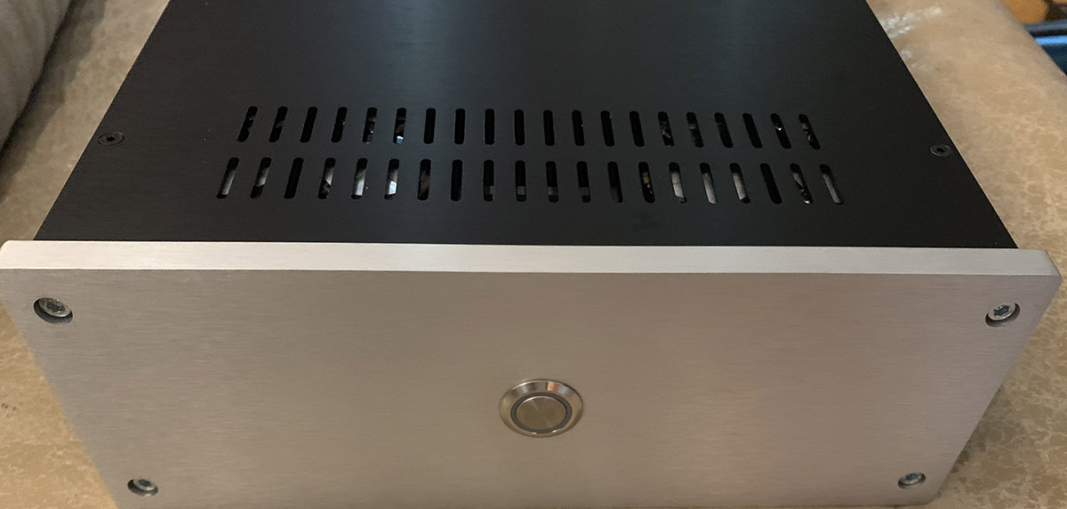

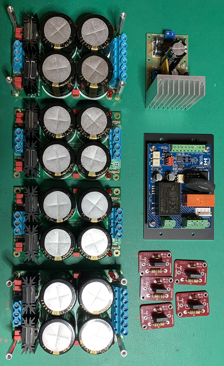

I finally got around to finishing the power supply for my preamp. This is in a separate box with a 14 conductor DC umbilical to the main chassis. The power supply has four separate +/- supplies (two of which are about +/- 18V and two +/- 23V). These will feed four pairs of UBib regulators in the main chassis for two +/- 12V and two +/- 17V supplies.
The 12v supplies will support the op-amp input buffers and op-amp output buffers that will parallel the DCG-3. This latter buffers will provide single ended outputs for my subs, and a second balanced output, mostly to compare with the DCG-3. Left and right channels are separate.
The power supply also has a regulated 5.1V DC supply for the stepped attenuator control circuitry and OLED display.
The transformer is a custom 400VA Toroidy with nine separate secondaries.
My preamp will use two 2-channel DCG-3 boards for fully balanced operation, and a four-channel Khozmo stepped attenuator and relay input selector.

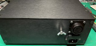

Could you please give some detail on the 14 conductor umbilical and its connectors. Awg etc?
Thanks. nash
Thanks. nash
I found a site called ShowMeCables.com which has a variety of options for multiple conductor cable. I ended up buying several different cables in 14, 16, and 18 AWG, each with 15 conductors (I'm only using 14 of them) because I wasn't sure how thick or flexible they would be and they weren't very expensive.
I haven't decided what gauge to use yet, but will probably go with the 18 AWG since it will be a bit more flexible and the drop across the cable will be negligible for the current draw required. I'm also still using the 6800uF caps at the input of the UBibs, so I'll have plenty of local energy storage in the main chassis.
I'm planning to add a braided tinned-copper shield around the umbilical that will connect to the ground lug on the back of the power supply chassis. The whole cable with shield will then be wrapped in techflex.
The panel connectors are TE Connectivity 205043-4 14-position circular connectors. The cable ends will use TE Connectivity 182649-1 plugs with a matching cable clamp (I have a couple different ones to choose from depending on which cable I use).

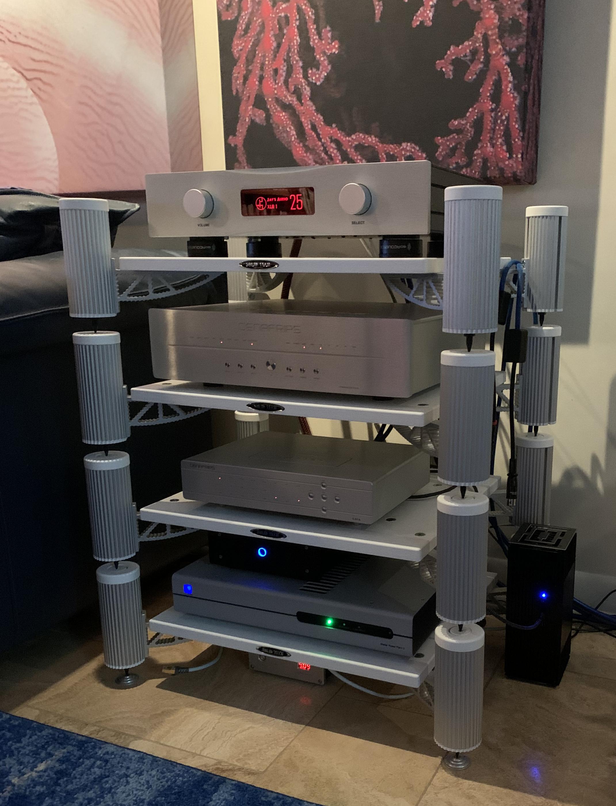

I've included a photo from Khozmo as well as a photo of my first DIY preamp.
