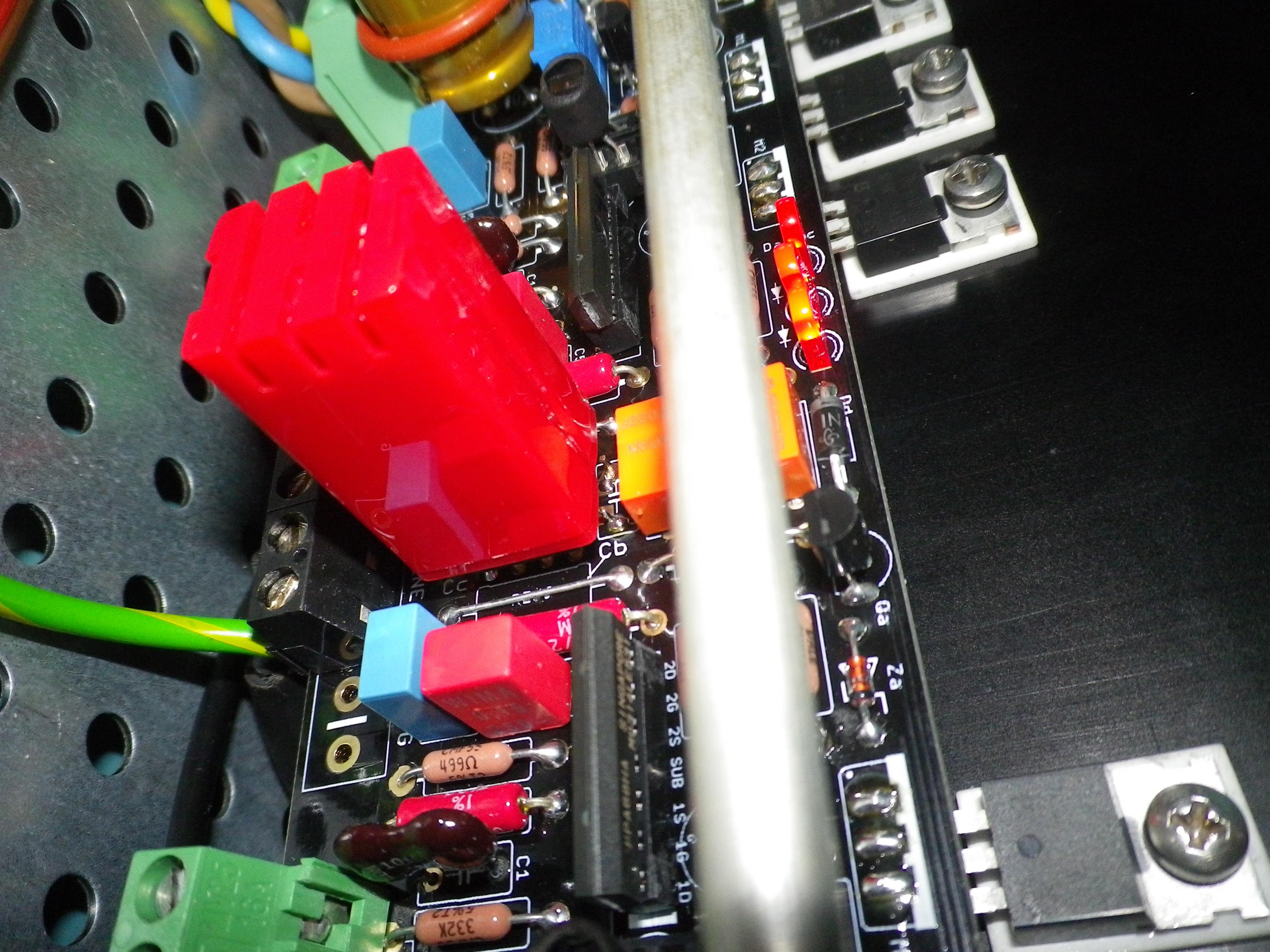

Here is a pic of how far along I am.
Thanks. How are you doing the +/-15V supply for the Muses and will that supply be in the PS box?
I Hope the muses is as good as they say it is. There is the muses, The muses PS which I got nervous on and went for an LDO ultra low noise, and now I have to figure out how to power that.😱

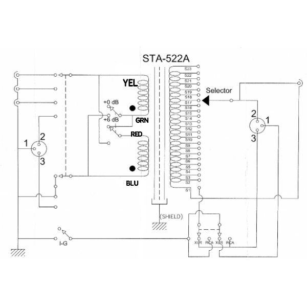

the DCG3 supposed to be very sensitive for volumepots etc,
would a tvc be a good candidate?
I looked at the silk STA 522A, and it seems that you can also do unbal to balanced here.
Also you would only need a 2 deck switch?, what am i missing here?

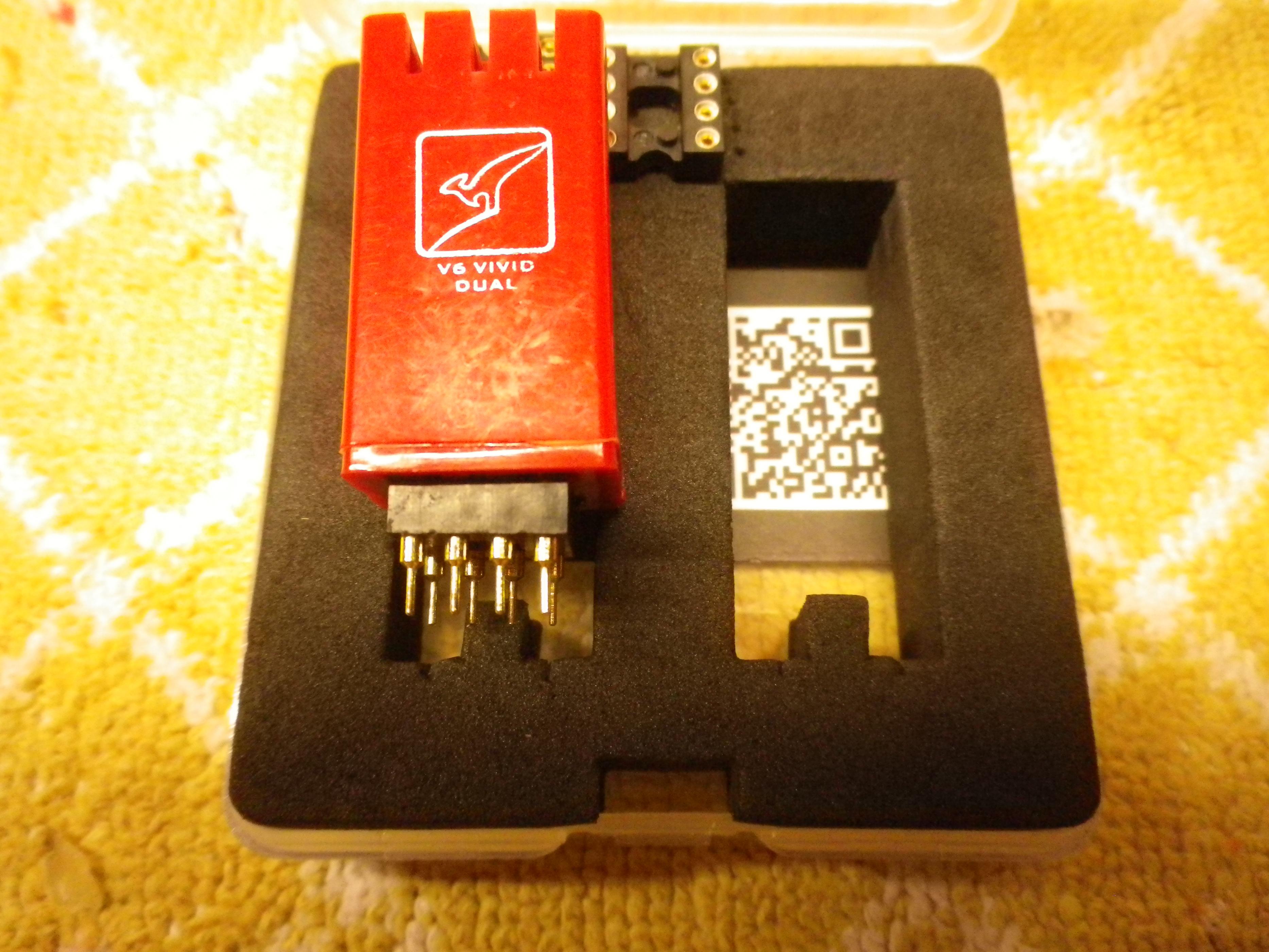

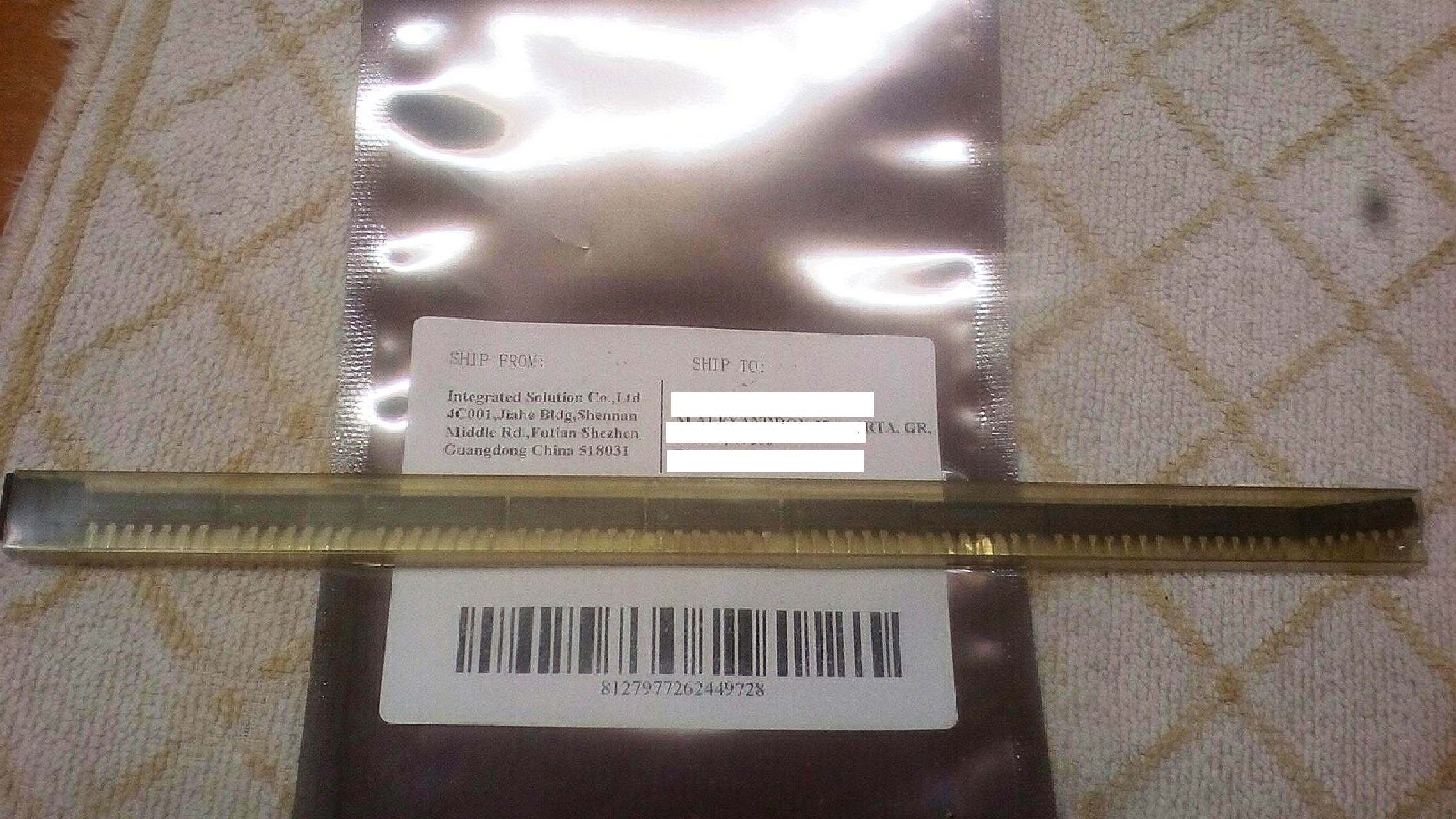

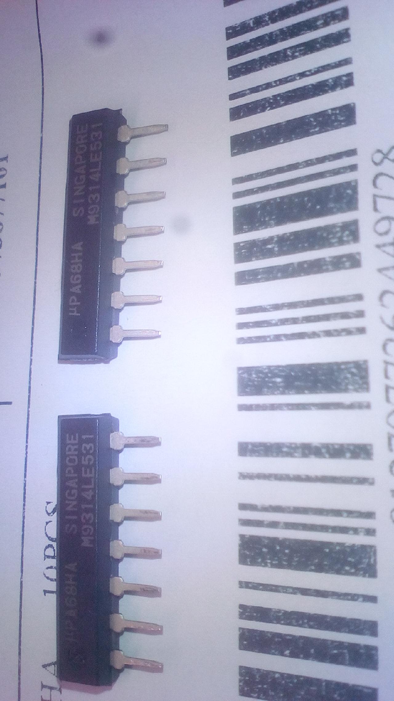

Αrrived today they look very good and play perfectly .... also the variation of the offset is minimal ...
regards,
John
John,
I have tried an AVC and it sounds quite good. You can try it before or after the DCG3. These usually like a low source impedance before it; the DGG3 output impedance is 50R so works fine with AVC after it. Cant specifically comment on a TVC.
nash

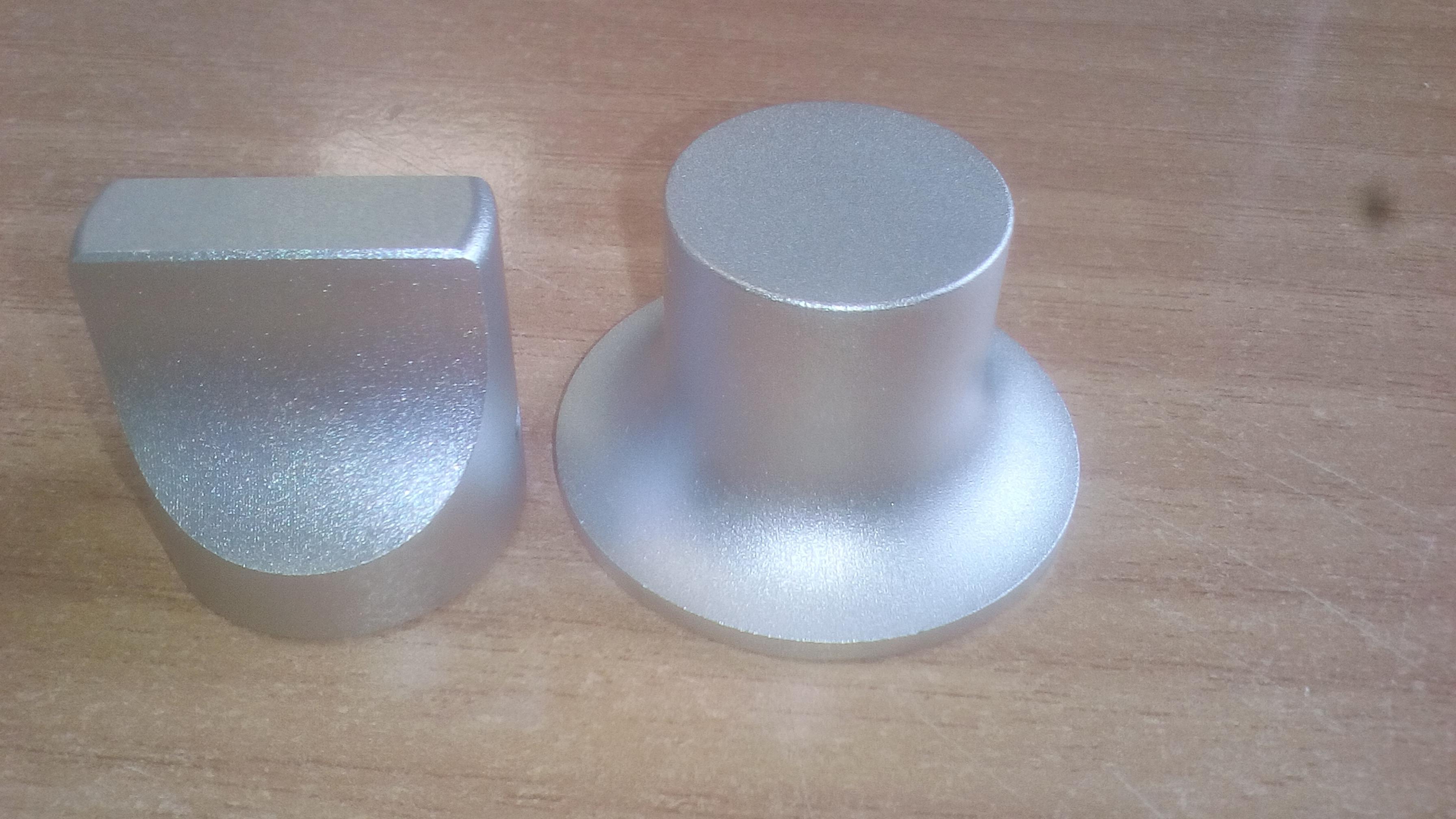

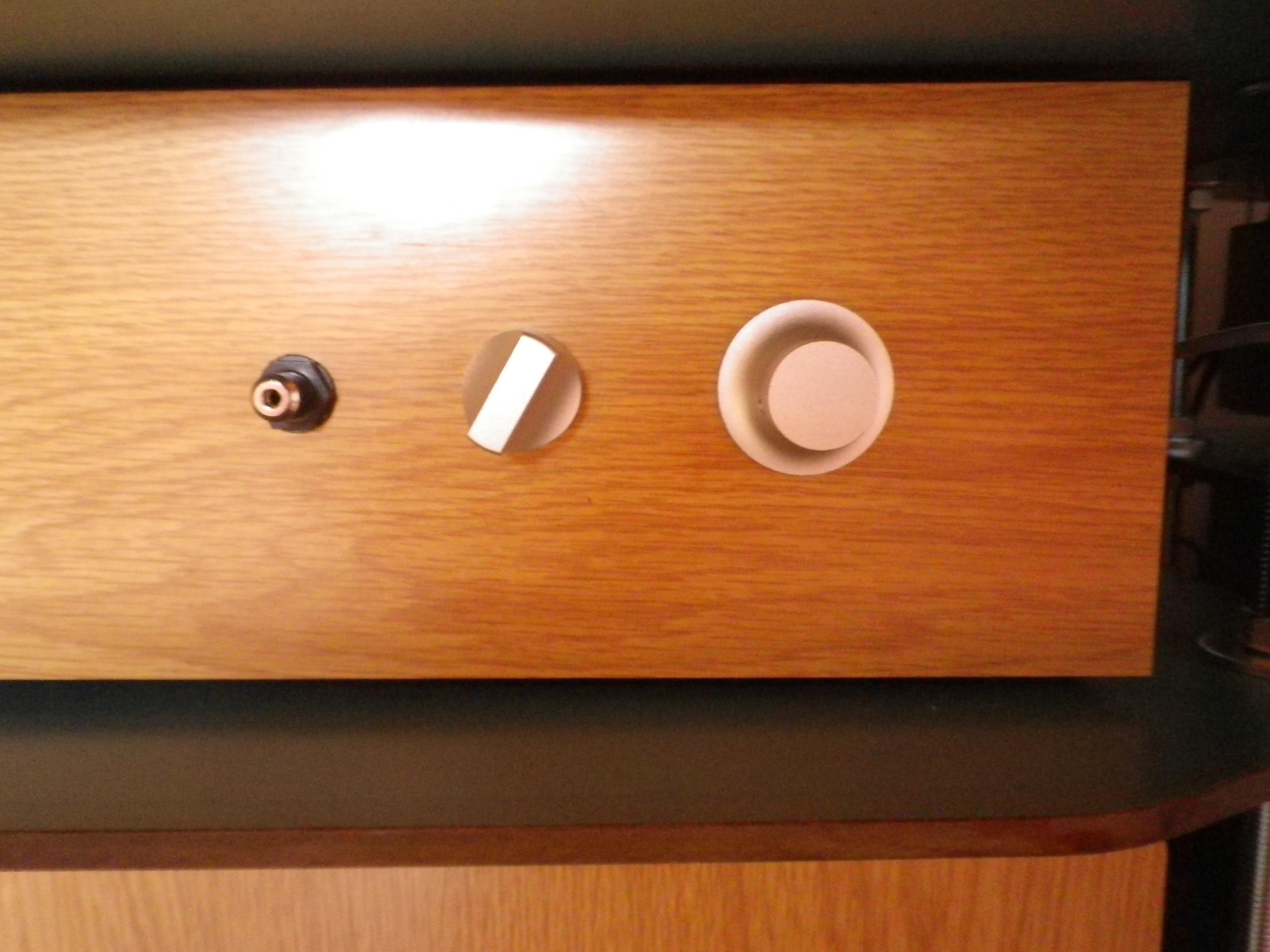

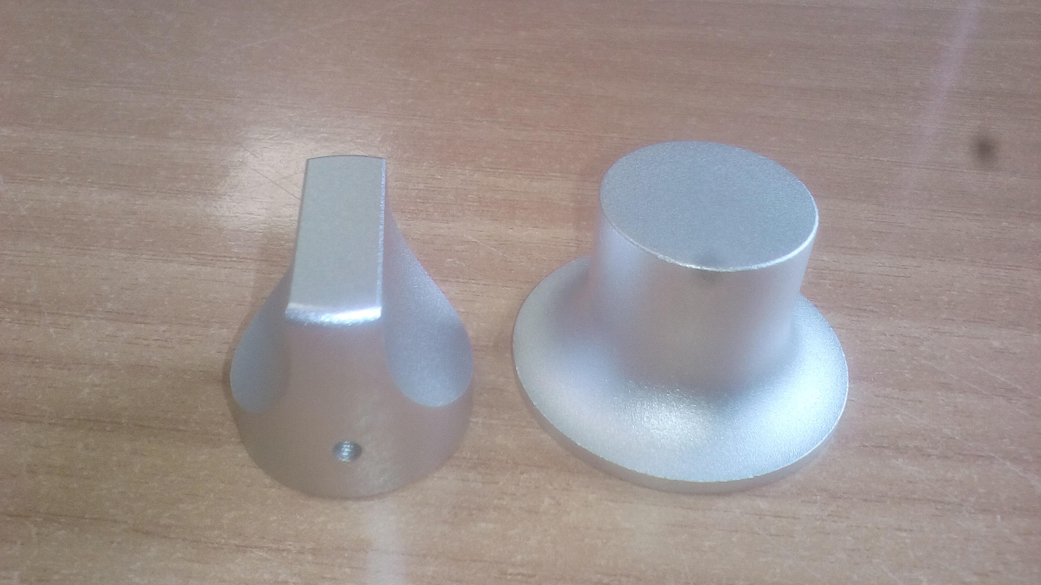

My aluminum knobs arrived.... Cost 10 euro both them...
BRZHIFI full aluminum knob for power amplifier 38*23mm|breeze audio|knobs for amplifiersaluminium audio knob - AliExpress
BRZHIFI full aluminum knob for power amplifier 25*25mm| | - AliExpress

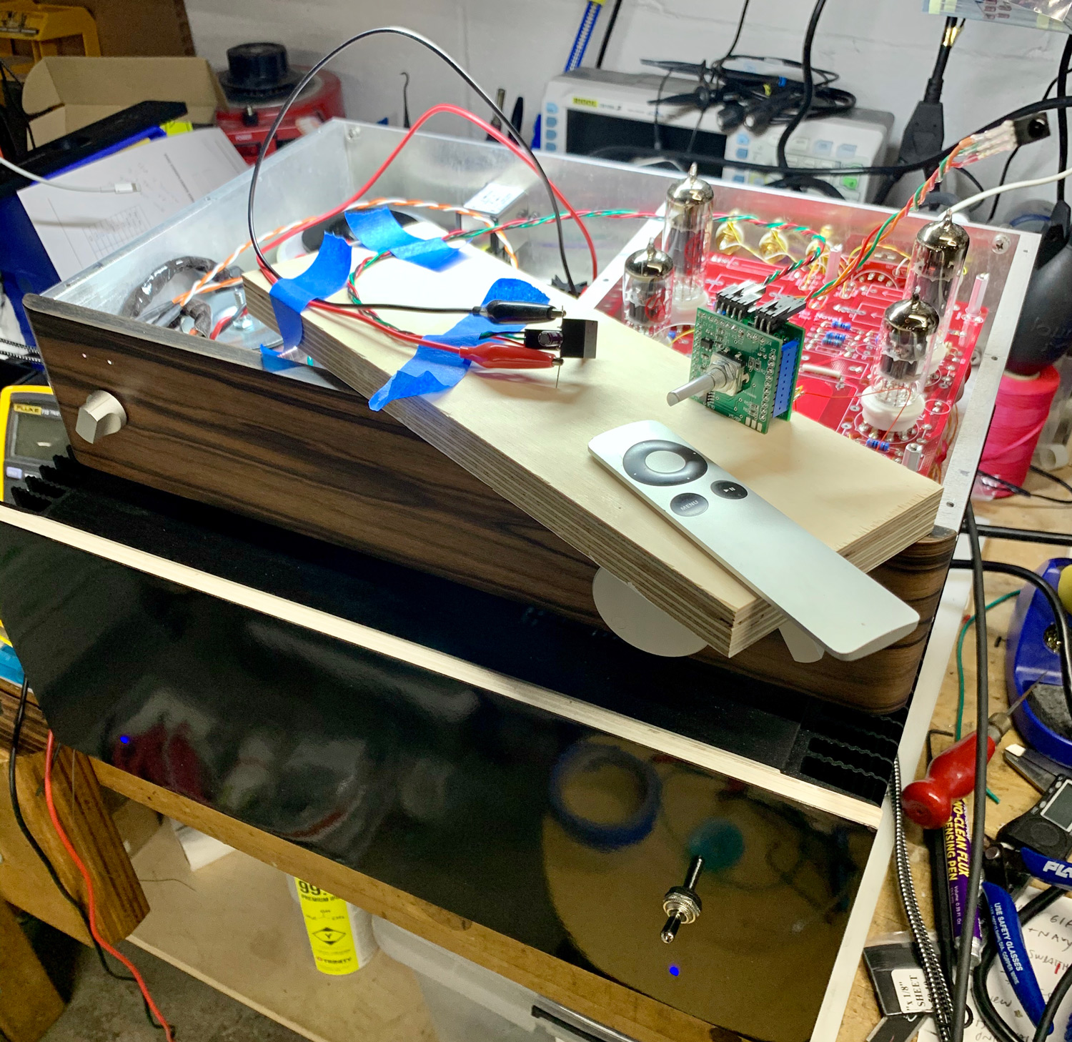

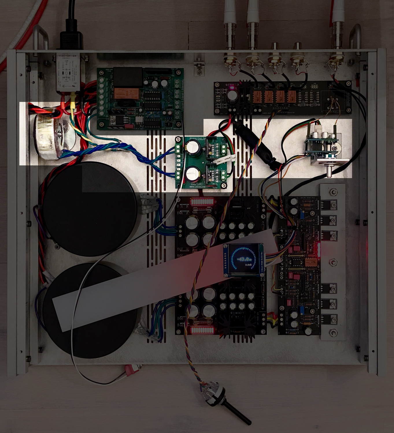

@Hicoco - Thanks. I'm using a Khozmo attenuator I haven't seen on their website. It was recommended by Arek (Khozmo proprietor) for my first DIY preamp and I really liked the way it worked, so I bought another one for this project.
In my first preamp, I did not have an input buffer, so fed the input directly to the attenuator (which operates in shunt mode). Since I didn't want too low an input impedance, I used a 20K series resistor. That one was built with Takman REX shunt resistors and Vishay Z-foil series resistor.
For this new preamp, I have added an input buffer so I could increase the preamp input impedance and decrease the attenuator resistance. I also decided to try different resistors, so this one will use Takman REY shunt resistors and AudioNote Silver Tantalum Non-Magnetic 4.7K series resistor.
The attenuator includes a 6-to-1 input selector, two rotary encoders (one for selecting input and one for volume), an OLED display, and an IR remote control.
Each attenuator PCB can support two channels, but the boards can be sandwiched with a daisy-chained control cable to support more channels.
I've included a photo from Khozmo as well as a photo of my first DIY preamp.
- Jay

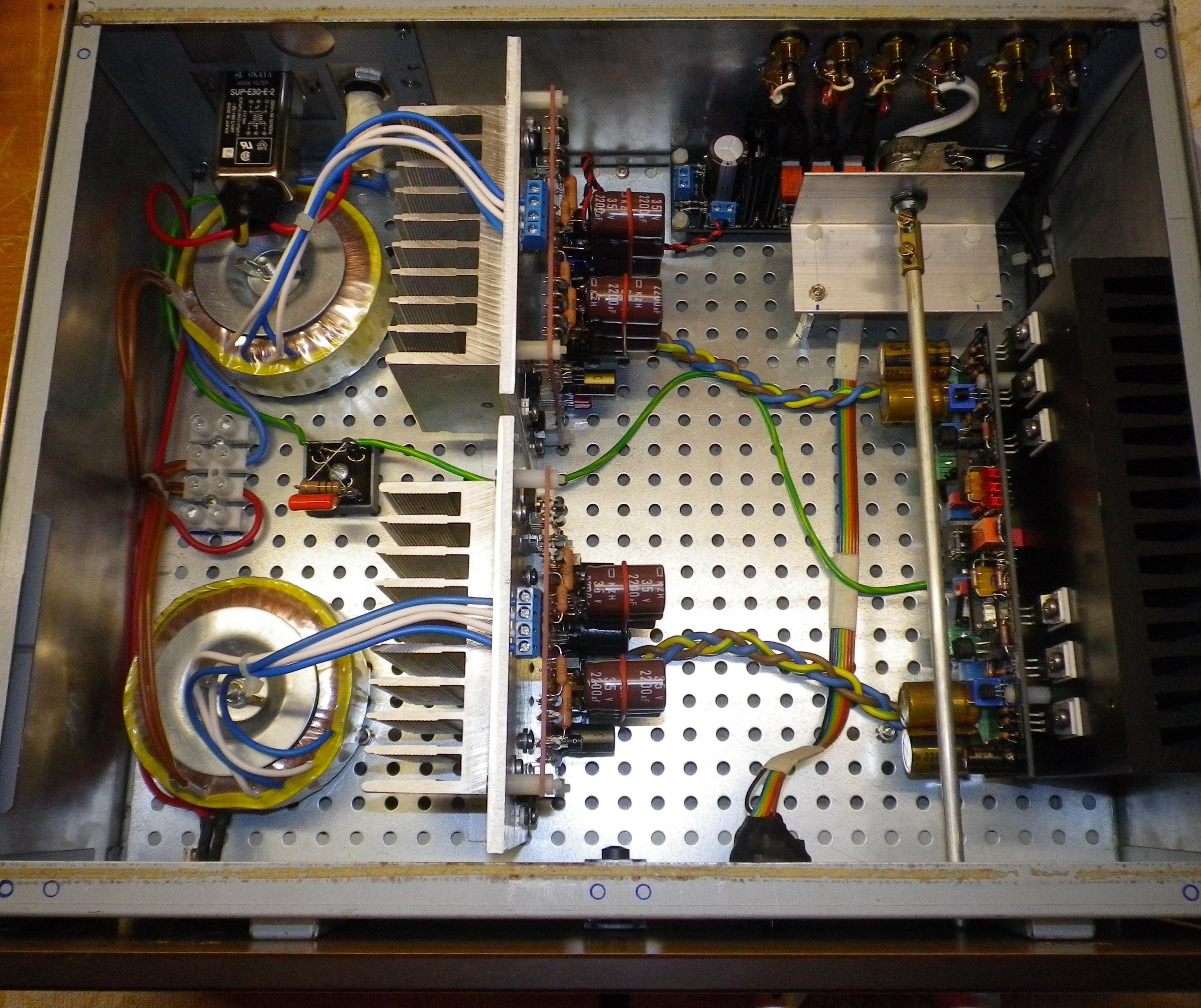

Great looking build. Do you have any pictures of internals of the main pre-amp? chassis? I am planning a balanced build and am curious how you've laid it out.
nash
Thanks Nash,
Before the DCG3 means i dont need an output filter in my dac and then i have se-bal conversion, but it is easy to try what sounds better i guess.
Still havent figured out how this all works, se in and bal out, i never used transformers before.

Thank you!They look nice against the wooden panel
(The ultimate sound ).... hmmm the best I've got from my system so far Vivid V6. Thank you again Νick for the preamp you gave us.
