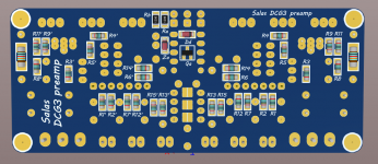

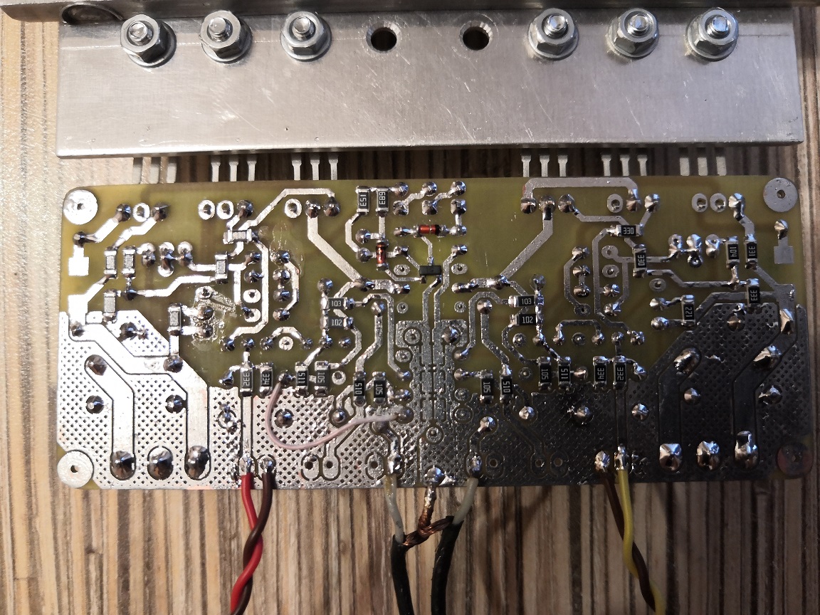

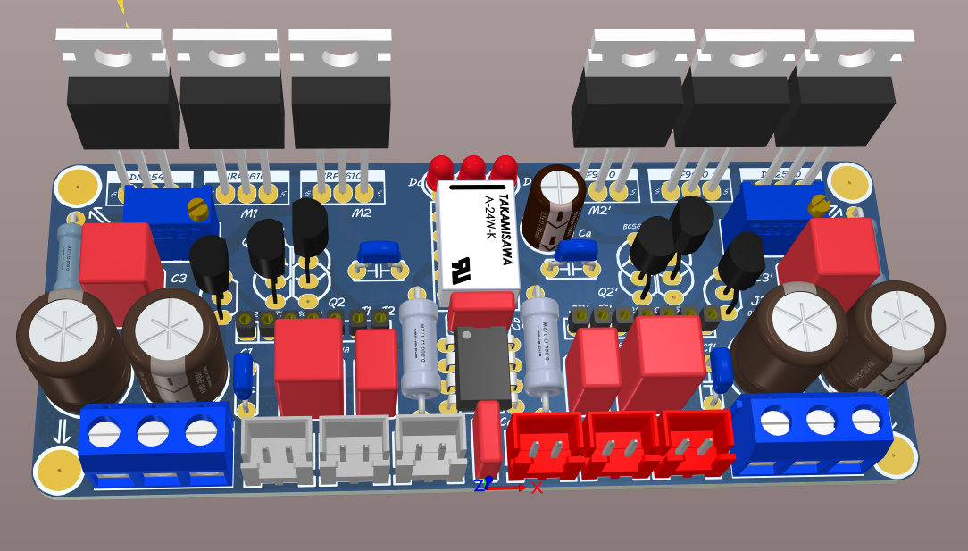

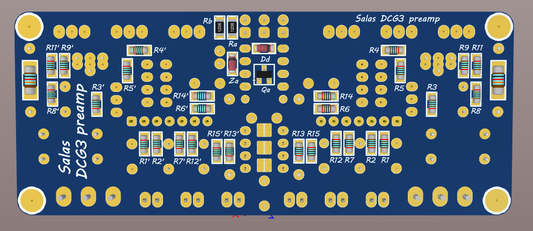

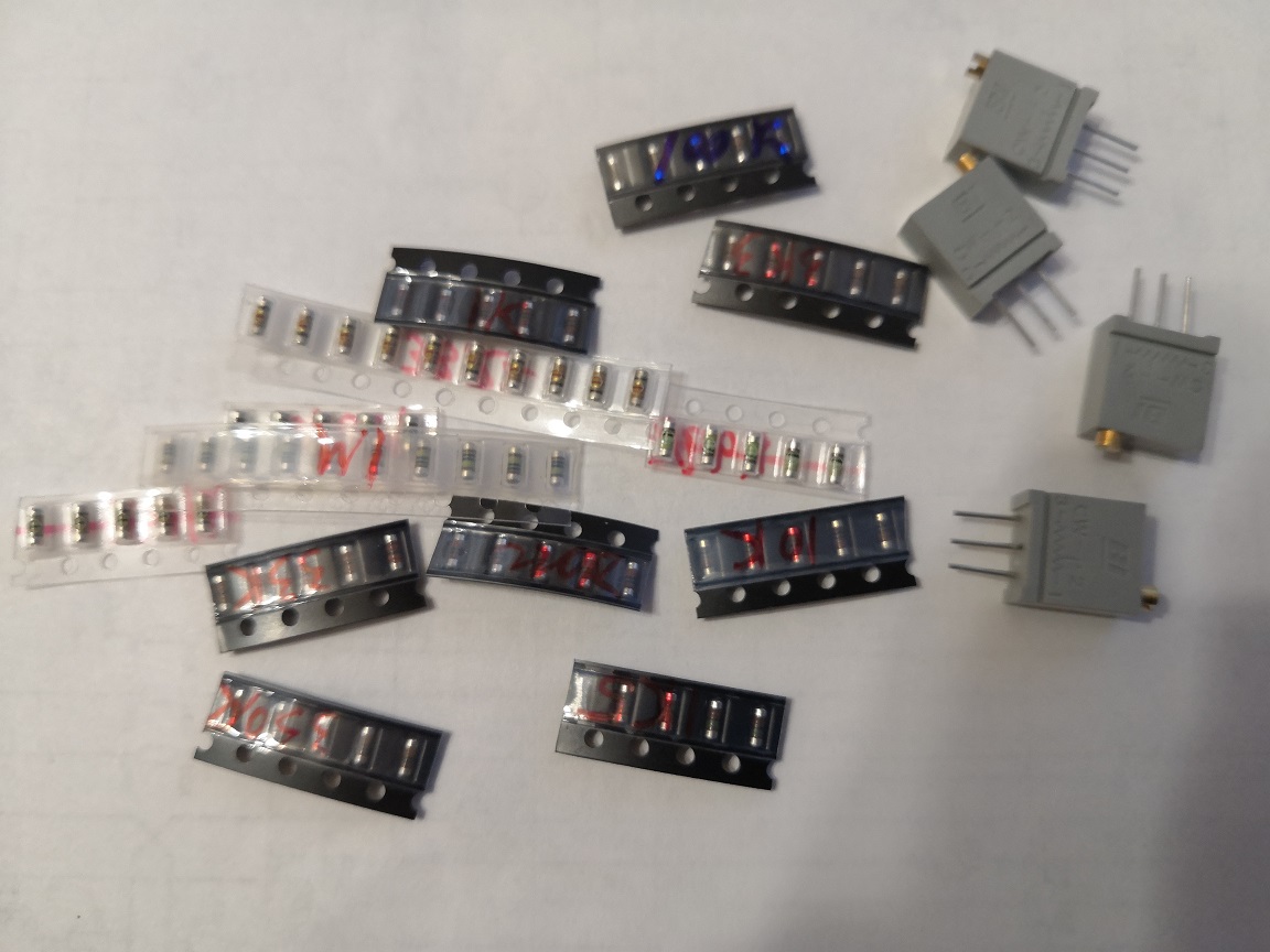

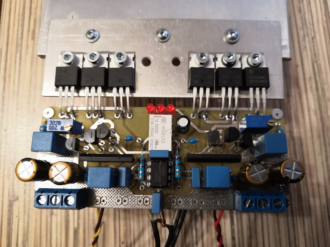

Hello, everyone. I finished the layout of the preamp. The first activation. Everything is OK, well, almost everything. I made a mistake in the payment.The channel 1 integrator did not work. That's why I built the layout. R10-10R. The offset current is 114mA. The sound, at first glance, is very good, you need to warm up. You can order the production of printed circuit boards UltraBiB and DCG3. Subsequently, I will replace the capacitors with Wima, miniMELF resistors. Tomorrow I will try to remove the RMAA spectra.
Good health to all. Performed measurements with the RMAA program. The preamp is powered by both channels in parallel from a single UBiB. Everything is located on the table. Not the best interblock wires (long 1m). I measured the sound card on itself and measured the Preamp. What can you tell from the results? Am I doing the right thing? Maybe you need to set certain levels in RMAA? I hope that after replacing the resistors, the noise will be lower.

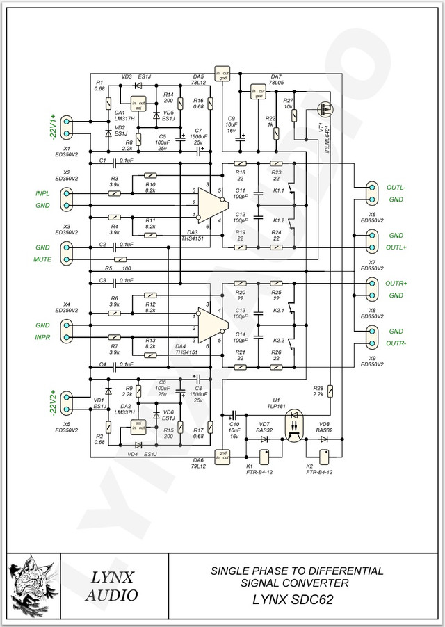

Hello. Please tell me the number of the post where it is indicated how to correctly transfer the preamp to the balanced mode. I plan to provide for these changes on the printed circuit board. Thanks.
And one more question. There is an unbalanced signal source and a balanced power amplifier. I plan to use a converter. How will the sound path be organized correctly? Use two preamps in balanced mode and put the converter in front of it. Or one preamp, and turn on the converter after it, before the power amplifier?
@Crazoff - Take a look at the posts starting with 5323.
I'm planning to put the single-ended to balanced converter at the front end of my preamp (after the input selector, but before the stepped attenuator). This way, you can take advantage of the strong drive capability of the DCG3.

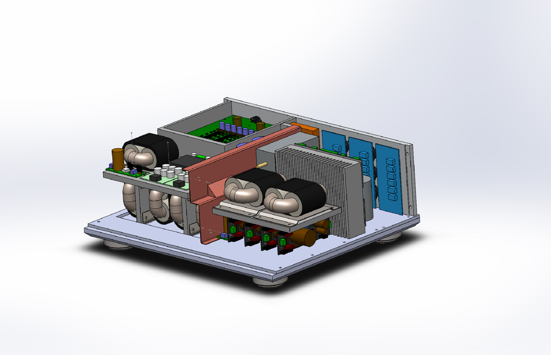

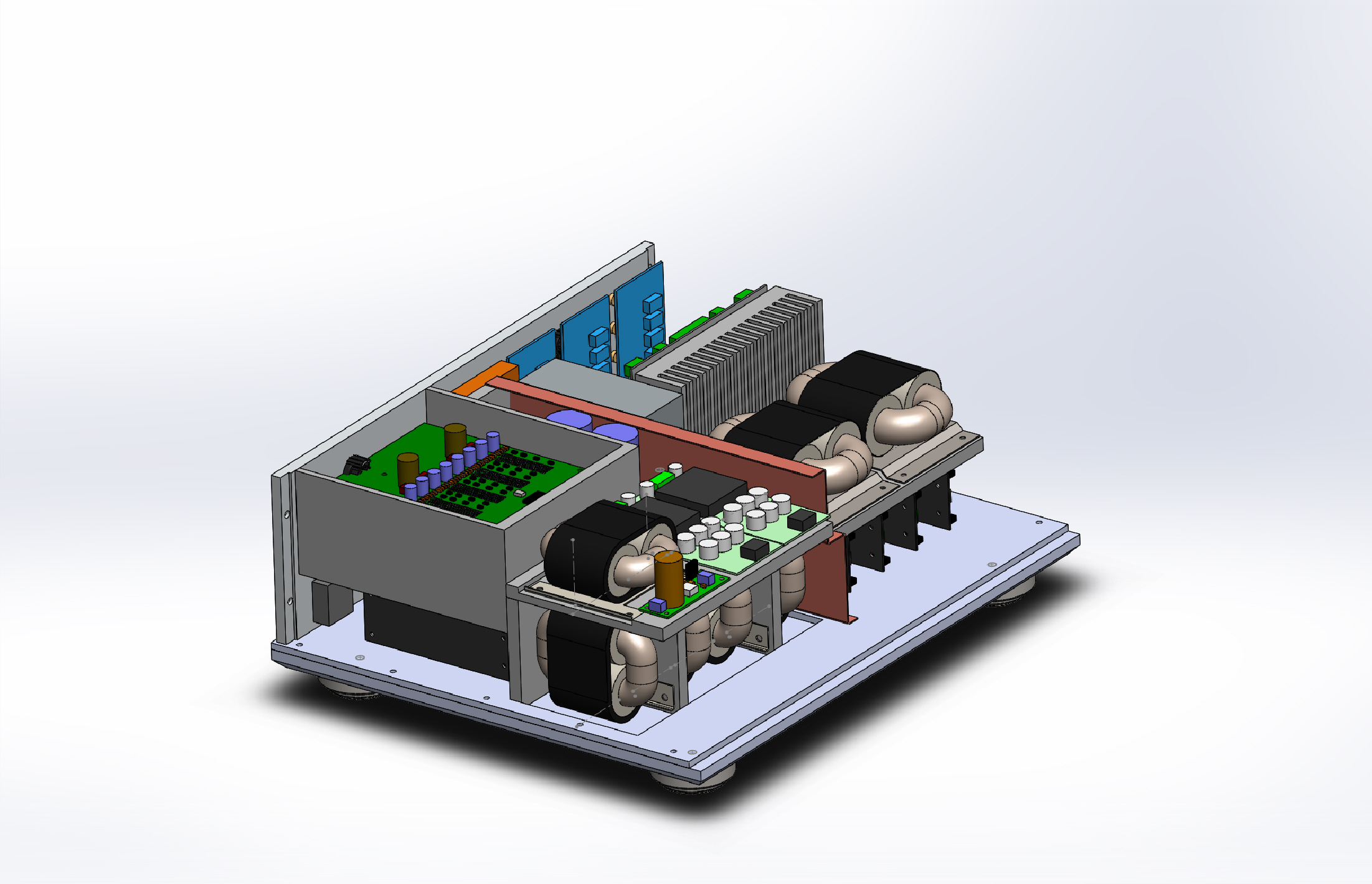

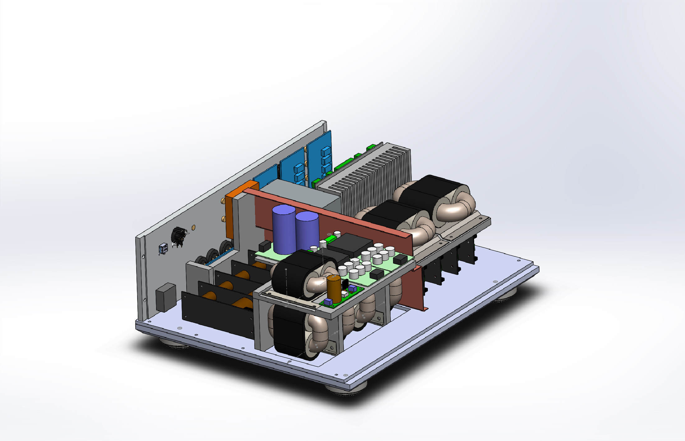

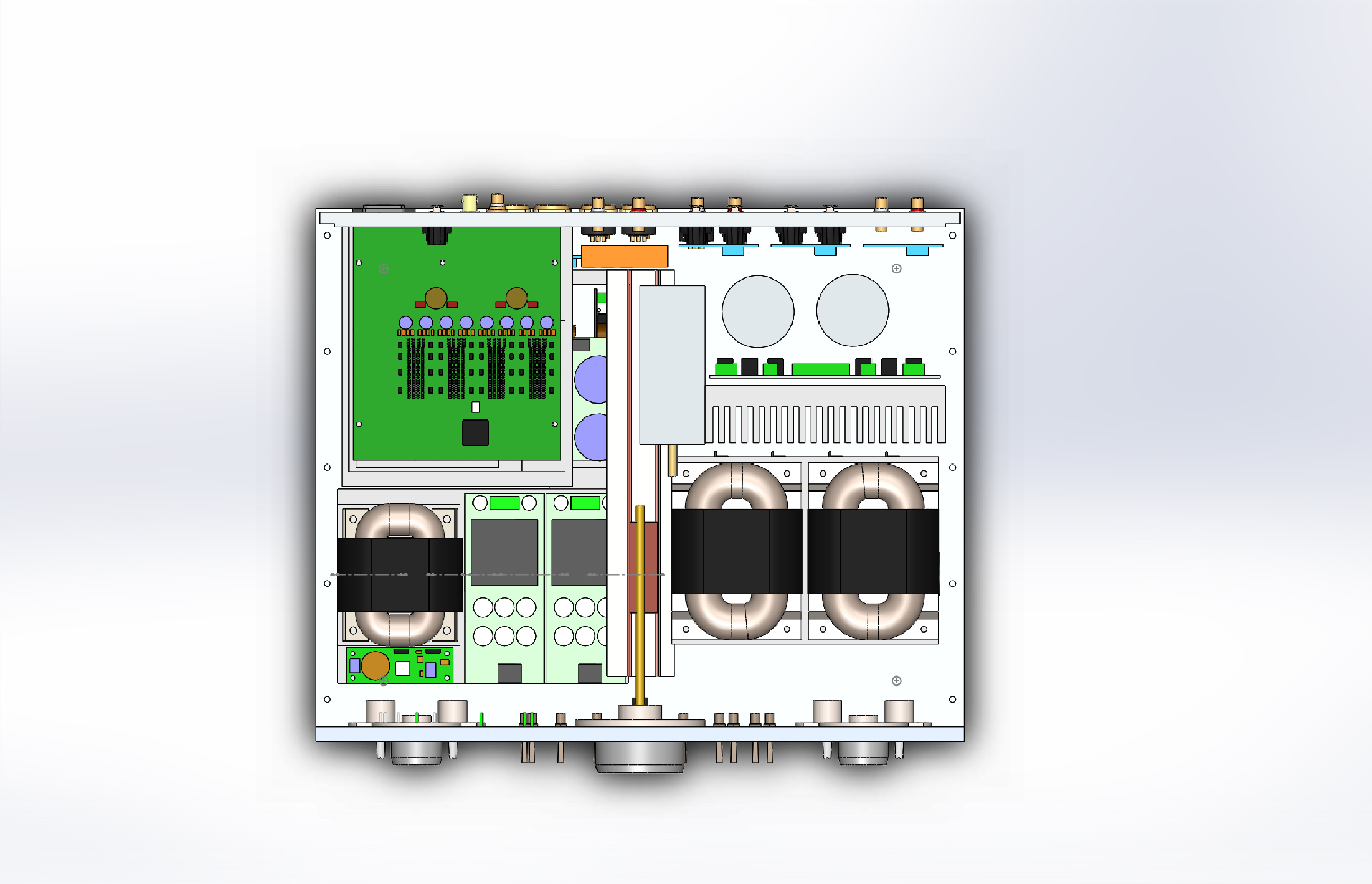

The pre amp casing is getting to be a big puzzle, it's full.
and i still need to add more, it's a challenge.
According to the cad, the weight will be 37 kilo's
we have:
7 UBIB's (4 for dcg3, 3 for dam1941)
2 sslv's (neurochrome)
2 tvicol zero's (5V for control, 12V for elma lin motor)
2 dcg3's
1 neurochrome buffer (processor out)
7 r-core transformers
2 silk tvc's with elma 24steps rotary switch
1 dam 1941
ian canada fifopi, reclockpi, stationpi, uc conditioner, conditionerpi and linearpi dual
etc etc
regards,
John
