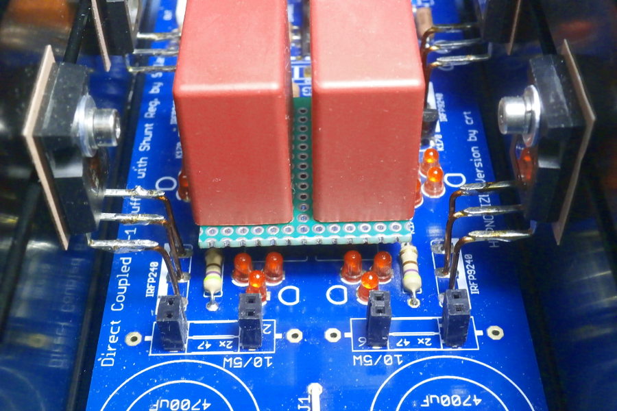

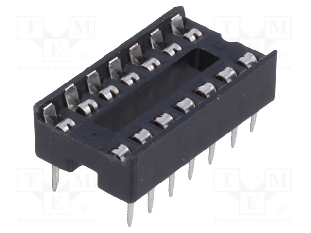

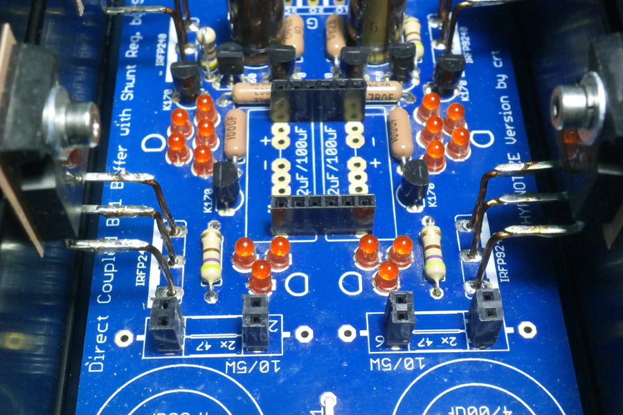

You also installed nice thick single in line sockets for easily exchanging J1 J2 I see? Where did you get those?
Normal headers can also be useful especially if you want to quick swap parts. An extra pcb is used in this case. The example shown is from my DCB1. I use double headers for high current connections (current setting resistors)
The dip socket Nikos shows has a tight grip but if you do a lot of swaps that could be inconvenient and in this case you could do the pcb/headers trick. On the other hand if you need one of two swaps or just want the part socketed would do the job just fine
